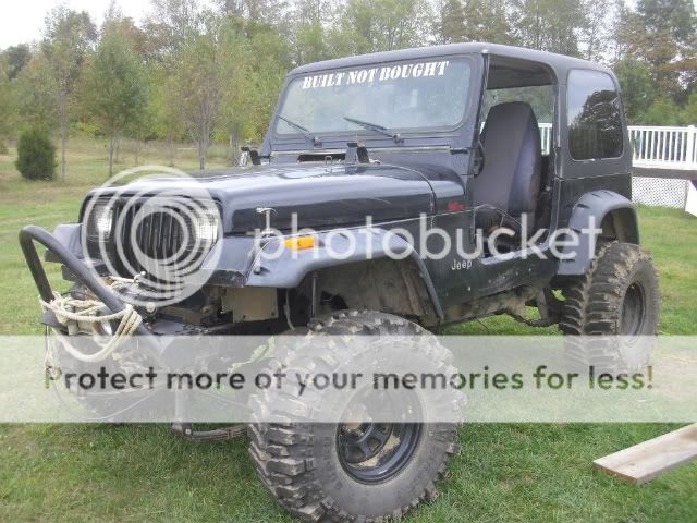

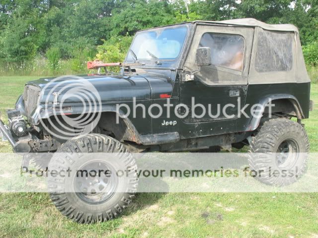

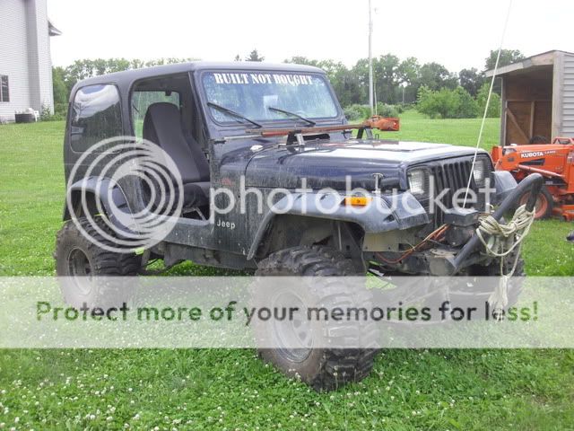

ive been building my jeep for almost a year now and have just now decided to post the build. its a 93 yj that started out red and was painted black during a body off restoration and had 35" bald baja claws put on it, it also had a burnt up winch before i traded my 72 satellite for it. all work has been done by me.
got it looking like this
i started out by doing a 3" BL and 4.5 spring lift and tom woods drive shaft with SYE kit.
then bought a hard top, bushwacker fender flares an xrc-10 winch and boggers.(over a couple of months period) my buddy made the built not bought decal.
this is at bundy hill offroad park a few of miles away from my house
93 yj 5.3 vortec, custom 3 link, 35/16/15 boggers, sye, xrc-10 winch. Built not bought member #127

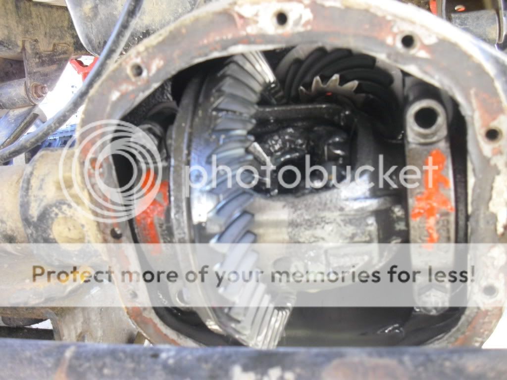

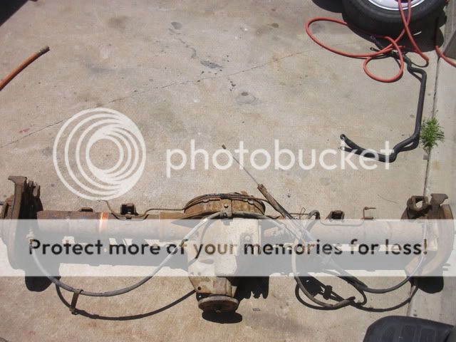

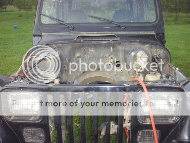

planing on putting an aussie locker in today and later this week a chevy 5.3 in it with an sm465/205 with a ford 8.8 rear end i have all of it so i will post pictures along the way. picking up an 8.8 later tonight with 4:10 gears and lsd for $80. the guy doesnt know what he has.

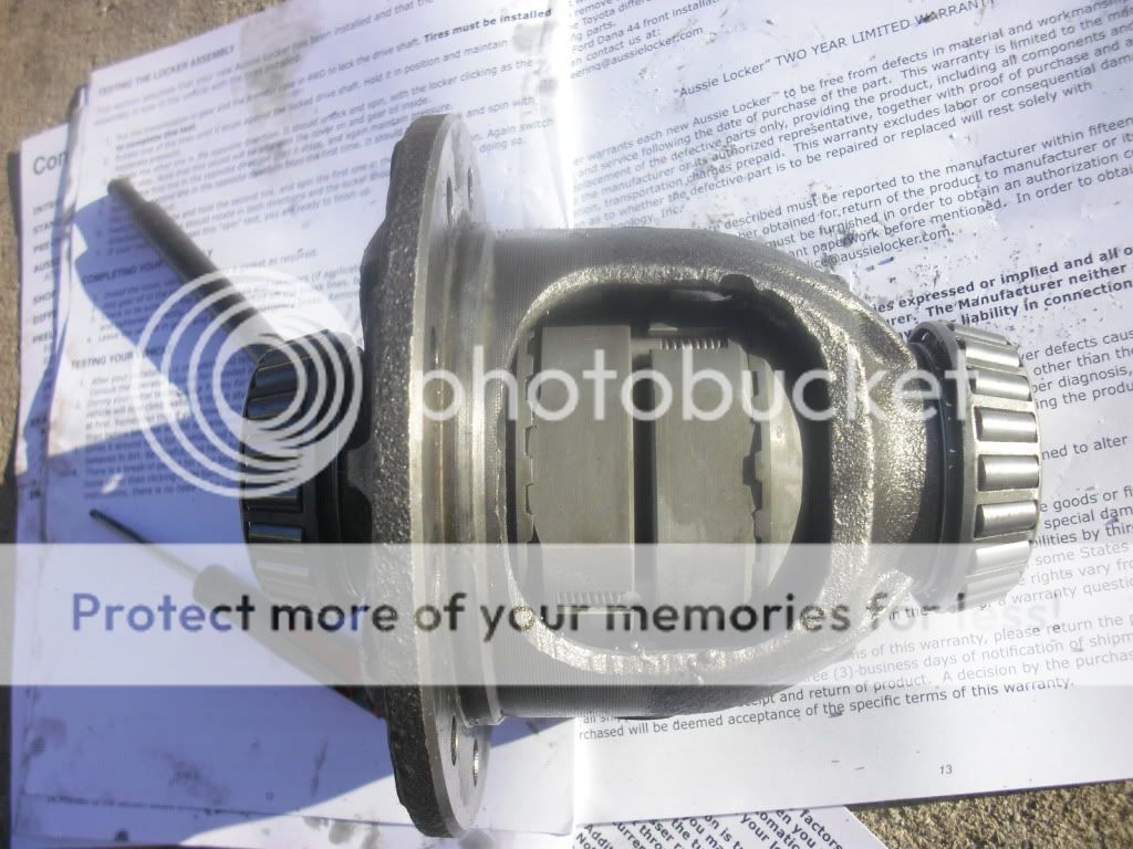

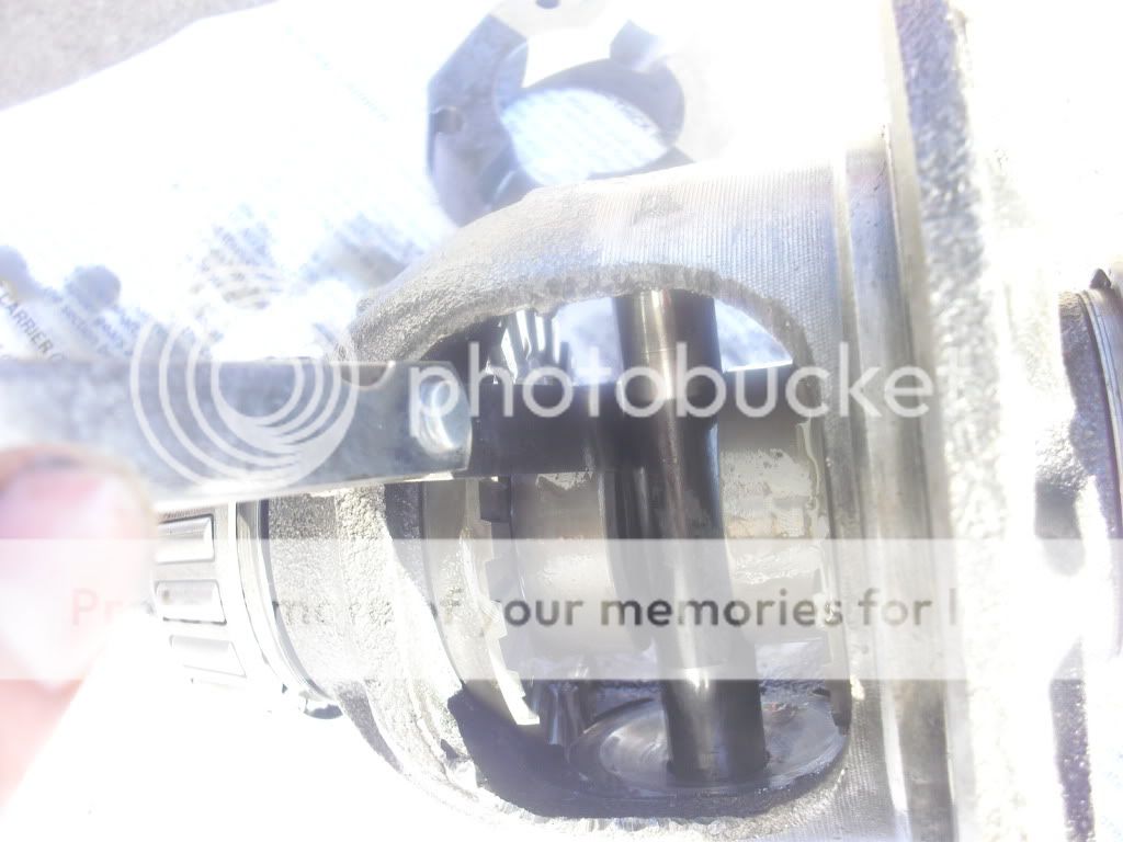

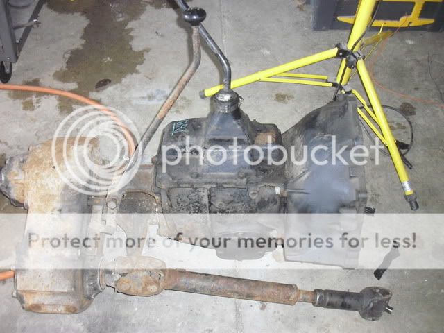

just picked up the 8.8 for $80 and finished the aussie(in the dana 30) just need to put back the axles and wheel bearings/ tires.got the trans last week for $300 with transfer case and have had this 5.3 in the sierra for 3 months now got the truck off my boss for $400 totaled and have used that to pay for 75% of my parts.(parted it out)

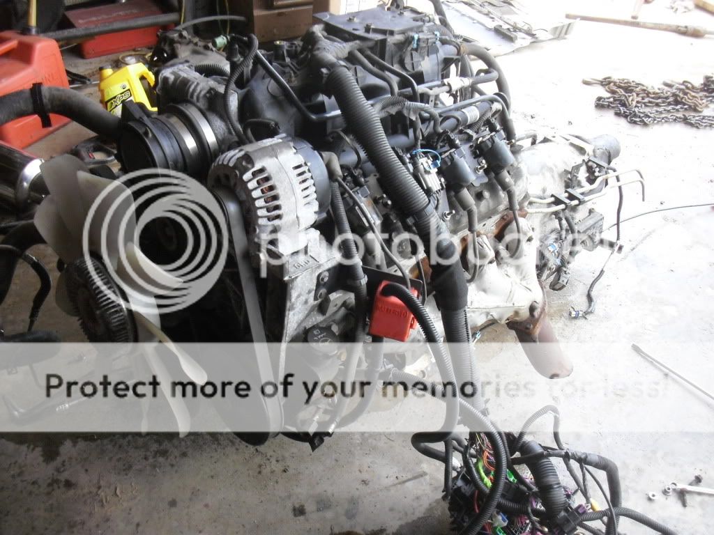

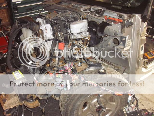

pulling the motor out tomorrow and puting it in the jeep with a buddy. got all week off for this swap.

got it pulled what a pain in the a**

slow going today didnt get to work on it that much just mated the sm465 to the 5.3 and installed used calipers off ebay for $15 and new in box brembo brakes with pads for $70. on the 8.8

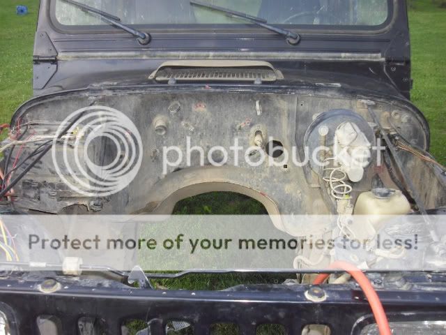

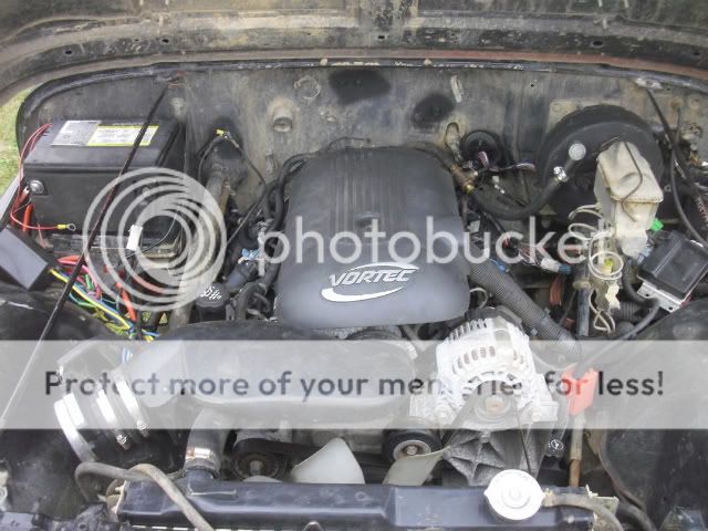

man ive been working out of town too much but i finally got the swap done now and i will post pictures later....for it i used novak adapters engine mounts and they worked smooth. i ended up ordering a bunch of adapters to mate the sm465 to the 5.3 and the np231 to the sm465. it was not bad rebuilding the sm465 for the adapter but it does require a bearing press and snap ring pliers.
as for fuel system(this seems to be a very common question) the guy at novak told me that the 4.0 fuel pump can be used with the swap you just need to set a fuel pressure regulator to 60psi or they have an inhouse setup that i am going with that is pre set.
i simplified the factory wiring harness down myself to save some money and used the factory fuse block ecu and drive by wire pedal, i just slightly modded the pedal to fit.
driveshafts were custom made from a shop down the road from me for $250
total after all was said and done it cost me about $100 to do this swap lol if you take away the money i got from parting out the truck it was in i would have spent around $2000 if you dont count the engine. long story short i used a salvage truck i bought off an insurance company to fund the project by parting it out and using the engine out of it.
