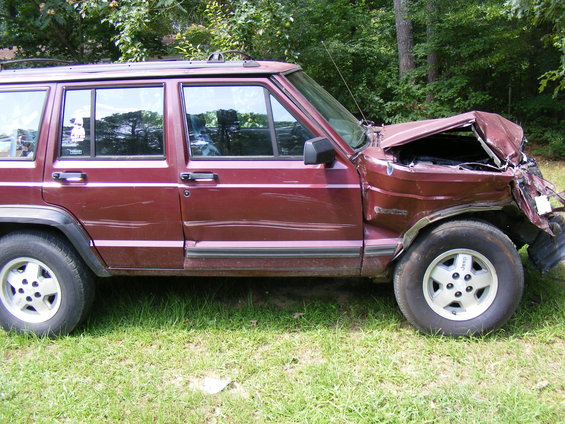

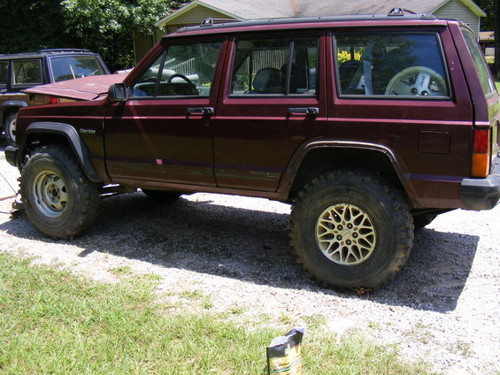

so quick pic of what ill be starting with....
before the teenage daughter...
after the teenage daughter...

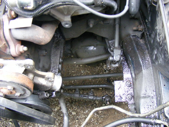

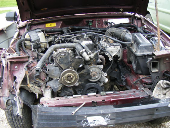

so stripped off a bunch of the bent stuff today to get at the engine...after yanking and prying and cussing I got the front of engine clear retied the cooler lines back together and started it up to make sure the drivetrain didn't get damaged...it didn't....slid up under it to take a look see and see if I could determine the total extent of the damage....in a perfect world id prolly search for a non-running 4wd version and save my self time and energy...and scrap this twisted mangled mess...roof is buckled in at lest 2 places, and the trans tunnel is all jammed up right behind front seats, so hard the paint chipped off...so I look at it like this....after I tube it out in front I can correct the wheel base damage(bent unibody)...once its caged the unibody will basicly be negligible...and it will prolly get all beat to h**l anyways so run what you brung is the flavor of the day....with the exception of some tubing all I need is a 4wd trans for a 231 and a front axle...budget wheeling at its best....already have the extra JJ's laying around...so...oh and I almost forgot I have that set of 34" tsl's...this might come together quite nicely....tubing is cheap...lol...

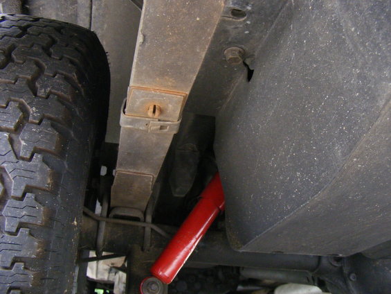

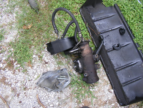

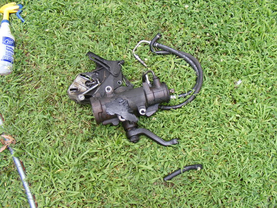

so things are moving rather well today...so far got all the new shocks off and swapped over to the waggy...also got both steering boxes and pumps off...managed to get pump and box off together from the wrecked xj so not a drop of fluid lost...woo hooo...taking a quick lunch break the the waggy gets new steering YAY!!!!!....ive only gotten to drive it twice since we purchased it because both the pump and box were bad, like wind up in the ditch dead bad.....well Ill have pics later...also between the two I have one usable set of swaybar bushings...lol ironic huh...once ive gotten the boxes back in(yes putting dead box back in wrecked xj just to make it easier to move I know waste of time maybe) ill move on to motor n trans mounts....once ive gotten all the parts I need off of the wrecked xj the fun(carnage) will begin...if weather permits I plan on having the waggy drivable by weeks end...well that's all for now I know it seems confusing but it will all make sense soon...I think........however I might just go crazy tring to build 3 jeeps at once.......

ok so I figured it was time for a few pics..
out with the old and raggedy....
the donor box and pump...
whats left of the old sway bar bushings...

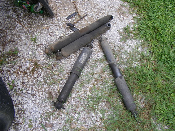

old dead shocks...
new red shocks cause red makes em work better.....
poor xj........

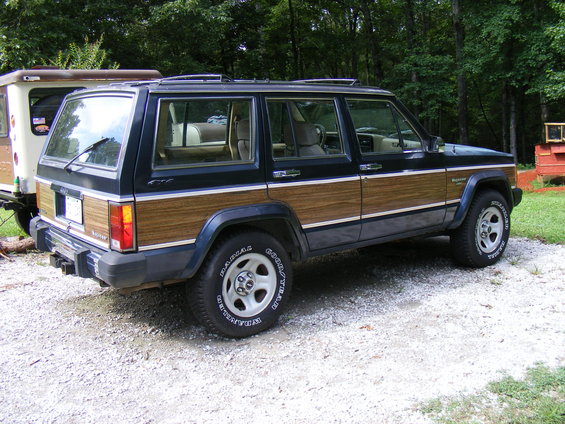

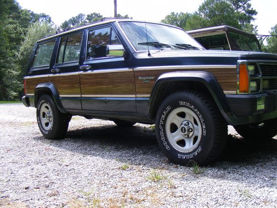

a few good pics of the waggy with its new rubber....and just for those who might not have see it before...

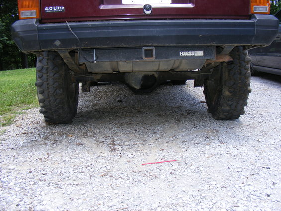

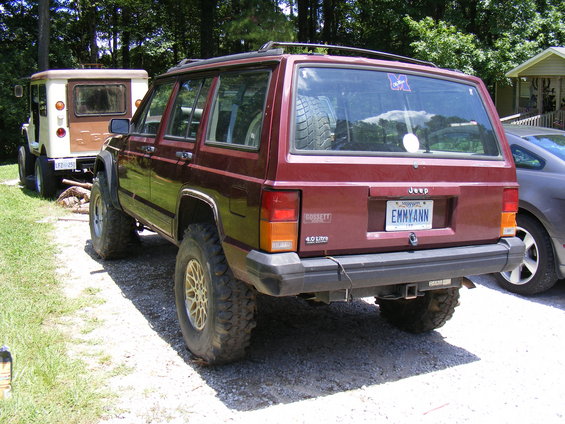

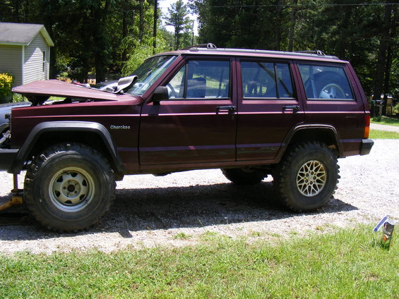

ok so a quick update with a few pics...lol....removed rear flares and trimmed 1/2"(to pinch seam) both rear wheel wells.....mounted 3 of the 34" tsl's to get a basic idea of if i was goint to be able to get by with just 4" of lift and the rest be some judacious trimming....with the front tubed nothing will be in the way and with the boattail rear nothing should be in the way so heres a mockup of what just the 34's and 4 inches looks like before any "real" work....i think it looks pretty good....im hoping that when i got the body manipulated and it all set up i can get away with 3" of lift some boomerang shacles in the rear and possibly get away with 14" of travel(wishful thinking...probably)...ok so on tho the pics...
so as i said this is just a mock up for height purposes only...any thought or comments?
