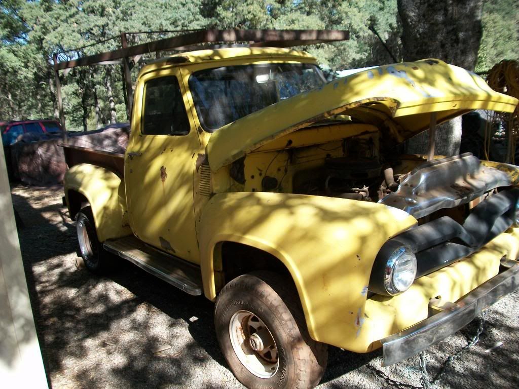

to bad about your jeep. i bet you wish u had a access door in the back to check the pump.
the pic above is of what i want it to look like. i have it stripped down right now.

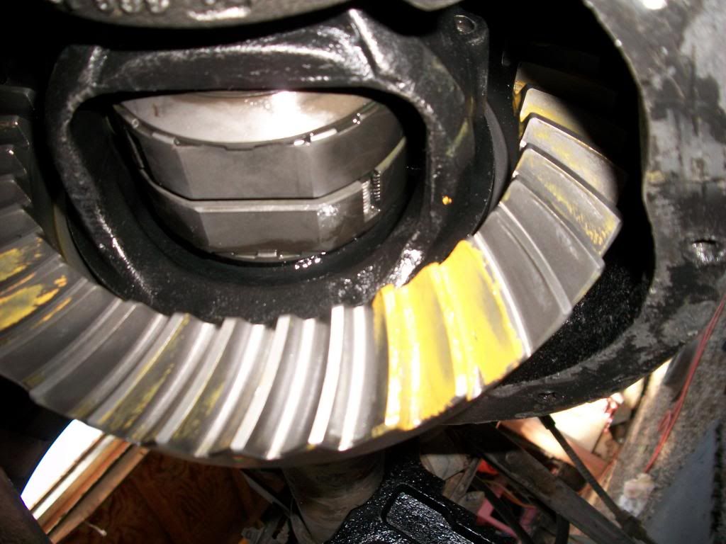

i set the d30 ring and pinion up today. i had the take the carrier in and out a bunch of times to get the backlash in spec. without set up bearings i would have ruined the new ones.
it also took a while to get the preload on the pinion right. the pattern came out great tho. i use to think shops were overcharging to do gear swaps but now i think there reasonable. im sure there faster than me but still takesthem a lot of time i bet.

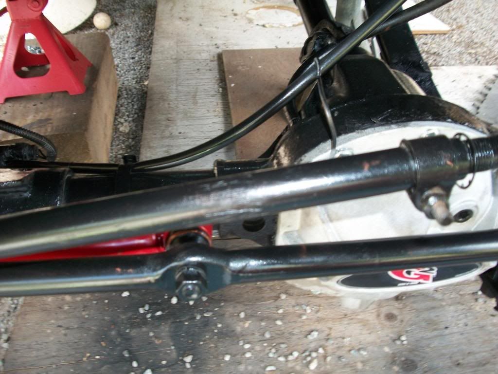

i noticed that my posiloc cable was crushed . i think it gets caught in the tie rod and axle housing some how and does any body have pics of how they routed theres to keep it safe?

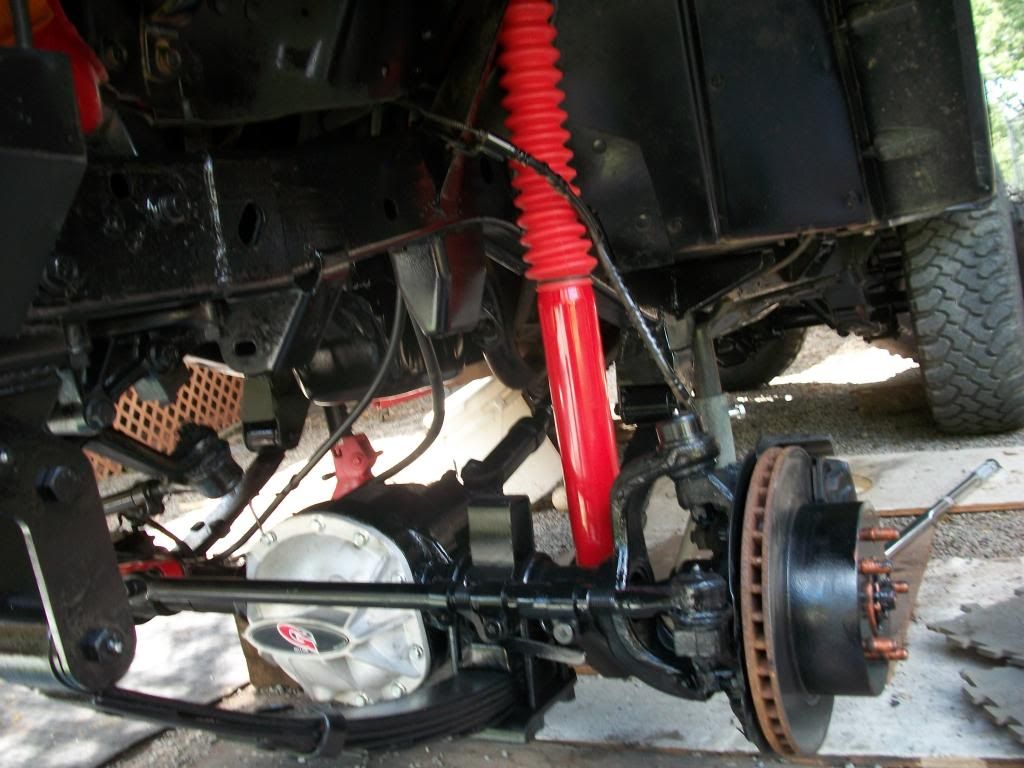

put the new posilock cable in. made a bracket to keep the cable from getting crushed by the steerting stabilizer mounting bolt, filled the diff, painted the shocks and undercarrage.
i took it for a test drive and the 4x4 works great again.
