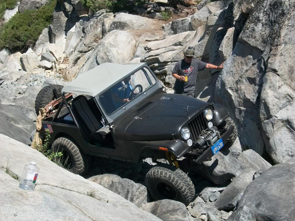

Hey, that black YJ is sure a nice looking rig.
