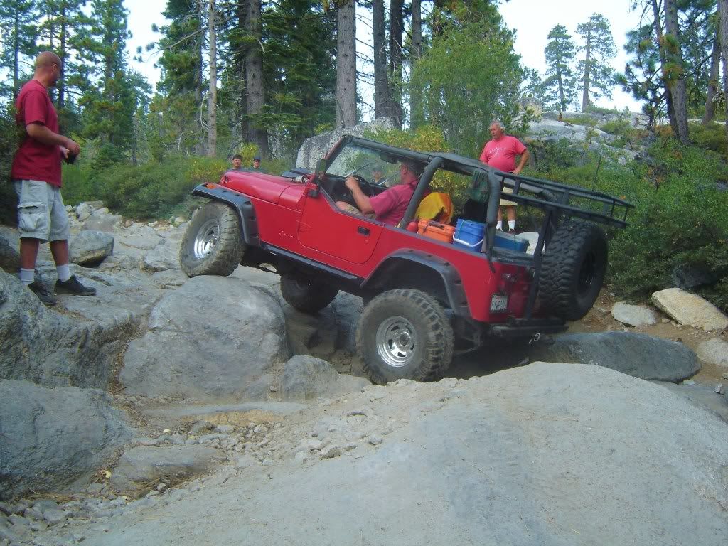

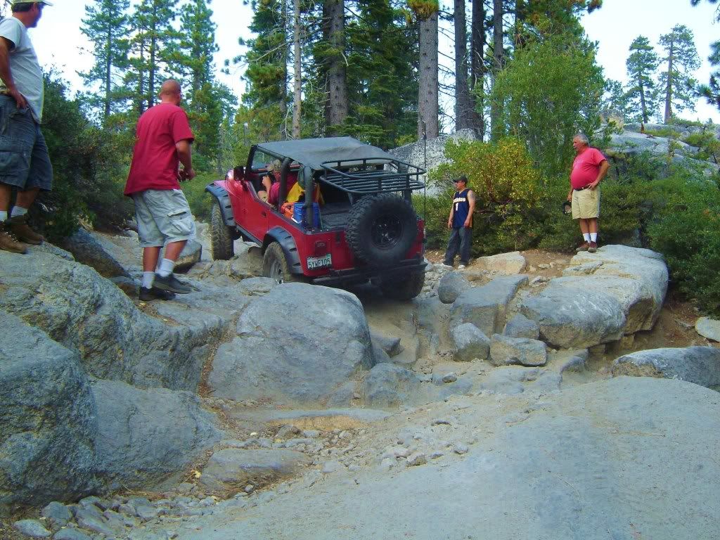

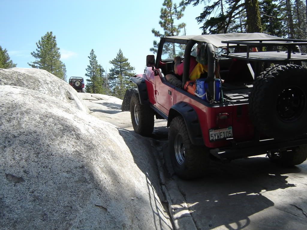

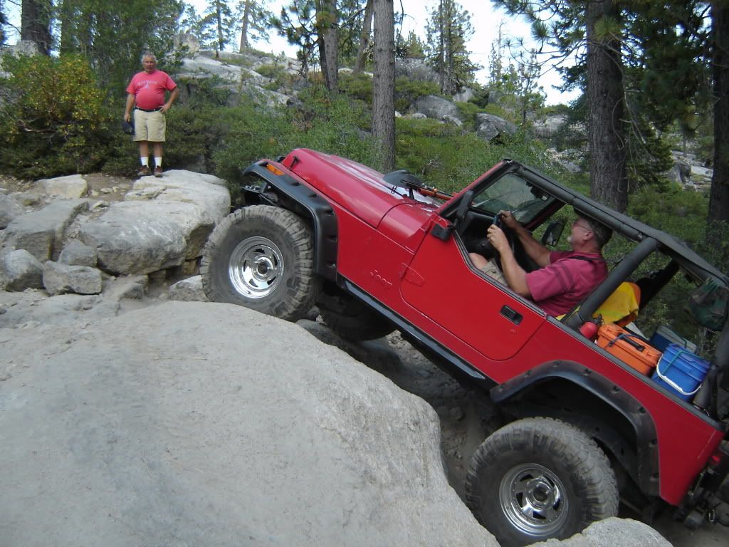

just got back from the rubicon and no problems . next i need to replace the rear springs for the third time, there sagging pretty bad.
