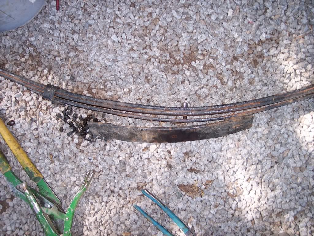

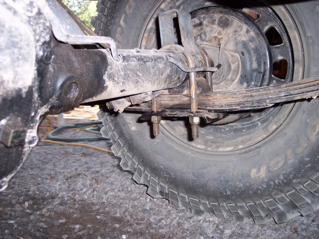

while i had the jeep up i decided to address the rear spring pack(again) the rc rear springs have 4 leafs in the pac. i run with a lot af weight so the 4" springs dont cut it. i took the short lower spring from my old pro comp spring and added it to the rc springs. it raised it up about 1 - 1/4". now i think its finally dialed in. i wont be able to test it untill i get the break parts on. i hope it wont be to stiff. when i jump on the back it seems to compress just fine. i now have a 5 pac in the back.

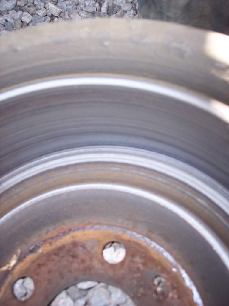

i put the new shoes, springs, wheel cylinder, and drum on today and test drove the custom leaf spring pack. the brakes are great now and the jeep rides just a little stiffer but not bad. i cant wait to load it down and see if i still have clearance between the flair and tire. one 25 cent spring retainer cost me $140.
