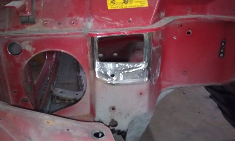

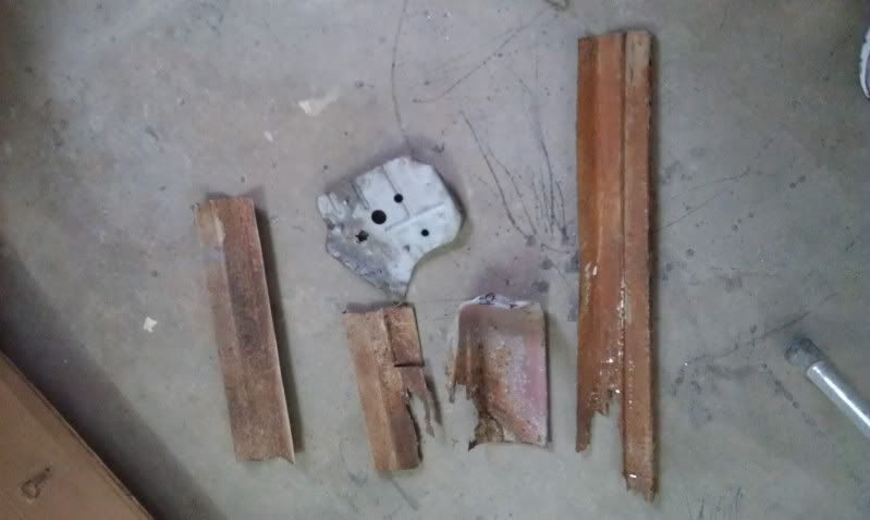

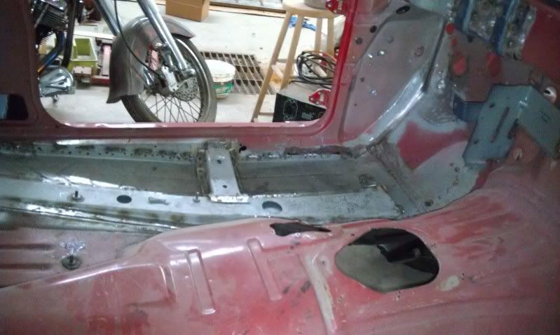

Stopped by the body shop.
Picture of the truck
Floor pans are welded in with frame plate and braces
97+ firewall modifications and brackets
New 3/16" battery mount in the works
Rockers and cab corners going in
Crap.....
While talking about my truck, and the two other MJs in the shop, my body shop guy continued to express the poor fit of the C2C floor pans and rockers. The MJ rockers are tapered and has a totally different rear floor shape. He indicated the only positive of the C2C parts was the metal quality. We also discussed water proofing the cab at length. When it is done, there should be no water problems.

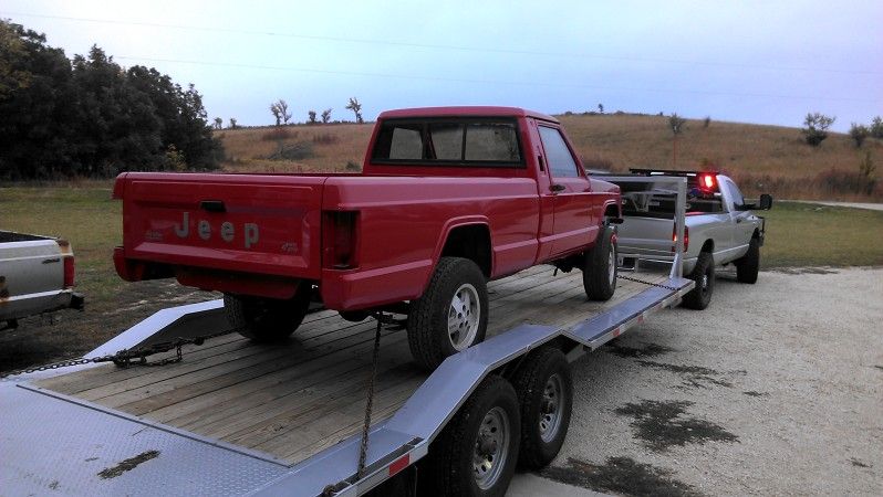

April 2011 to End of 2013..... IT IS FINALLY BACK!!!
It has been a long time coming, but the results make it oh-so worth it. I picked the truck up from the paint shop, drove to the hanger and attached the bed, then drug it across the county to my garage.
Now, how does it go back together?
