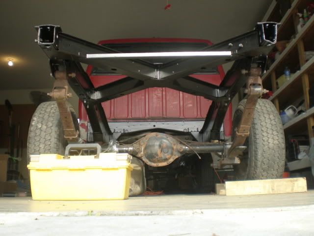

Inside the rear frame rail:
Inner the frame rail, floor pan will cover this: (yeah, I know its dusty)
Then a lot of sanding and two coats of Chassis Black:

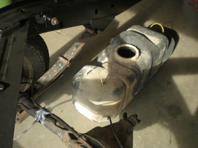

Also picked up a 22 gallon Dakota OBDI fuel tank, should be almost bolt in with the 99 XJ pump and sender:

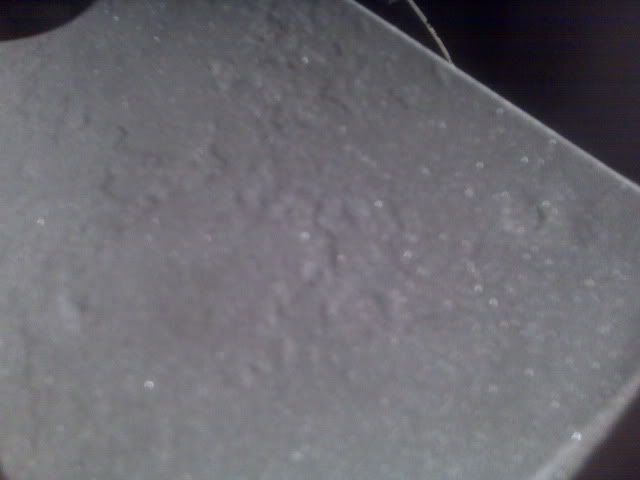

Sandblasted with used 40/60 Black Diamond
Even after blasting the wheel, the finish was very irregular

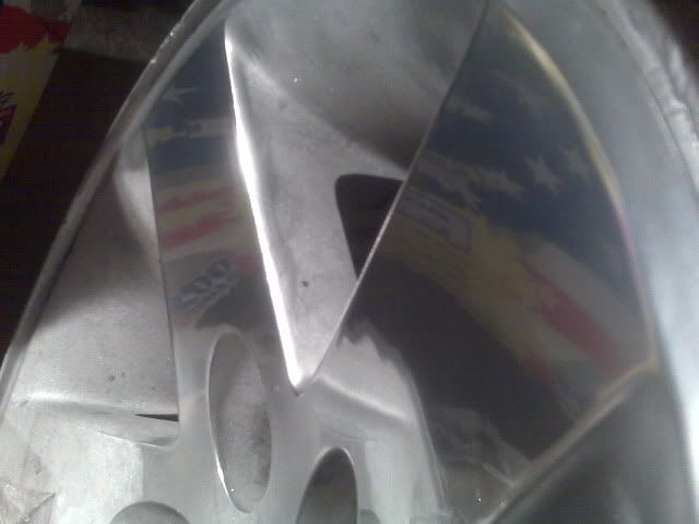

I attacked the wheel with sand paper. 80, 120, 180, 400, 1500 then 2000 wet sanding. Quick polish with harbor freight white and red bars and some Mothers Mag polish
My plan is to polish the flat face of the spokes and bead then use a finer media to texture the inner edges and lips. Clean it up real good then shoot with clear. Comanche is going to get some *bling*
