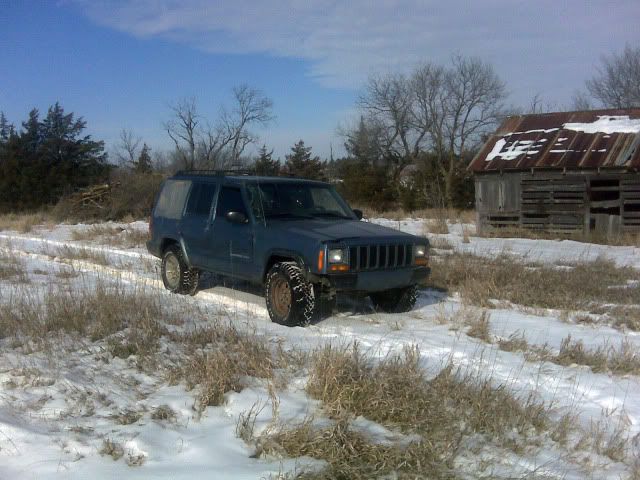

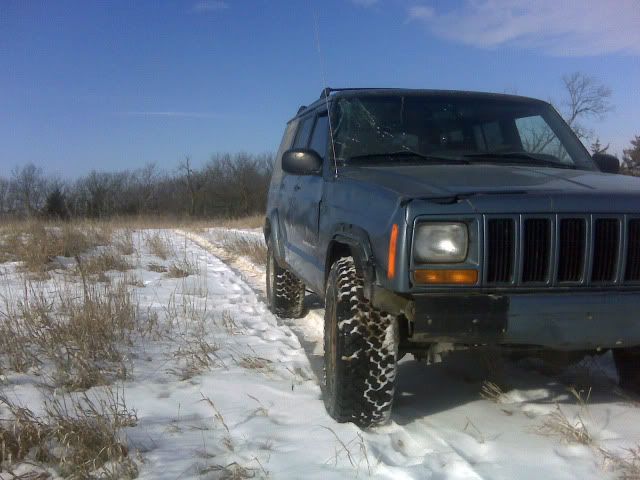

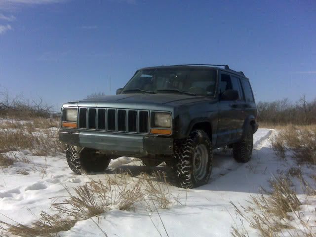

Picked this beauty up from a little town near Columbia, MO.
1999 Jeep Cherokee
- 4.0
- AW4
- NP231
- 8.25
- Cruise
- 155,100 miles
- New 235/75r156 tires
- New AC system
- Rolled on its side into a ditch
- Exhaust cut right after Catalytic Converter
- Shot front axle outter shaft u-joint
Interior is in good shape less the stale aroma of old cigarettes. Ran around the farm today. Never got hot and the auxiliary fan seems to work like it should. Now it is time to get serious about this MJ project!

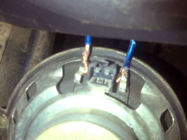

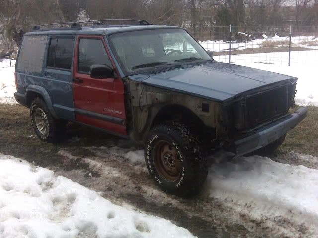

December 22, 2009

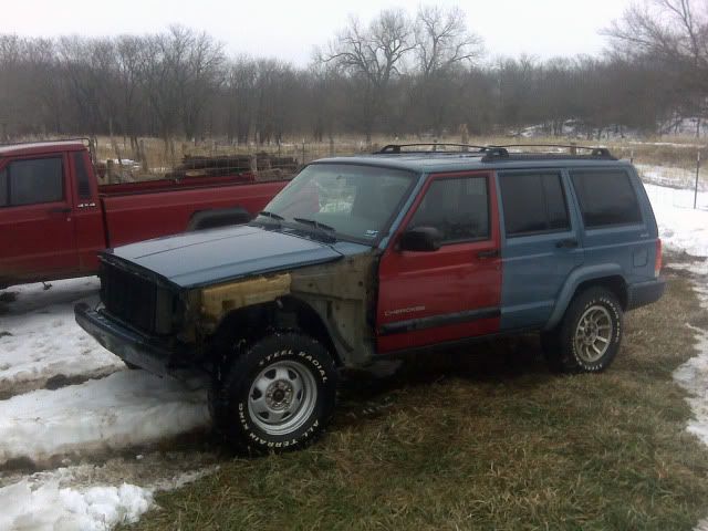

I spent the day working with the donor.
My first order of business was to remove the front sheet metal that was bent/banged up. The findings:
- Both front fenders junk
- Header panel junk, bezels in good shape
- Hood perfect
Then I decided to install the doors I picked up earlier this year to make sure everything works (locks, mirrors, windows). To my surprise they all worked flawlessly!

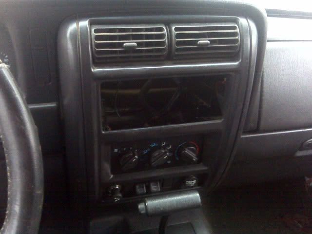

I then removed the stereo. There was an electrical nightmare of exposed wires, poor splices, and a hot amp wire in the cargo area. Yanked all of that out and threw it in the junk pile. I will be running a factory XJ head unit in here eventually.
Image of the vitals:
Took it for a spin down the county road and tested the cruise control. To my amazement, it too worked flawlessly!

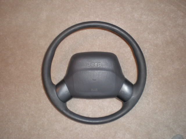

Picked up a steering wheel from a local club. The XJ's wheel is missing 1/2 of the leather wrapping.
