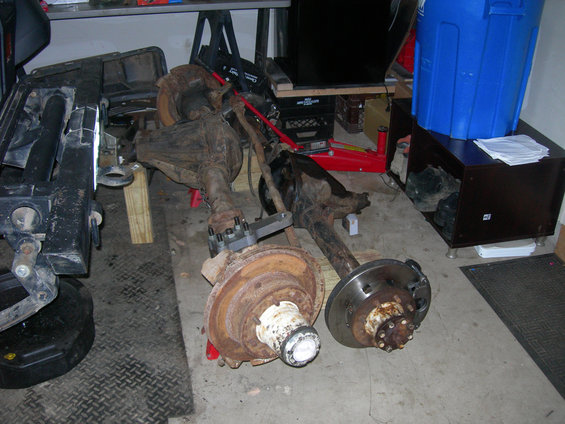

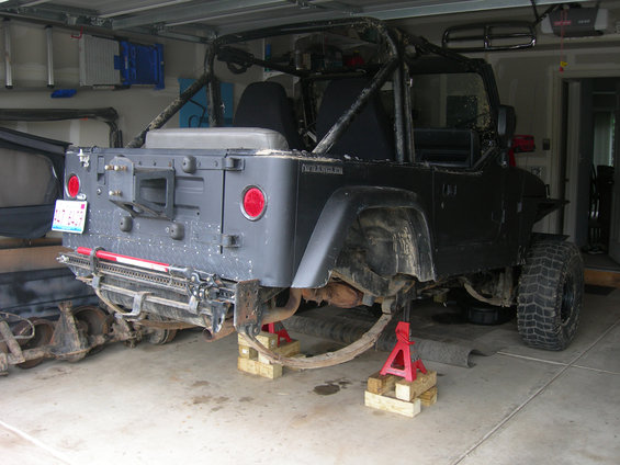

Yesterday, I pulled the rear axle out first:
Old axle, going to the scrapper:
Next steps are to strip the paint of the rear of the frame and coat with some POR 15. Put the SYE kit from JB conversions on and lose the transfer case drop spacers. This isn't going to be the fasted build, any free time from the job and my newborn, so be patient with me.

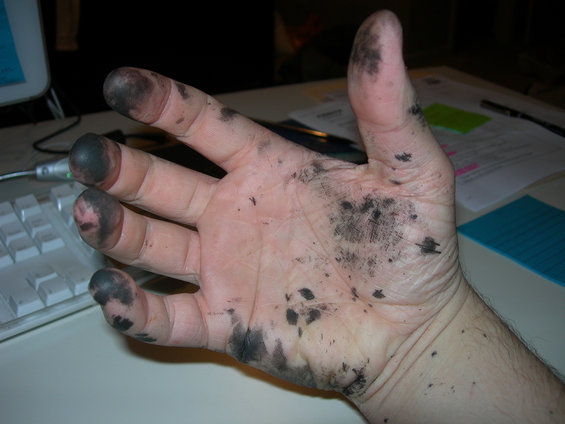

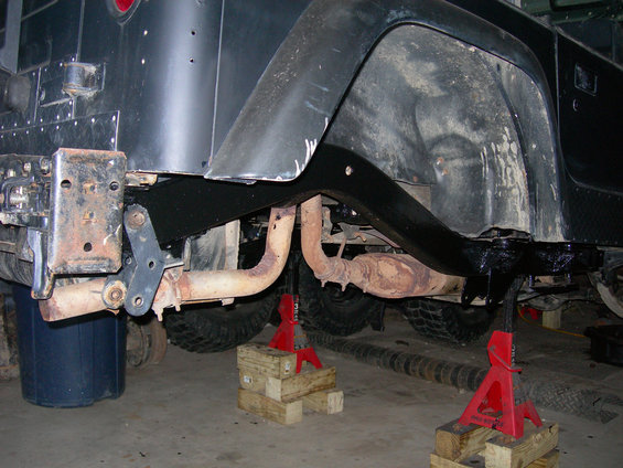

Stripped the rest of the rear frame and painted with POR 15.

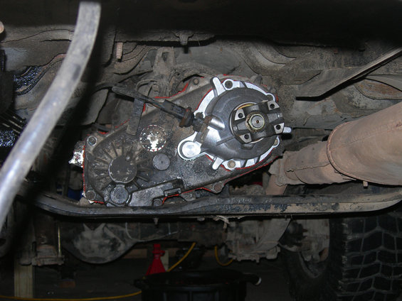

Installed my SYE kit, with the transfer case still in the vehicle, really didn't make it any more difficult.
By the way, POR 15 doesn't come of your hands! Where gloves!

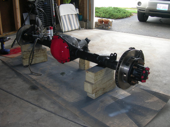

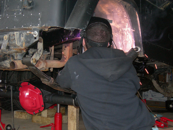

Got the rear axle all welded up, primed, painted, and bolted in. I also welded on the shock towers. Over all it was a good weekend.
Axle, with my imitation ARB cover:
Me, burning in the shock tower:
Installed and back on the rollers:

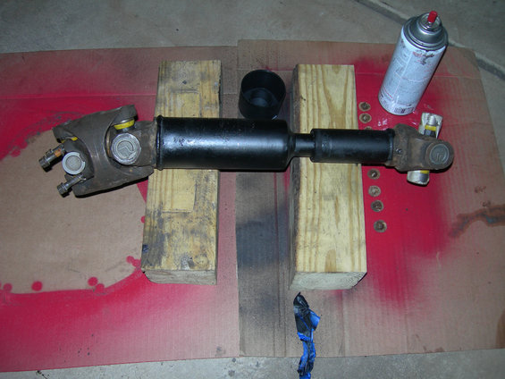

Last weekend I built the rear drive shaft. It was the front drive shaft from the 78 F250 above. I cut it down, welded it up, smoothed it all out to try and make it as balanced as possible (fingers crossed).

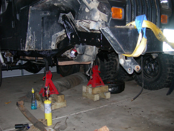

I have been super busy the past couple of weekends. But this weekend I managed to get some time in the garage. I pulled the front axle.

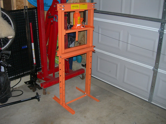

I also purchased a 12 ton press. The bushings on the wagoneer springs are incredibly hard to get out, I have tried it all. So I bought the press, figured I would get some more use out of it (future gear swap?)

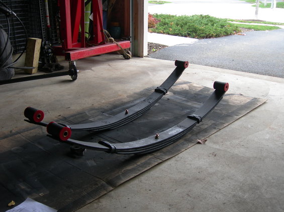

I built my front spring pack, wagoneer front springs with some chevy springs added. Got new poly bushings and painted them up.
I have the D60 under the front, the front spring perches are a little off, do you guys drill out the center pin hole on the perch or just make it work?
