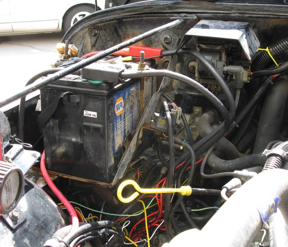

Got a new mod installed this week.
Here's a pic of what I started with...
Here's what I ended up with...
It's the Rugged Ridge dual battery tray, and I'm running a pair of Autozone Gold series batteries. My old battery never failed me at all, but with a winch, a lot of lights, and my tendency to wheel alone, I wanted a little extra oomph for all those accessories. It also helps that I had $50 in Autozone gift cards, $120 worth of credit on my Autozone account, and a coupon for $20 off $100. I got both batteries for $50 w/o turning in my old one. So basically...dual batteries for less than $200 with the tray, batteries, and wiring! That's hard to beat I think!
As you might notice in the picture, I didn't run a relay or disconnect between the two batteries. I just wired them in parallel and called it good for now. Eventually I may get around to doing something different, but for now I think this setup will work well for me.
As for the tray...well...the instructions leave a lot to be desired, and either my Jeep is a little tweaked (Certainly possible at its age), or their bracketry isn't quite correct. After a little work w/ the hammer I was able to get all the holes to line up and everything tightened down. I will say that it's extremely nice that the tray kit came with a bracket for the relays and such. You can see them mounted on the front left corner of the tray. I'm very, very happy about how cleanly they mount to the new tray. Things I didn't like so much...having to hang the ignition coil by one bolt rather than two because it interfered with my new batteries and having to relocate some other stuff w/o having clear instructions. That said, the ignition coil relocation may be due to my battery choice. The stock batteries are much, much smaller than the ones I chose. I did a bunch of measuring, looked up sizes of batteries on Autozone's site, and then went to Autozone with the tray and did a test fit. These batteries barely fit, and I'm only running two hooks to mount them rather than the three that the tray came w/ since there's not room between them. Perhaps with two stock size batteries (which are smaller in every dimension) the ignition coil would not need to be rotated slightly.
Anyways...this is a rambling but I wanted to include details of my experience since I couldn't find ANYTHING online about someone else installing this tray in an early YJ. If anyone has any questions about the it, feel free to ask.

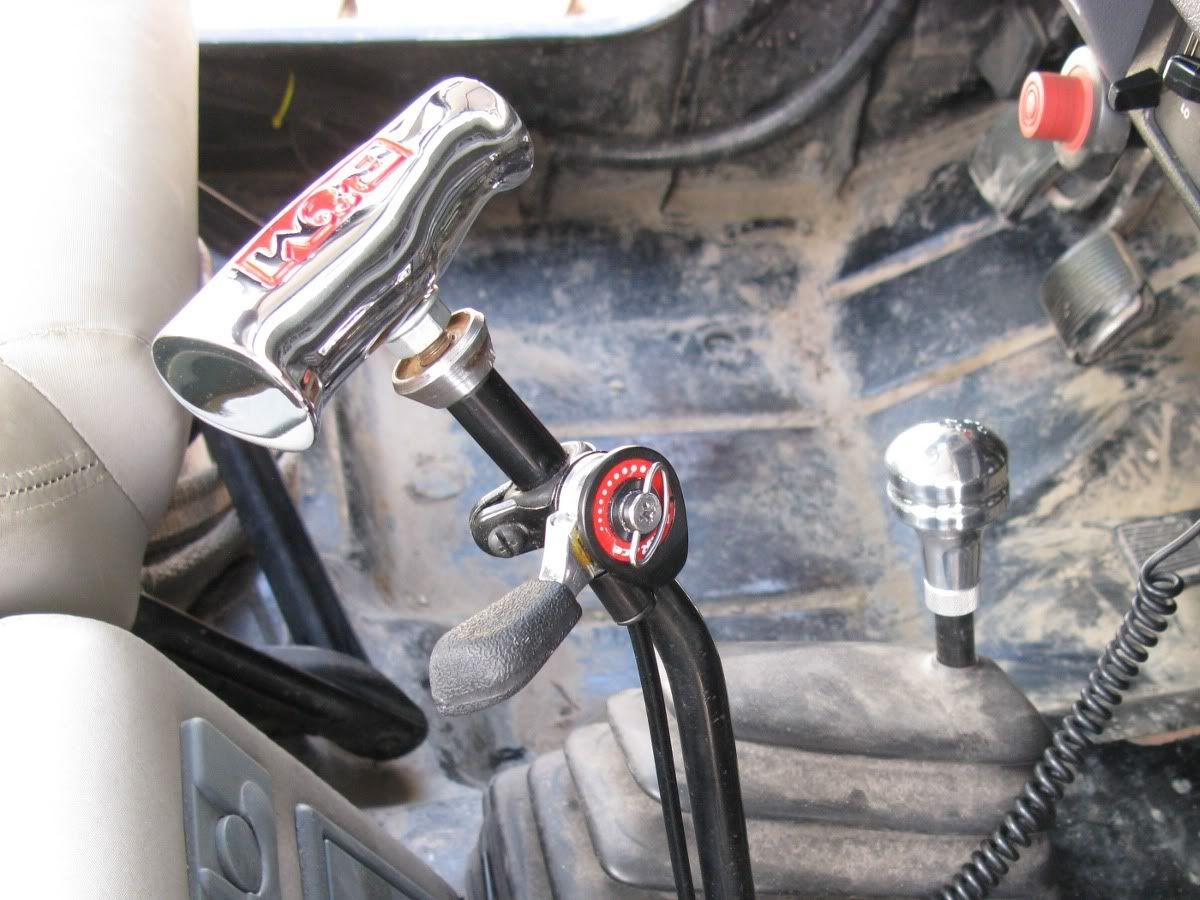

Here's a pic of the aluminum shift knobs my brother got me for my birthday, plus my hand throttle. I am still tweaking on the hand throttle and need practice on using it smoothly, but I really like being able to use the throttle, clutch, and brakes at the same time while wheeling.

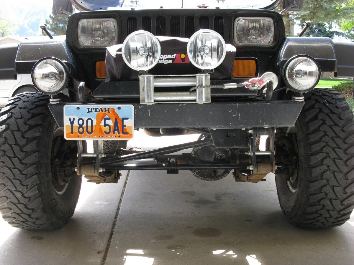

Here's a pic that shows a bunch of mods...
The most obvious thing is probably the lights. The lights on the fairlead are Hella 500FF fogs. The lights on the ends of the bumper are KC Daylighter 130 watt driving lights. The headlights also aren't stock. They're IPF housings with fatboy bulbs.
The Rugged Ridge winch cover is keeping snow and rain away from my Engo 12,000 lb winch. I got it last summer from Chris at truckaddons.com. He was great to work with. I haven't gotten the chance to use the winch for recovery yet, but I hope to soon.
The bumper is still stock, but it is cut down for looks and clearance.
The SOLID diff cover for the Dana 30 is also visible, as are all of my steering mods. There's a Rugged Ridge steering box skid plate, a Rough Country steering box brace (barely visible), Rugged Ridge HD steering system, and Rancho RS5000 steering stabilizer.
I've heard a lot of negative things about the Rugged Ridge steering, but I haven't had any issues yet. It's way way beefier than stock and it cost me less than $200. If money weren't an object I'd have gotten the JCR setup and drilled my knuckles, but I don't have the tools required for that install, making it cost about double what this one does. If I run into issues with this steering setup then I'll admit that going the cheaper route was dumb, but for now I'm satisfied and much less worried about tearing up the steering on the rocks than I was when I was running stock stuff.

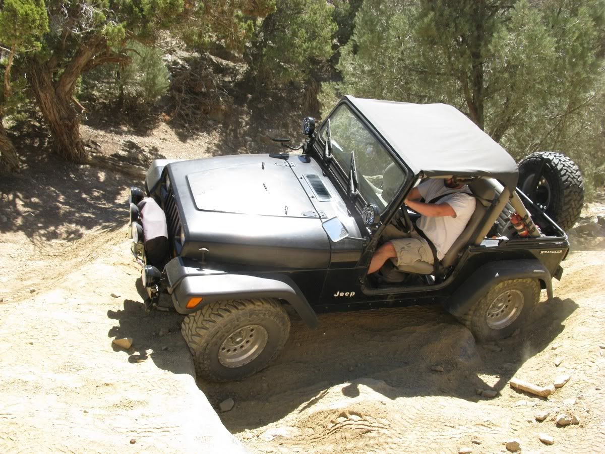

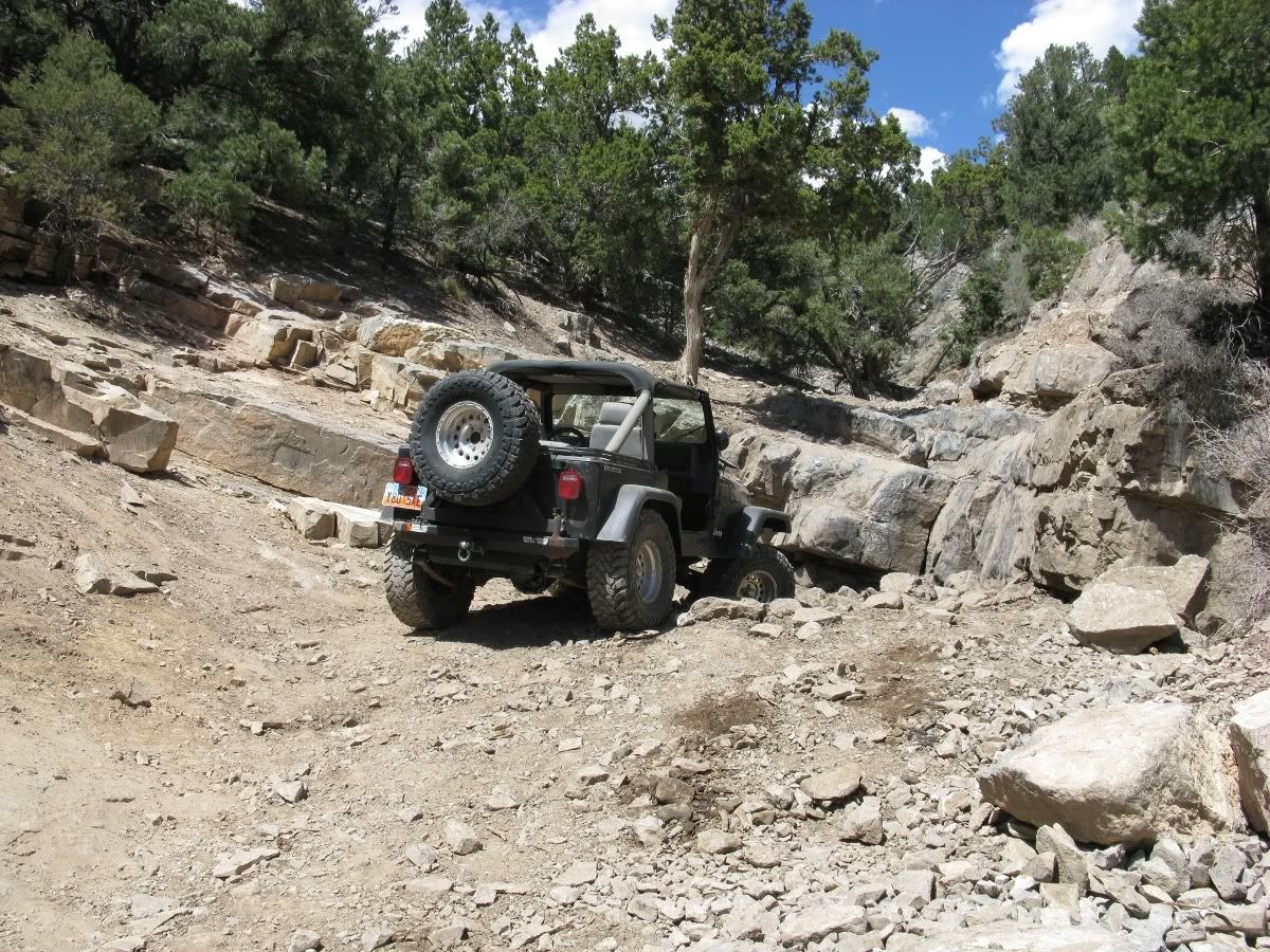

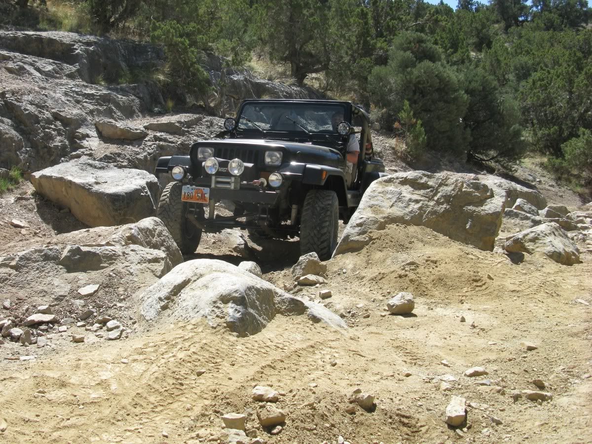

I went wheeling with a friend and his neighbor yesterday and had a great time. I beat the crap out of the Jeep and nothing broke, which always makes for a good day. I did add some rock rash to the rims, rocker armor, flares, gas tank skid, and the tub behind the left rear wheel. Nothing major though. We ran Rattlesnake and Constrictor. Rattlesnake is a 3 I believe, though there are some fun optional lines that ratchet up the intensity a bit. Constrictor is probably a 4, though Eagle's Nest (the last obstacle) is a 5. It's a 6+ foot wall that most buggies get denied on. There's a winch anchor at the top of it, and maybe after I get a real belly skid I'll try winching up it, but for now I was happy to make it to that point unassisted, as there are some nasty obstacles on the trail to that point that I wasn't sure I could conquer with the front still open.
The pics aren't that great because I can't take them and drive at the same time, but here's what the other guys did get of my rig in action...
All the pics are on Rattlesnake except the last one. The last pic shows my Jeep parked at the base of Eagle's Nest. My Jeep isn't huge by any means, but still...that wall is a good 3 feet higher than my hood.
