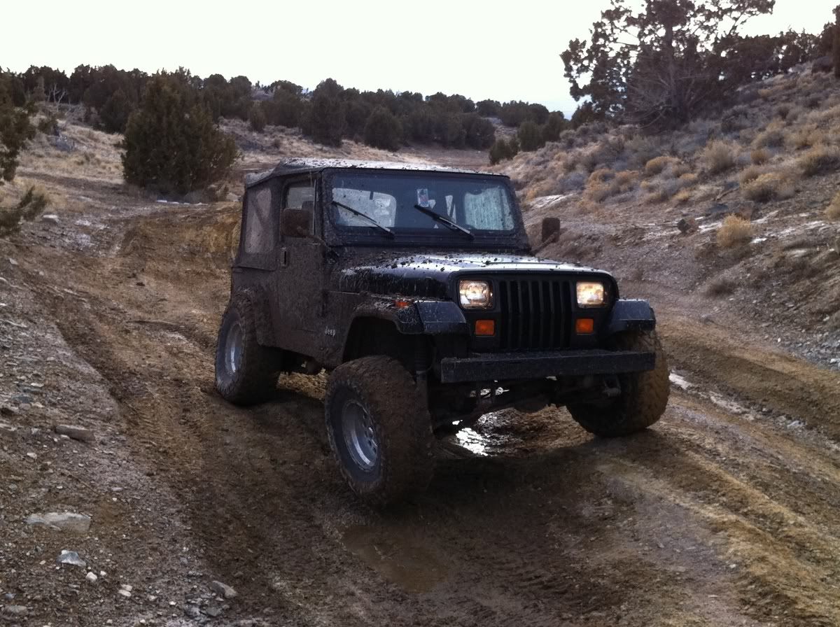

Here are a couple pics from the first time I took it out wheeling. I know they're not that exciting, but it is hard to get good pics while driving. Check out that awesome flex!!

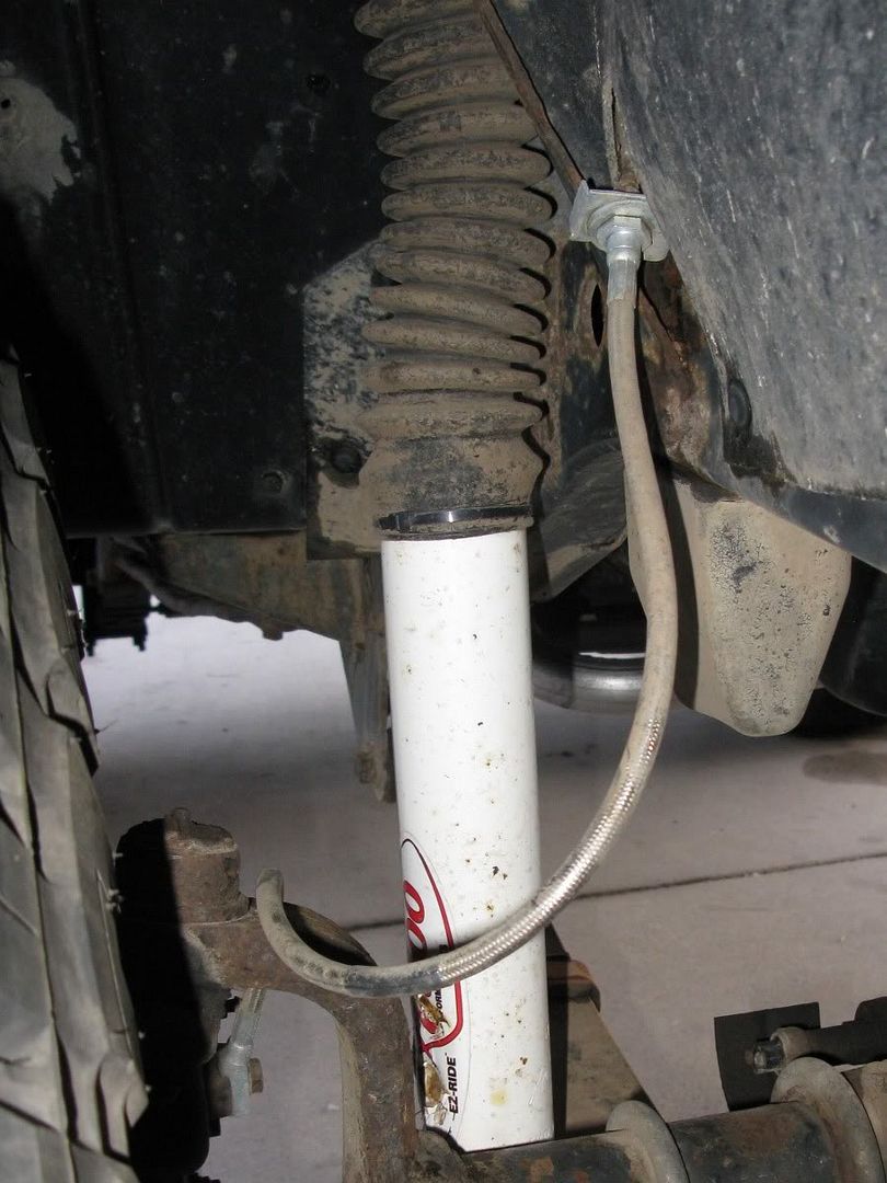

As I mentioned before, the Jeep was lifted when I bought it, but for some reason the PO was still rocking stock brake lines. After seeing how close they were to ripping, I decided they needed to be upgraded...
The fronts were easy...
The rears required a little more work since I have a Ford 8.8. I used a brake line extension made for the Jeep, but then bent my own lines to go from each caliper into the distribution block on the axle. The stock Ford brake line was one piece from the passenger side caliper all the way to the distribution block, so I just bought another driver side line and bent my own metal tubing to run over to it. You can see part of it in the pic. If anyone has questions or wants a pic of the passenger side setup, I can post one.
I plan on reworking the metal part of the lines eventually. They're pretty well protected by springs since I'm still SUA, but I'd still like to move the lines to the top of the axle to make it harder to snag them on rocks and tree limbs and such.
