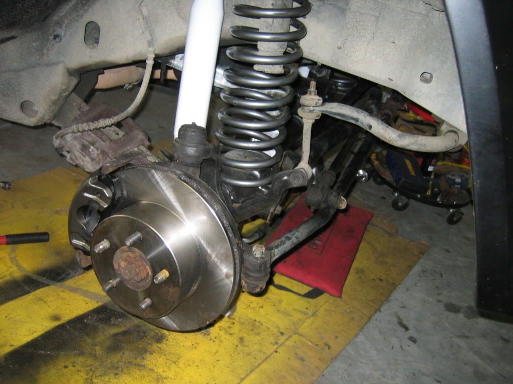

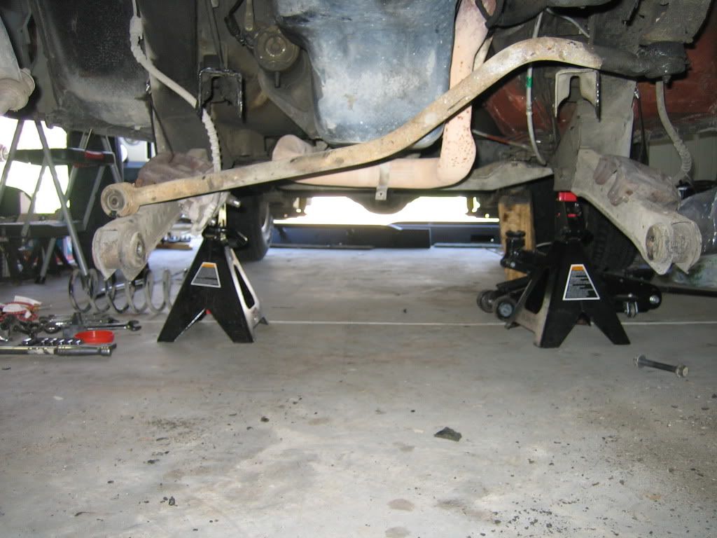

I got the front 2wd axle out:
Got the new Dana 30 in with new rotors, calipers, pads, coils, shocks, steering from the donor and a ZJ sway bar:
I'll disconnect the old caliper when I'm ready to bleed the brakes.

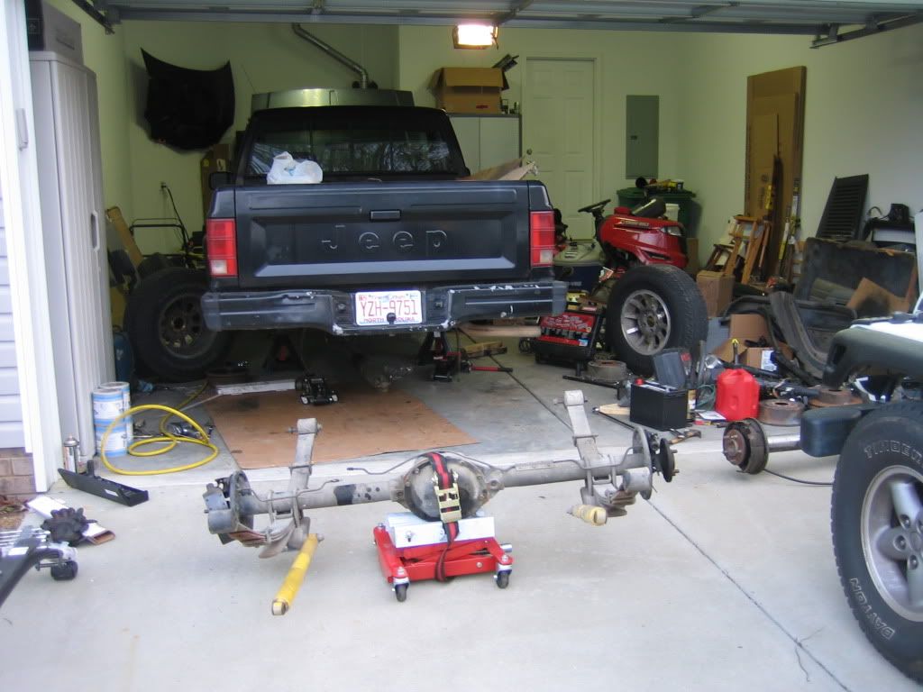

Got the old Dana 35 out too:
I got the 8.25 mocked into place, but forgot to borrow an angle finder, so I haven't set the pinion angle yet. I decided to put it on all fours to see how the lift looks:
Hopefully I can get the pinion angle set and get the perches welded on tomorrow. Then once I get it bolted back in, I'll have to do the rear brakes. I'll do a shake down run with the current transmission to make sure the lift and axles are good and then I'll tackle the 4wd transmission and transfer case.

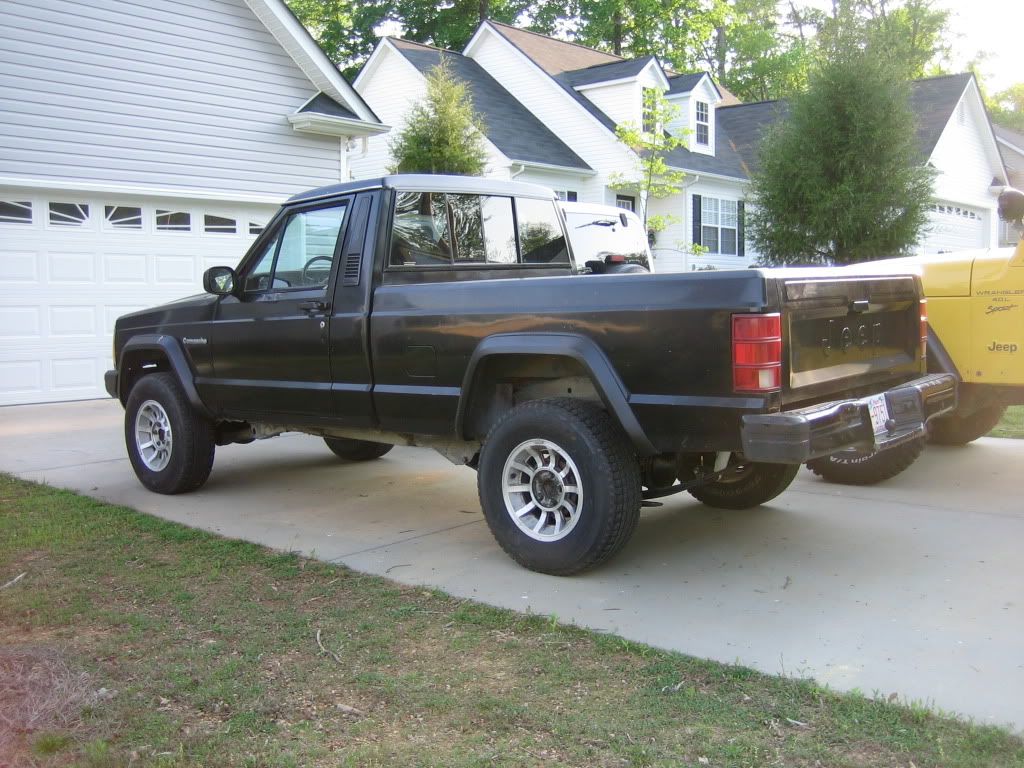

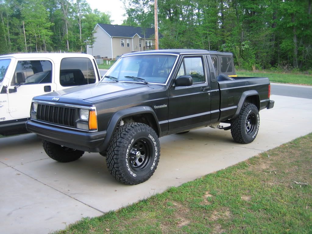

Well, the axle swap and lift is done. Here is the result:
I picked out the tires I wanted (Goodyear Duratracs), but couldn't decide on an alloy wheel that I really wanted to spend $350-400 on, so I think I'm going with some steel wheels for now; I might paint them gunmetal, we'll see. I'll order tomorrow and hopefully I can have them the first of next week.

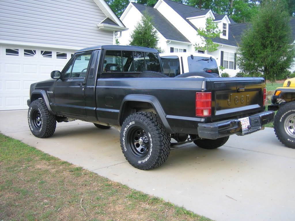

Here are the new wheels and tires!
After the 4wd axle swap I have a vibration at anything over 50mph (before and after the new tires). I just had it aligned too, so I know it isn't that. I'm going to try replacing the driveshaft u-joint this evening and hopefully that will cure it.

Gah! White lettering on the tires! Otherwise looks awesome.... Wish it was mine!

man that looks good

love the white letters! haha. to each his own.
great mj build. came out real nice. any plans to paint the soft8s gunmetal?
Thinking about it, but probably won't do it until after I paint the truck.
