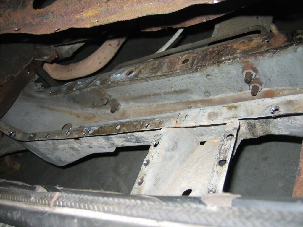

Well, the floor has been trimmed and the new pan is going in tomorrow morning. Here's one last shot of the Flintstone mobile:

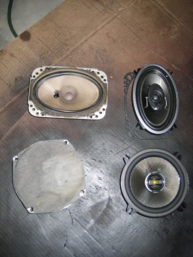

I decided to go ahead and start upgrading my audio, so I ordered some new speakers. Pioneer TS-A4672R & TS-D502P:
I hooked them up and with the factory stereo, they kinda sounded like garbage. So, I'm going to order a new head unit tonight.

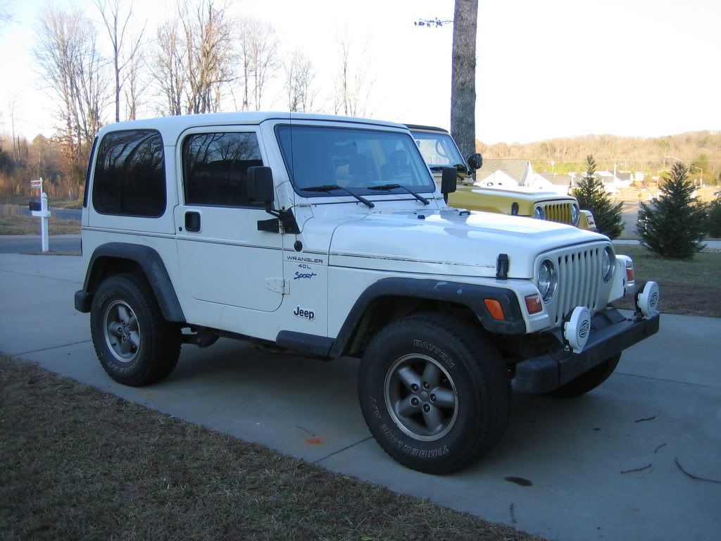

Oh, I sold my car (extra cash for the MJ), but they guy paid me in $100s and a TJ:
I'll be fixing this one up and reselling it so I'll have more money for the MJ and my other TJ.

Good looking trade! I love the rims on those! I'd sell it like it is if runs good!

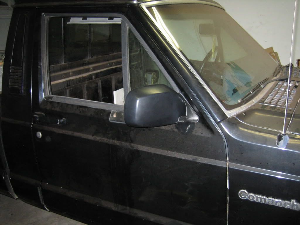

Got my '97 style Ebay mirrors. Now I just have to figure out what I'm going to do about the space where the old ones were mounted.

Progress has been slow. A little more work has been done on the floor, but its still not done (I need to learn to weld....). The headliner and visors have been recovered (not installed yet). I got a new slider for the back and pulled a couple things from the junkyard (transfer case linkage and front drive shaft for the 4wd swap mainly). Speaking of.. I'm moving forward with the swap. I'm picking up my axles this Saturday '96-99 HP Dana 30 and '97-'01 8.25 with 3.55 gearing.

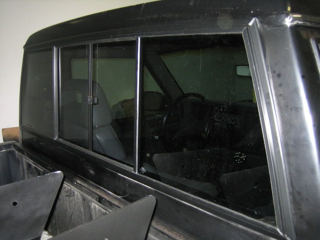

Here's a shot of the new rear slider:

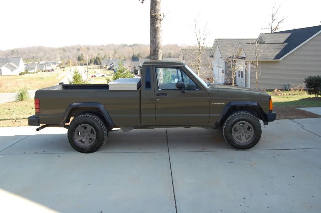

I did this photoshop to get an idea of my end goal. Haven't completely decided on the color, but I'm leaning toward Jeep Dark Khaki Metallic. I might something else completely by the time I pony up the $ to have it painted.

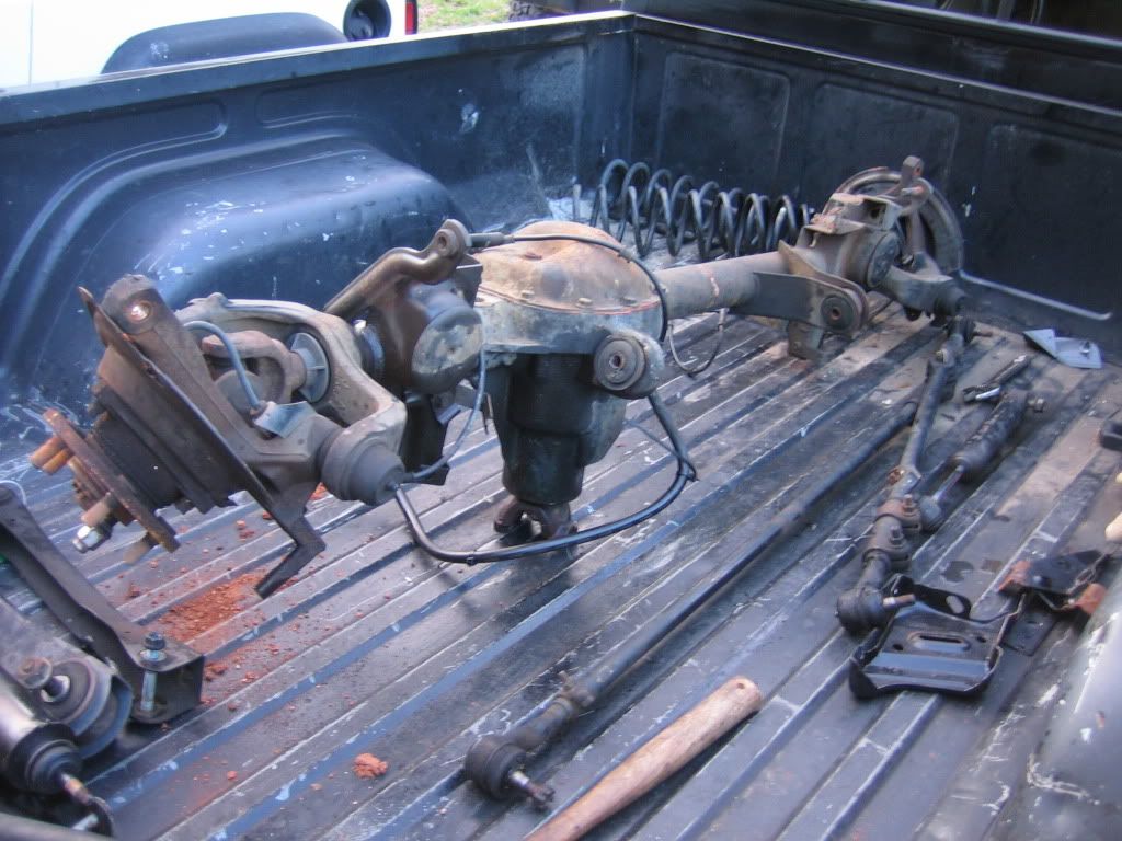

Here's the new Dana 30. It came with all 4 control arms, shocks, springs, track bar, steering linkage, brake rotors and I assume those are abs sensors (even though I asked for no abs, no big deal).

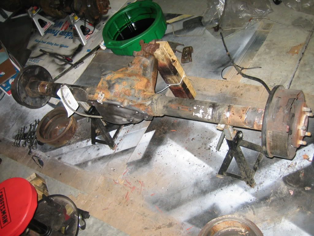

And here is the 8.25. I cut the old spring perches and shock mounts off last night. New spring perches are on the way.
The swap shouldn't be too bad. I've never dealt with drum brakes before, so I've got a little reading to do to get the cut e-brake cables out. I'm hoping I can just use the ones already in the truck. Any reason why I shouldn't be able to?

Did you ever find some new perches? If not, I've got the old ones off my diff. The brother in law did a pretty decent job cutting them off. Very usable and free.

Wheelin and dealin! Extra TJ for sale good one!
I ended up ordering the Mopar ones from Summit like you suggested. I ordered them Tuesday night and they'll be here today. When I cut my old ones off, I did pretty well with one and could reuse it, but the other, not so much.
I'm going to prep the axle tonight and hopefully get the new ones welded on tomorrow. We'll see.
