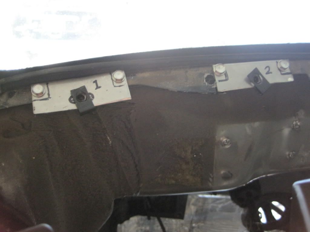

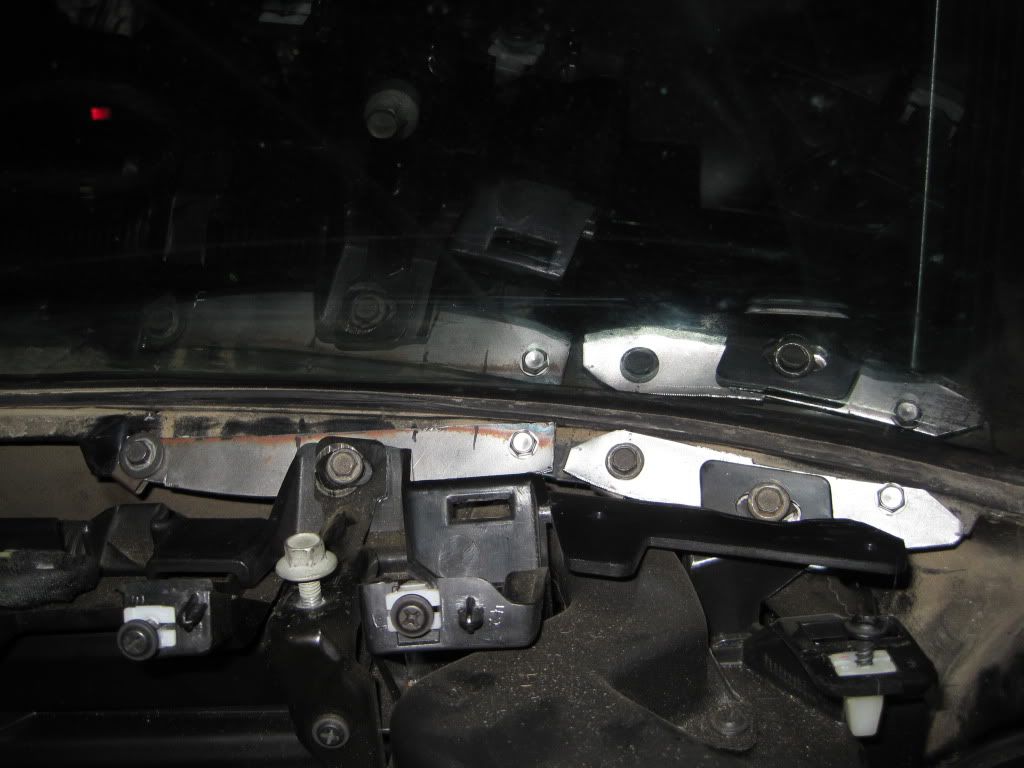

Here are the first two brackets I made the other night:
I was trying to reuse the existing bolt holes. They work just fine, but they look ugly; I may redo them.
Here are the others (well two of them):
The squares in the corners kinda show where the dash tab fits between the two bolts and you can see the elongated hole where the mounting hole is. When I mount them permanently, I'll grind down the edges and corners up top so it doesn't rub on the windshield molding. I'll paint them of course too.

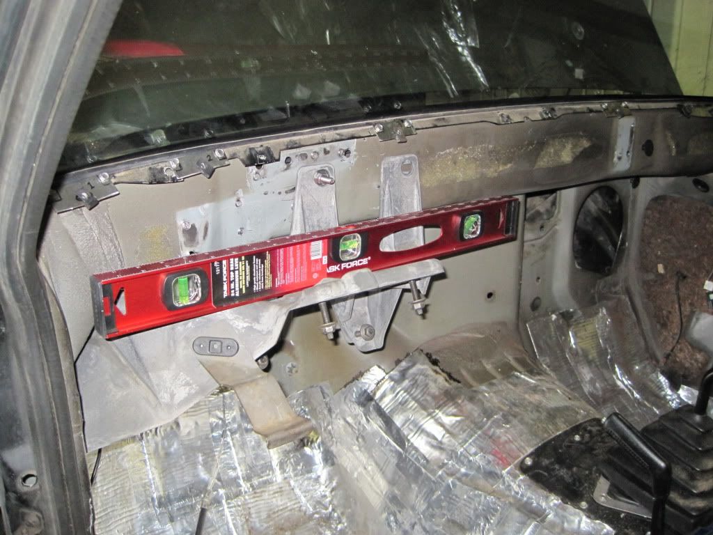

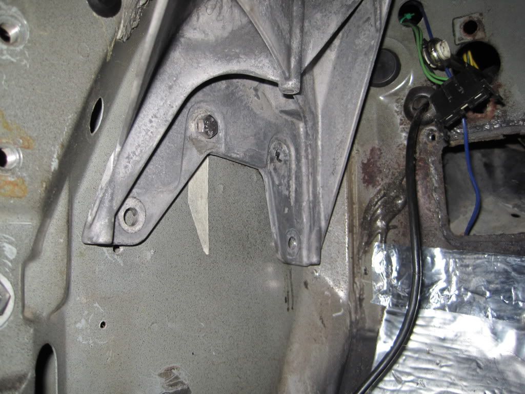

I got the steering column dash sub-frame mocked into place. I only have two holes drilled at the moment, but I've got the rest marked. After I mounted it, it looked really low, but tonight I connected the brake pedal and it bolted up fine to the assembly on the firewall. After remeasuring, I might be 1/16th inch off, so not as bad as I thought. The holes are slotted and it doesn't affect the fitment of the dash, so I'm happy. Here are a couple shots:
I started to take the heater box out tonight, but realized I don't have the special tool to get the AC lines off. Hopefully I can get that mocked up tomorrow. After that, I'll move on to the wiring harness through the firewall and the steering column hole.

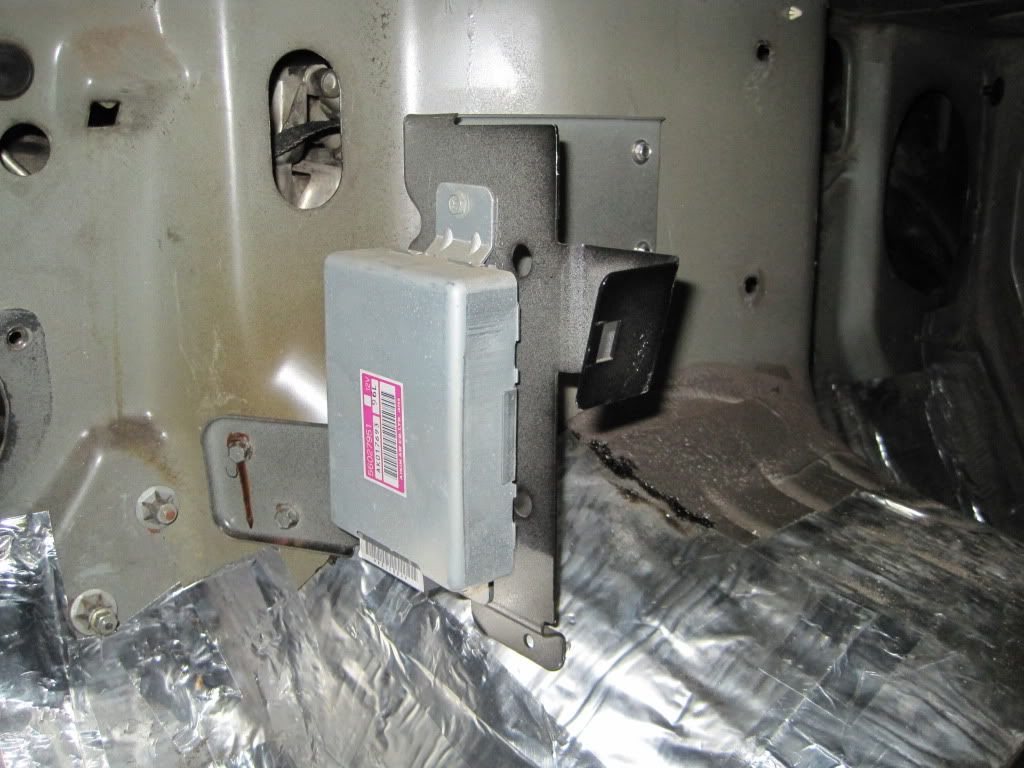

I got this computer box mounted to the firewall today:
I'm not 100% its in the right place. There are some significant differences between the firewalls that just looking at, it would be hard to spot. I'll know when I put the heater box back in.

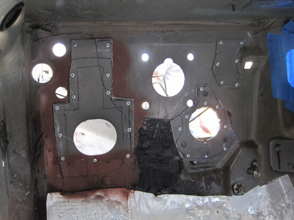

I started working on the fuse panel and nothing lines up. There are 3 studs on the XJ that hold the fuse panel. On the comanche, the fuse panel would cover up the stock location for the radio antenna, so I'm planning on cutting that whole panel out of the XJ and using it as a patch on the MJ. I started doing the same on the driver side fire wall. I have several holes to fill. You can see where the clutch master was (it will be an auto when I'm done) and where the wiring harness came through.
Here, I have cut the firewall out of the XJ and use the booster bolts to locate it.
The hole on the top left is the hood release. Its the same size as the comanche, but its in a different place. The hole that's there just had a plug in it. I pushed on it from the inside and it went flying, so I'll have to look for it later. I'll just plug that hole back up and use the existing hood release hole. I still have to move the steering column hole and there is another small one up top that needs to be patched as well.

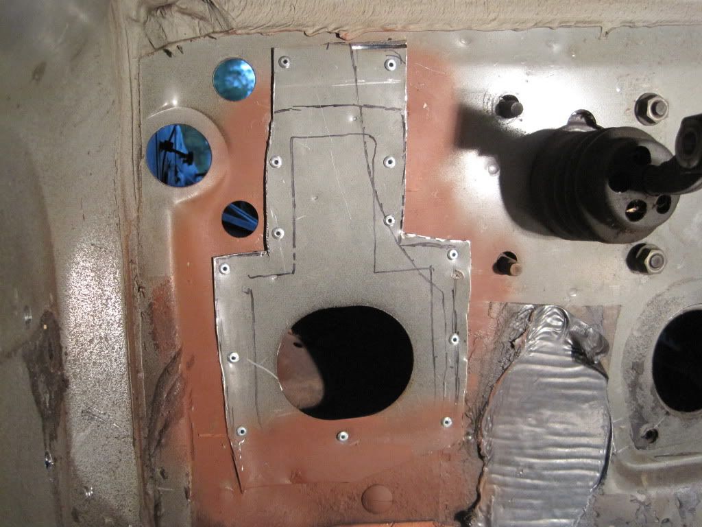

I got my first firewall patch done. This is what the hole looked like after i cut it out:
And here it is with the patch in place:
I may add a couple more rivets, but I'm going to seam seal the edges on both sides when I'm done. I think what I'll do for the steering column hole is this: Cut the general area out of the MJ, cut a large patch from the XJ. Then I'll slide the patch onto the steering column and bolt it up. Then I can mark exactly where it needs to go.

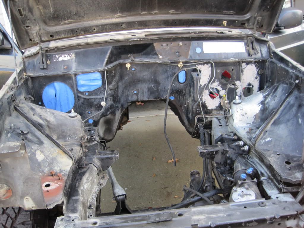

Well, its been a while, but I've made some progress. here is a shot of all the driver side patches on the firewall:

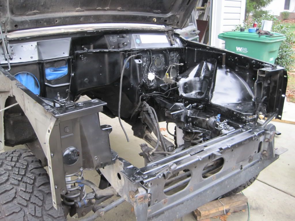

I got the motor pulled and here is a shot of the empty engine bay with the seam sealer on the patches:
And a shot of the fresh paint:
Tomorrow I'll start labeling the engine bay harness in the cherokee before I pull it. Once I get the harness in place, thing should start to go pretty quickly.
