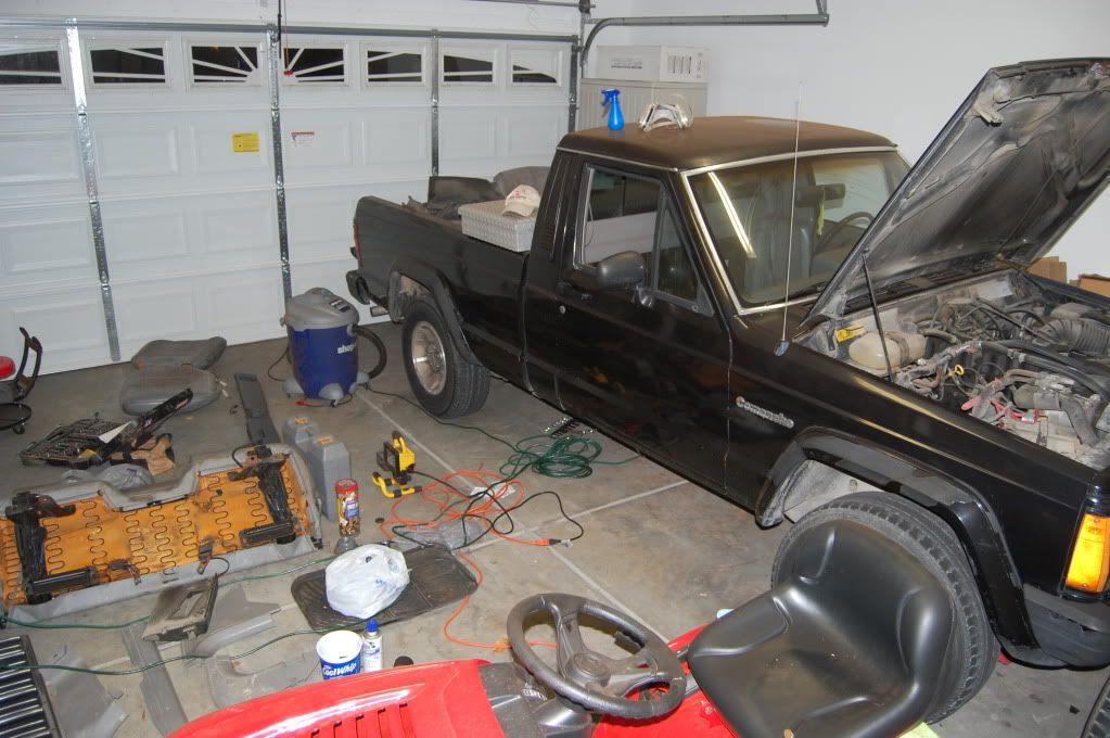

I got the bench seat out and the carpet pulled.
I got a quote yesterday on a transmission and transfer case out of a 92 Cherokee, front dana 30 and rear 8.25, drive shafts and all for $1k. Oh and free delivery. It seems like a good deal to me. Any thoughts?
I also took a trip to the pull a part. I got bucket seats out of a '92 cherokee, a full instrument cluster, front fender liners, digital clock, and tilt steering column out of an auto (not sure if I can make this work), a full front clip (mine is cracked at the top) and the ash tray just to fill the blank in the dash. Not a bad day's work for $127. Pictures coming soon.

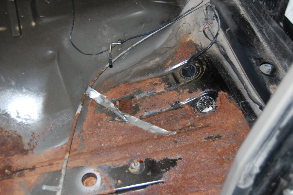

I got to working on the floor a little bit today. I got the broken e-brake cable out only to realize that the new one I bought is not the right one.
The passenger floor board really isn't that bad, just some surface rust. The driver side is worse than I thought. I found a small hole on the side near the rocker panel toward the back of the door and another hole on the left side under the parking brake pedal. There is surface rust all down the firewall on the inside. So I have to figure out what's leaking down.
Passenger side:
Driver side (most of the bright orange is the padding from the carpet that stuck to the floor):
Back driver side:
I obviously want to keep all this from happening again. What's the best way to find leaks? Also, does anyone know how to get the firewall padding off without taking everything off the firewall? I need to get behind it to address the surface rust on the driver side.

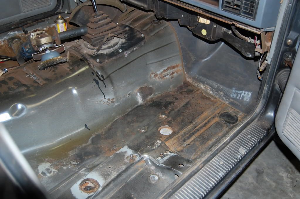

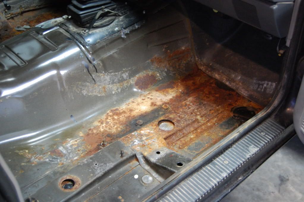

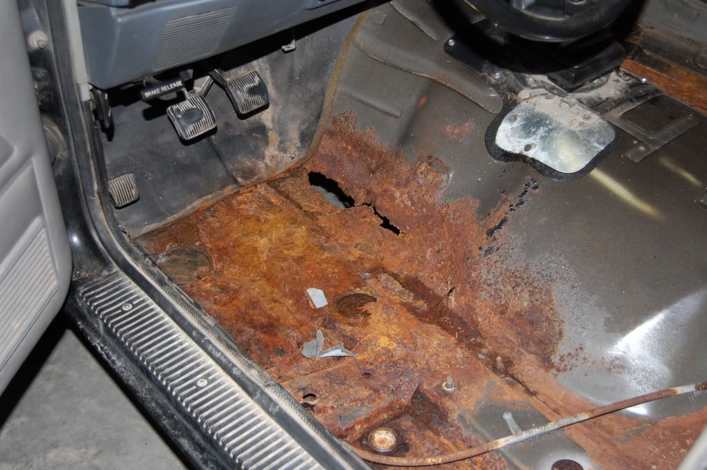

Well, I have made some progress. The passenger side is pretty close to being ready for paint. Just a little more wire brushing and fill in the the small pin hole. The driver side has been a little more problematic. I've been trying to work around the firewall padding and its been rather annoying. I found the source of my leak. Its a leaky clutch master. The fluid dripped down and seeped in around the fuse panel. My floor boards have seam sealer everywhere. The whole firewall is covered in it. The fluid dripped down behind the seam sealer, so a lot of the rust was covered up.
Passenger Side:
Driver Side (I obviously have some more work to do, but at least all the fuzz is gone). I wiped down the passenger side, but not the driver side, so a lot of what you see is rust dust:

awesome. Maybe weld in a new floor pan on the drivers side. some 1/8" plate steel should do. or some sheet metal.
