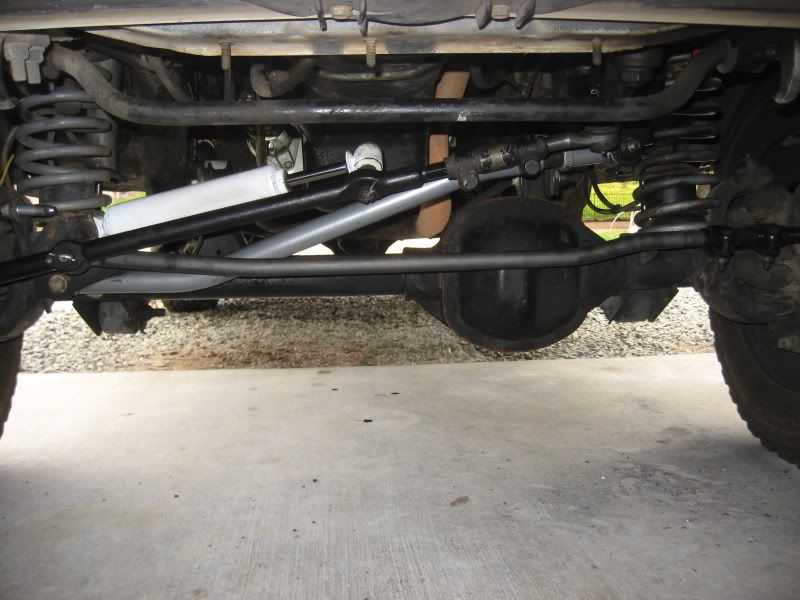

so i noticed my tires wearing funny and noticed my TRE's were shot. so instead of going with stock XJ steering, i sprung for the V8 ZJ steering, and while i was at it i ordered the goferit tie rod flip insert
and here it is all installed
and the tie rod filp
(notice the sway bar bracket is gone. the tie rod flip makes the tie rod interfere with the sway bar bracket so it needs to be removed and new brackets need to be made or ordered from JKS)

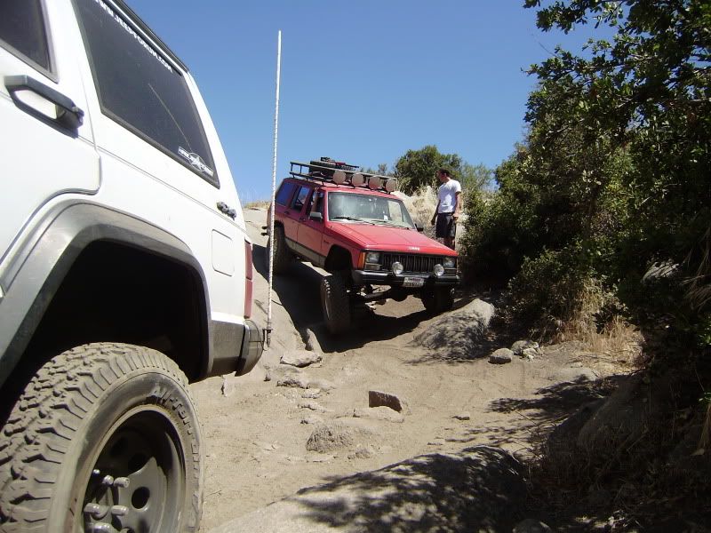

i went wheeling a few weeks ago. same place as the pics in the post above.
and high centered on the diff

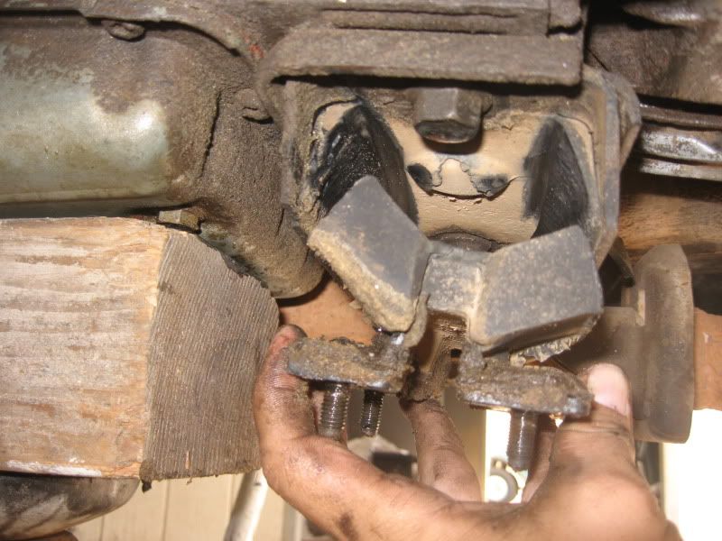

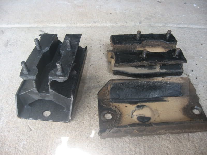

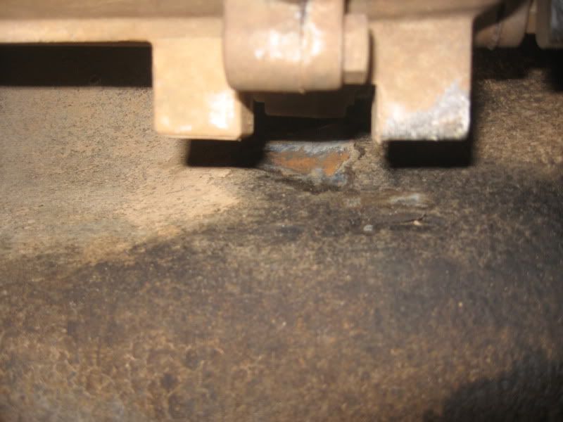

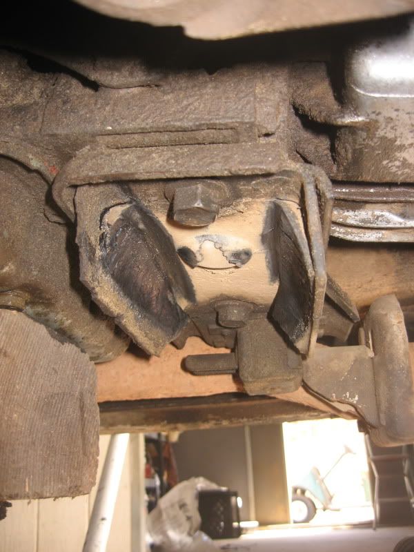

this was probably long overdue but i replaced my crossmember mount. i have a feeling thats what killed my motor mounts but i just never replaced it. it was in two pieces, just like both of my motor mounts
new vs. old
heres what bed crossmember and motor mounts cause

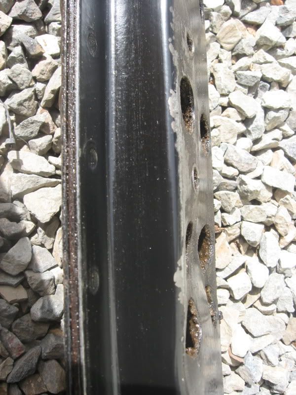

my crossmember doesnt look so hot either

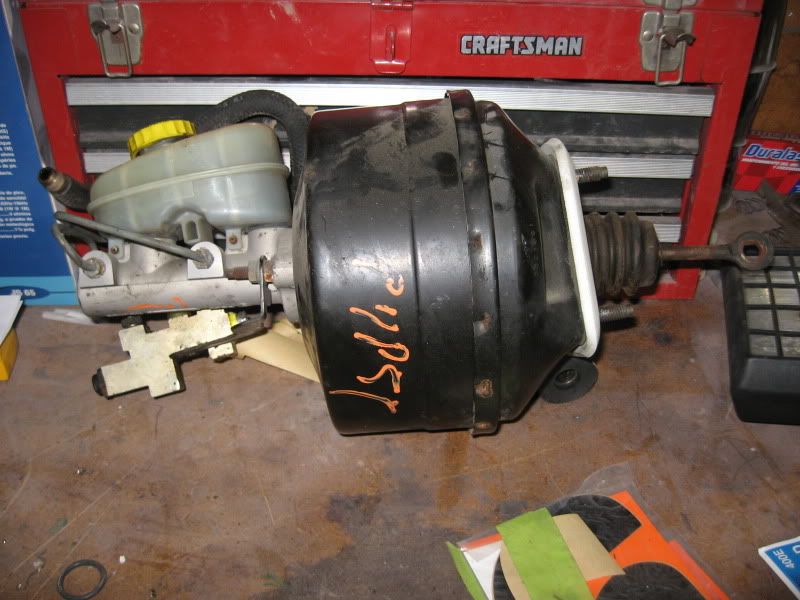

went to the junkyard and got me a 95 dual diaphragm brake booster and MC, and some nice aftermarket tow hooks. they mount the same as C4x4 brackets but with one more point of attachment.
