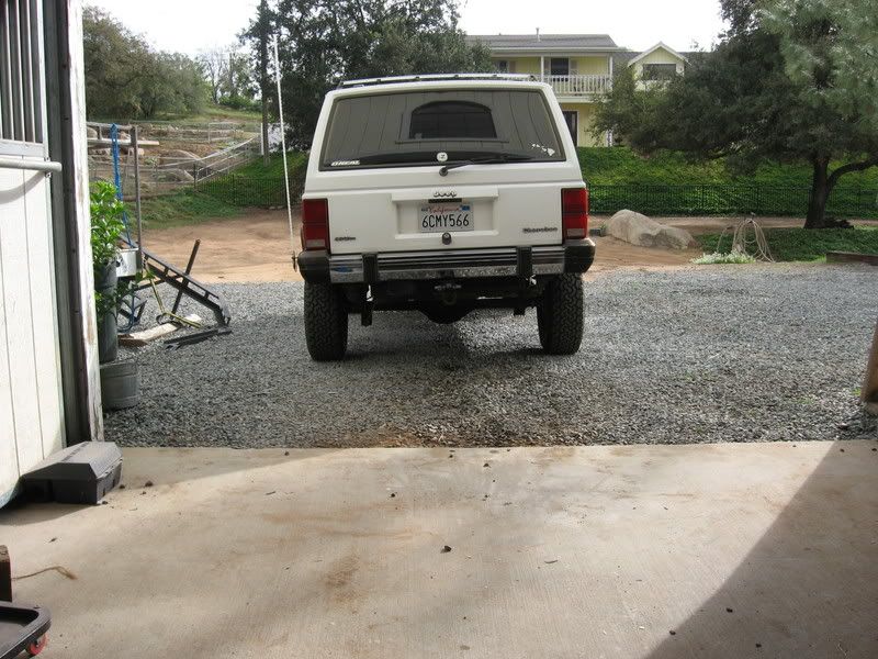

made myself a CB antenna mount today. i still need to run the antenna wire to it. i think its plenty strong on the bumper with those bolts

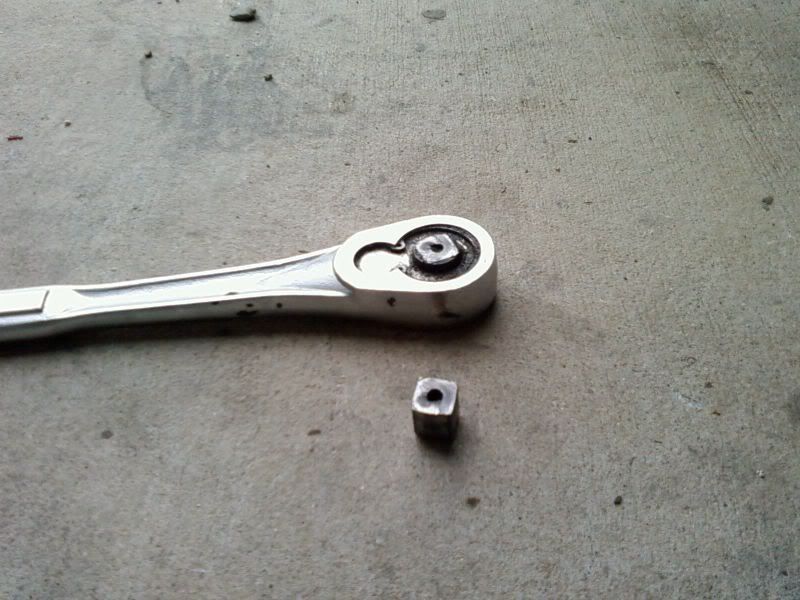

replaced the passenger side ball joints. talk about a PITA. the autozone press sucked to i had to grind the top of the lower ball joint off, this after hitting it with an oxy-acetylene torch multiple times, and pound it out with a BFH. the rest wasnt too bad. i will be looking for a good press tomorrow that is more complete. broke my 1/2" drive socket wrench as well while trying to get the 36mm hub nut off
so i had to go buy a 3/4 drive breaker bar and use some 2' long pipe on the end of that to break that nut loose
Wrench looks like a Craftsman. . . Time for a Sears trip to get a free new one!!!
thats exactly what i did when i bought the 3/4" breaker bar. i figured if it broke, so would a wrench just like it. had to go bigger.

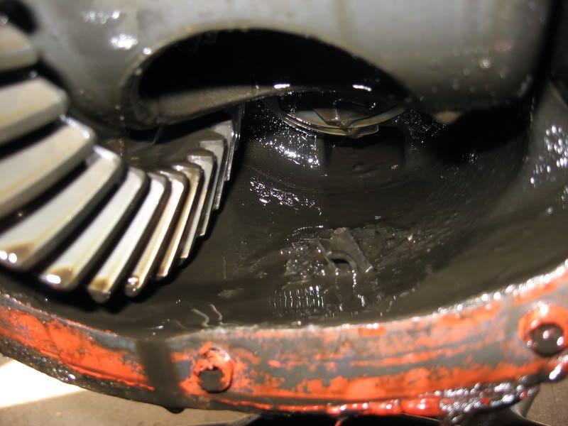

well a few weeks ago i picked up a 29 spline 8.25 for $100 from a 98 XJ since my rear end looks like this:
so i cleaned up the 8.25 and got some new u-bolts.
all i need is the hard brake line that goes across the top of the axle from drum to drum. i think the D35 one will work fine though

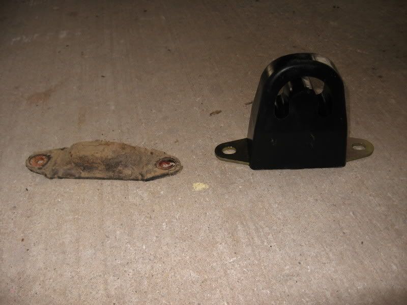

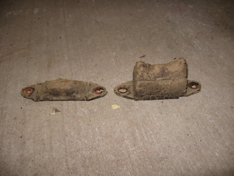

got my daystar extended bumpstops in today and threw them on
and i noticed MAJOR gangsta lean
