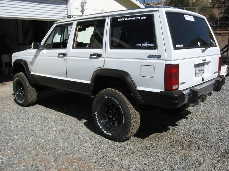

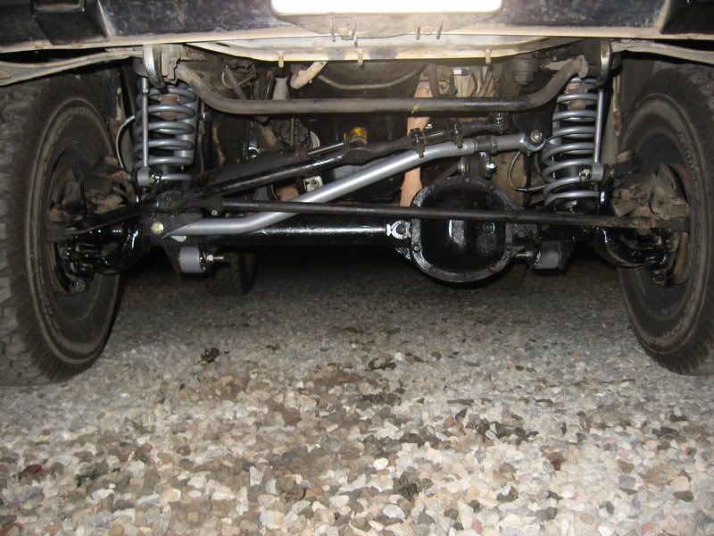

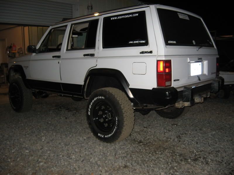

alright so i got the front on today. took longer than expected but wasnt too difficult, considering i did it by myself. rear goes on tomorrow.

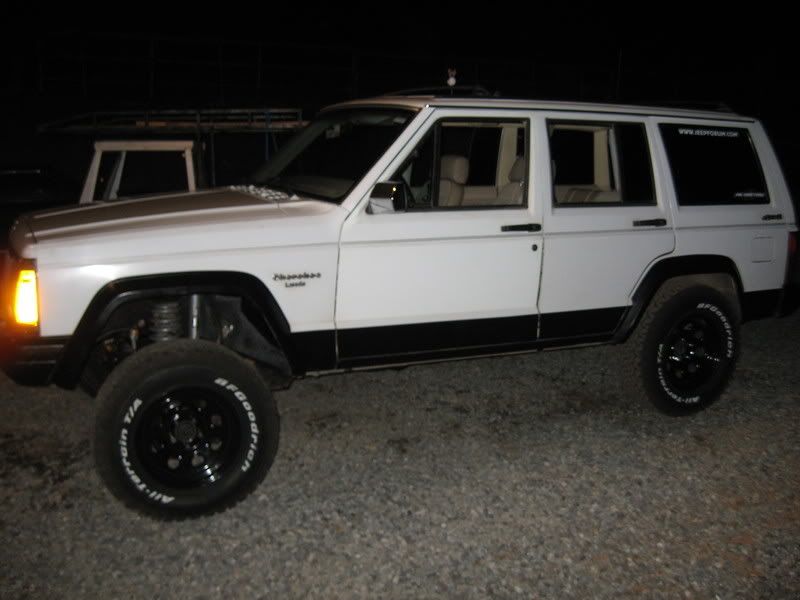

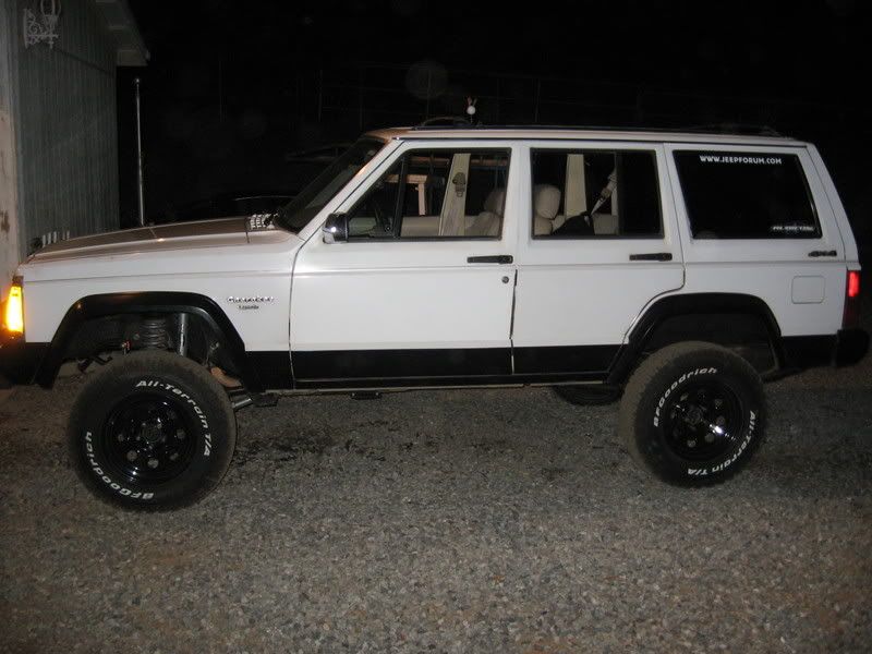

now its completely done!
i do have very slight vibes around 30mph so im thinking my 4* shim may be a little too much. it doesnt really sit higher in the rear either which is a surprise. all around its around 5.5" right now.

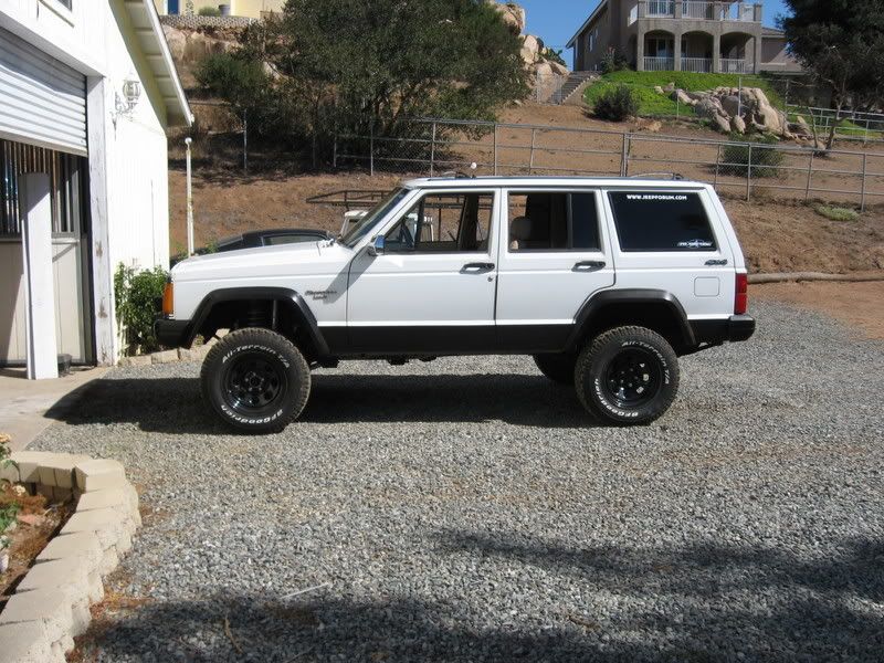

and daytime pics

Looks great, nice job ......Hows it ride?

thanks! its definitely a lot more rigid, thats for sure. but not kidney jarring. i cant complain as it was to be expected.

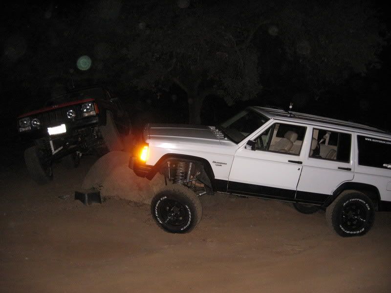

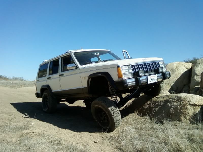

so i got to flex it out completely for the first time today and the front over compresses. so i need to add more bumpstops. my coils rub the frame and the axle on the inner C's. and my LCA's are a little long so when i flex, my tires rub the front of the flares.

Originally Posted by 1990JEEPXJ View Post
and daytime pics
That looks great man.
