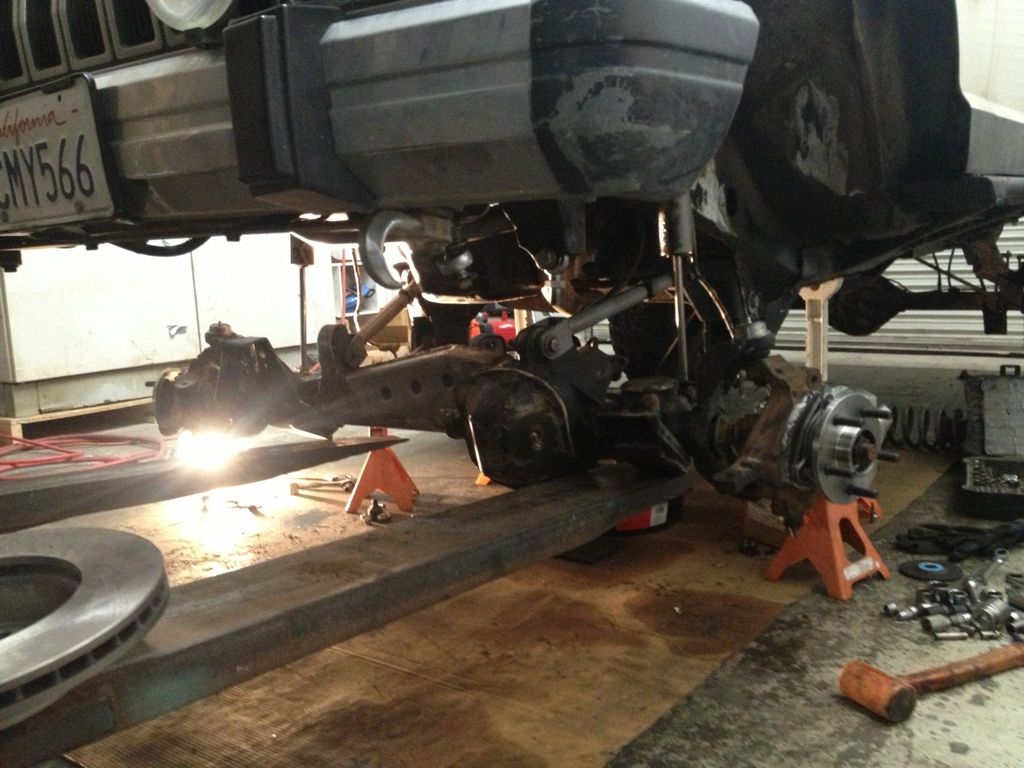

Been beefing the 30 today. Stripped it of the hubs, shafts and knuckles. Made a new trackbar using heims
at this point im waiting for the truss from ballistic, the akebono calipers and i need to get WJ rotors and redrill them for the XJ bolt pattern. after that have the locker installed and probably get a set of chromos with 760's

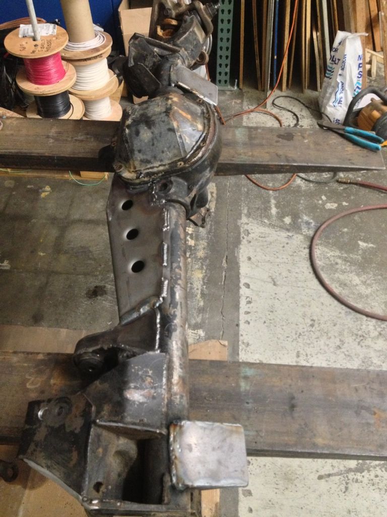

Welded on a truss last night.

making more progress on the 30. dropped it off to have the locker installed on thursday. should pick it up monday. today i bought some used ten factory alloys off of a fellow NAXJA member as well as a ruffstuff cover with lube locker gasket.
i decided to finally mount the calipers tonight. the WJ calipers are HUGE compared to factory XJ stuff. i also made my new tie rod out of 1.75"x.375" DOM. shouldnt bend that one. ill be using one ton tie rod ends on the new setup because of the bigger cover, and the clearance issue with the draglink and the JKS trackbar mount. i also drilled the WJ rotors to the XJ bolt pattern tonight.
next up is to get the housing back and begin reassembly. i am just waiting on one tube adapter and the reamer for the tie rod ends.
then off to KOH on thursday. just crossing my fingers that my rims will clear the calipers, or that i will be able to simply grind a little off the wheel and/or the calipers

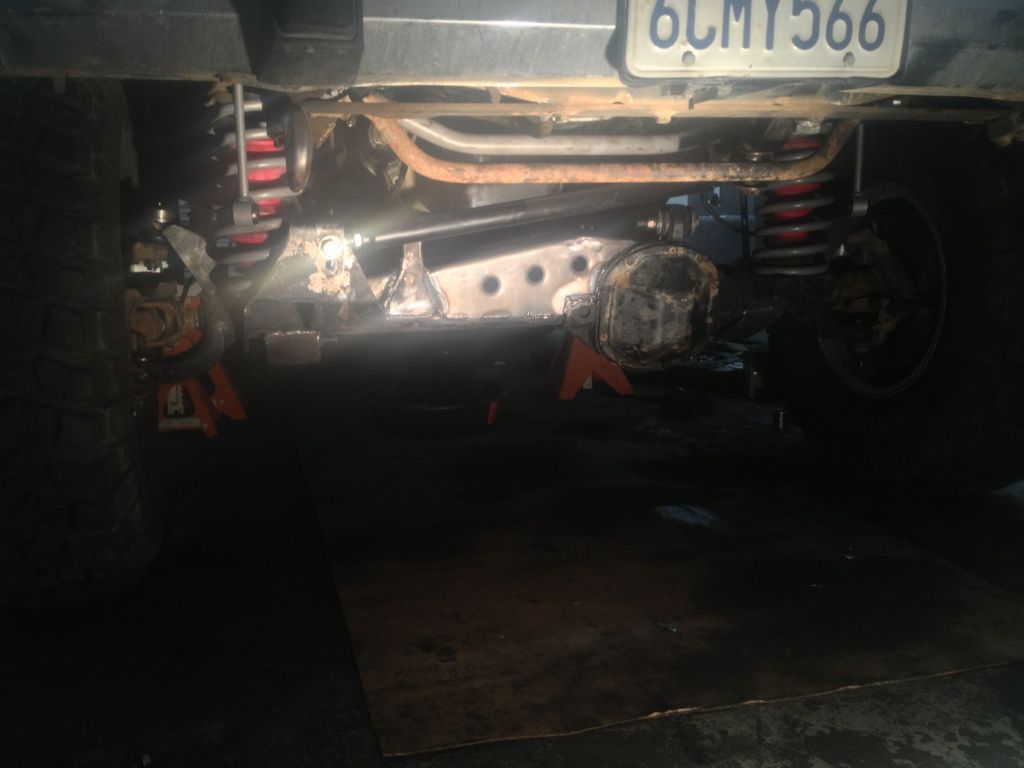

Old XJ and new WJ calipers and the welded ruffstuff hole
