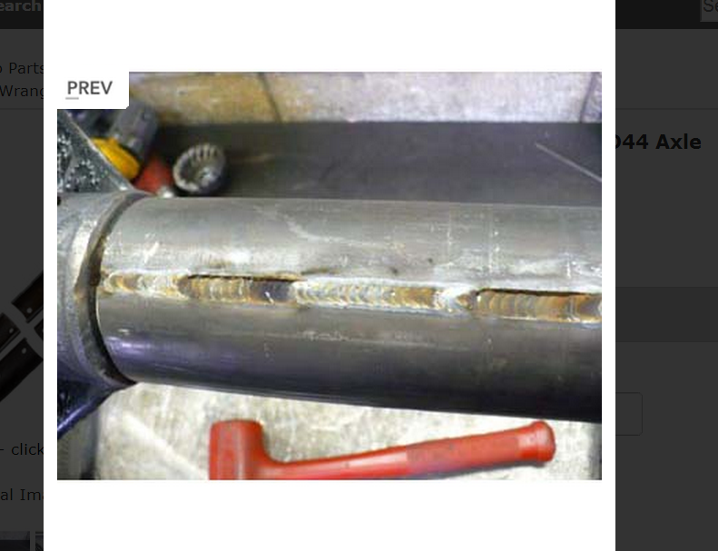

Cool. mine was super rusty also, even to the point that when I ground off the perches and rust there was noticable material missing. It was under the old perches, which lined up on the edge of my new ones causing them to sit crooked. I got them level and tacked them on which left a small gap, My good welder friend filled in the void while welding them on. worse case drop $100 on a truss from iron rock/artec etc. you could also sleeve the tubes on outside before doing perches if there is serious amounts of metal missing. (3rd pic)
Hard to tell but if you look at the contour you can see some real estate missing
