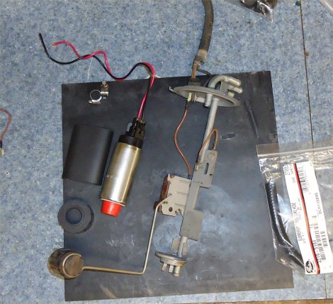

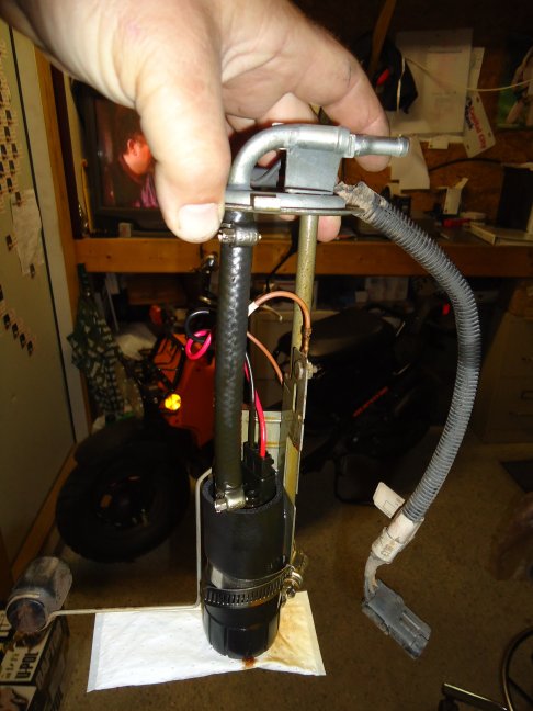

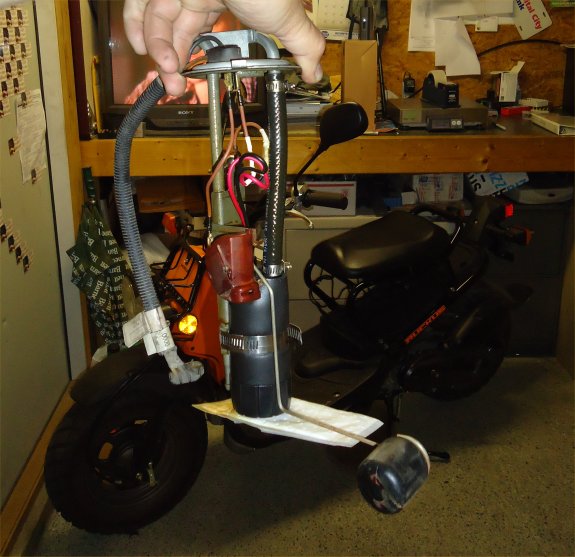

Friday I Installed my new walbro pump on the unit which drops in the tank. First pic shows the unmodified pick up unit. I just cut the small loop off that the original pump sat on, measured the distance from the seal at the top to the bottom of the tank and then used a hose clamp to attach the new pump to the side of the return line and fuel level sender at the proper depth so that the screen will sit right at the bottom of the tank.

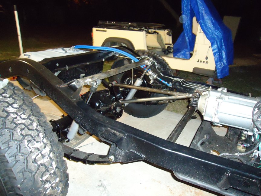

I made a little more progress on the antiwrap bar yesterday. I am using a 3/4" hiem joint at the front of the bar, the chasis shop localy only uses 1" and 1.25 joints so I was unable to fint the weld in insert. I machined one from some 1.25" barstock and threaded 3/4 x 16 in the small lathe .
Then welded the threaded insert in the lower bar which is 1.25 od x .155 wall dom , then faced and turned it to clean it up a bit in the big lathe.
panaceabeachbum is offline
post #142 of 965 Old 10-29-2011, 07:18 PM Thread Starter
panaceabeachbum
Location: panacea, fl
Posts: 1,133
here is a pic of the upper and lower bars tacked together

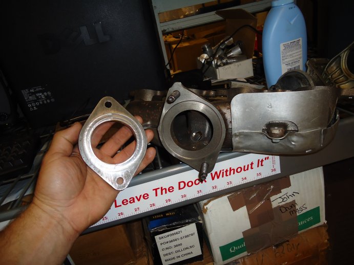

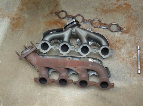

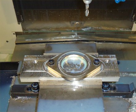

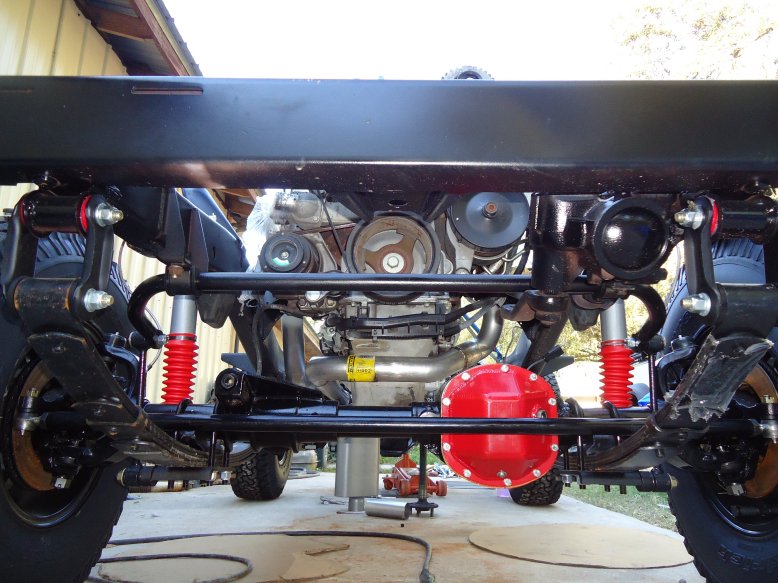

today I was able to sqeuze in a few hours on the exhaust system, The c6 manifolds landed on friday . I had to machine a couple of flanges to work with the manfolds , I machined the center hole to be a nice snug fit over the 2.5" tubing I am using for the first half of the sytem.
These manifolds use a flat gasket instead of the more common conical gasket on the truck manifolds.
post #144 of 965 Old 10-29-2011, 07:27 PM Thread Starter
panaceabeachbum
Posts: 1,133

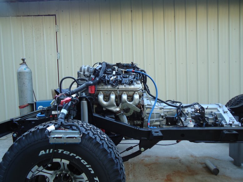

A few pics comparing the truck manifolds and the corvette manifolds

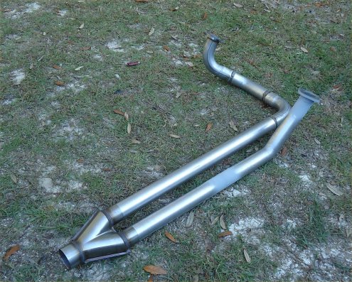

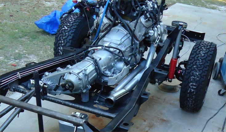

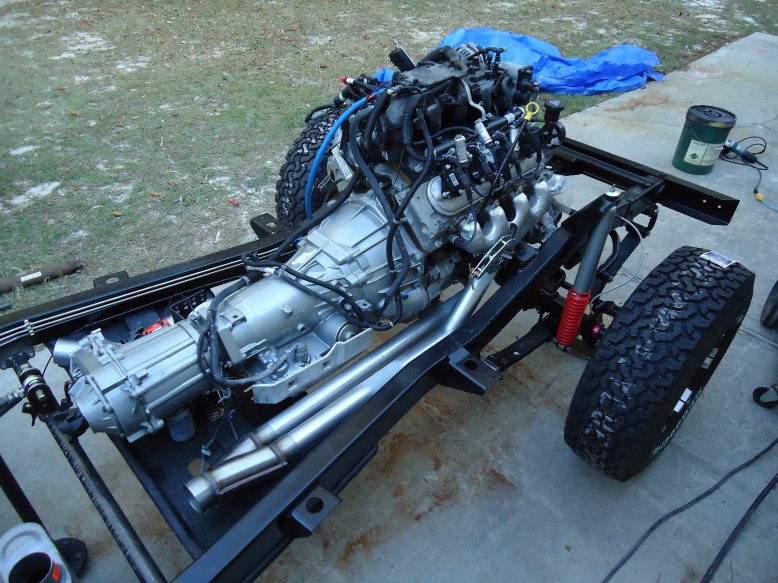

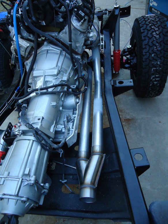

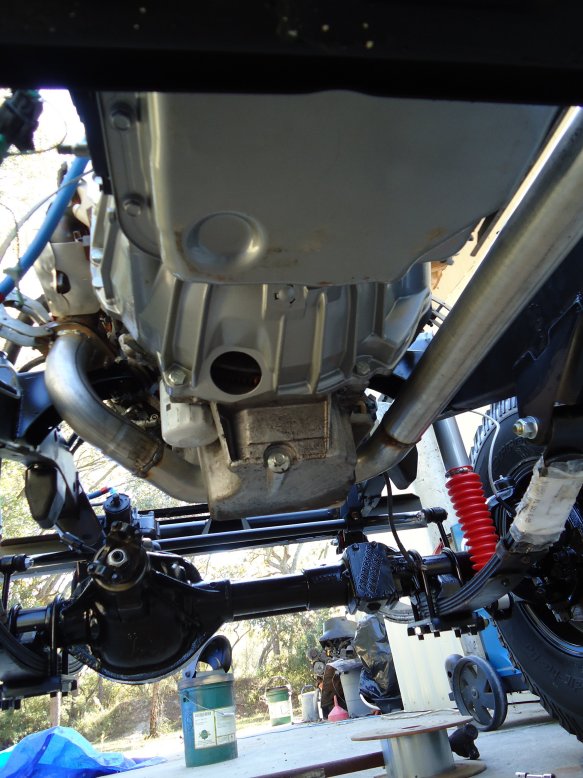

I started with the drivers side pipe, like most of the threads i took my inspiration from I just came forward and under the oil pan to wrap around the passenger side. This pipe is 2.5" and it used two walker 90 degree elbows , one summit 45 and 4' length of pipe to reach the rear of the transfer case.
post #146 of 965 Old 10-29-2011, 07:35 PM Thread Starter
panaceabeachbum
Posts: 1,133
The drivers side used one summit 45 , which is aprox 1' long on either side of the bend, and 19" of 2.5" diam tube
post #147 of 965 Old 10-29-2011, 07:40 PM Thread Starter
panaceabeachbum
Posts: 1,133

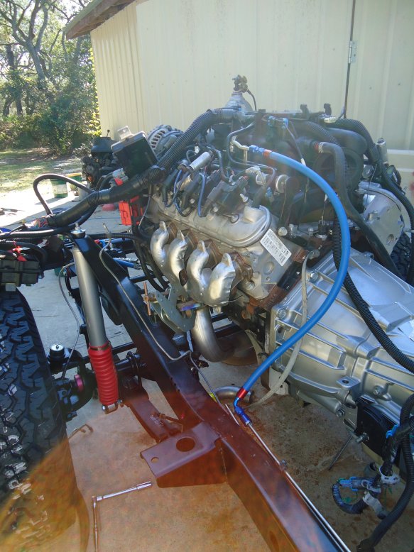

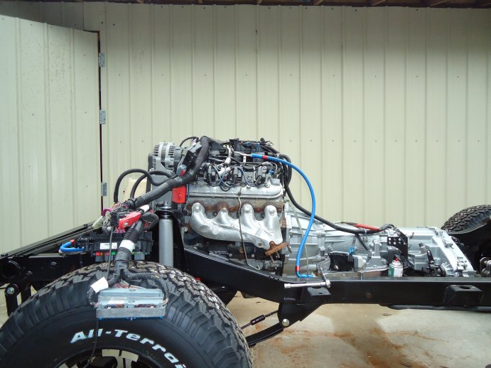

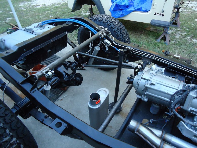

I decided to bring both the 2.5" pipes into a 3" outlet collector from magnaflow which ends at the rear edge of the transfer case. I am going to make a flange to weld at the back of the collector and to the front of the muffler since the front half of the exhaust system can be dropped and removed as a unit with out any problem. I still need to address the long runs of hose in the pic below, the original setup used two long rubber hoses also but I am considering using hard line with short lengths of hose on each end.
Here is a pic of it out on the ground after finish welding
And a shot of the collector at the rear of the transfer case
