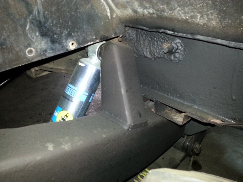

Rear shock mount. Custom.

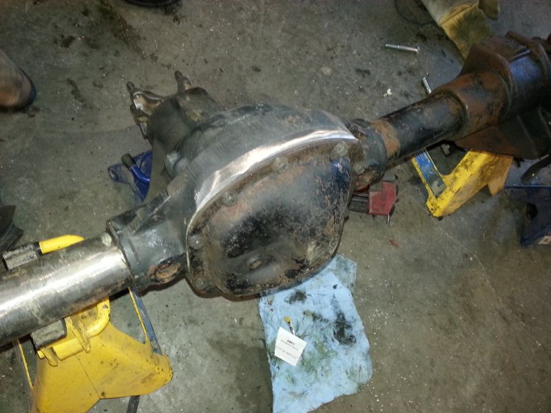

8.8 after re-gear, ARB and paint. Waiting on SOLID cover.

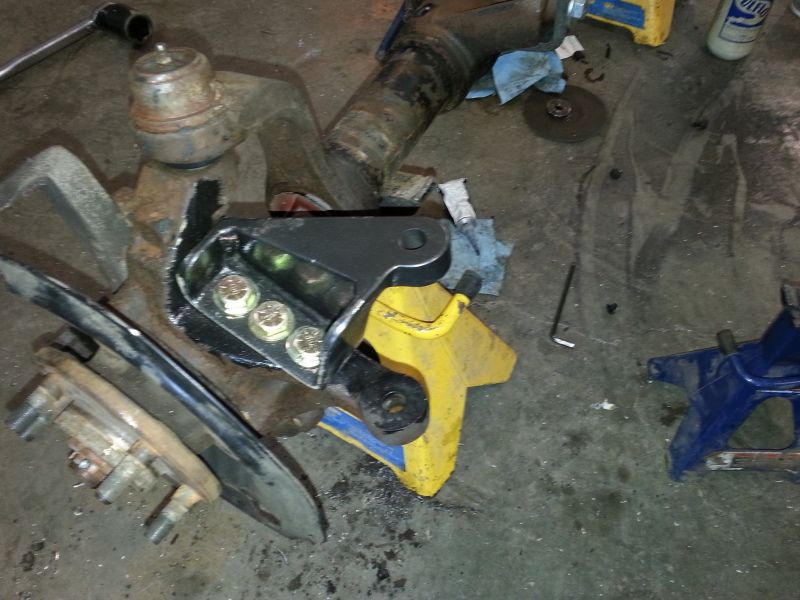

Front Shock mount out of a F-250

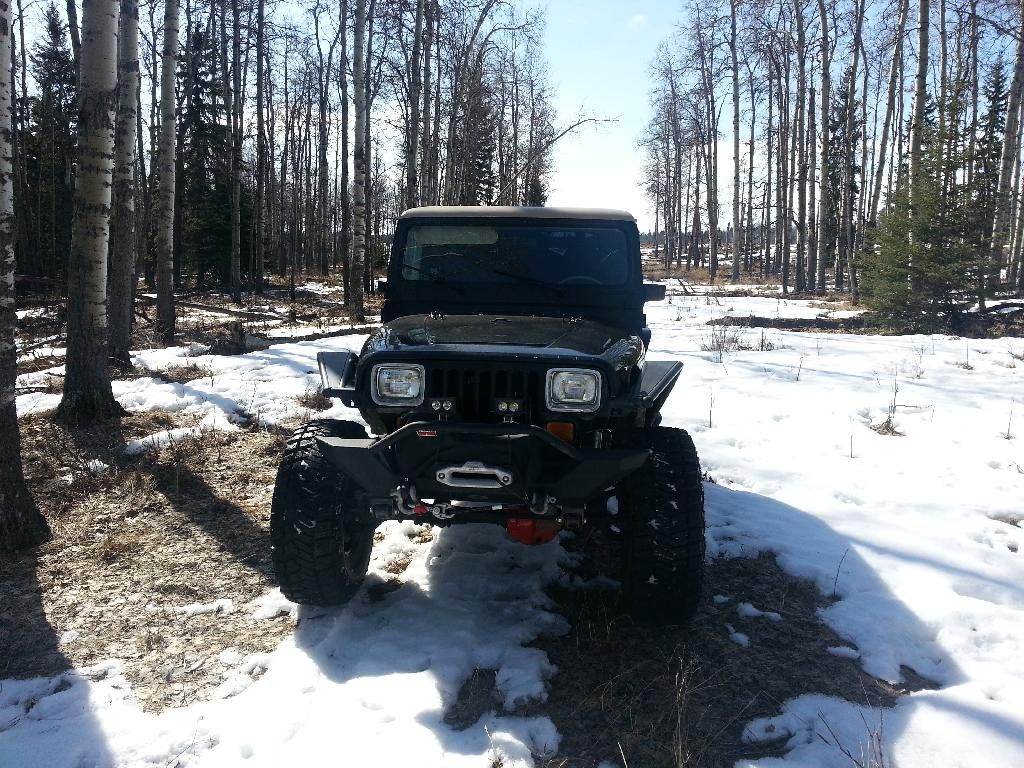

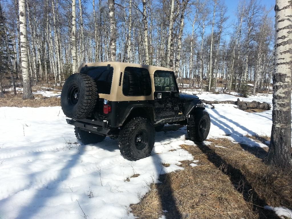

I'm continuing to work out the bugs. Had a couple leaks, replaced the clutch master cylinder and replaced a faulty fan relay.
I broke the first rule yesterday and went wheeling by myself on our property. Pretty mild as the ground is still frozen. Some deep snow, but nothing too tough. Tested out the lockers in a deep drift. They work. Would have had to test out the winch if they didn't.
I was solo, so no action shots.
I've decided not to install the adjustable trac bar for now. Just have to be aware on the pavement. Handles very well offroad with lots of traction. More pics to come over Easter weekend.

8.8

Ford 3/4 ton shock mount. Compressed a bit.
