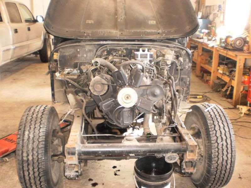

Anyway, we bought the Jeep and I quickly realized that the 4.2 needed to go. We found a 2001 Jimmy with a 4.3l Vortec on kijiji that was smashed but still had the motor and was in good shape. So we tore into it last weekend and got it out. What a pain in the a55! These motors are in there tight to begin with, but add a little tweakage to the front passenger side, and its in there good! Finally got it out after lifting the body off the front motor mounts. Cost me $500 and I should be able to get my money back parting out whats left.

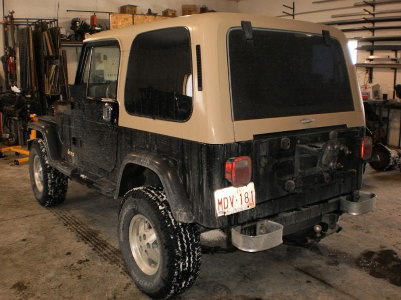

The Jeep as I bought it. Its been way too cold to hit it with the hotsy (heated pressure washer) so the pics don't really do it justice. Its in great shape for an 89.
With the new motor.
Old motor.
