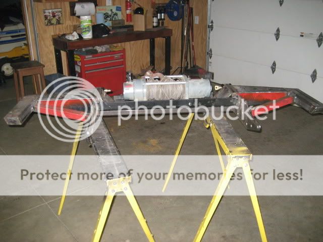

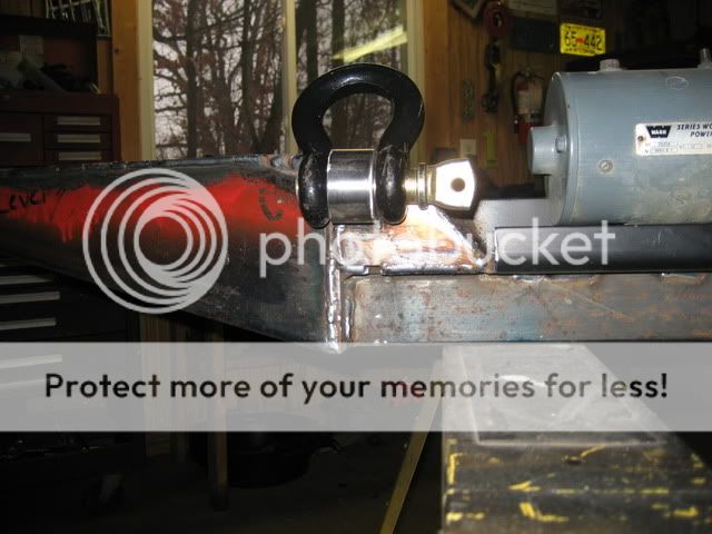

machined the d-ring mounts tonight

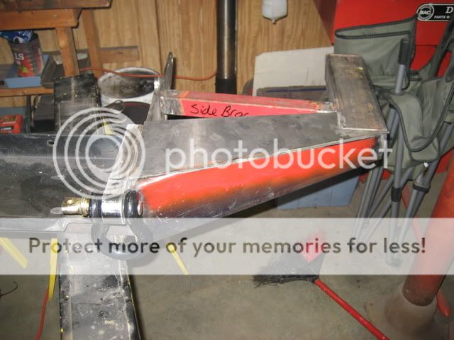

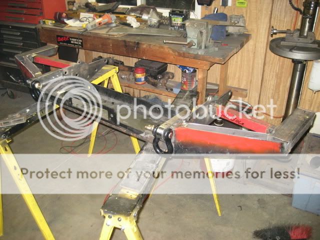

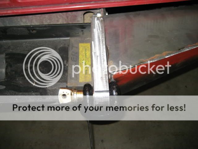

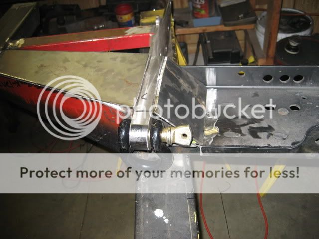

everything is fully welded, minus the top caps and angle plates. the d-ring mounts are welded and bolted to the bumper mounts just in case a weld fails, there are still 2 grade 5 bolts holding it.
self explanatory haha
end welded and blended
cap
angle plate

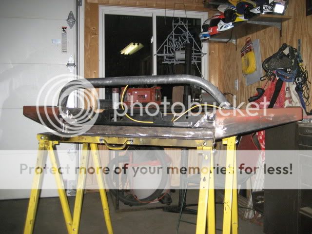

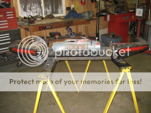

done minus tube, grinding and paint. weight=70lbs bumper, 50lbs winch so after the tube it should be around 130 lbs total.
capped off
back side

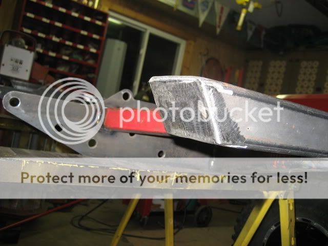

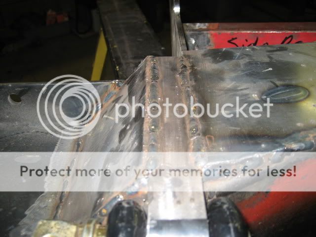

some of my welds. im no expert but there is solid penetration and they look pretty decent. all the welds will be smoothed though.

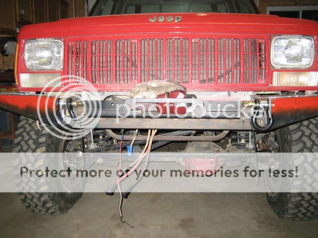

blended/smoothed ready for paint this weekend
