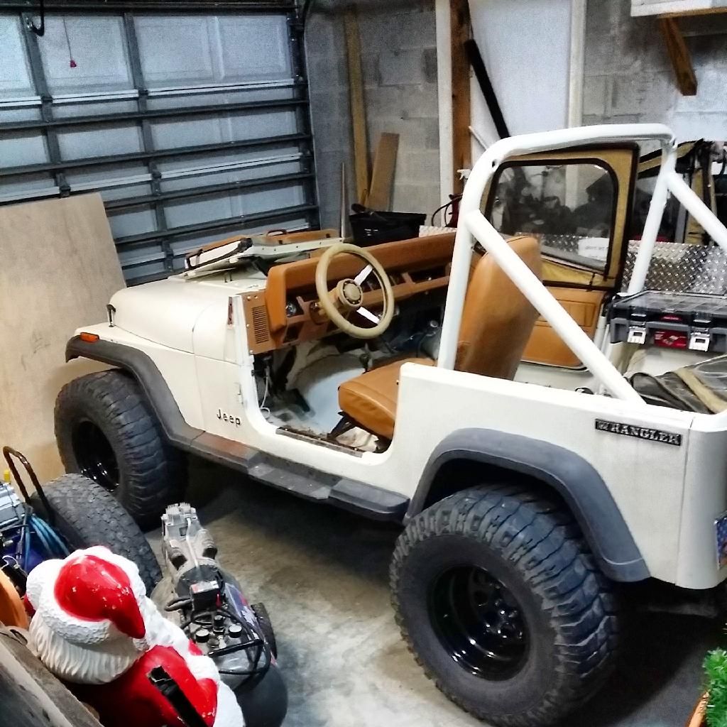

Going to be scuffing up the floor soon and prepping it for some rustoleum enamel before I install new carpet.

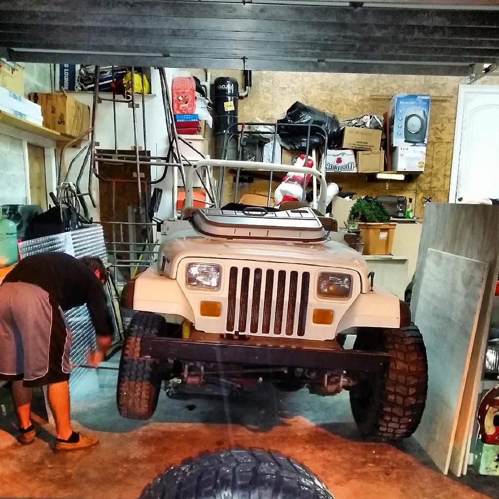

Got some free 33x12.50s from my cousin who upgraded to 35s on his tj.
worn but they'll do for a while. I ordered my rims which weren't really what I wanted (15x8) so I went with 15x10. Backspace of 2.5" which is what I wanted regardless of 15x8 or 10.
when I do get new tires however I want to get 33x15.50. I think it'll look nice on the 10" wide rims.

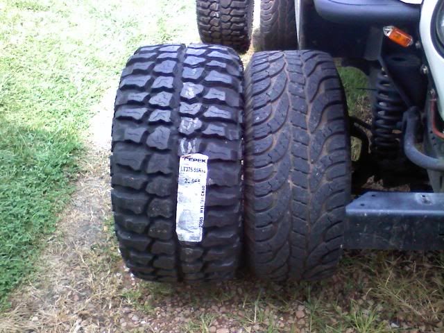

this is the look im after- 33x15.50s on 15x10s
this is monjorrow's jeep (not sure on his backspacing)
compared to 33x12.50's

FINALLY got my CORRECT wheels from pro comp!!! 15x10s with 2.5" BS
Huge lip is an understatement.

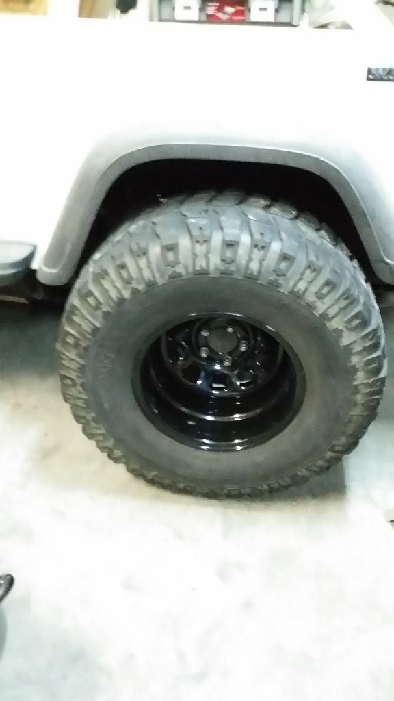

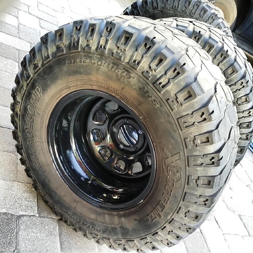

33x12.50x15s mounted and balanced on my 15x10 2.5" BS pro comp wheels.

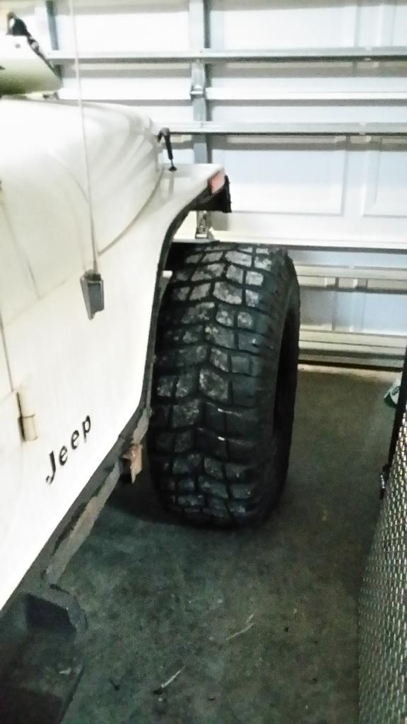

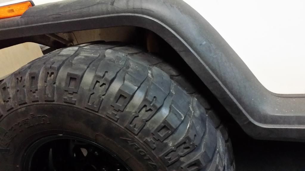

Let me start by saying I love how wide the stance is. 15x10 with 2.5" backspacing. 33x12.50s.
The jeep is STOCK. I didn't think they'd fit but I'm not driving it right now so I was just messing around and decided to try. Surprisingly they fit. The rub flare up front only at almost full lock at the corner of the flare by the door. Considering TJ flares but I like my YJ flares better to be honest.

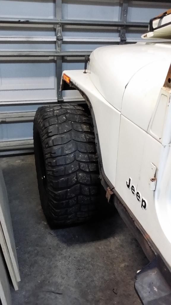

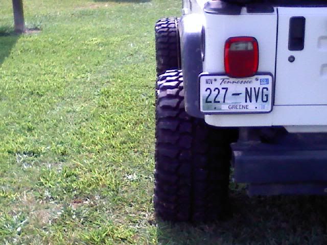

I cannot explain enough how much I love the stance of these wheels!!!
I'm in the process of taking all the flares off. Gonna ride around like that for a while, until I decide what I want to do, be it a lift or tube flares. Likely metalcloaks.

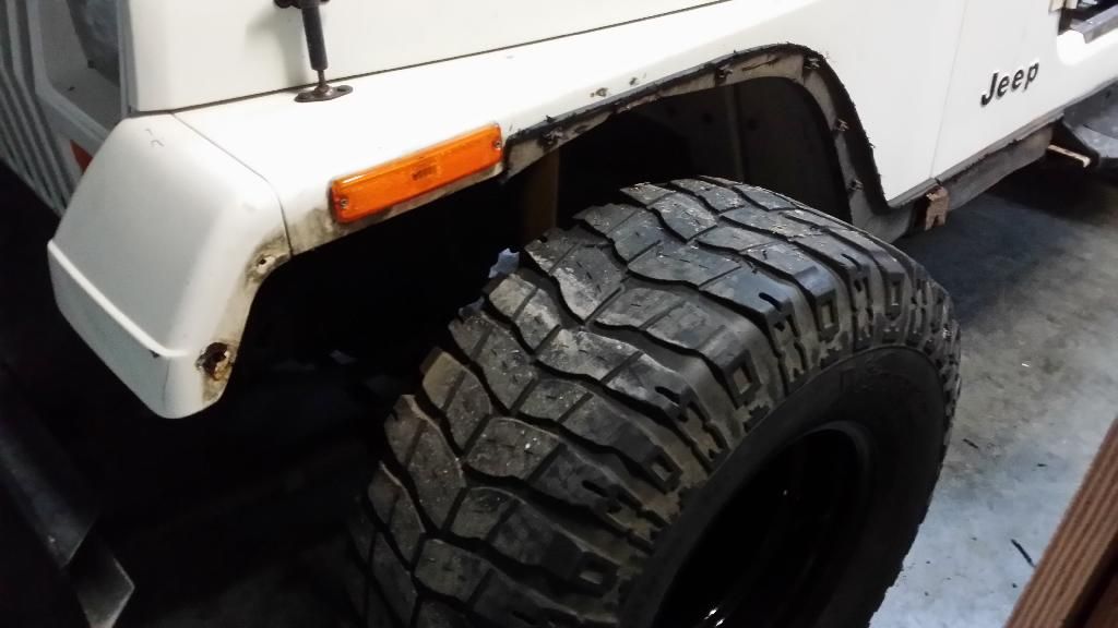

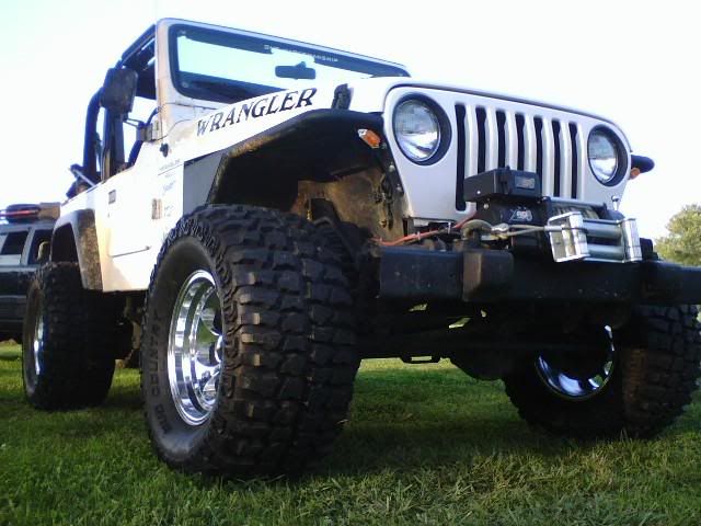

Cut off the front flares. the bolts were Giving me trouble so they'll be easier to remove now. Wasn't gonna use em anyway. Plans are to do something like this, and keep it stock height:
Here's mine:
