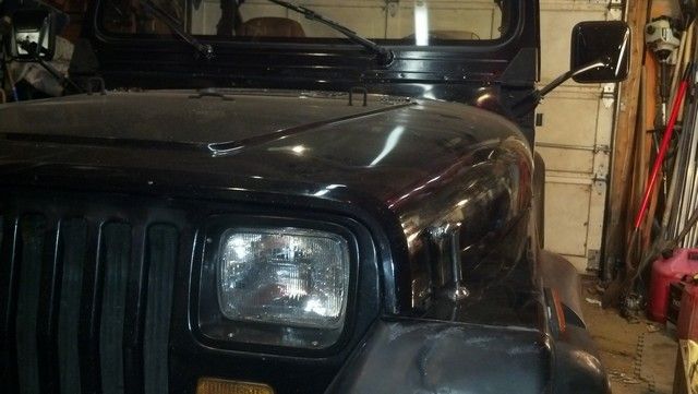

The initial reasoning for the purchase of this Jeep is so that I can have something fun to drive while I'm rebuilding my 1980 CJ5.

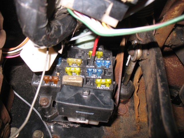

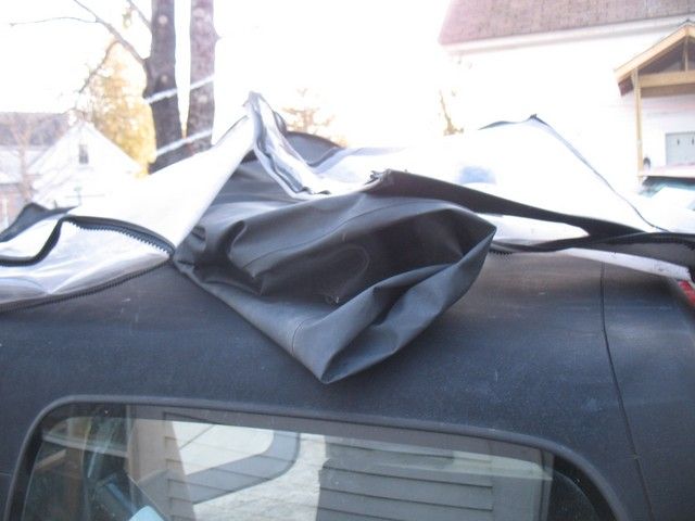

The first thing I did after getting the YJ home is test a free TJ soft top that a co-worker and fellow Jeep enthusiast gave to me. It doesn't immediately look like the top will work. The windshield attachment is different and my tub doesn't have the mounting rails on it. I don't see that the roll bars over the door openings have the proper holes for the door frames either. I'm not sure if this top can be adapted to the YJ easily or not. edit I did find some parts at Quadratec's site: corner belt rail kit & retainer belt rail kit. edit

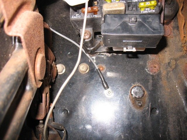

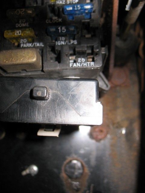

The heater blower does not come on with the switch, which was a bit of an issue for the drive home tonight. Bikini top and full doors flapping in the breeze (held shut with bungee cords) with outside temperatures below freezing. It started snowing just after arriving at home, hopefully the last snow of the season.
I looked at the fuse box first and found that the fuse is good, but loose in the socket. Upon closer inspection one of the connections has a broken tab. I'll need to pull the fuse box out and replace the terminal connector there. For the moment I bent the prongs a bit to make better contact with the fuse. Presto! The blower fan comes on now.
I've sent emails to follow up on several craigslist postings for hard tops, soft tops, and doors.
I also pumped diesel fuel for the first time in my life tonight. The first fillup was 16.139 gallons. I wonder what size the tank is...

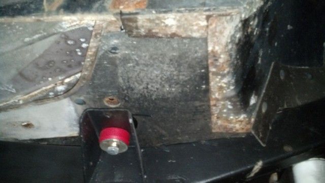

Yep, the frame, axles, cross-member, steering components, etc have all been cleaned and treated with POR-15.

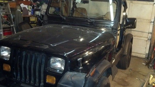

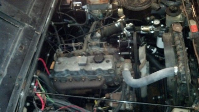

This morning I registered the Jeep and drove it to work. No issues, Jeep ran great. It was about 40F and raining but the bikini top and soft doors (with bungee cords) kept the rain out.

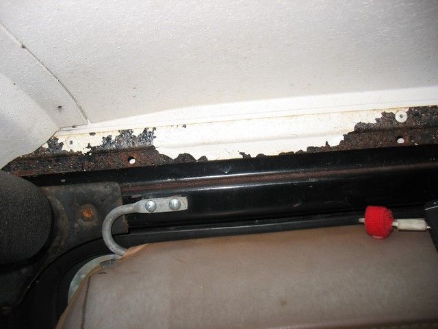

I discovered that the windshield leaks pretty badly. Water was coming through the dash onto the floor all over the place. Windshield hinge gasket? Glass seal? I'll need to investigate and correct this issue.
A few of my co-workers are Jeep or auto enthusiasts and they came out to look at the diesel jeep. When I fired it up the alternator belt was visibly slack and slapping. I shut him down and lo and behold the belt was falling apart. I dug out the few tools I'd brought with me and borrowed a wrench from the company tool kit. The belt snugged up a bit to the point it seemed like enough.

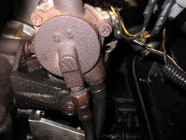

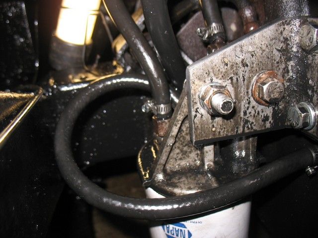

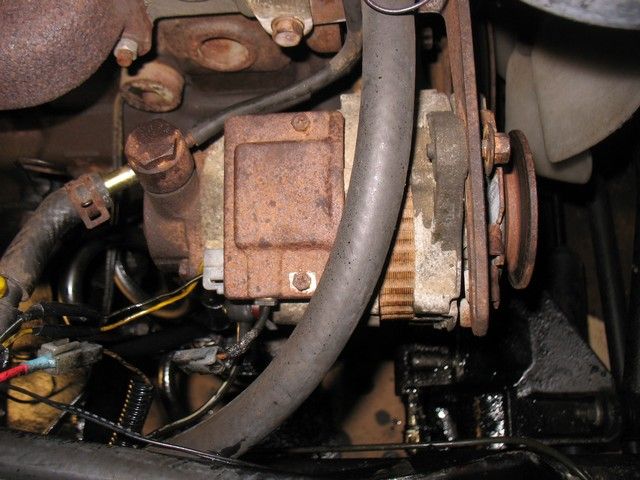

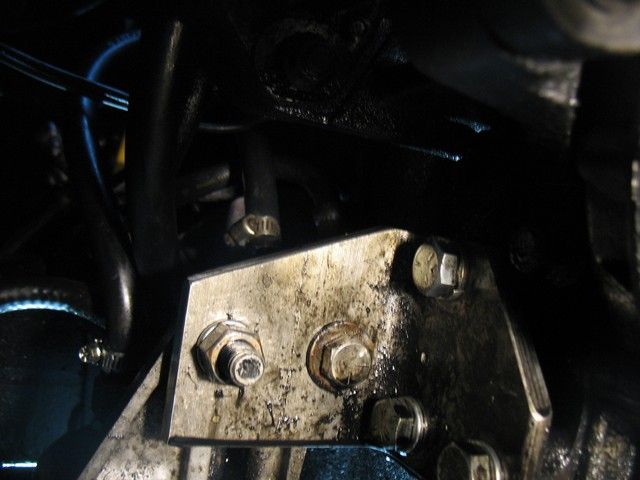

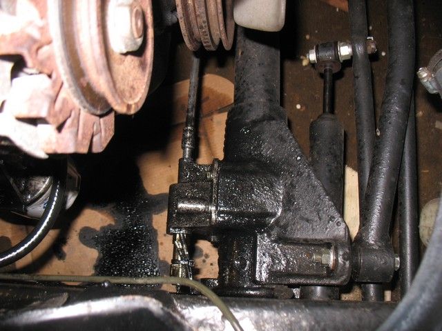

There was also an obvious oil leak developing below the alternator where the bypass filter is. I didn't see any obvious hose or connection failures and the engine was less than half a quart low so I mentally filed that away for later investigation.
When I got home tonight the oil was everywhere. What a mess! I tried to wipe most of it up and sprayed a little engine degreaser as well. NOTE: the engine degreaser softens the POR-15 - don't use again...
The only issue I could find is one hose clamp on the bypass line to the filter wouldn't stay tight. With a new clamp on there and the hose shortened 1/2" the connection doesn't visibly look any better. I'll take it to the car wash in the morning and try to remove most of the oil mess. This might make it easier to locate the leak and will certainly make it cleaner to work on.

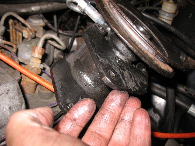

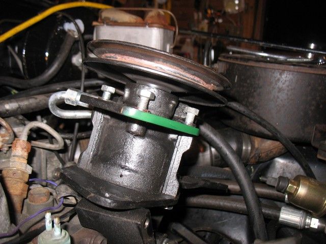

I picked up a new alternator belt from NAPA this evening. Part number 25-9447, 31/64" x 44-7/8" or 12.5/13mm x 1140mm. The old belt was W BANDO FAN BELT A-43. The new belt seems a bit longer than the old one but there is plenty more adjustment to the alternator so I installed it. Note that there are two pivot bolts below the alternator due to the vacuum / oil pump on the rear. Forgetting this will make it hard to adjust the belt tension.
The power steering belt must be removed in order to replace the alternator belt. The power steering pump is an aftermarket add on with a custom fabricated bracket. The bracket is nicely made from 1/4" steel plates, 1/4" wall thickness tube, and 1/2" plate. The bracket is bolted to the block and then there are two plates bolted to the power steering pump. These create a pivot point and a sliding bracket for adjusting belt tension. However, with the adjusting bolts loosened the pump doesn't' release far enough to remove the belt. The pump needs to be removed to accomplish this. This seems to be due to interference between the pump plates and a mounting bolt for the bracket. I cut a corner off of the front plate so that it more closely matches the shape of the rear plate and painted the cut edges. I also elongated the slot in the adjuster bar about 1/4" into the slight S bend near the pivot hole. It's not going to create an issue with needing to tighten the bolt over this angled portion, the adjustment this far is only for ease of belt removal. I re-assembled all of these pieces and was able to install the power steering belt by hand. Success!
With the belts back on and the oil somewhat cleaned up my work is done for the evening. I also picked up a 12 volt power adapter (cigar lighter) from NAPA to install under the dash. I may examine my two parts jeeps for a real cigar lighter but wanted something that I could install easily this weekend. I'm hoping to head out to Boothbay with Mr. Magoo to search for a hard top, soft top, doors, and possibly seats. If I'm going to daily drive this thing I'll need shelter from the elements at times.
Top down view of the alternator and oil spill below
View of the front axle and the oil mess
Bypass oil filter, offset mounting bracket, engine mount in background
Back of alternator - vacuum pump and oiler hoses
Front of bypass filter mounting bracket, engine block to right

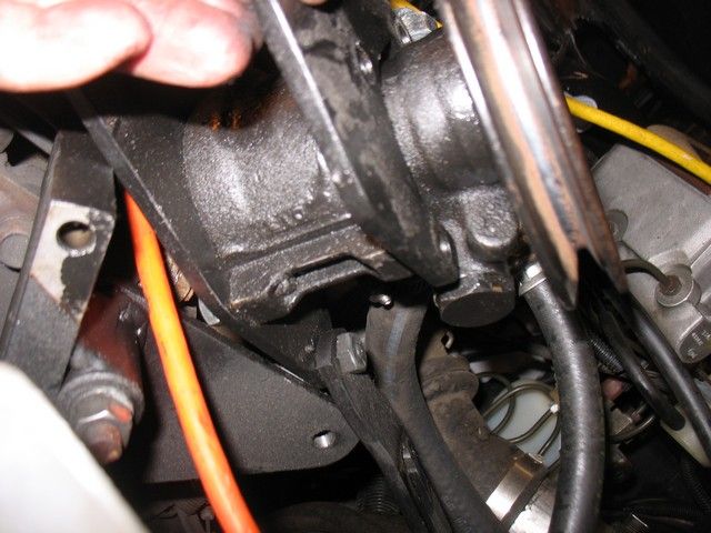

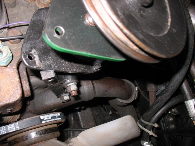

Power steering bracket to be modified, as it mounts to pump
Power steering bracket to be modified, face view

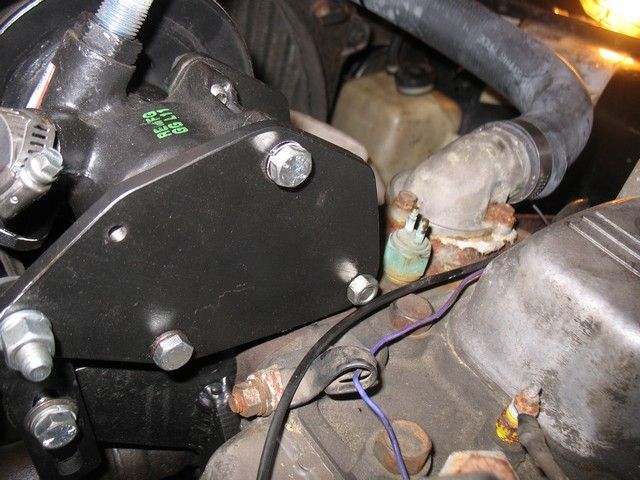

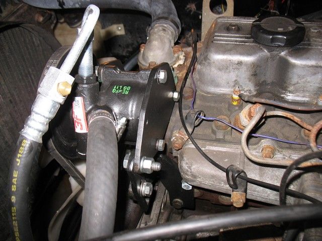

Modified plate back on pump
Power steering pump re-installed

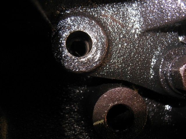

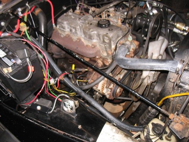

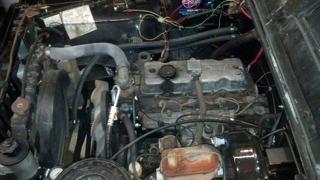

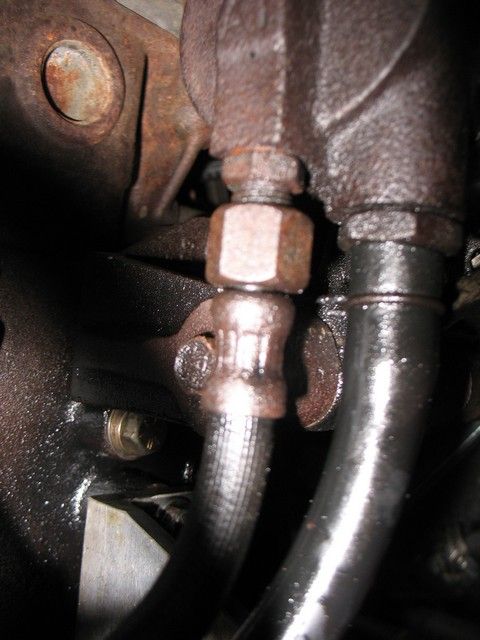

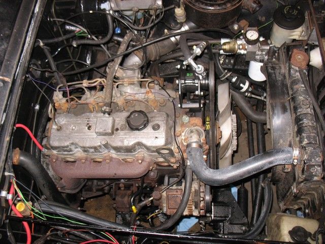

I was able to get out to the garage tonight and work on the YJ though. I had the bright idea to start it up and look around with a mechanic's mirror and the drop light to search for the oil leak. I'd already narrowed it down to a small area below the alternator where the bypass filter is located. Sure enough I could see a small steady stream of oil running down the side of the filter. Following the trail up it looked like it was coming out of the side of the block behind the mounting bracket for the filter.
I shut her down and proceeded to take the alternator, bypass filter, and its mounting bracket off. What I discovered is that the lower alternator bracket mounting bolt was missing and it goes through the block so that you can see the innards through that hole. Apparently the diesel engine vibrations can shake bolts loose - go figure. Ta Da ! I love it when I find the source of a problem and its guaranteed to be the issue and a correctable one to boot.
It took a bit of scrounging but I managed to find a bolt with the right diameter and thread pitch to fit the bill. It also had the correct length and was grade 8. I used a bit of gear oil resistant gasket maker to seal the bolt up and everything is back together now.
I'm planning to head out to Boothbay tomorrow to look at a hard top, a soft top, some doors, and possibly seats for the YJ.
Here's the bolt hole with the bolt missing, with a scope I could see inside the engine
View of engine bay on passenger side
Rear of alternator / vacuum pump, new bolt in lower left of frame
Top down view of engine from passenger side
Video to show where missing bolt is located, use lock washers on everything when you run a diesel!

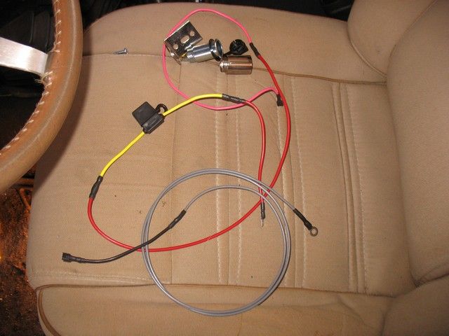

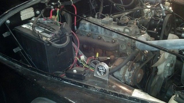

Today I worked with my younger son to get an aux power port installed under the dash. We topped off the oil after yesterday's repair. We also took the back seat out and packed a small toolbox for a short road trip. We headed out to Boothbay for the afternoon to look at a hard top and some other stuff.
Quick power port

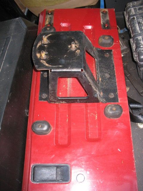

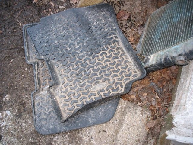

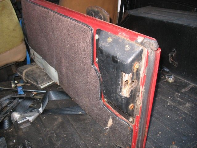

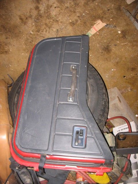

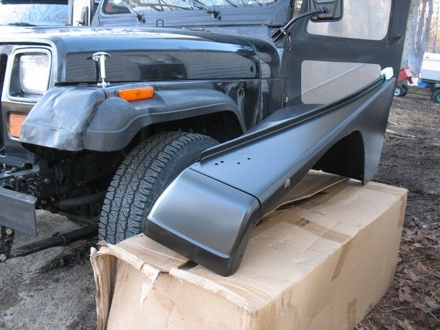

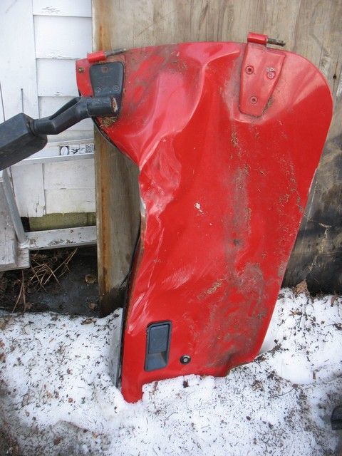

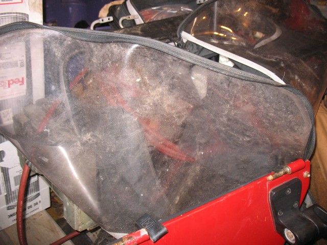

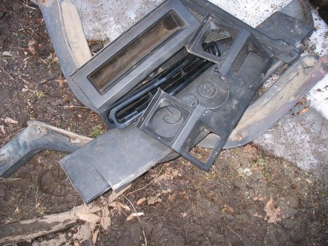

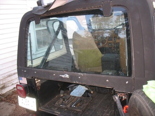

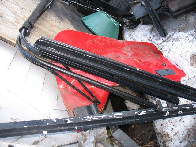

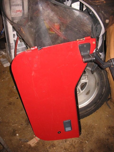

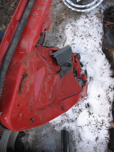

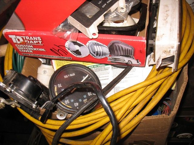

The guy selling the stuff used to have two YJ's but one of them hit a tree, which messed it up pretty good. He's done playing with Jeeps he says and all the parts must go.
Scenic photos

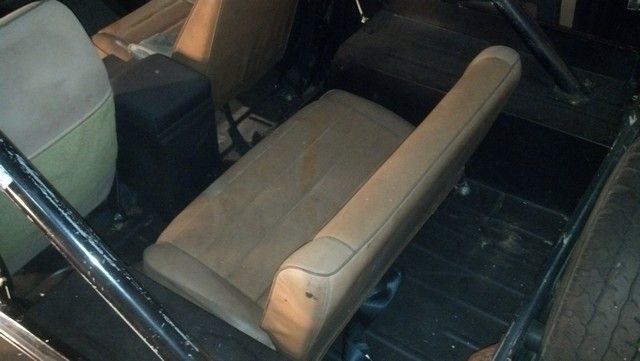

So, we're discussing various Jeepish things and the seller is talking me in to taking more of his stuff. He walks around my YJ and says "boy do I have a treat for you". He goes to a large cardboard box that is taped shut and says "this is a front driver side fender, new in the box, never opened". Sure enough, the one piece of bent body work on my Jeep is exactly the one new piece of body he has. Outstanding!
One good hard half-door
One not so good
Lots of dash related bezel pieces, all in black (mine are tan)

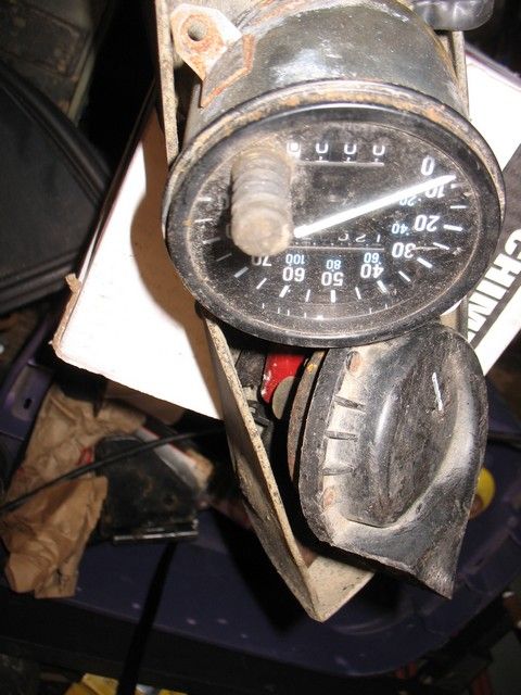

stainless rear diff cover, tachometer, windshield wiper motor
Half door top skins, mounting hoops not shown
Soft top
Set of four Quadratech slush mats
Speedometer, horn

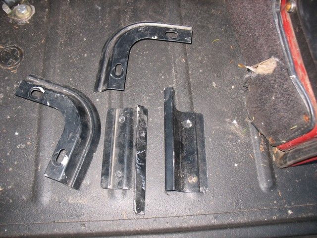

Soft top mounting hardware, including tub rails
Tailgate
Oh yeah, and a hard top - the reason I went
Not photod are:
Grill inserts
gauge cluster
headlight switch
two front fender flares (two pieces each)
one rear fender flare
two hard half door striker mounts w/ hardware
mounting hardware for both tops
chromed and flame throwing rear view mirror
and I think I've forgotten some stuff
The seller was asking $400 for the hard top in a previous listing, I was thinking that's fair and maybe a couple hundred more for the soft top. I had $600 cash with me. He gave me everything for that $600 and was glad to have it gone. I feel like he's passed a baton of jeepdom on to me. He was a YJ owner but is now done. I'm a new YJ owner and I've got his stash of parts.
Oh yeah, a set of gaskets for my 258 straigh six for the CJ5 too.
(and I'm sure I've still forgotten stuff)
