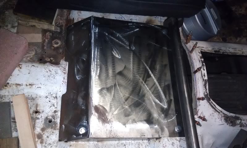

some time last week when thinking of a cage design for my scrambler that stupid hump on floor always got in the way so i decided to just cut it out and reinforced it and make an access cover for the t-case still need to finish it up.......

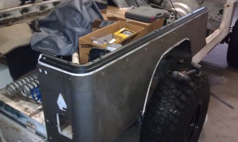

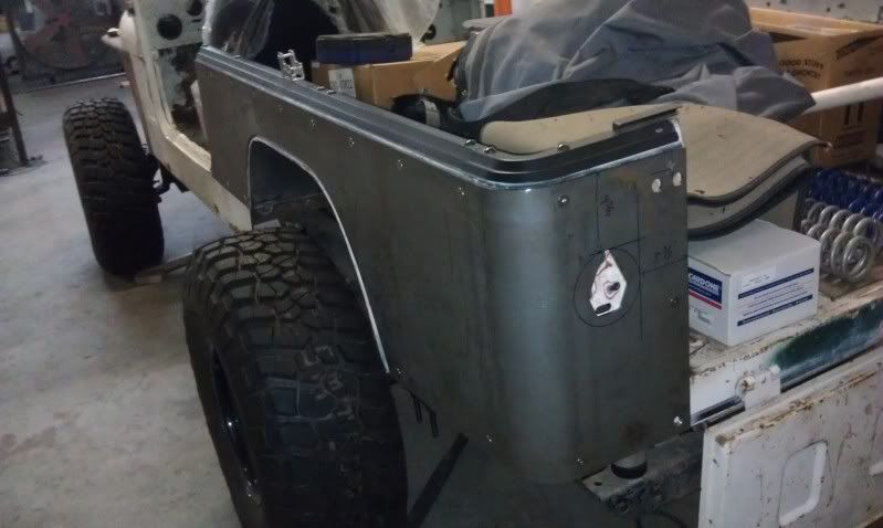

did some work on the inner fender wheel wells only one the driver side...... it took forever lol but the other side shouldnt take that long, oh i still have to clearance around the coil-over still

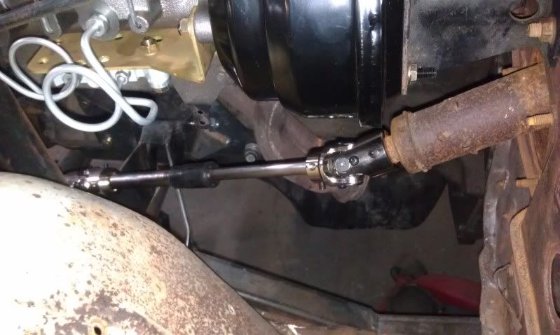

t-case shifter

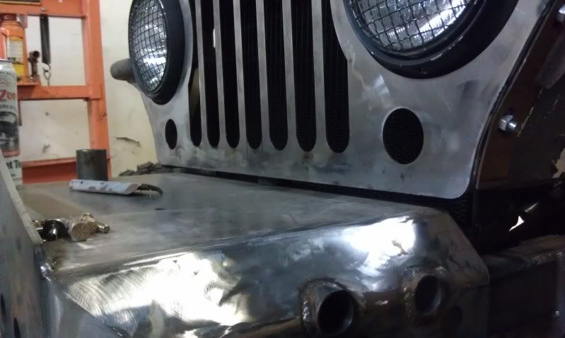

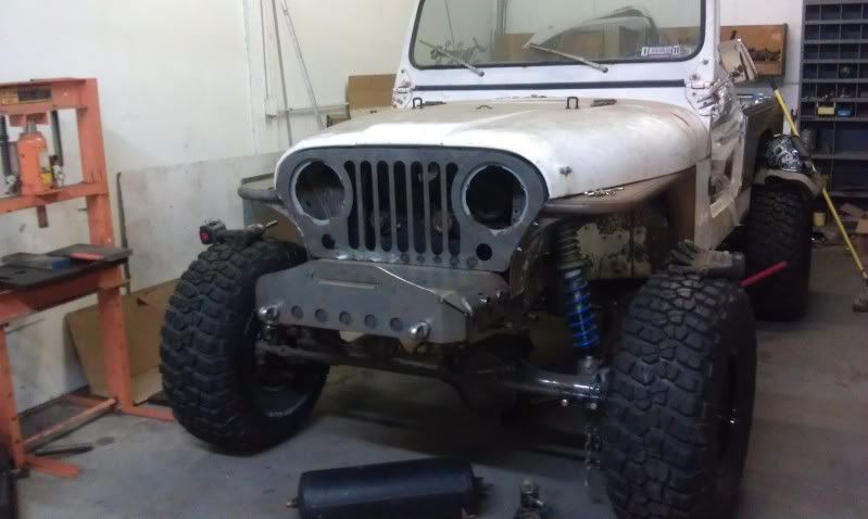

still dont quite like it..... i might have to do another grill but 1 inch shorter...... well see lol
if you like it cool.....
finally lifted the grill and now it looks alot better

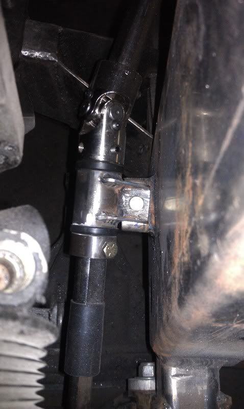

pisc of the support and collar i made

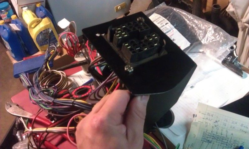

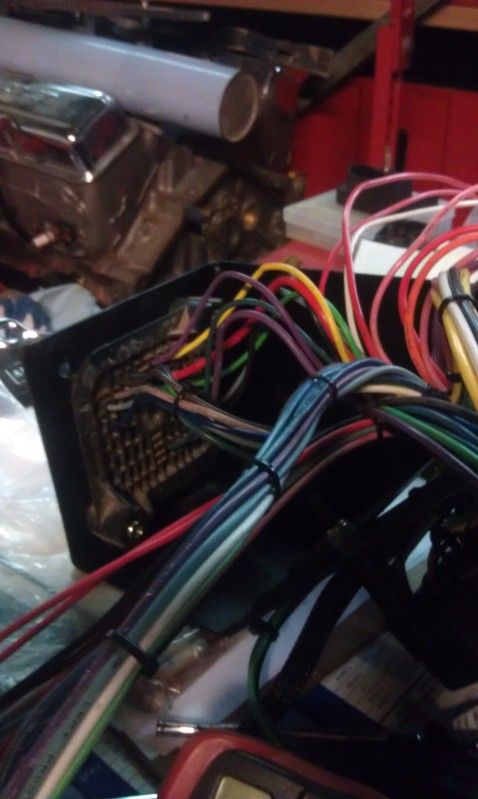

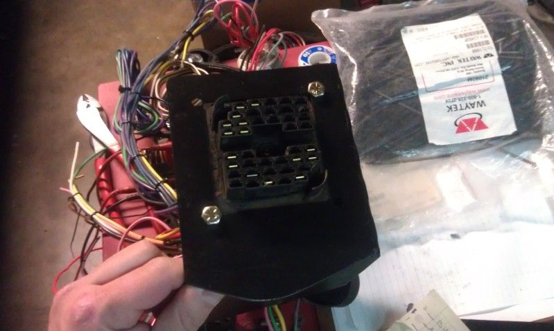

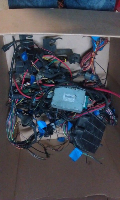

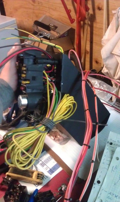

heres a few pics of my wiring under my dash..... i made the fuse box holder
heres the harness for the motor..... thats almot finished

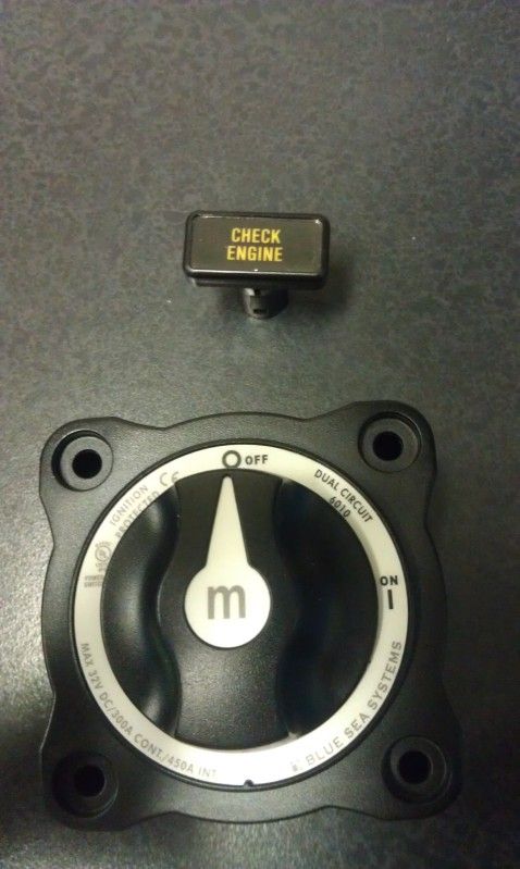

cut-off switch and indicator lights im going to use

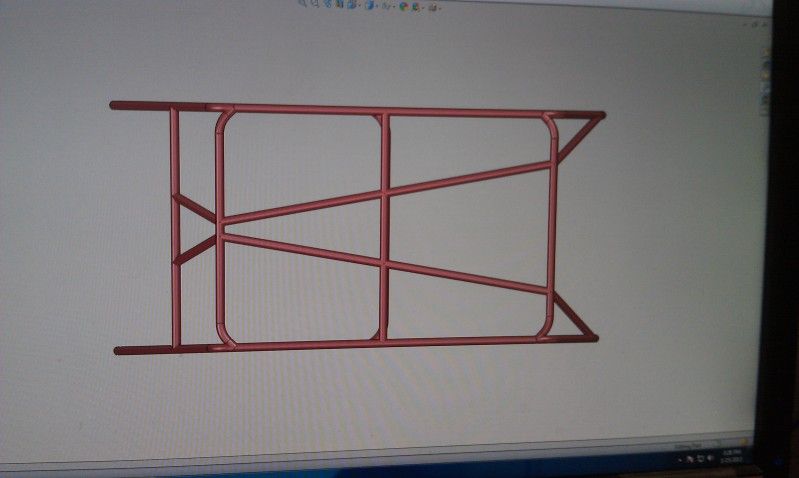

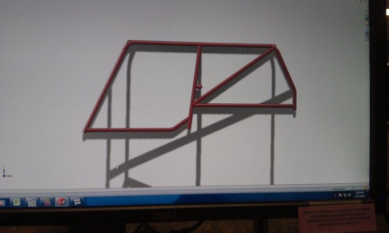

1-28-13
did some work on my cage in solidworks..... i came up with 2 different styles i like so well see what i go with still need to add gussets and other tube so don't freak out people lol

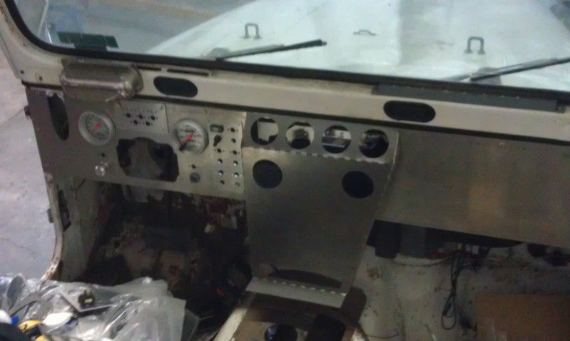

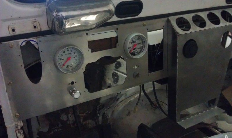

sat. early morning i went to work and got a new dash cut out..... what u guys think ???? the center piece part is going to get a few more cut outs......

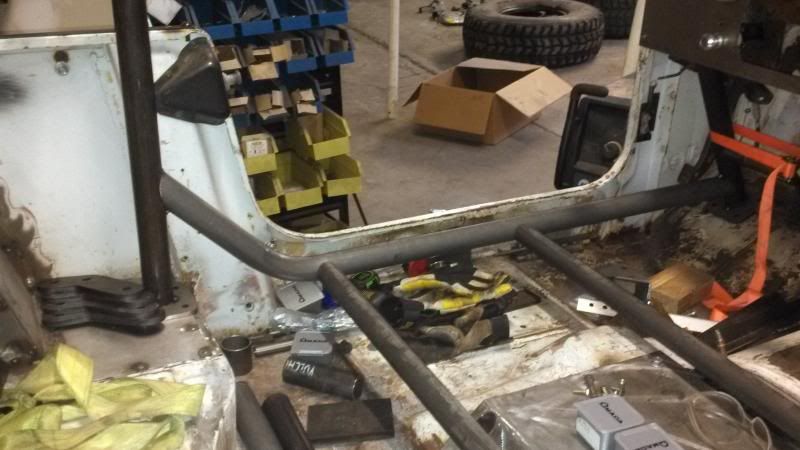

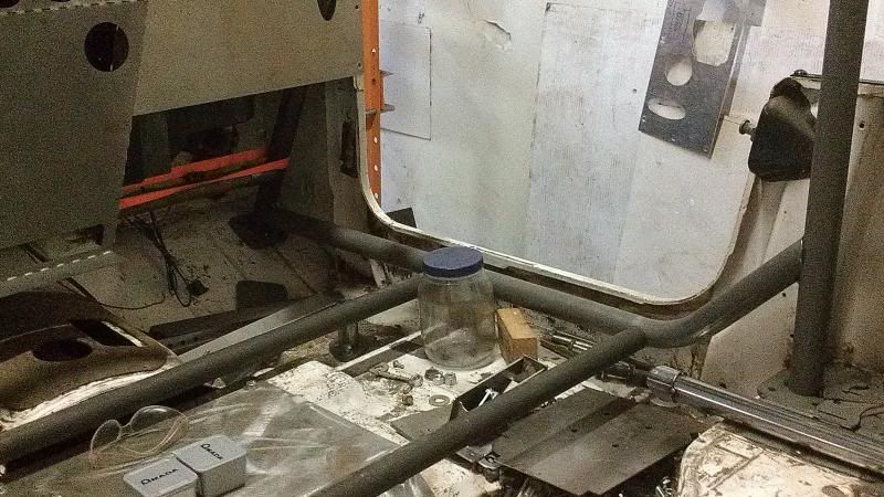

2-4-13

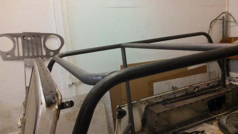

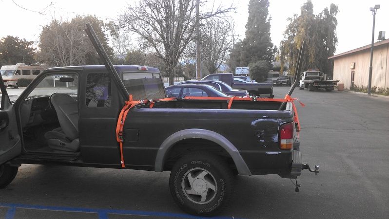

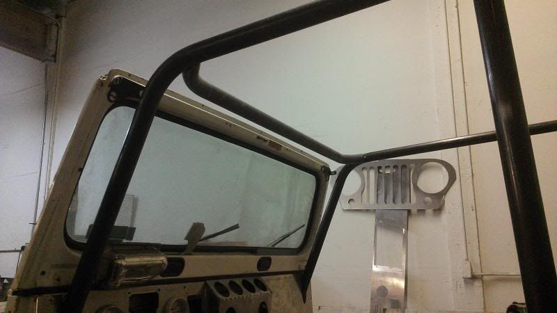

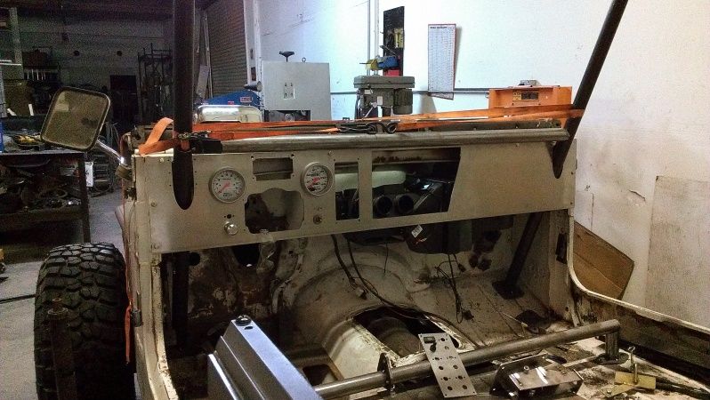

last week i took some tube to a local business to cnc bend my 2 main hoops from 1 3/4"x.120 dom, i took him my scrap monster and he made what i gave him...... then on fri i went to go pick them up..... it was kind of nice not having to worry that i was going to over bend it or screw up some thing since im way to meticulous on almost everything i do lol.......
so...... what u guys think???? do tell
3-19-13
ok no more page 2 lol....... did some work on the cage this weekend.....
