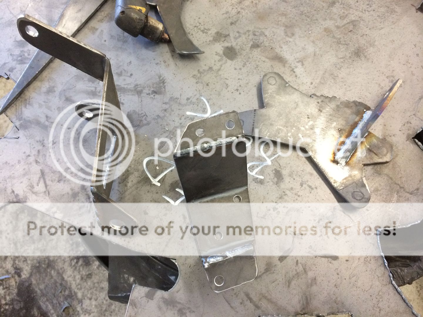

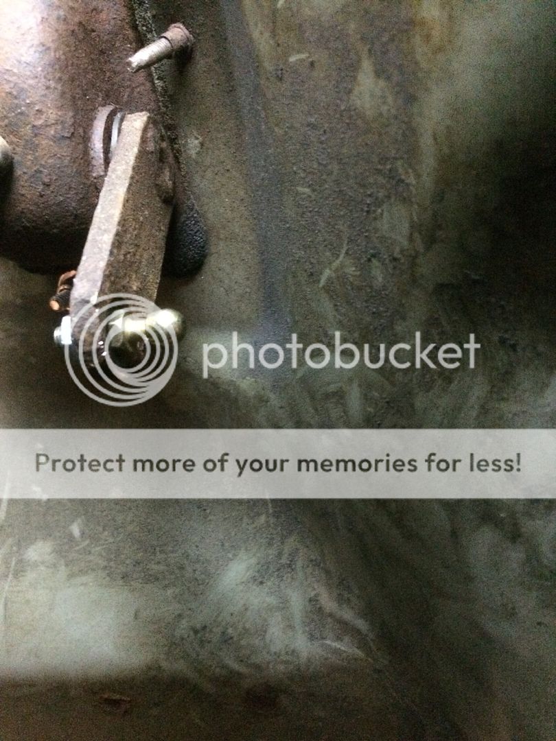

made another set of 231c brackets.. and a gas pedal bracket for a hemi lol..
fender flares and wheel spacers going on.

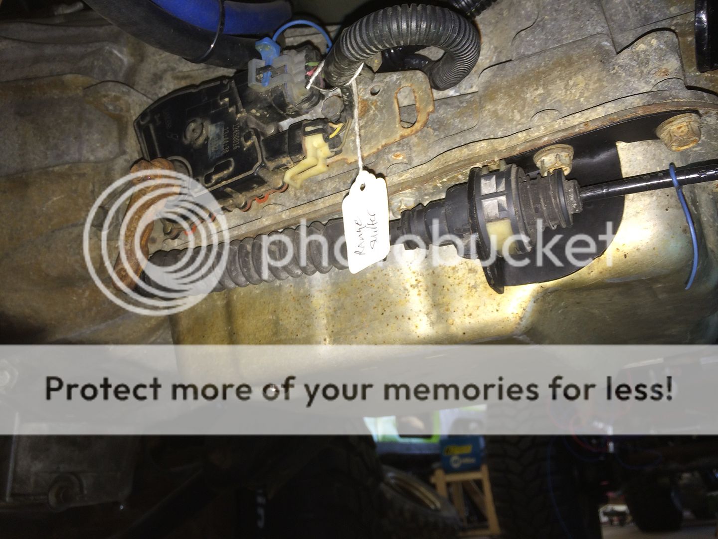

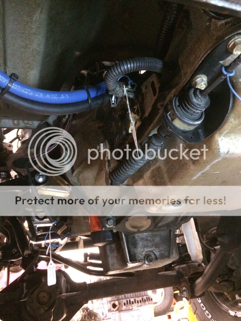

4wd shifter cable set up...

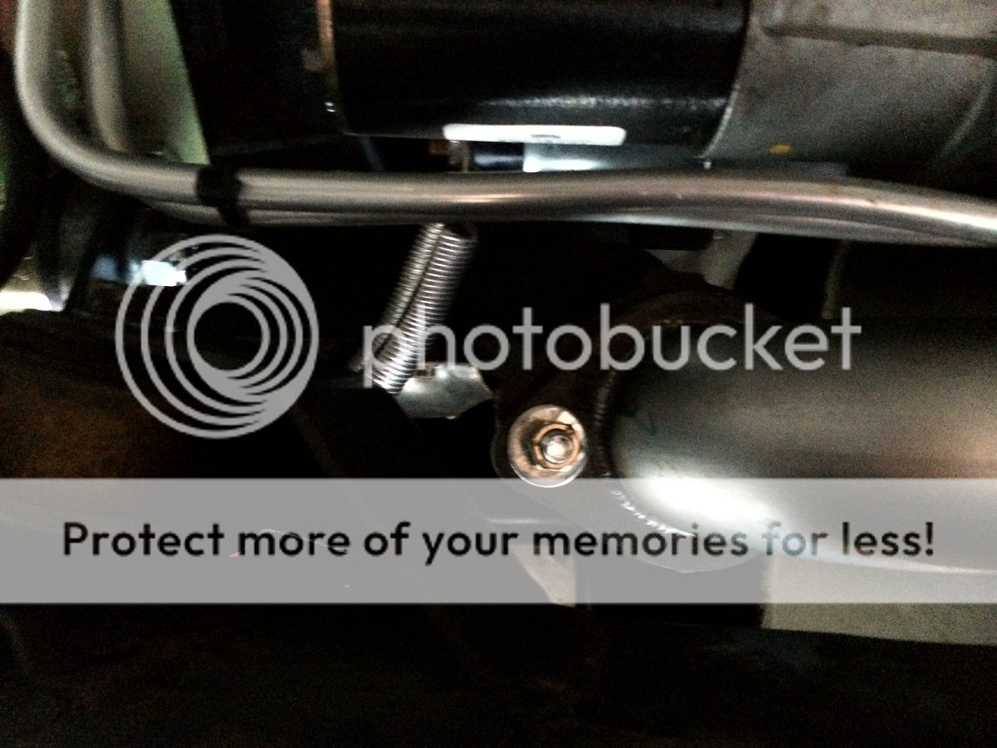

not a bad line at all...

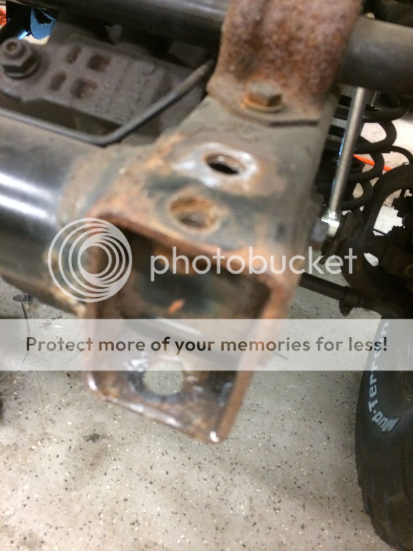

removed the front bumper weld nut form inside the frame. the old bolt was sheared off and I just decide to replace it..easier... plasma'd the old welds off, knocked it off and in with the new..

shifter cable and bracket in...

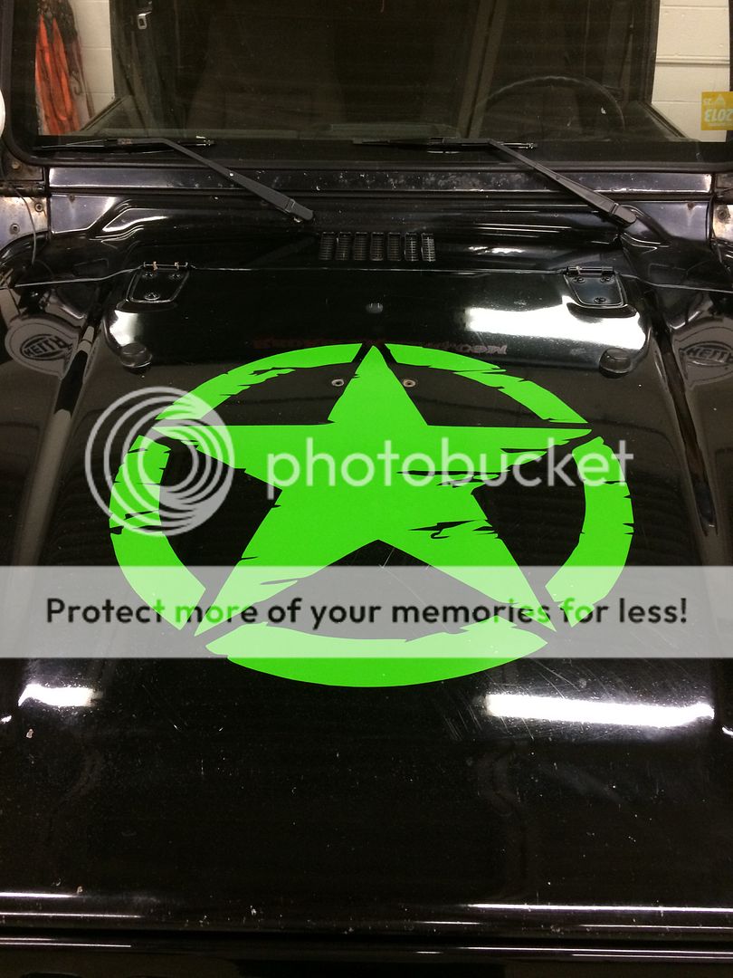

we have the frame plates all welded in and the cross-member painted and 'final' installed.
then I said lets add a little color to this girl. going to carry the star and color into the gauges as well. should look sick.

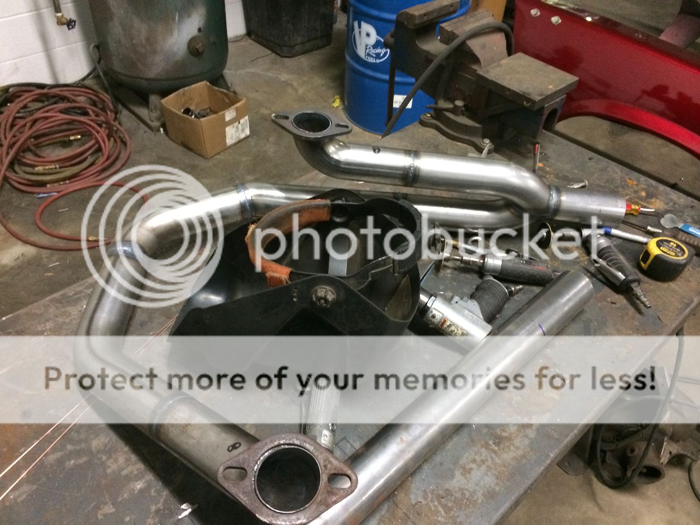

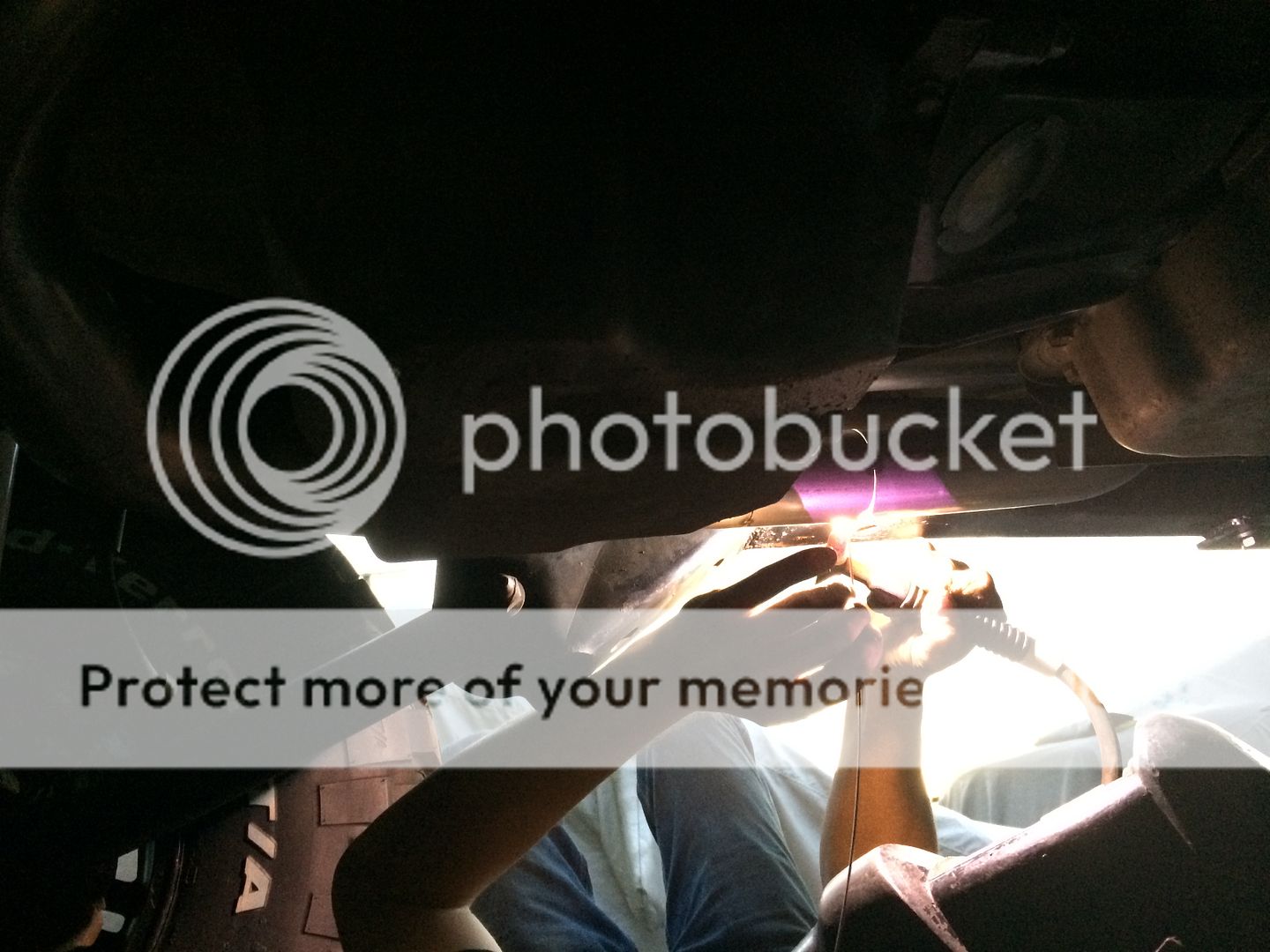

little more exhaust from yesterday night...
you can see the sharpie circles... that's where the o2 bungs went in...
I dropped her and the hemi rubicon at the exhaust shop tonight so that they can get to them first thing in the morning. so both will be done tomorrow. I just need to order 2 o2 sensors for rock auto.. which I am going to do right now....

the exhaust system is finally complete... couple more little loose ends and shes ready for a new home...
