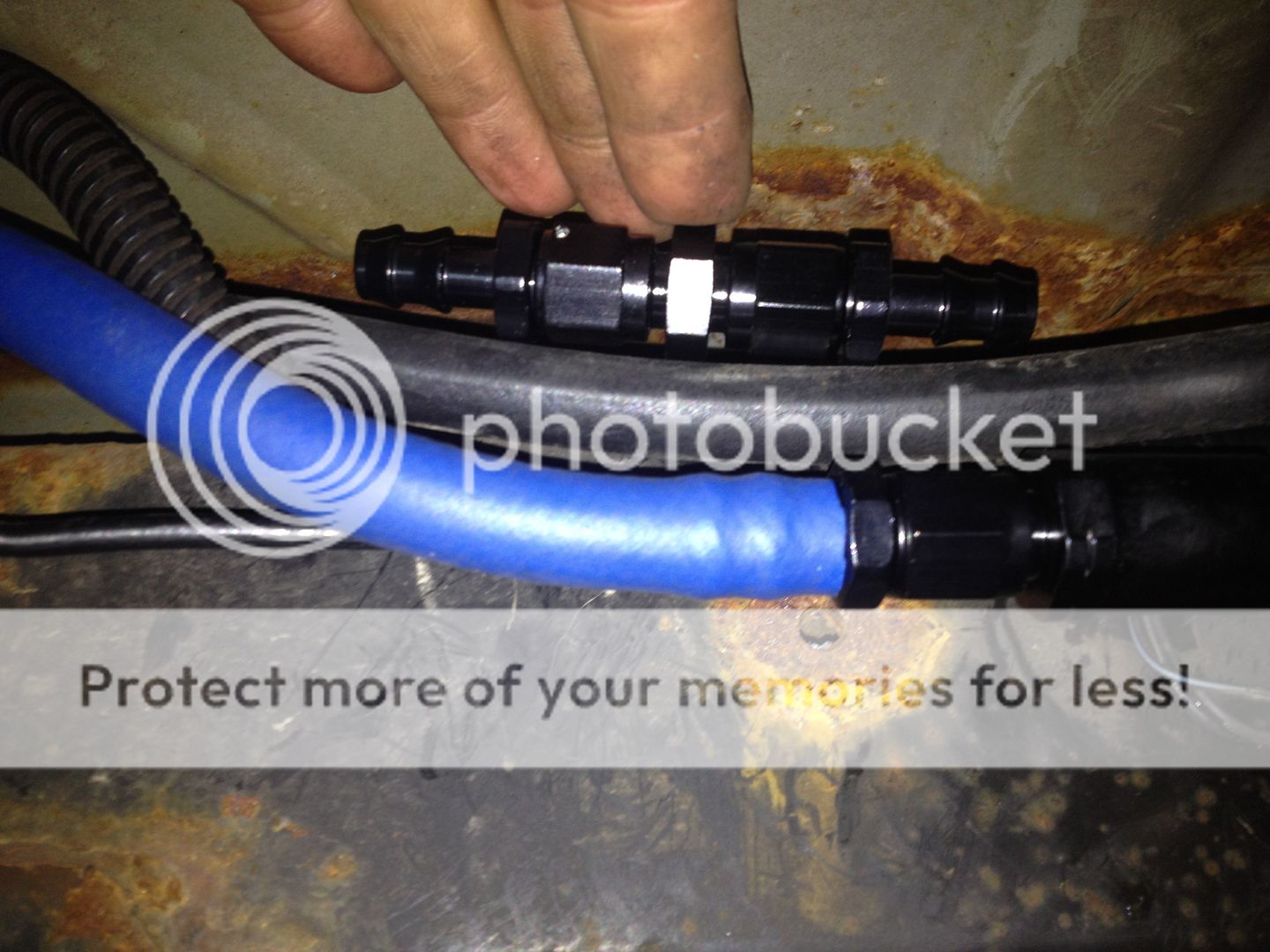

fuel system continued.

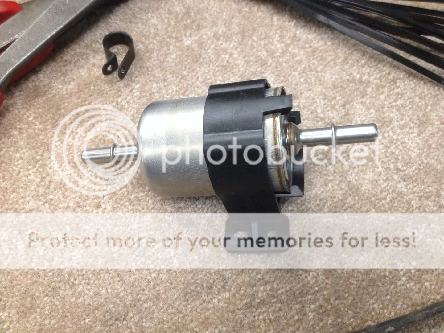

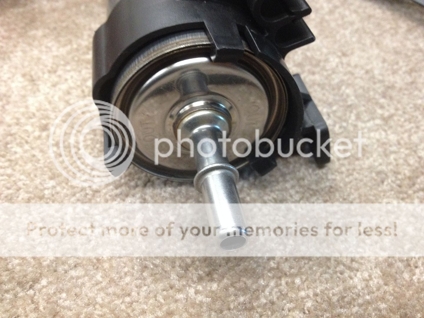

The 5.3 ls that went into this jeep has the pressure regulator on the fuel rail so it needs a line up to the motor and another coming all the way back.
I like the idea of an external fuel filter as well as it provides a place [with purpose] to 'break' the fuel line run. if you have to pull the tank, you just disconnect from the filter.
obviously we aren't going to filter the return line, but it still needs a 'break' in its circuit as well, so I just throw an union in there close to the fuel filter. easy and simple... convenient.
heres the new fuel filter of choice. it has a plastic mounting clip, but the cool thing is that it has integrated 'retention channels' in it as well. 3/8" efi nipples on each end. perfect.

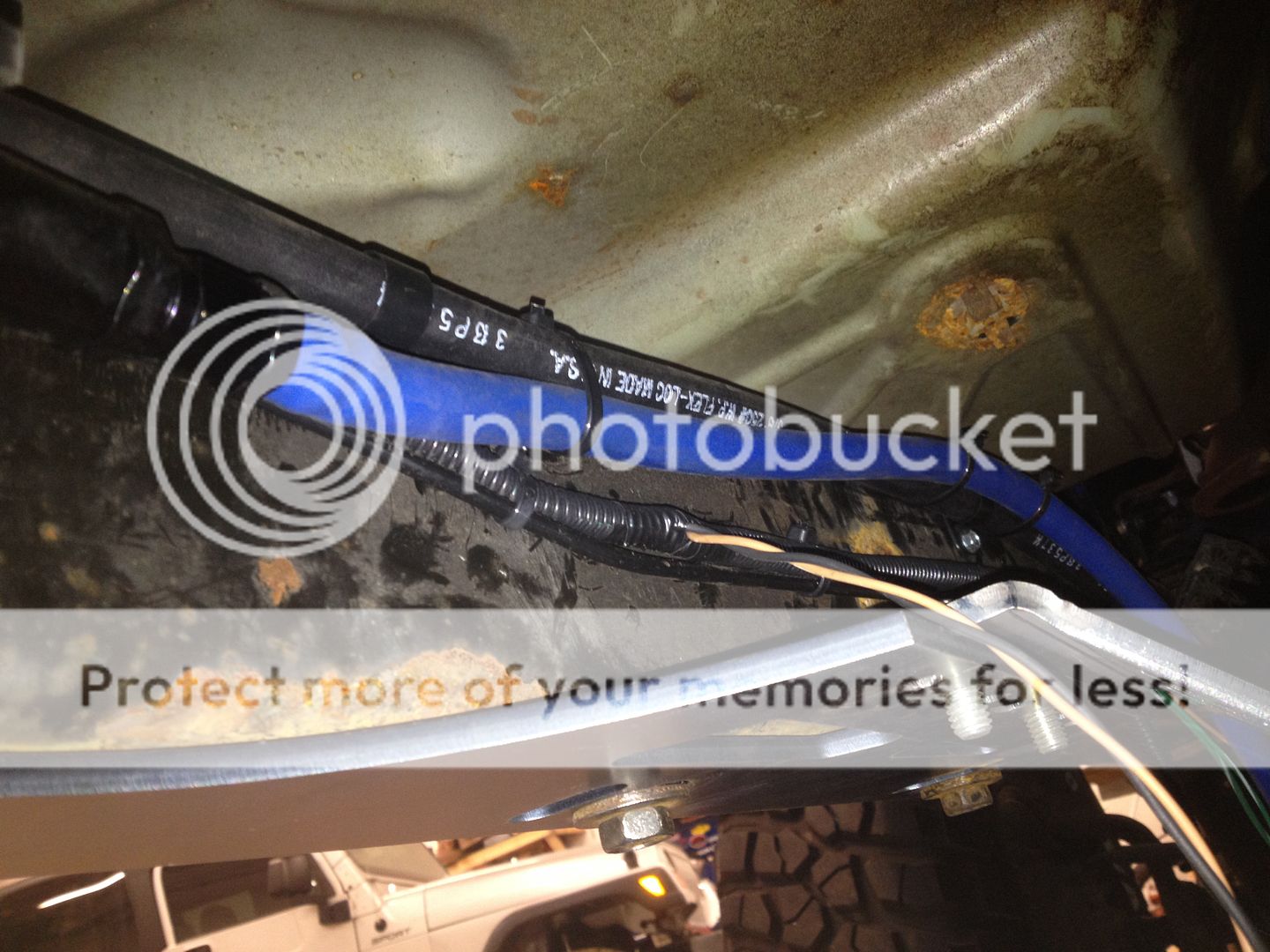

time to run the lines...
mounted the fuel filter on the frame. secured the fuel pump, fuel level sender and the 4wd switch grounds here as well. then locked on the efi fittings to start putting the lines together.
once the pressure side lines were cut and ends installed, I connected them to the new fuel filter. now it is time to cut the return line and install our 'service union.'

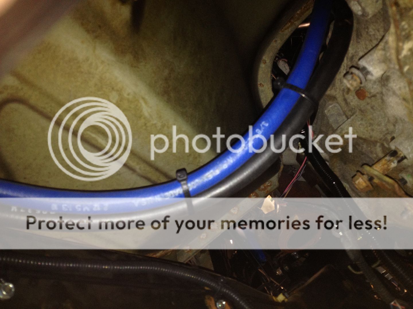

once installed, we continue running the fuel lines forward, along with the 'rear' harness.
and then up to the fuel rails on the motor
now that it is all 'set up' and I like the way things are, I have to go back and tighten everything down. That is the best way to do it. Just build your system, snugging the connectors up and continuing till your done. That way you tighten your connections all at once and your done. you don't miss and its just easier to work with until your satisfied with the results.

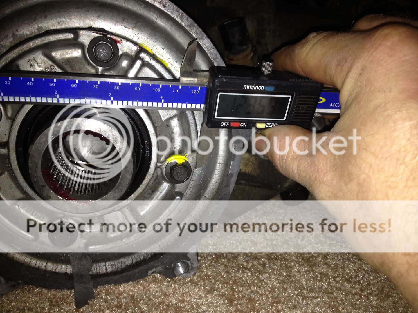

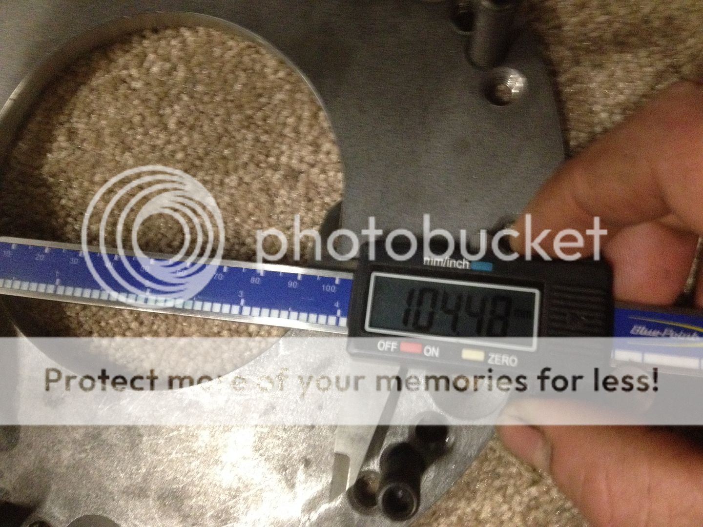

I ordered a s-10, 5 bolt clocking ring for the 231c case just to keep the project moving. it showed up in 'damaged' packaging. Thus, it was missing studs/set screws whatever. They offered to credit me for the missing pieces and told me what I needed to replace them. OK but maybe increase the quality of your packaging materials. for what you charge for the clocking ring, you can afford to ship the fawking thing in a durable container. WTF! youre shipping a 3/8" thick, 9" diameter ring in a paper bag, seriously.
issue one resolved with a trip to Fastenal. fine. needed other stuff anyways.
onto issue 2... bout 15 minutes ago, I crawl under the jeep to mock up the clocking ring on the tcase. One small problem.... the inner circle 'cut-out' on the clocking ring is TOO SMALL TO FIT OVER THE FRONT BEARING RETAINER ON THE 231C... JUST AWESOME... thanks for the set back in my project again.
we aren't talking about a difference of a few mm, we are talking almost an inch in diameter differences. SERIOUSLY. Bearing cap outer DIA 123.59mm opening in their 'clocking ring' DIA 104.48...... hmmmm.
231c
clocking ring
ehhhhh!!!!!!!
