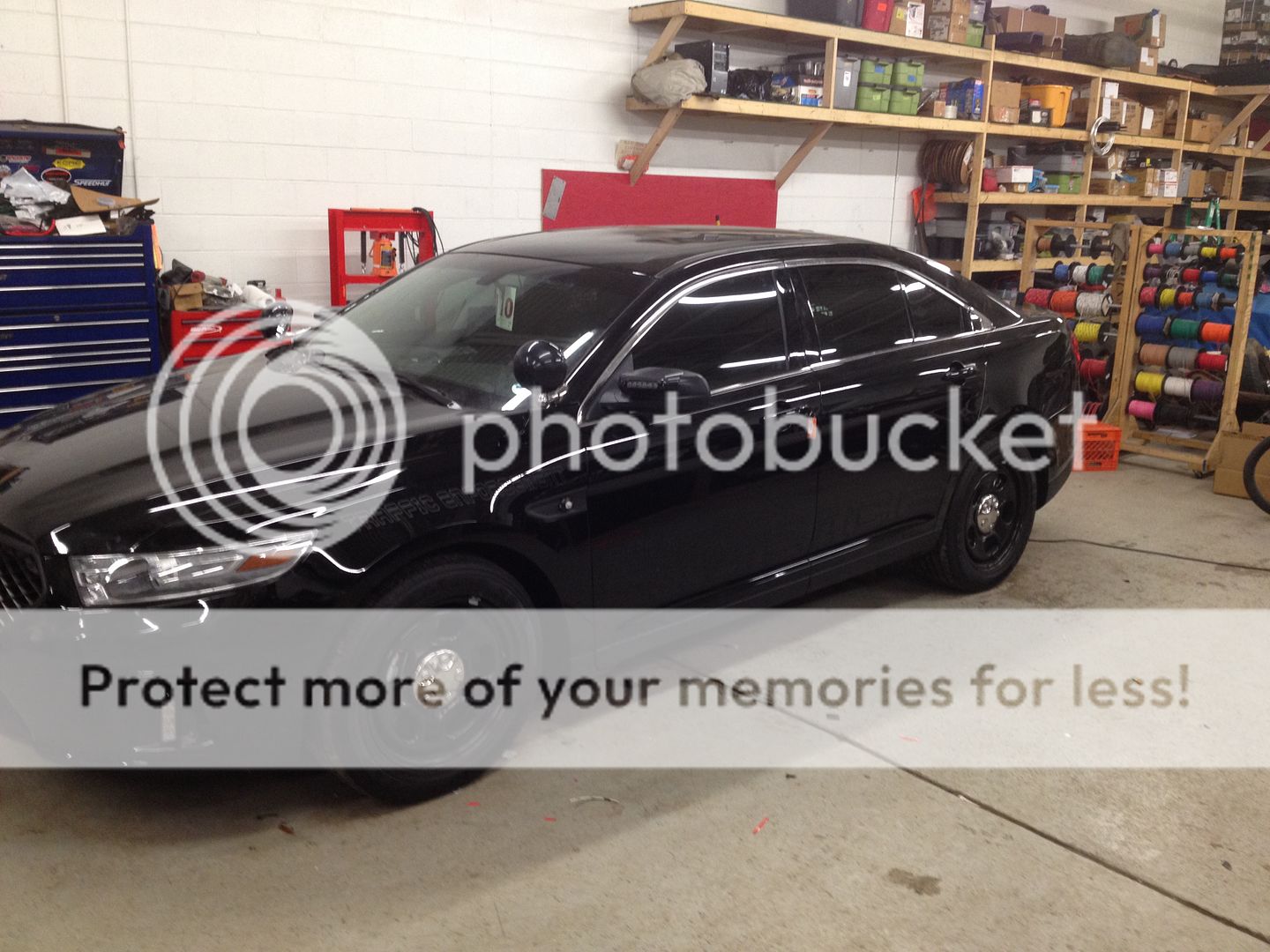

well the cop car is 95% finished, buttoned all but 1 stupid panel up tonight. looks sick. department will be happy. he wanted subdued light package and subdued graphics-think we delivered. it does actually say police on the side. pic 2 is proof LOL
finished....
fun
finished.. working in these trunks sucks compared to the crown vic!

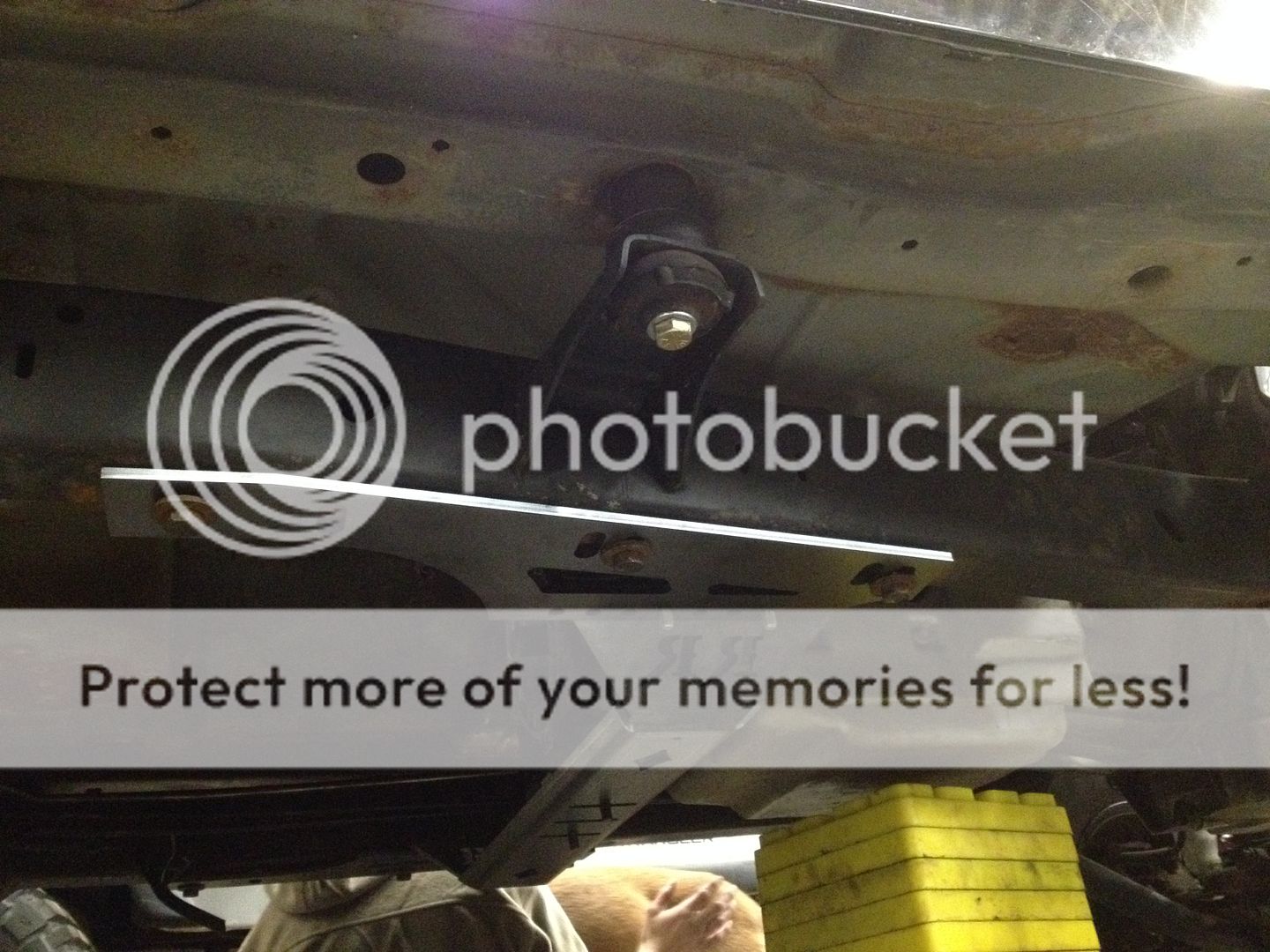

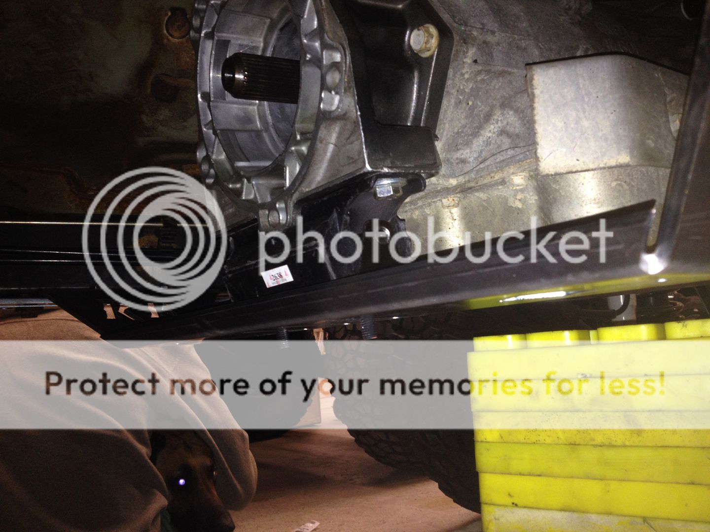

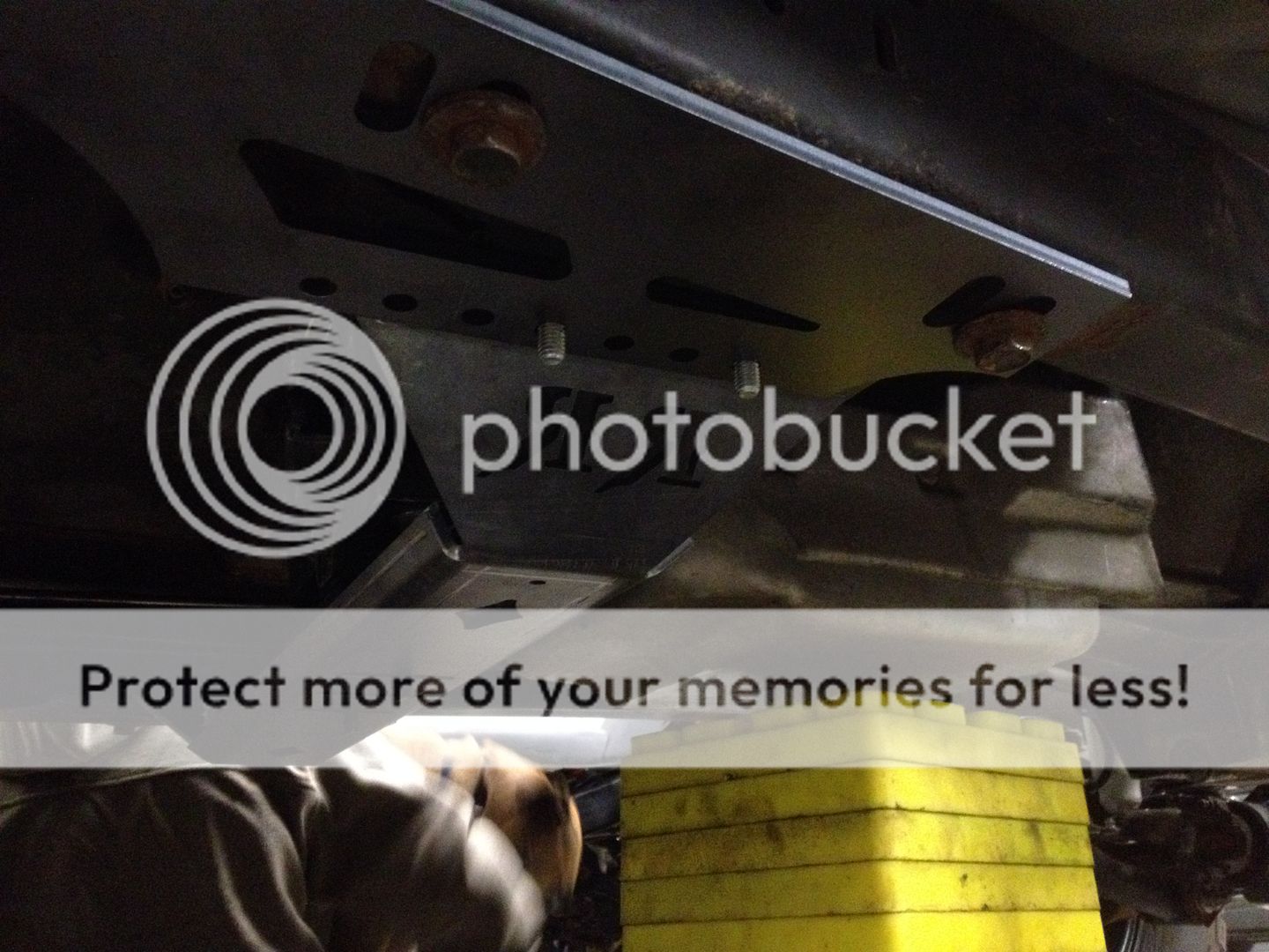

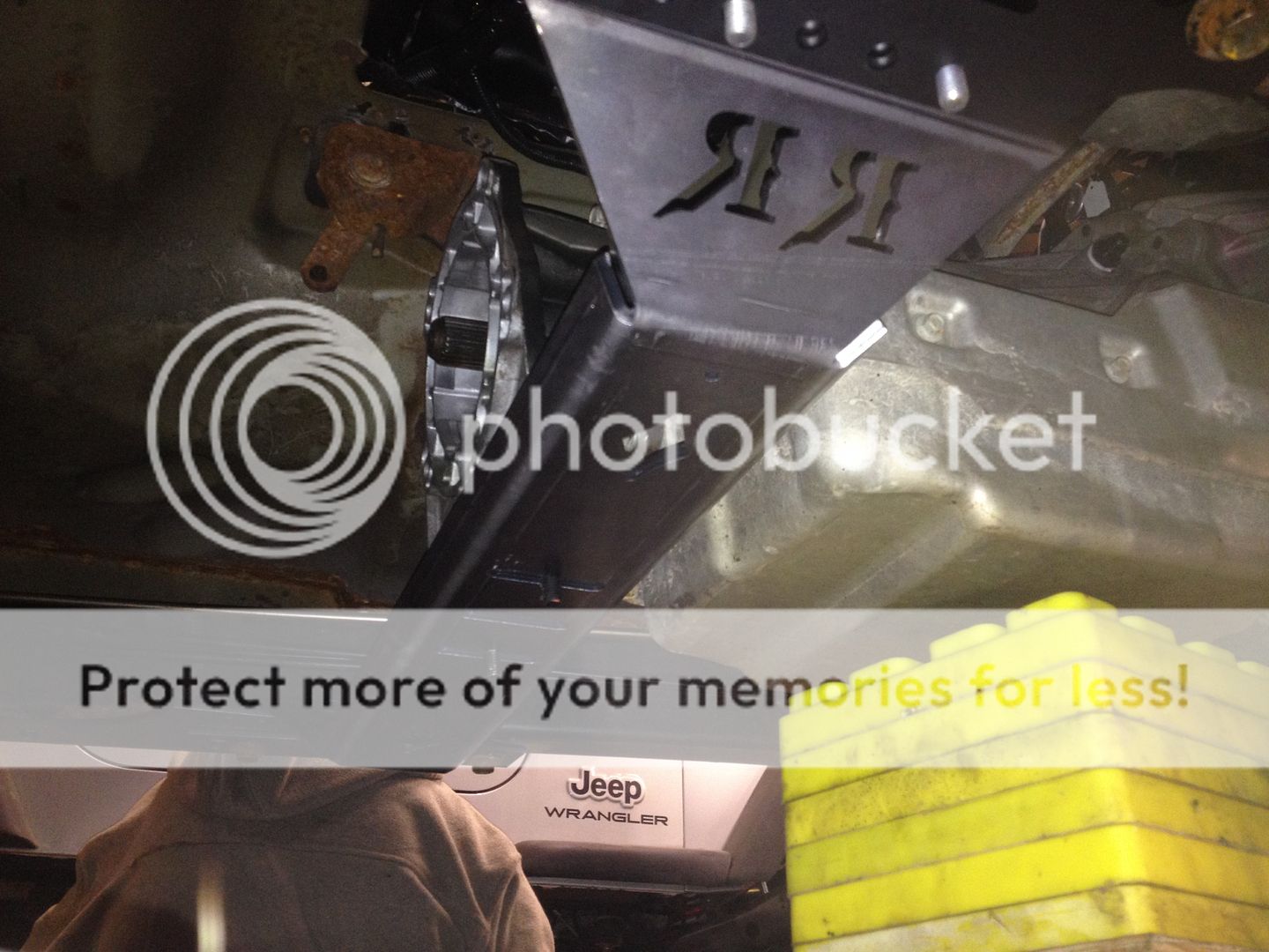

I was able to pick up the revised X member from the forming shop. looks good other than they guy bent it backwards [initials to the inside vs the outside]. no worries. wont be an issue again.
pulled the original prototype off the jeep and set in the new one. I like the side plates better now with the frame profile match cut. the piece and system looks good and fits well. I will make a couple small tweaks and shes good to go for production.
the revised X members have the correct off set for the LS based swaps, [2] drain holes and are form bent. the frame plates are now cut to match the frame profile.
installed with a stock GM 4WD trans mount

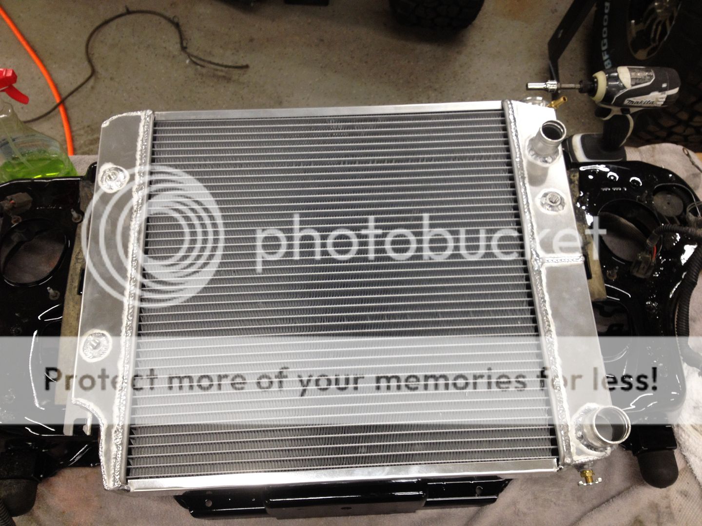

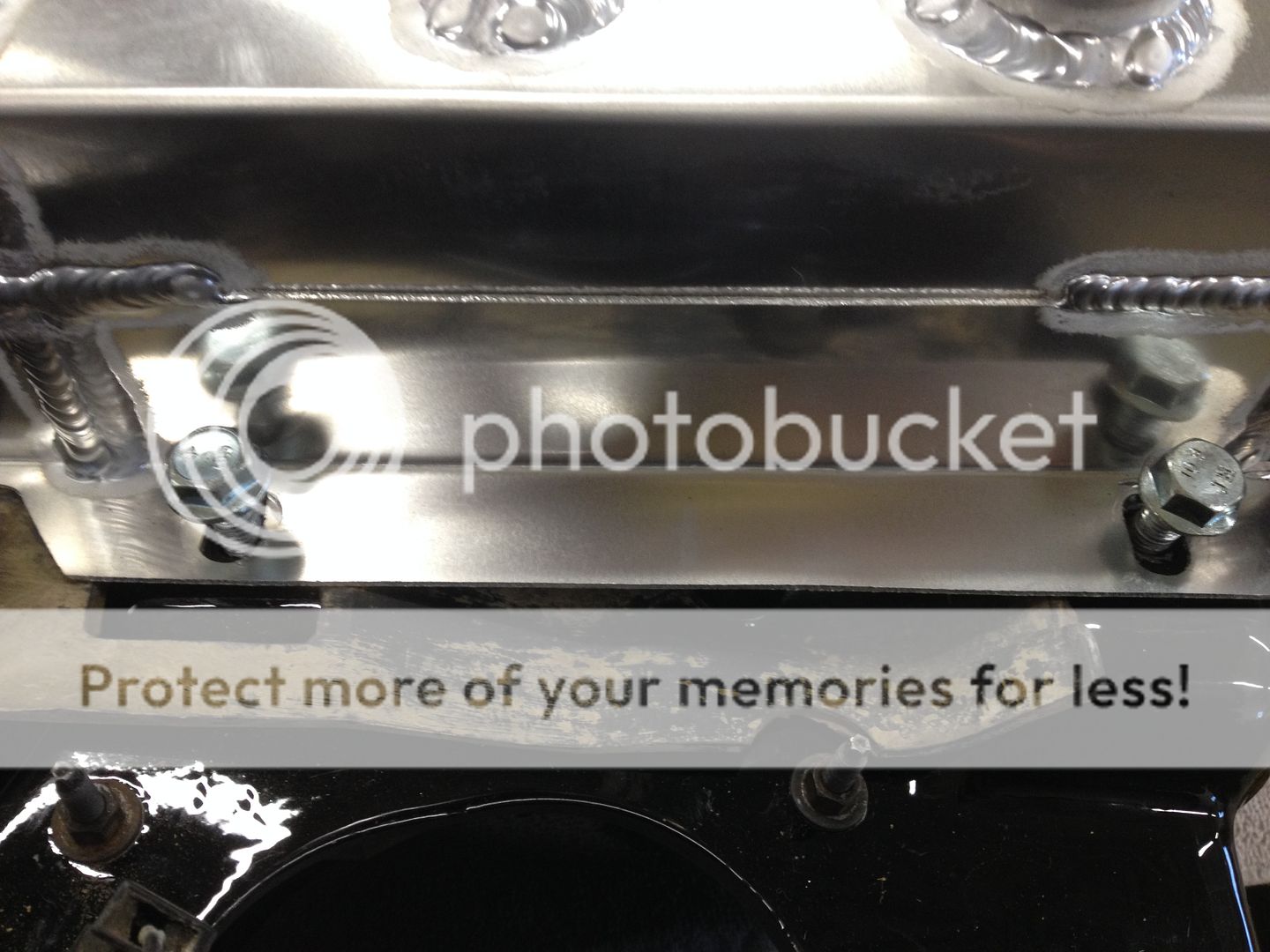

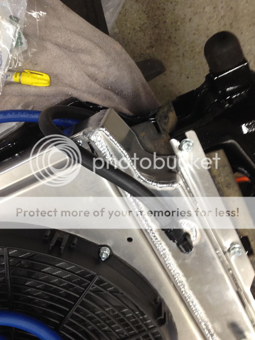

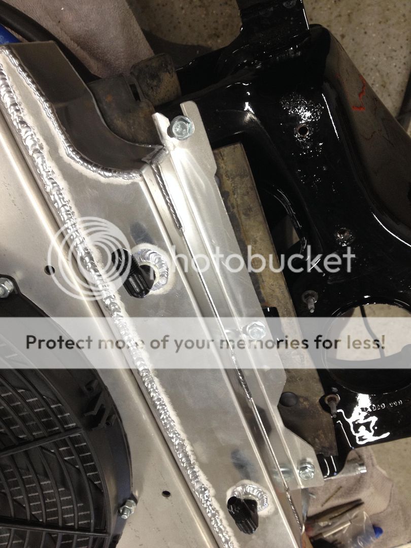

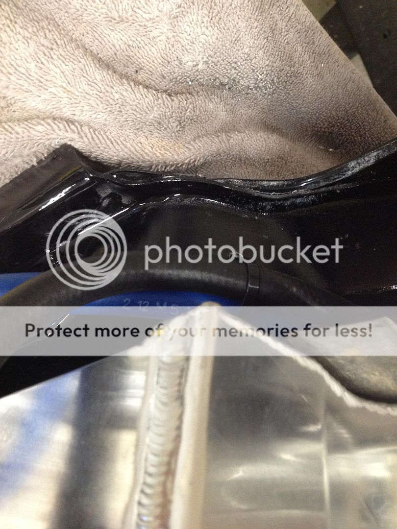

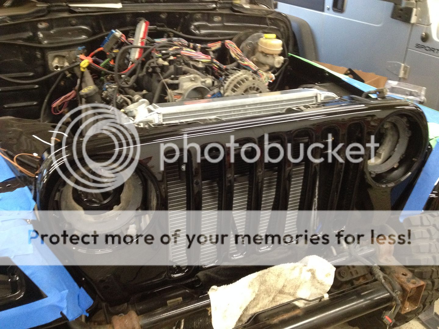

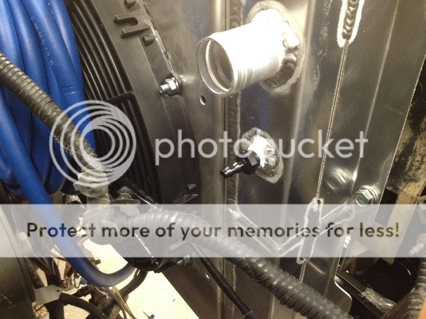

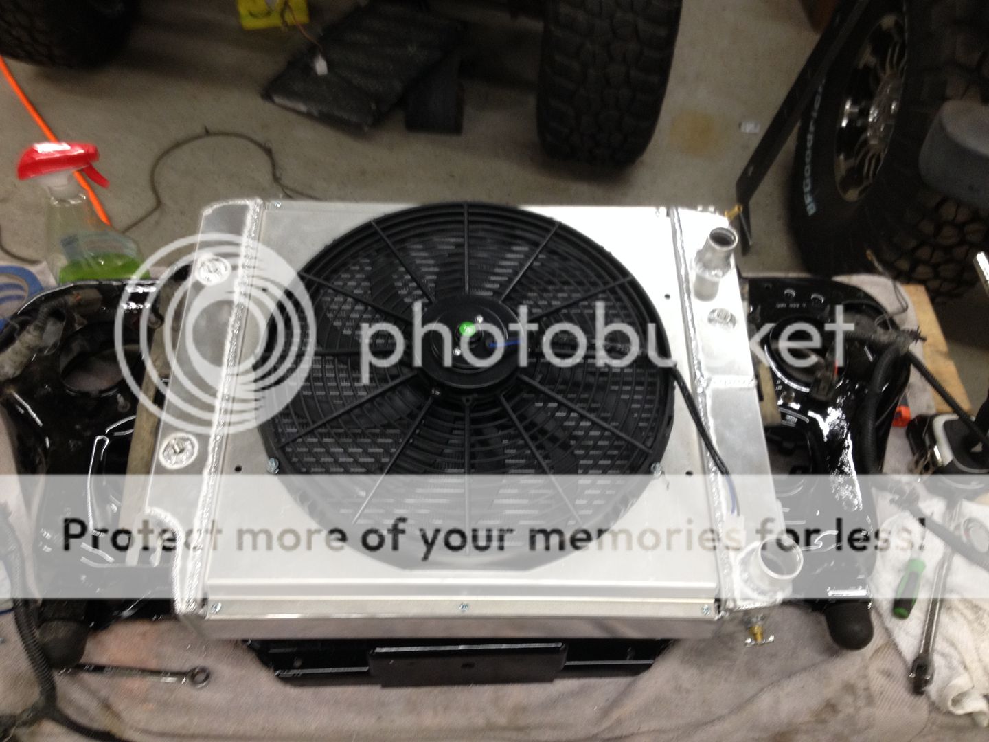

I got the cross flow radiator corrected the other day by the rad shop. Talked with the owner again and he said he will make sure that the LS rad's are set up this way for me. Ok.

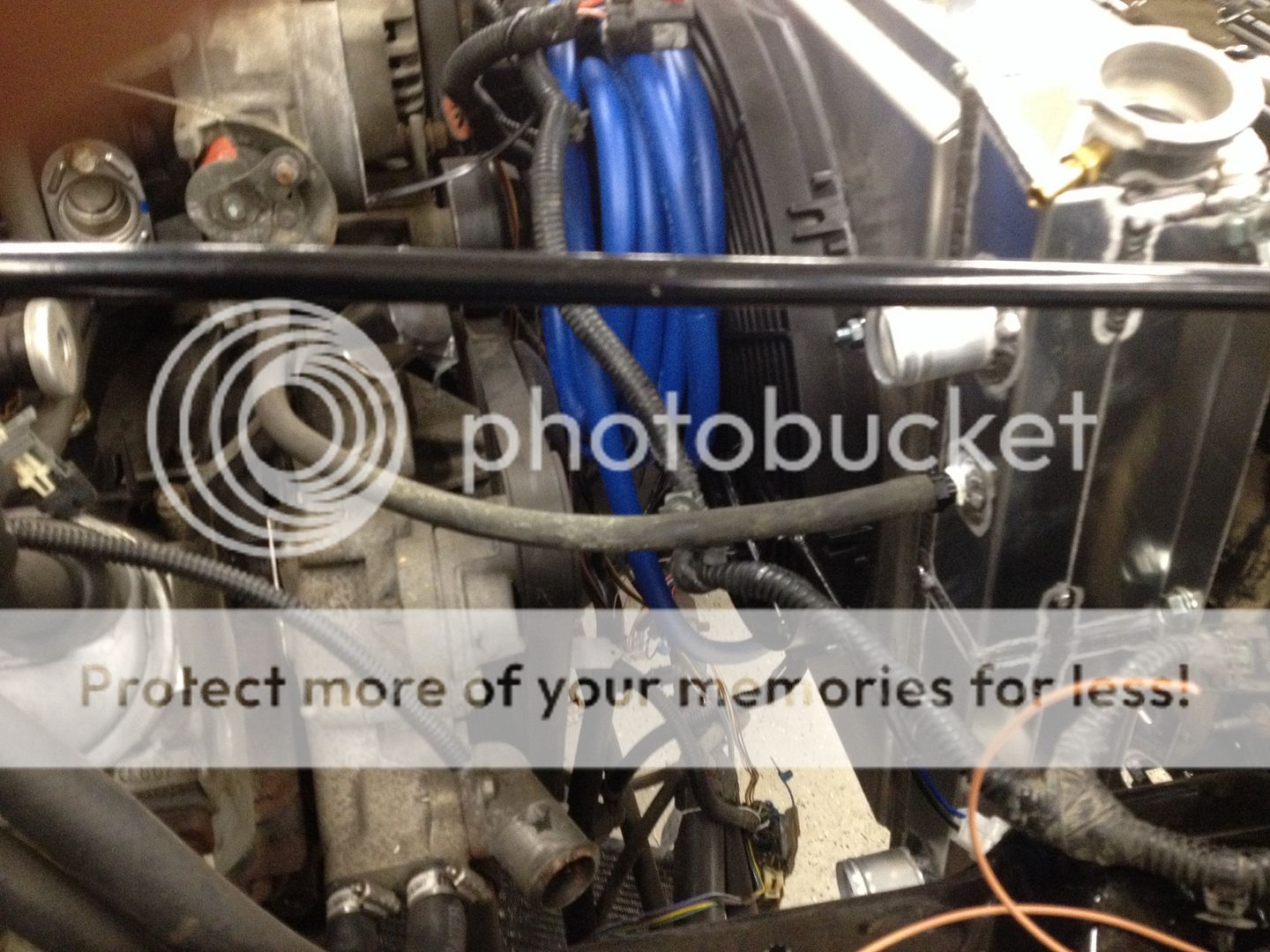

I cut out a new profile for the trans cooler bracket. Reduced its overall profile by 25% or so and made it so you can mount it anywhere on the grille brace (high low middle etc). I like this version a little more than the last.
Started putting the grille all back together. Headlight wiring and buckets installed. Extended the washer fluid pump line (stay tuned for that). Got the trans cooler mounted, just have to wait on fittings to come in from the speed shop now.
Set the radiator up and installed our modified fan shroud and electric fan.

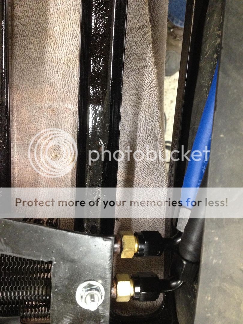

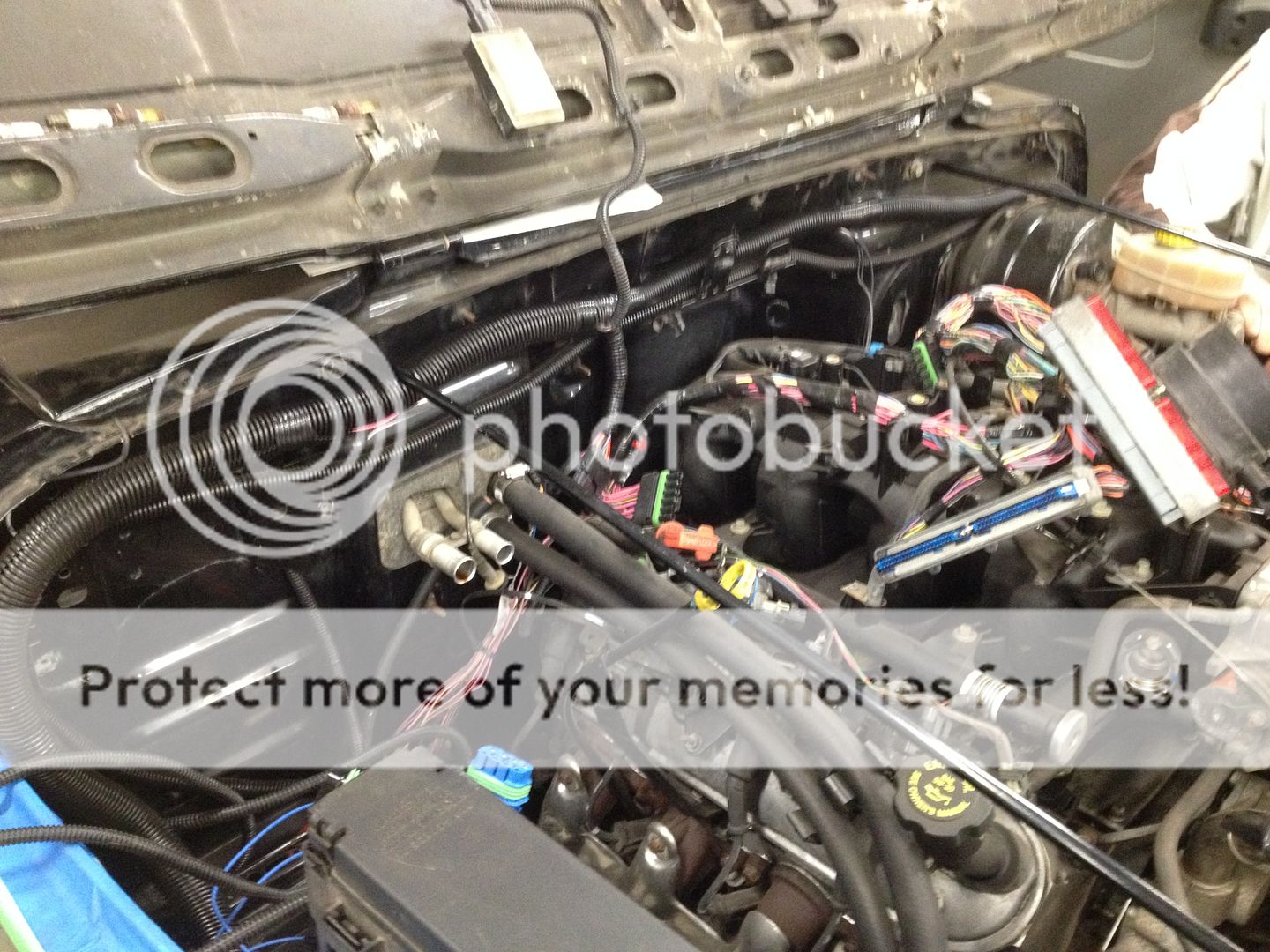

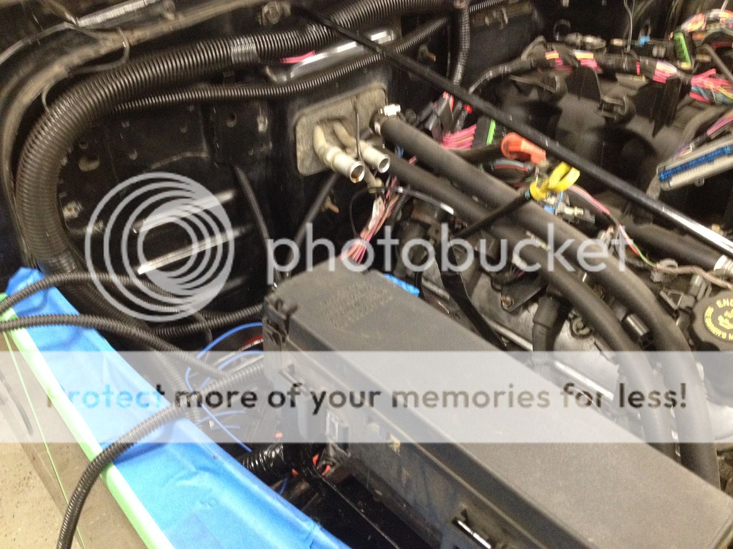

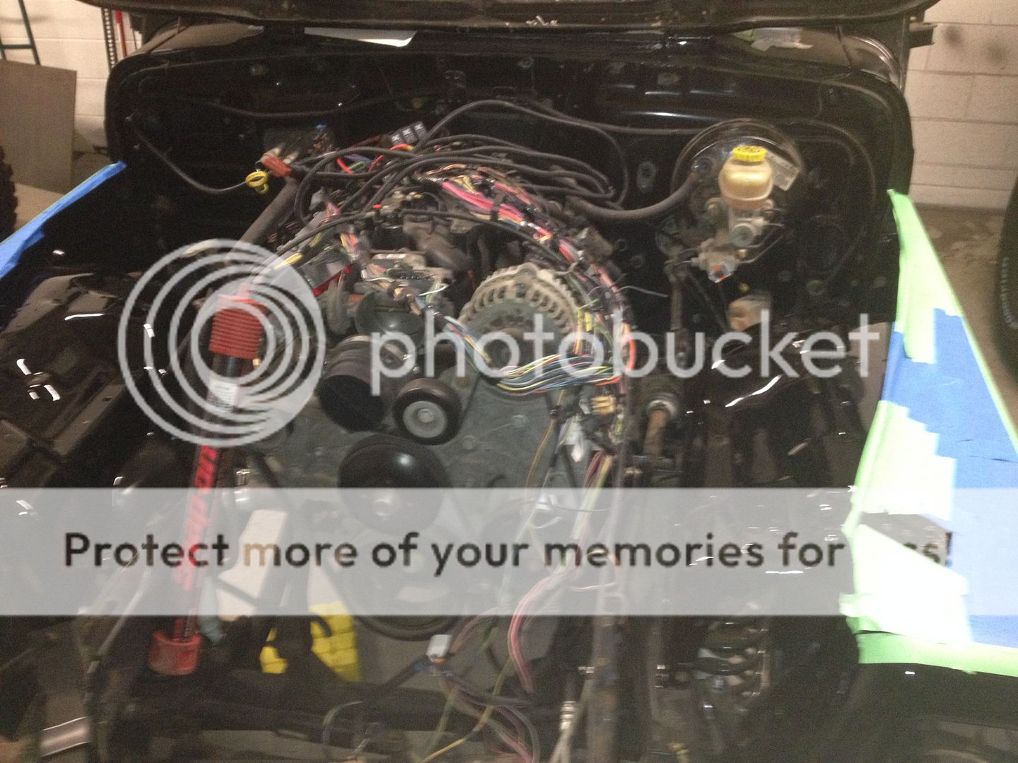

progress and picture time....

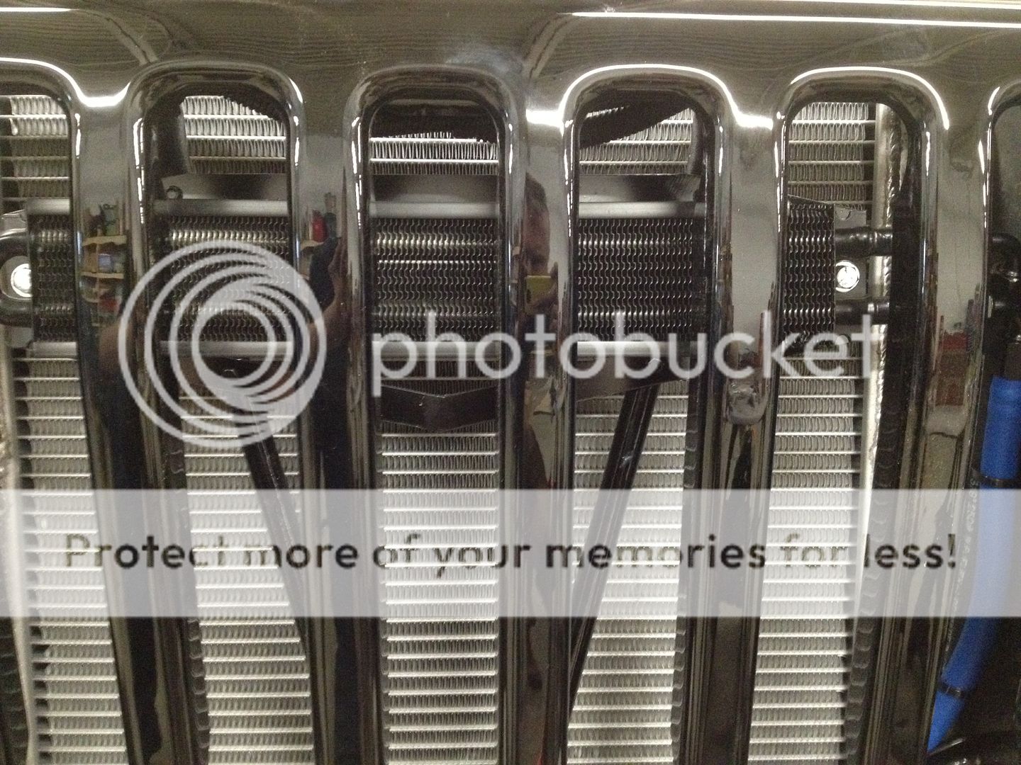

we join our superhero with the new trans cooler bracket and cooler installed...
attaching the lines to the cooler, then installed the fan to the radiator
junked the little 6mm radiator bolts for some 8x1.25 like everything else on the jeep.
adapter fittings installed
tied in the trans cooler intermediate line
drilled a hole in the bottom of the grille and secured the lines with a zip tie. just to make sure they stay where I want them.
AND..... we have a grille back on the jeep
steam port fitting

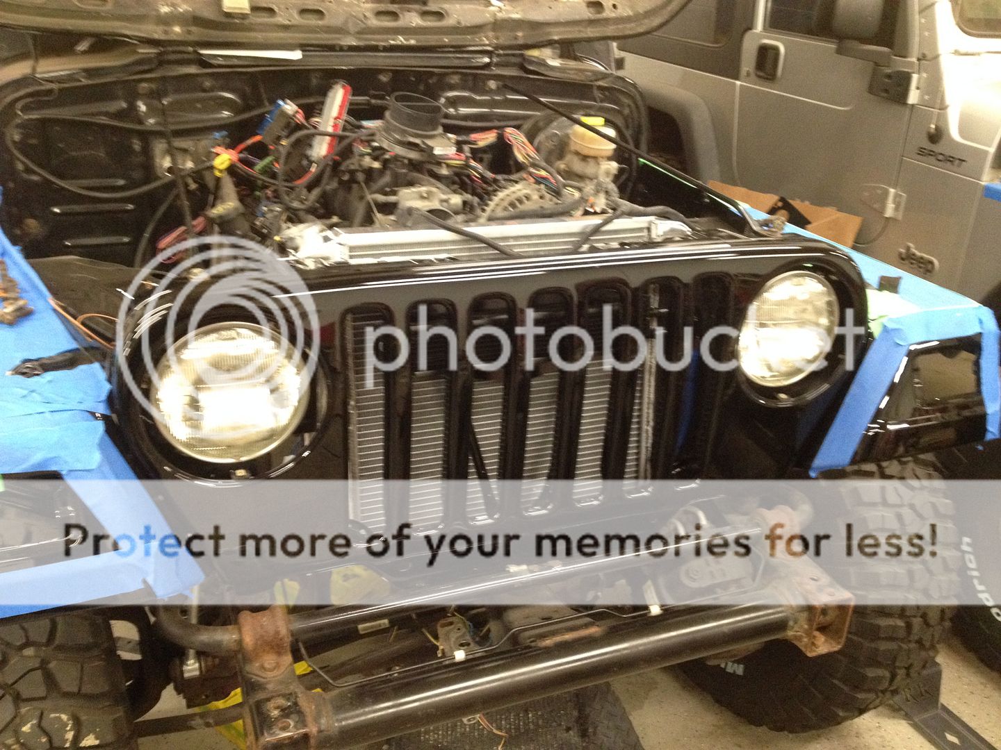

headlights in... the bezels are drying.. decided to paint them satin black instead of leaving them the stock chrome

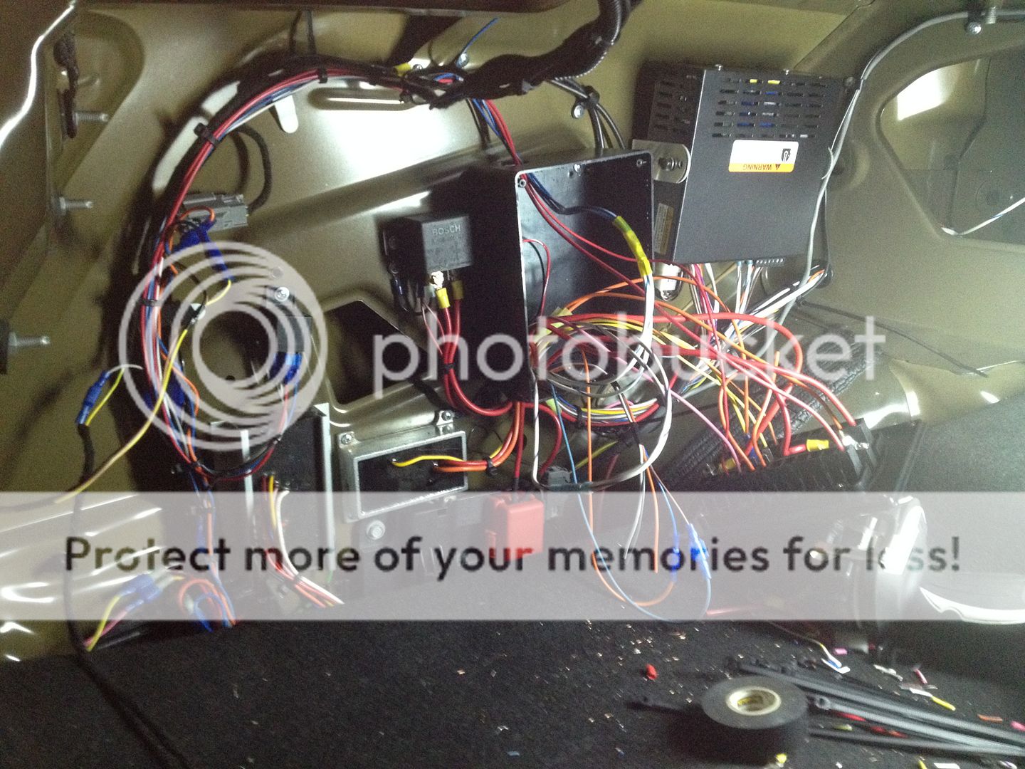

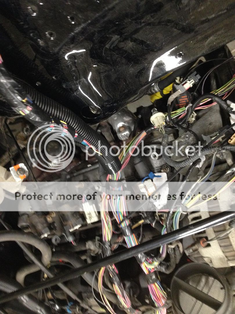

random wiring shots

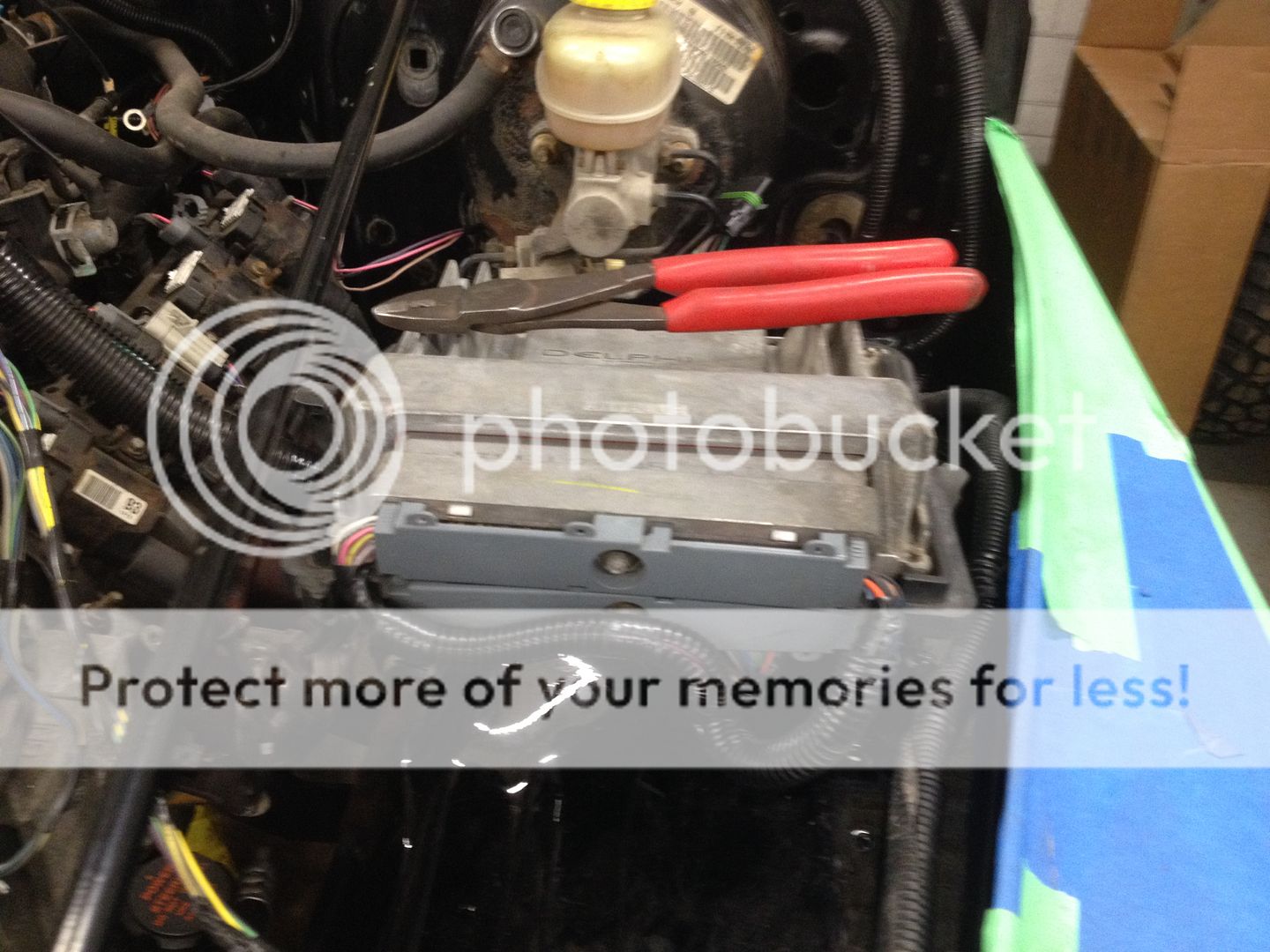

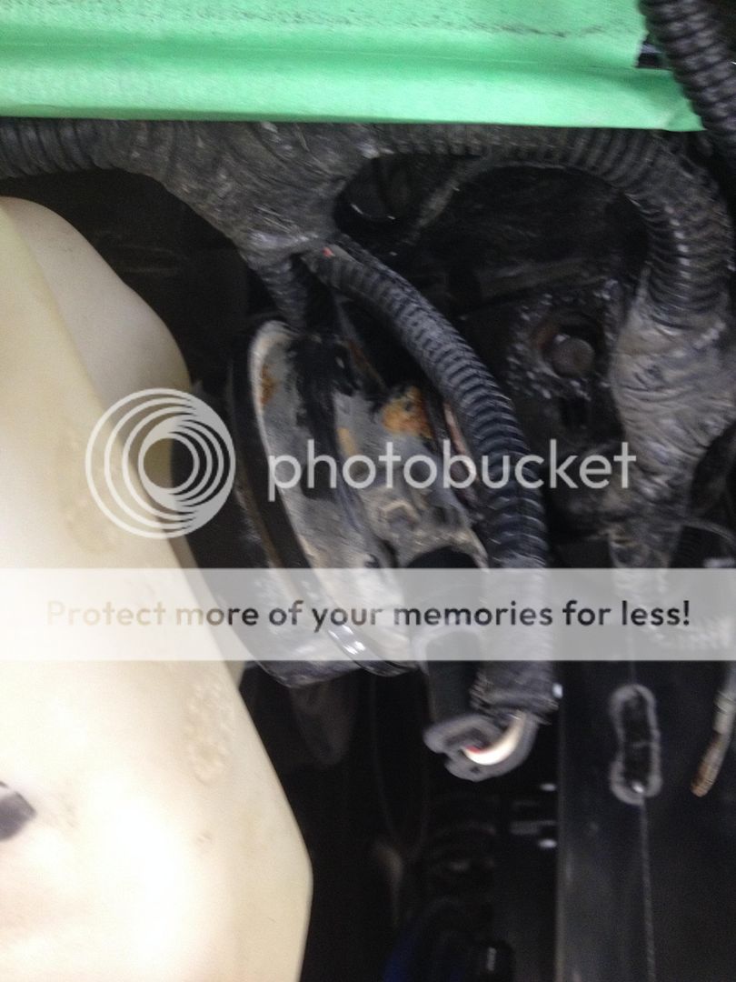

more...

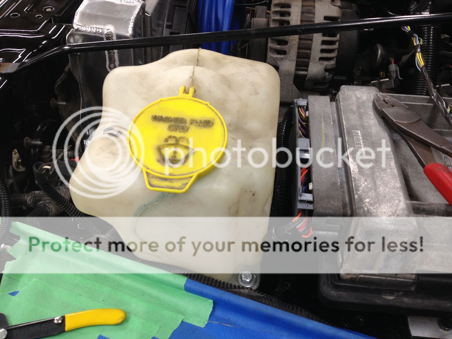

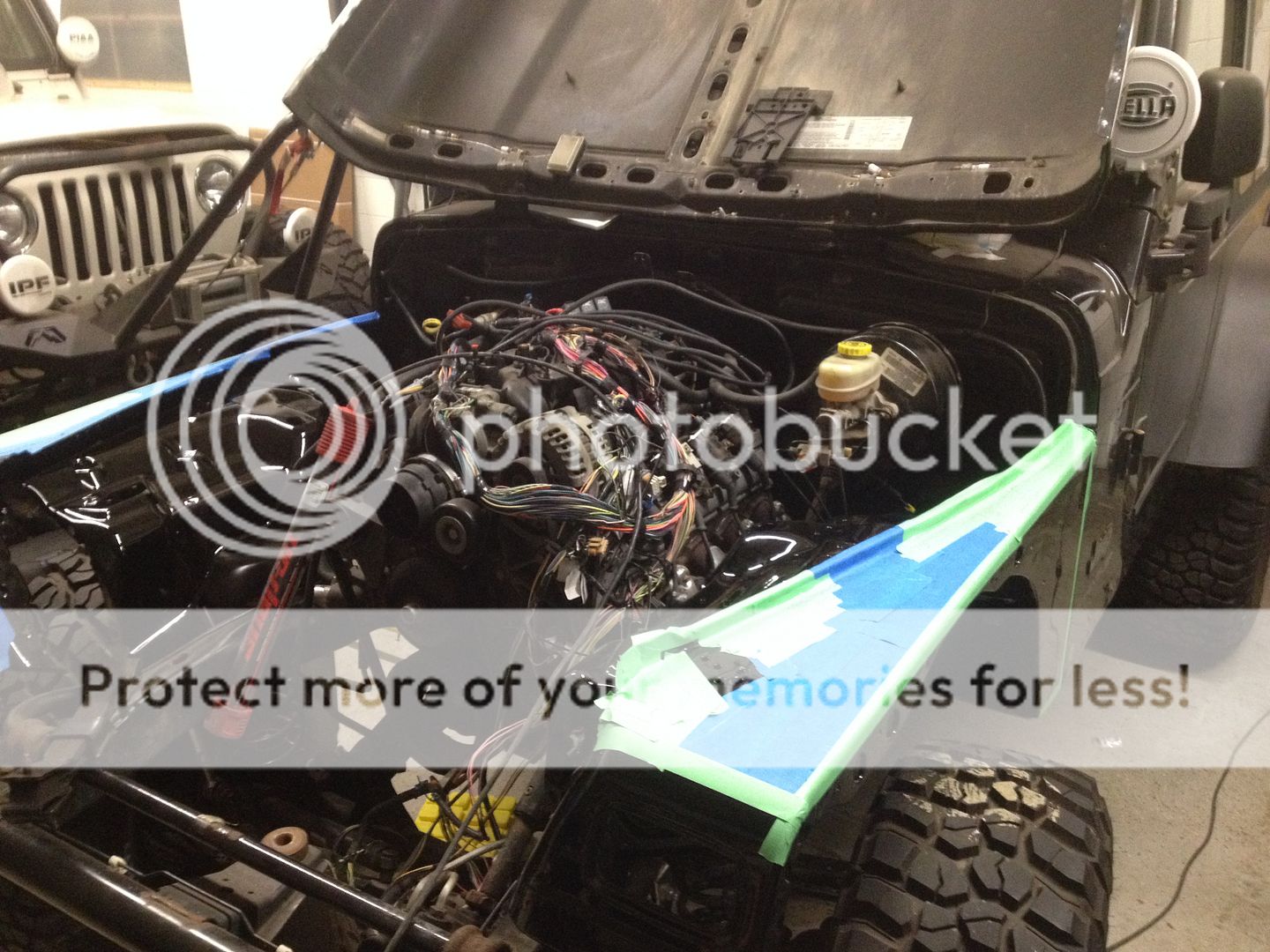

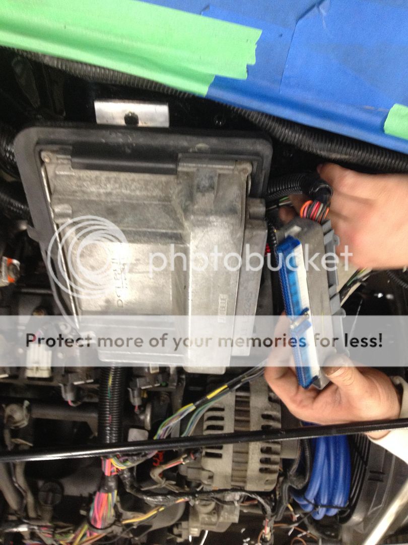

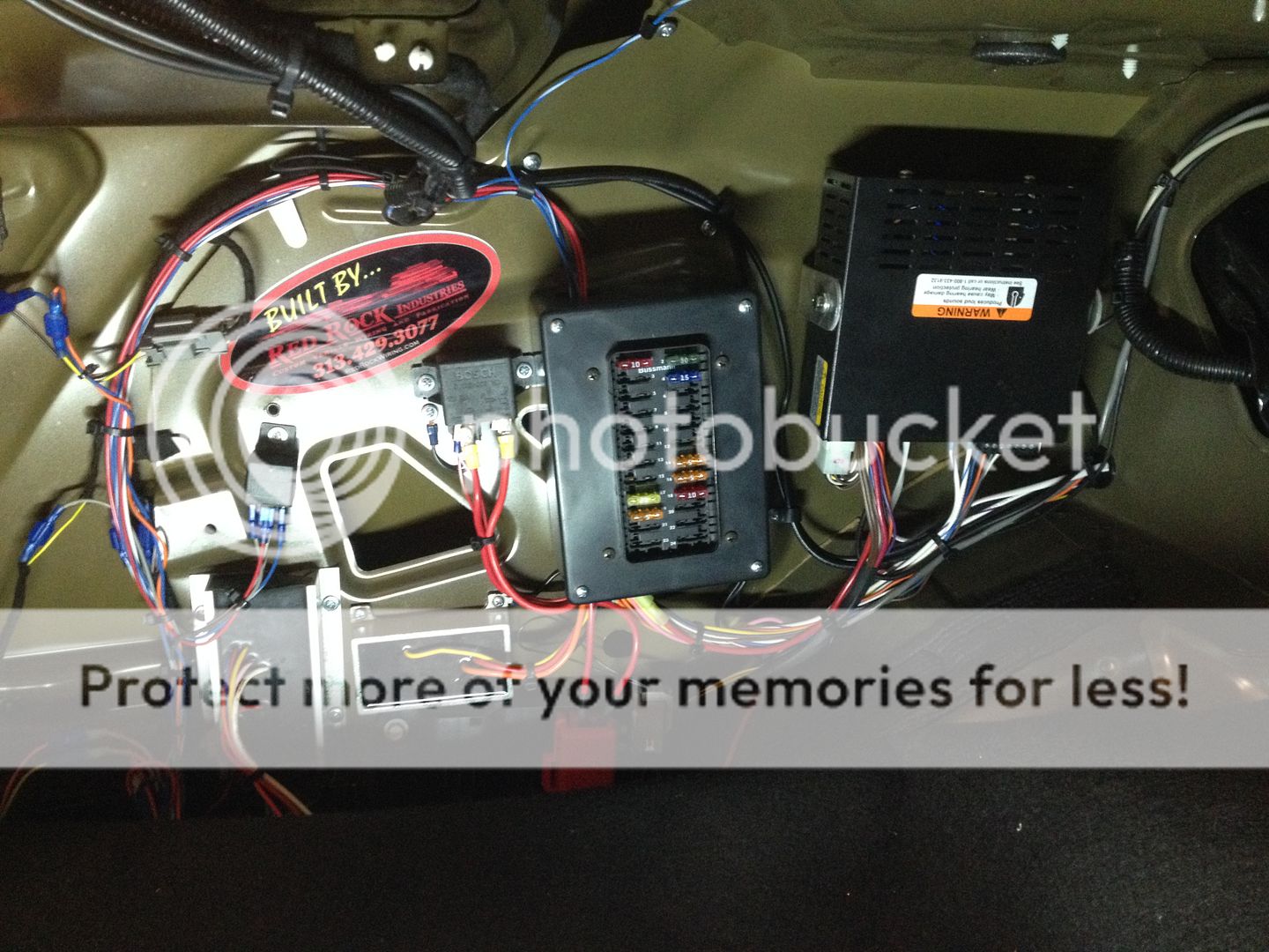

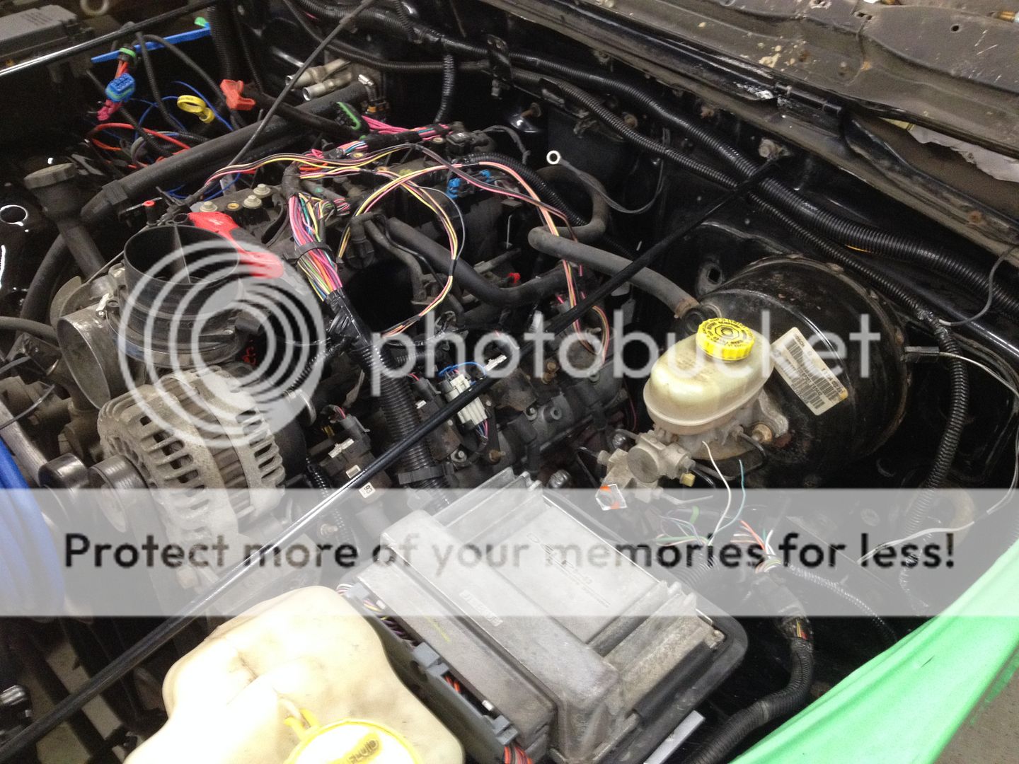

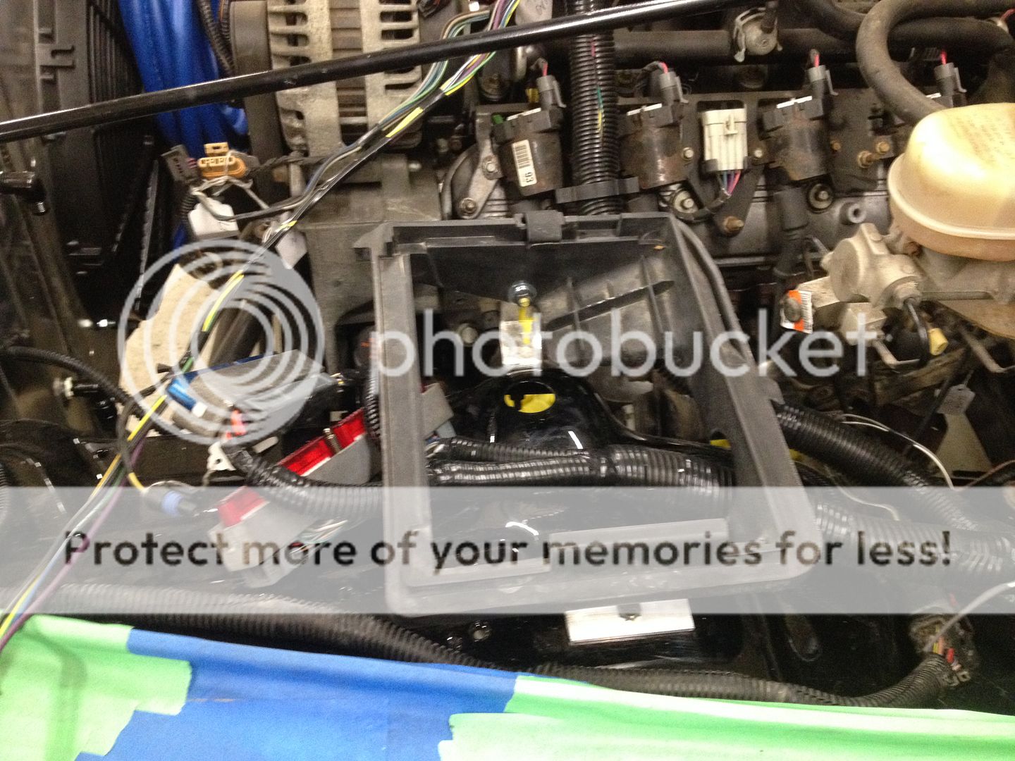

took a few minutes to decide on where to mount the brick of an ECU. heres what we ended up with-with a little modification to a stock ECU bracket.
slipped the washer reservoir in the factory spot and bolted her down...
then the stock horn....
looks sorta like this...

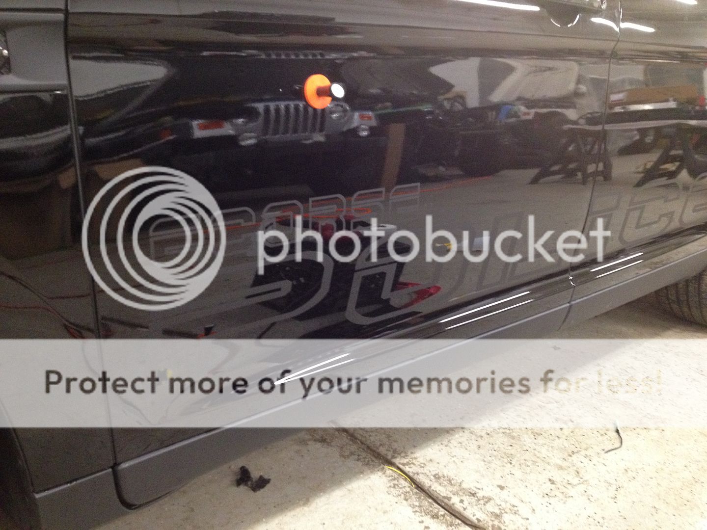

looking for opinion..... stock, smoked or clear front light housings???? this is black betty... leaning towards smoked.
