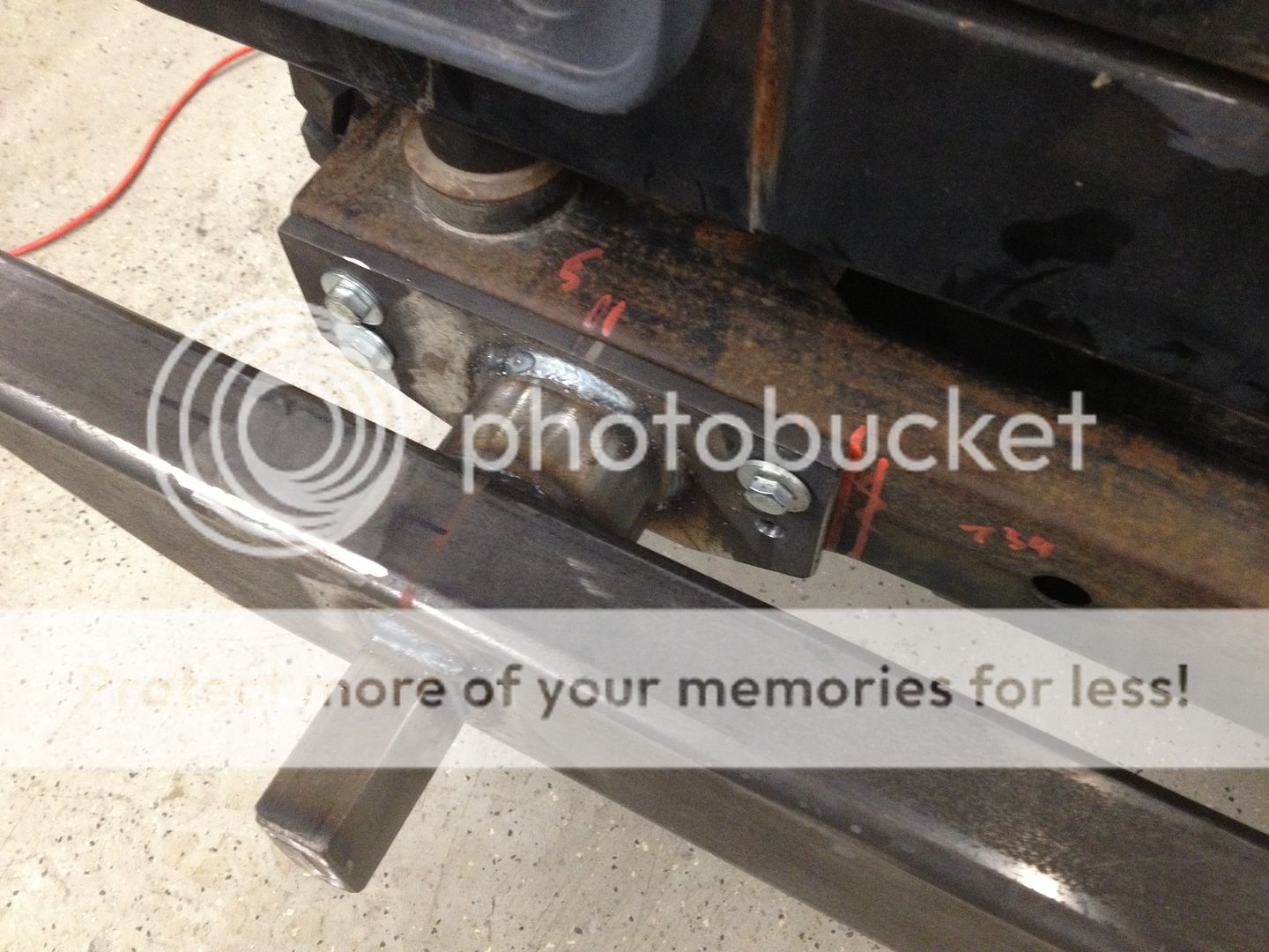

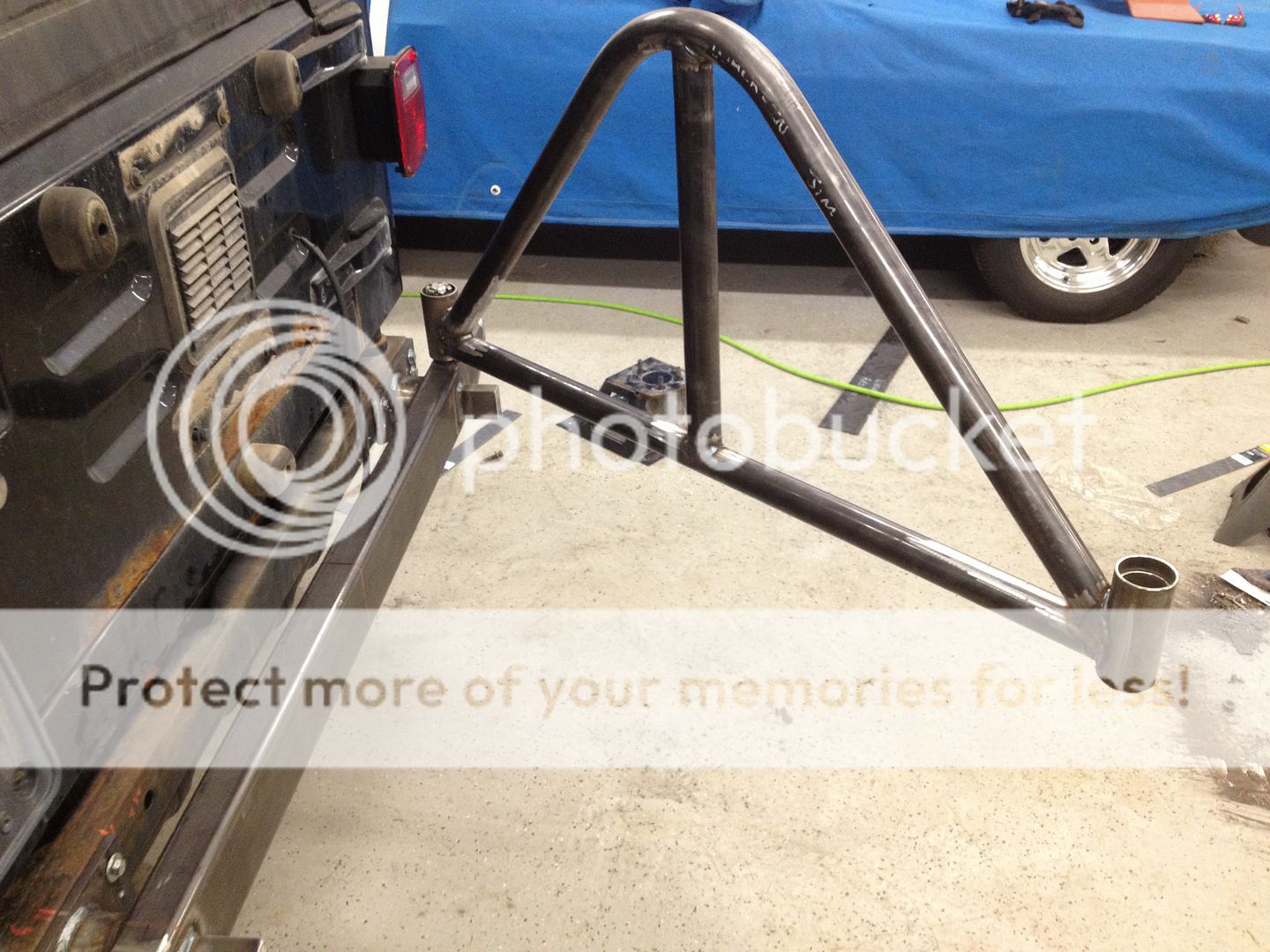

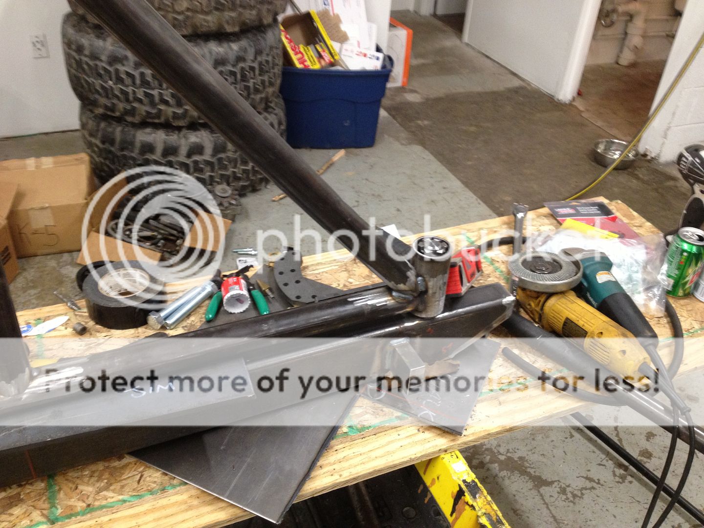

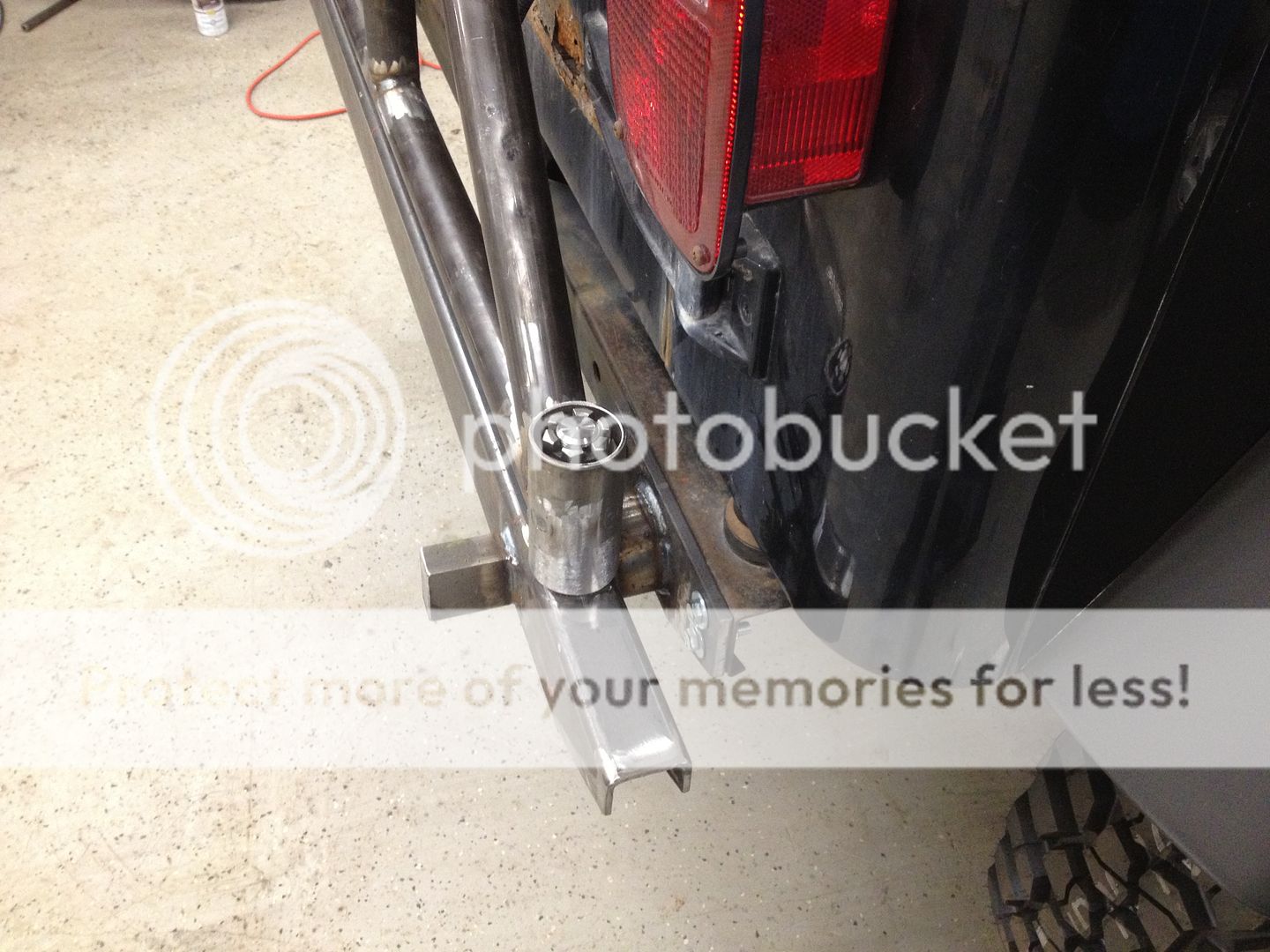

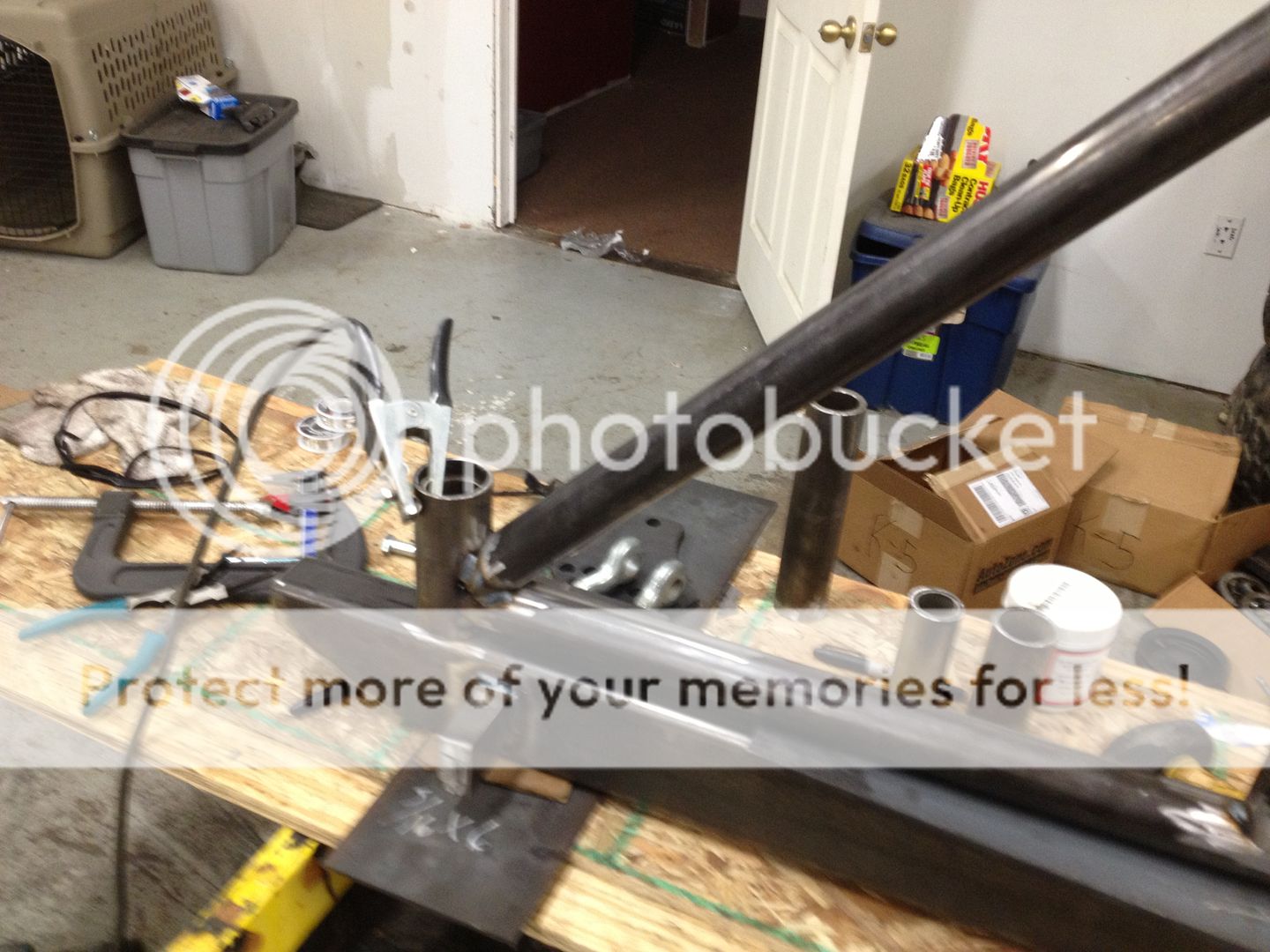

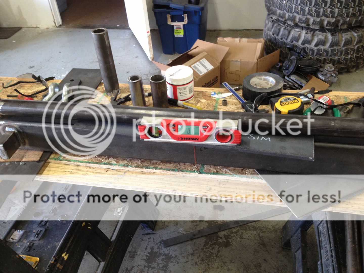

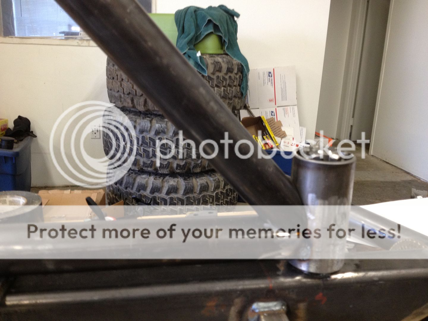

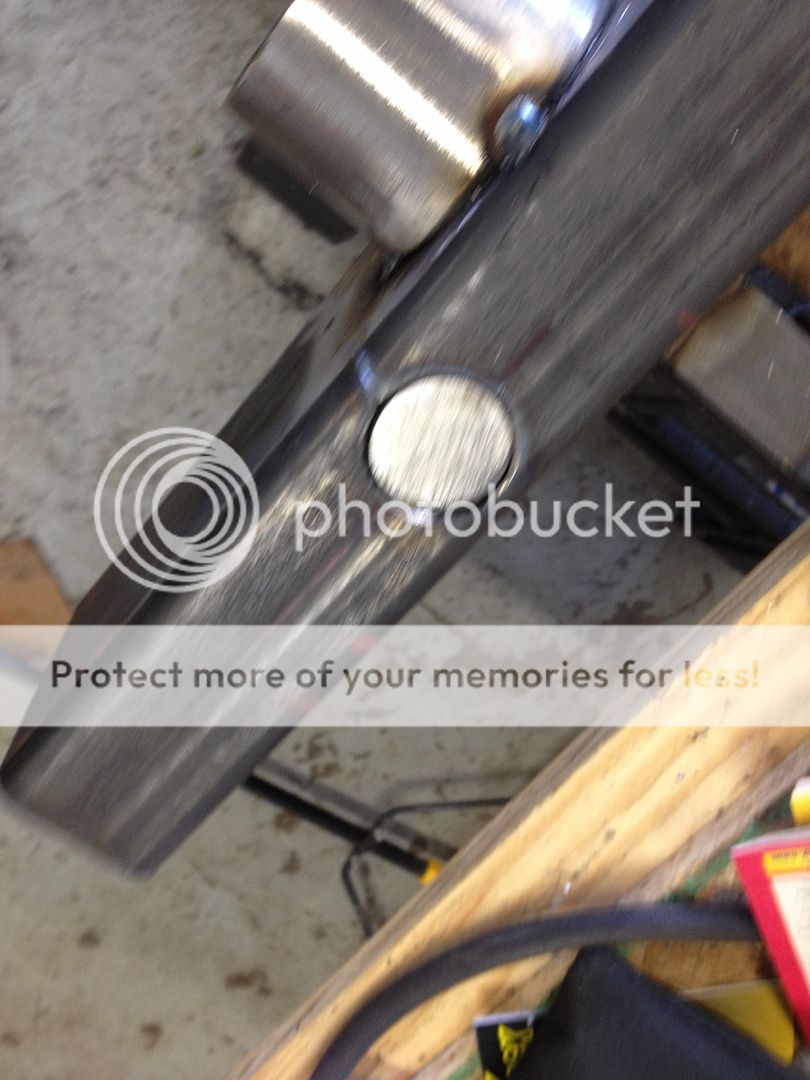

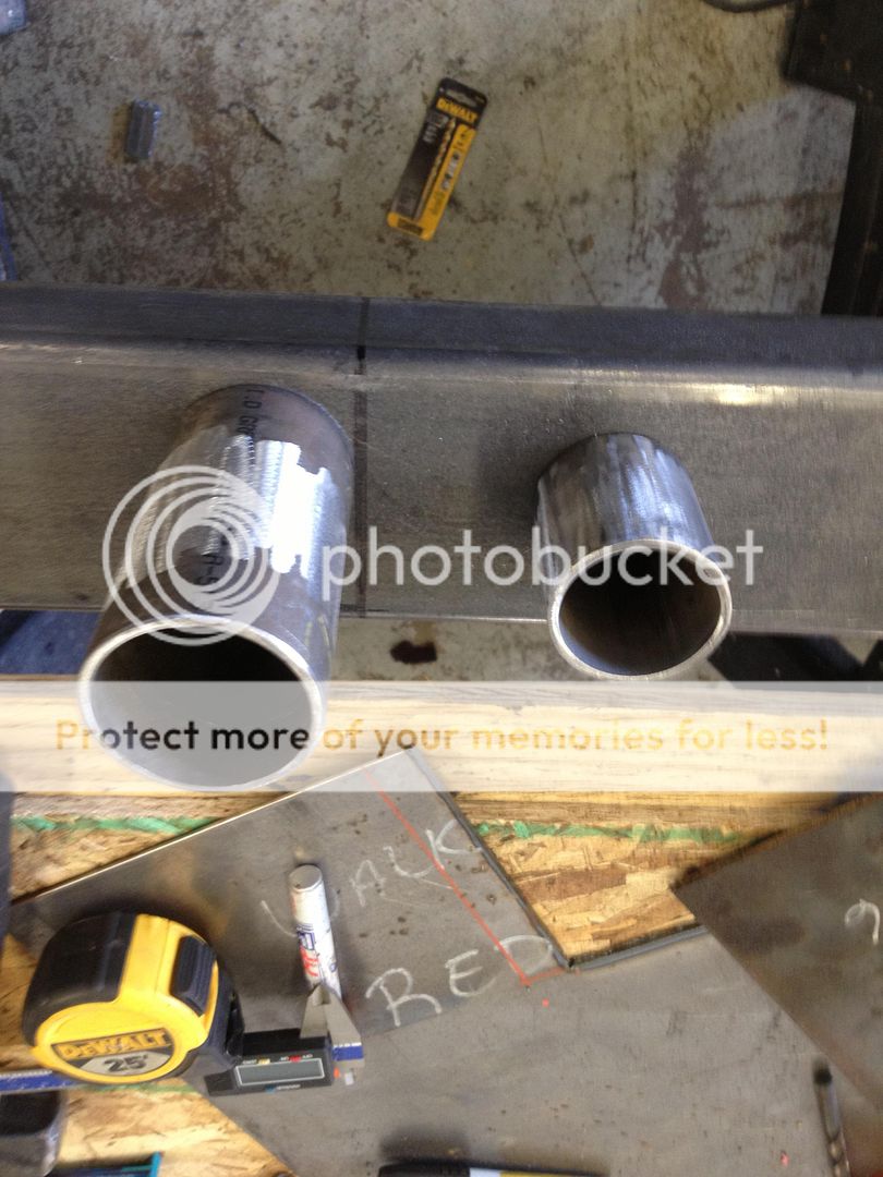

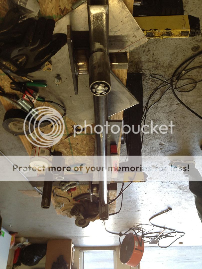

alrighty.... I started my tire carrier project today. first off I will say, that when I build another carrier, I will just order the bearing housing/outer tube rather than 'constructing' my own. I had the stuff to do it, but its a time versus investment issue. faster to use a mass produced part for $5 more than what it costs to make it.
anyways.. pic time...
bottom of the bumper, that's the bottom of the spindle.
if you don't have one of these digital level/angle finders in your tool box.. go get one. I use the heck out of it.
cross tube set up...
putting the swing out together...
then I took what I had built so far and mounted it up to the jeep just to see...
I know.. I know... I don't have the drivers side 'stop' or 'securing mechanism' mounted yet. I am toying with different ideas. I wanted the tire carrier to look 'symetrical' from the back. now I just have to 'nail' down a securing method.

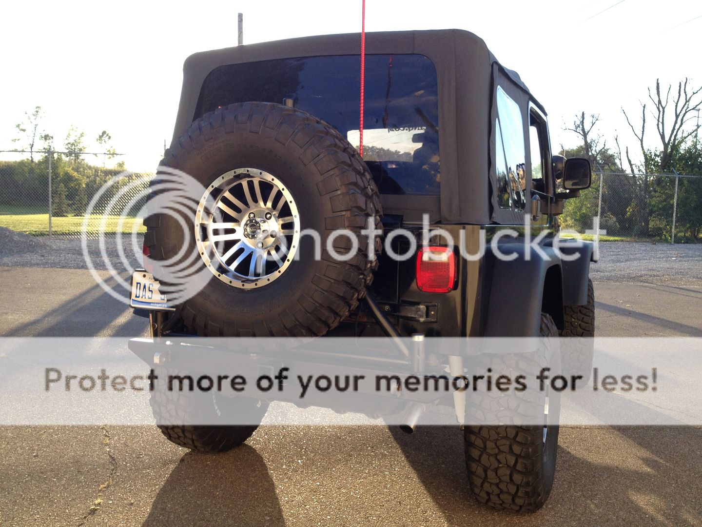

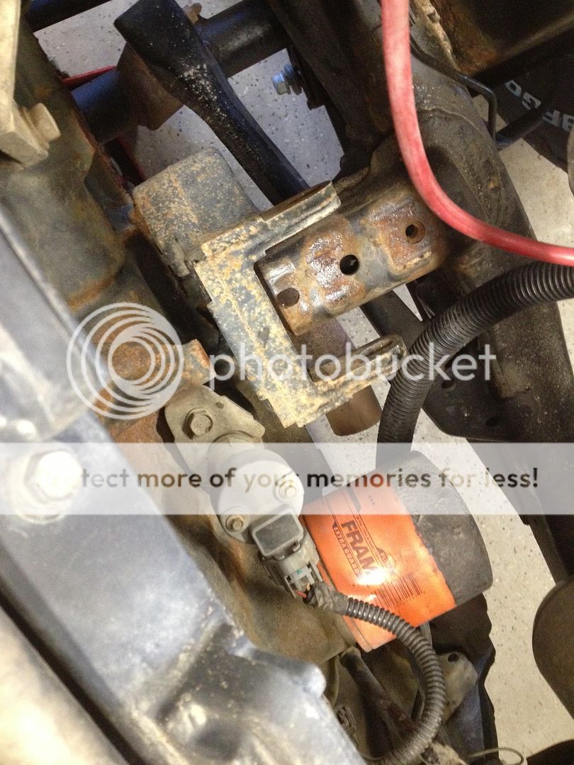

tied up all the little things today and she is mechanically finished.
did motor mounts, next time I will just build them myself.
only way to do it on the drivers side. when you re-install them, flip the motor mount thru-bolt and put it in from the back to the front.
this little sucker was fun. no match for PB blaster, wire wheel and a hammer. figured I would set up the t case linkage for now until I order the novak cable, or make my own system
all done...
a little tooooo comfortable... I think he took it over..
exhaust and plates on Monday!!! then I work on resolving the door hinge issues. not worried about doors

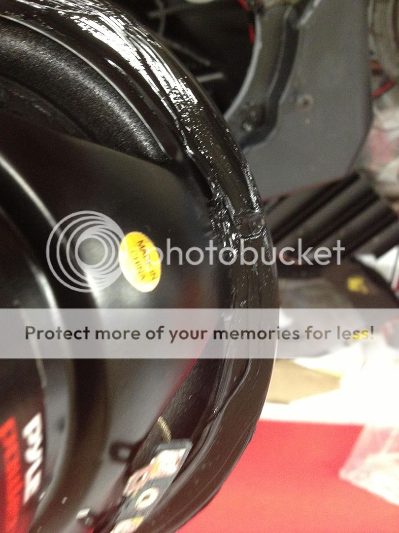

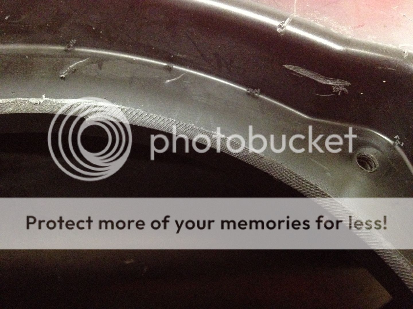

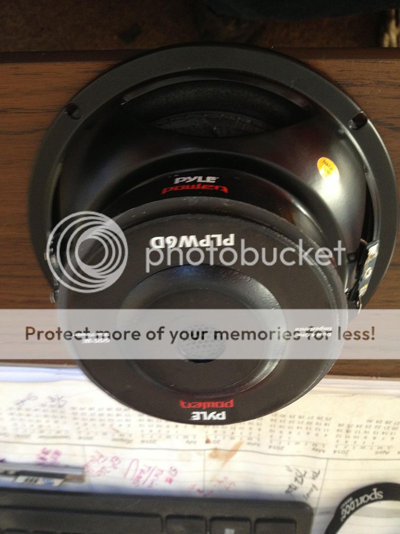

I also got the sounds system all redone. kenwood head unit, kicker 4" in the dash, lanzar 5.25s in the sound pods [stock grilles installed over them] and replaced the blown stock subwoofer with a $20 4ohm DVC 6" sub that sounds pretty darn good off the stock sub amp. close I could get was DVC which will put a 2 ohm load on the amp. better than a 4 ohm load.
yep, still have to trim the inner plastic ribs like all other aftermarkets... I needed to put a bevel on the opening for the sit flush on the mounting surface.
silicone on the mounting flange. the sub doesn't come with any gasket material etc...

So I had some hits on the jeep but no takers... So I decided that driving a 6 Cly sucked compared to the v8.... Yep... Sourced a 5.3 out of a 2001 Tahoe with 87k on it. Figured I'd do one with dbc throttle body and use a np231c case I have on the shelf.
In less than 3 hours the other night I had the 4.0 pulled, 4.0 mounts off, frame prepped and new mounts burned in.
Sold the 4.0 the next day....
The 5.3 is already in, trans lines made, heater lines hooked up, manifolds swapped, steering adapted and secured, chassis and motor ground cables made and attached. Need to address the power steering "high pressure line" next.
