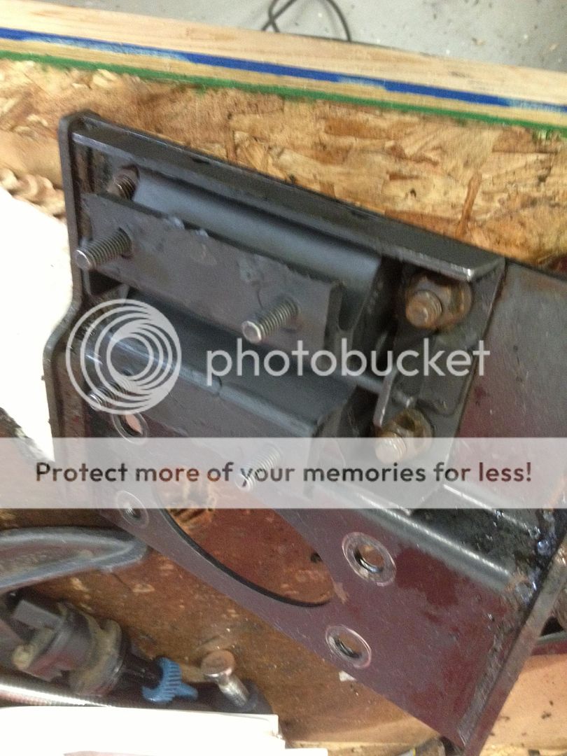

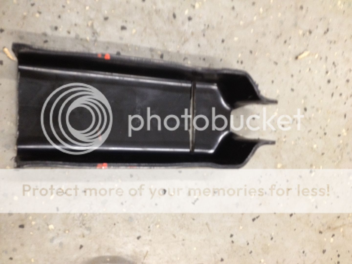

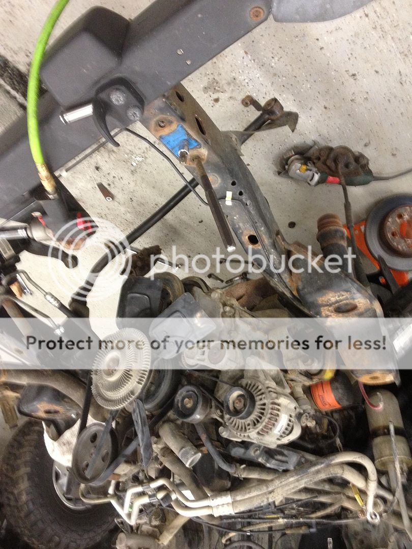

I got the t case back up in the tunnel. noticed the stock trans mount was shot so I ran up to the auto store for a new one. picked up some trinkets and so PB Blaster. when I got back, took a second and shot the upper rear shock bolts. I really think im going to out board on this jeep. I have the ford towers that I opted no to do in the silver LS jeep. im thinking of grabbing an 8.8 a guy has on CL and just getting to it. IDK...
figured id get this on today..

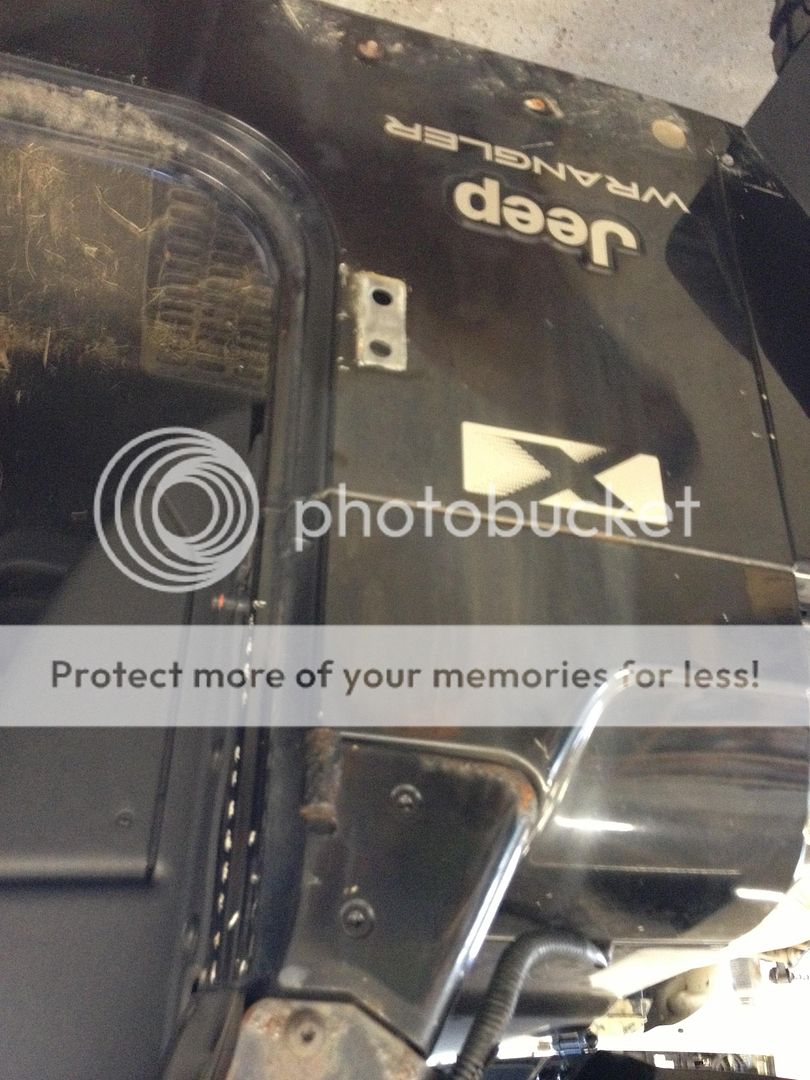

so the steering shaft pillow block mount bolt [top] broke off, SWEET... had to drill that out..yay extra 20 minutes on that.

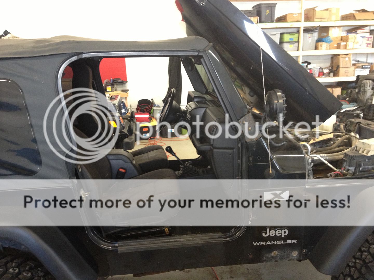

I cant get the doors to pop off either. I had the jack under the drivers side, wiggling it and she still wouldn't give up the ghost. wtf.

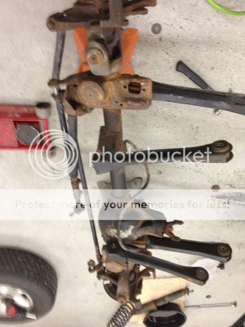

today I put in about 2 hours.... pulling the front end apart [hub bearings, shafts] one of the hub bolts broke

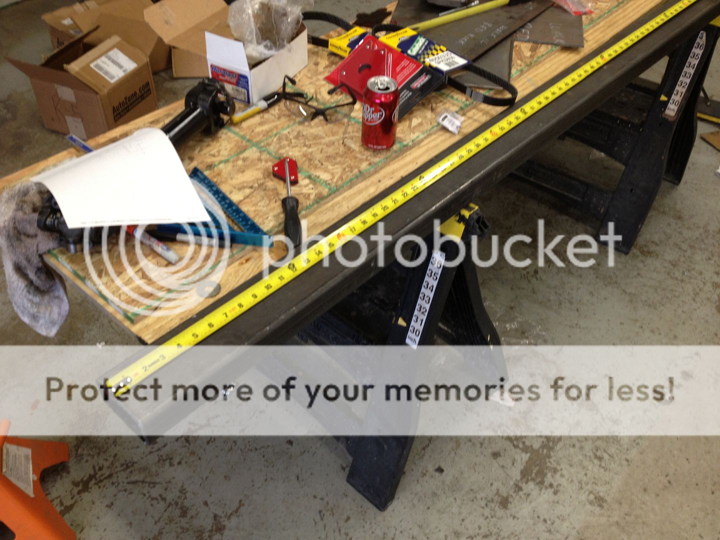

and cutting out the old lower links
I know I can get the axles rebuilt tomorrow. hub bearings, pretty sure ill be able to source them, the hub bolt...ehhh maybe. cam bolts ehhh maybe.

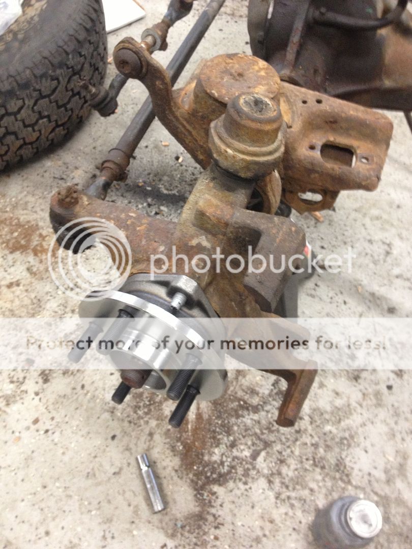

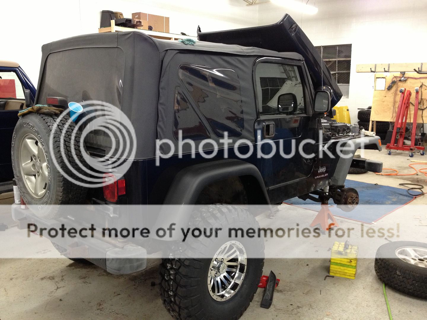

the hub bearings came in.... and yes I know I left the dust shields off.
we got the front axle back under the jeep and it all in. all I have to do is tighten the lower cam bolts and upper CA bolts. fought the remaining pieces of the links out of the sway bar.
pretty much where the front is at. we would have been farther along but the K5 blazer is throwing curve balls at me. the front 60 was fighting the tear down process today.

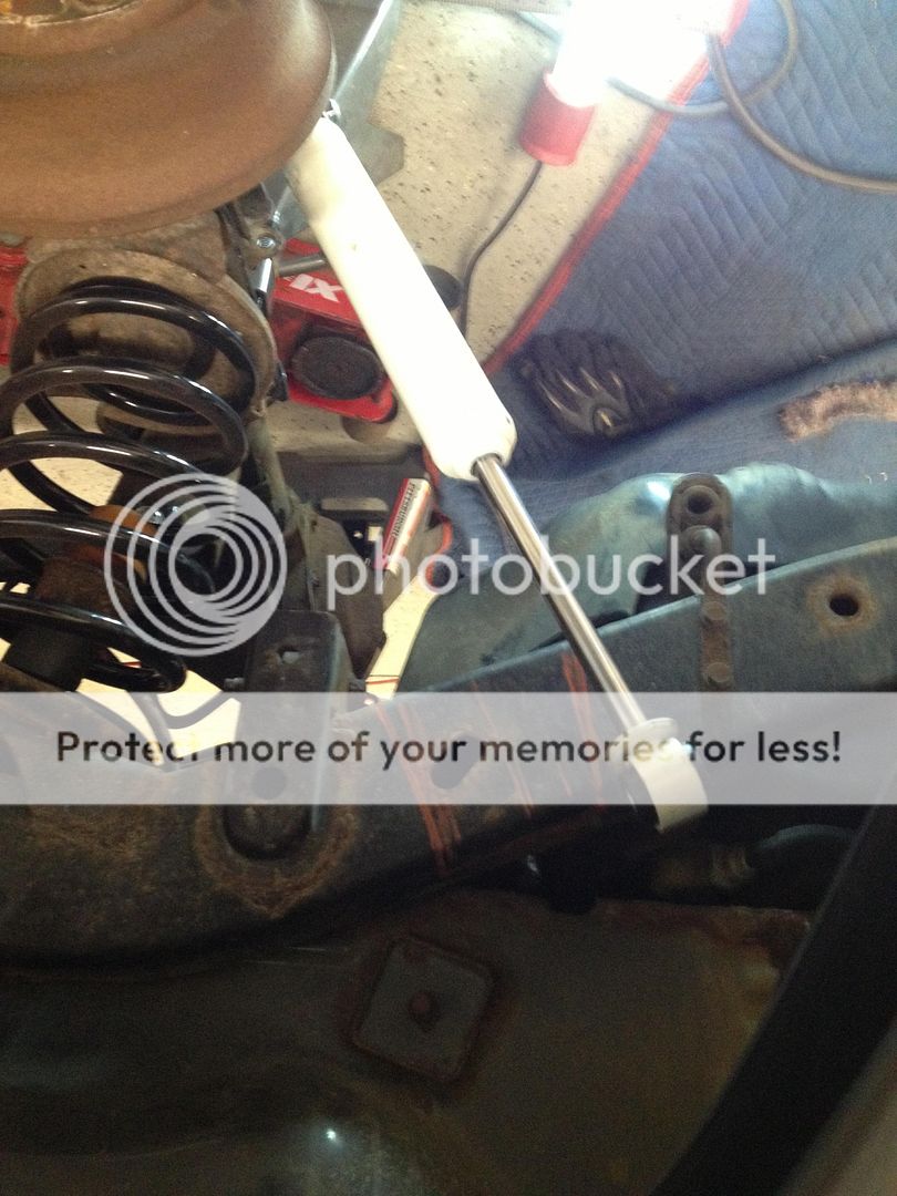

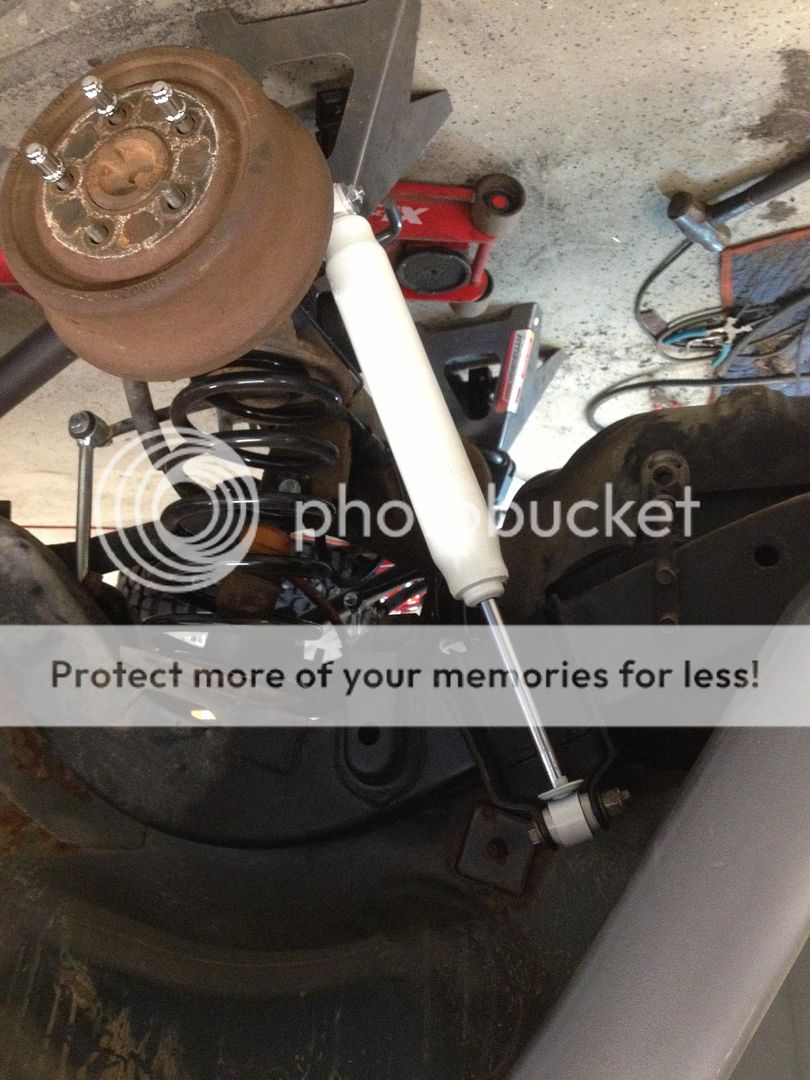

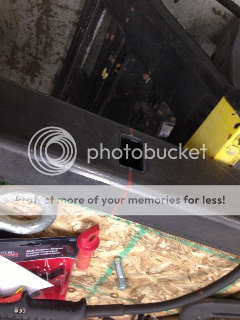

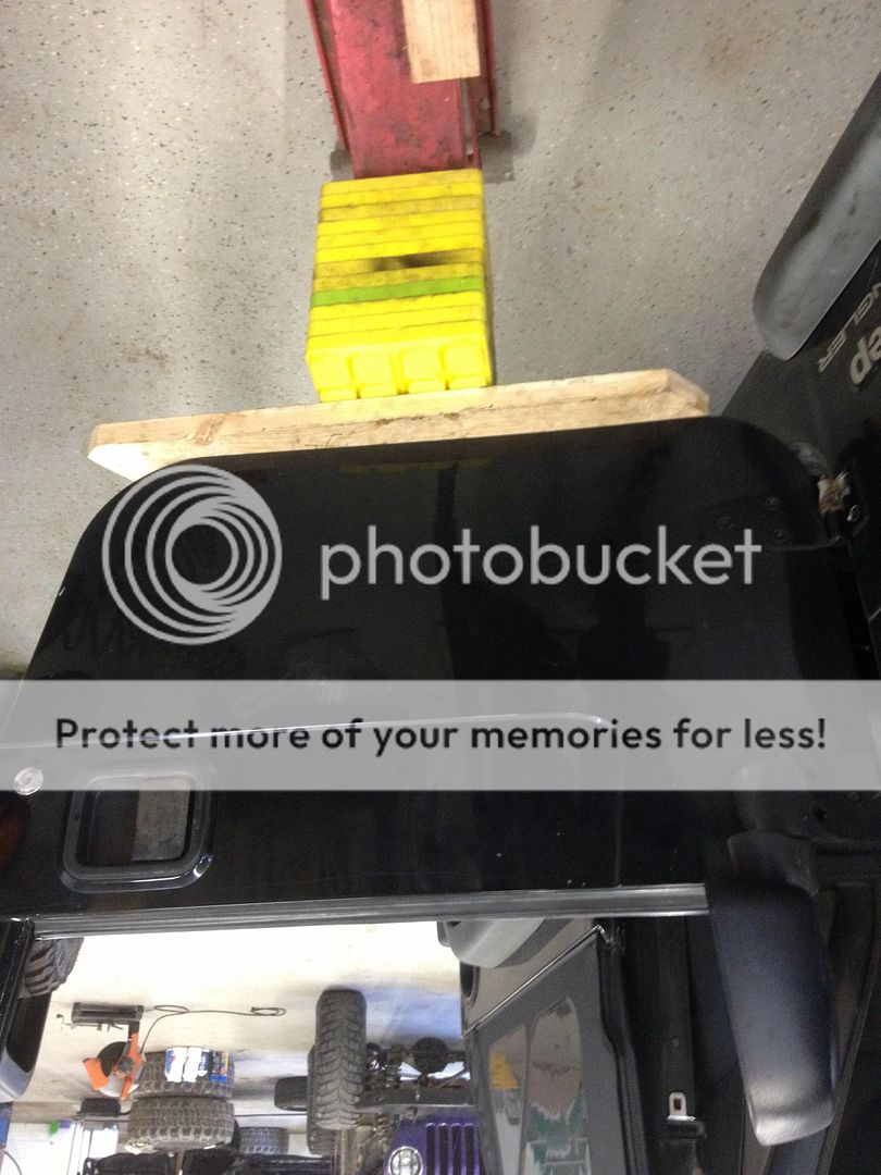

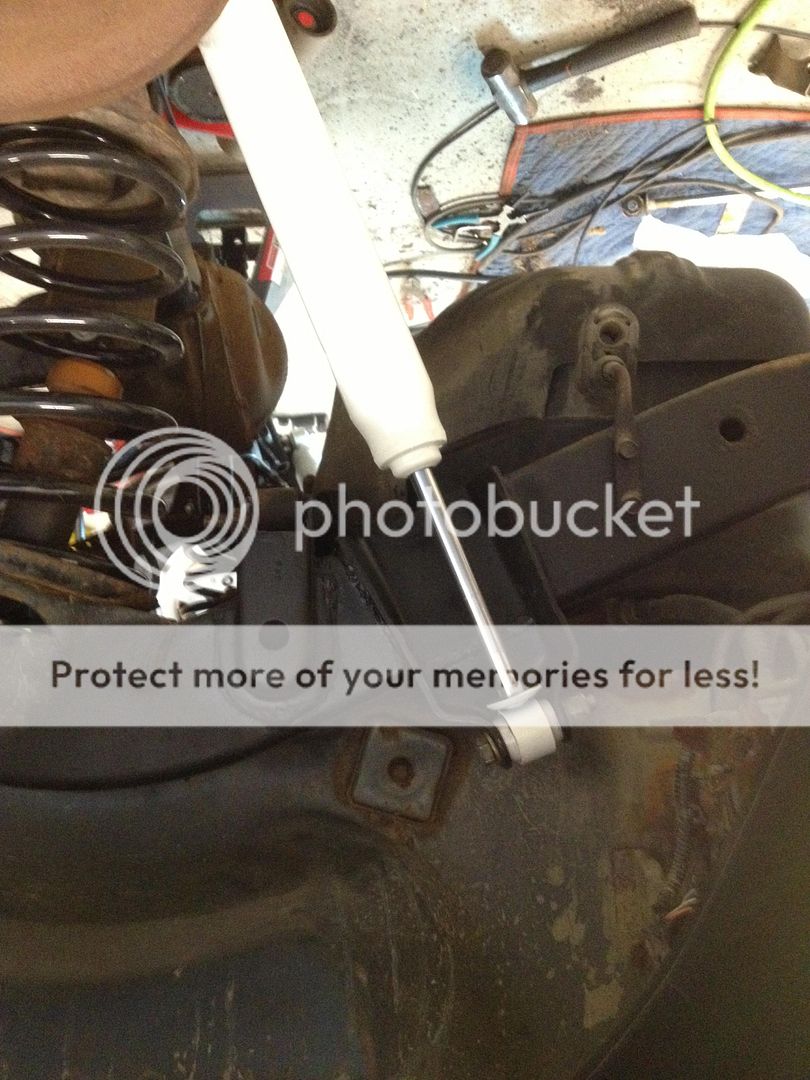

so then I jumped on the back, figured id knock it out.. RIIIGHT!. all 4 upper shock bolts broke off.. [given] but the real b!tch is the upper bumpstop bolts are rusted away, so to the point I cant get any type of socket on them. CHIT!!! I will have to drill them out tomorrow. I have to have proper spaced bump stops.

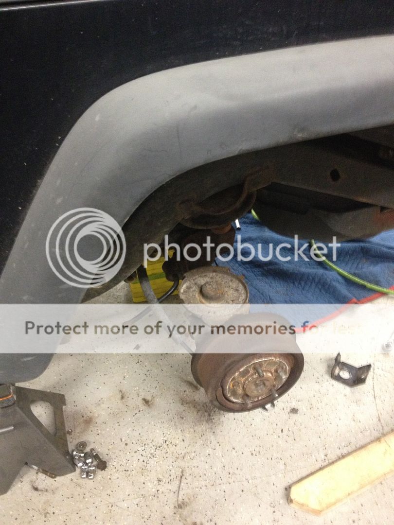

I was able to get [1] of the rear bumpstops out with the old snap on extractor kit. whew. going to try for the other one here in a minute, and then knock out the upper shock weld nuts. maybe I can have her back on her wheels by tomorrow night.

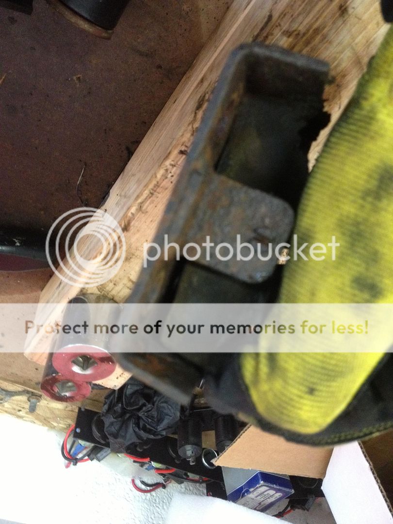

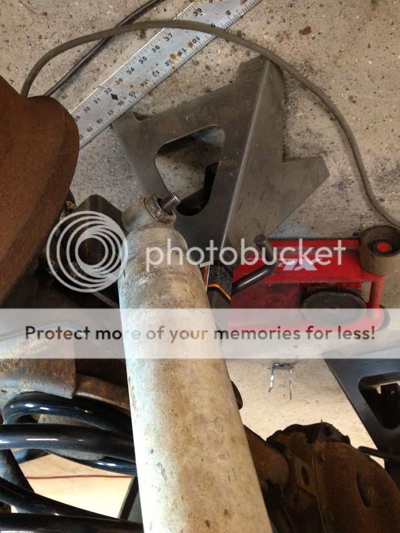

okay. I tried to beat out one of the upper shock bolts and it ripped the top layer of the cross-member apart.. SWEET so its either drill out the other 3 after I pry the frame ripping weld nut off.. or outboard. probably outboard but that's just me asking for more punishment and something else to pop up LOL.
cause me and this jeep are havin a fight. shes resisting any efforts to change. I went to change the leaking rear brake cylinder and yep, a fight ensued... now she needs a brake cylinder and a new brake line from the cylinder to the 't'.

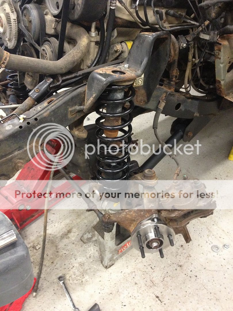

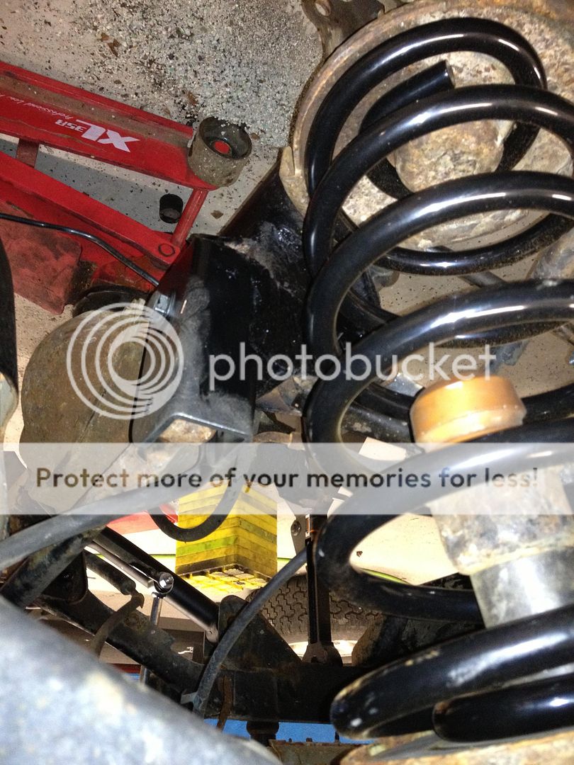

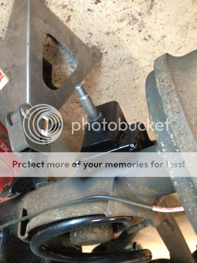

made some progress tonight.

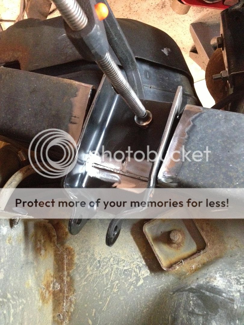

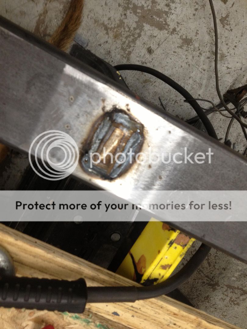

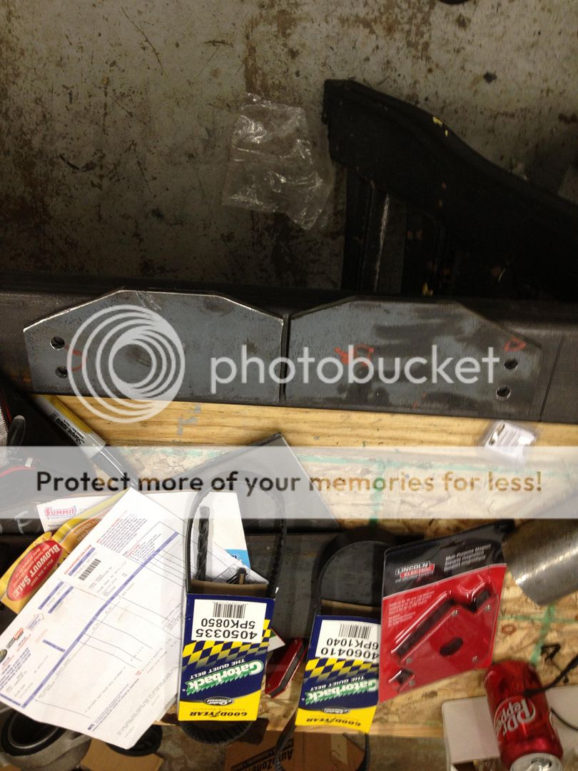

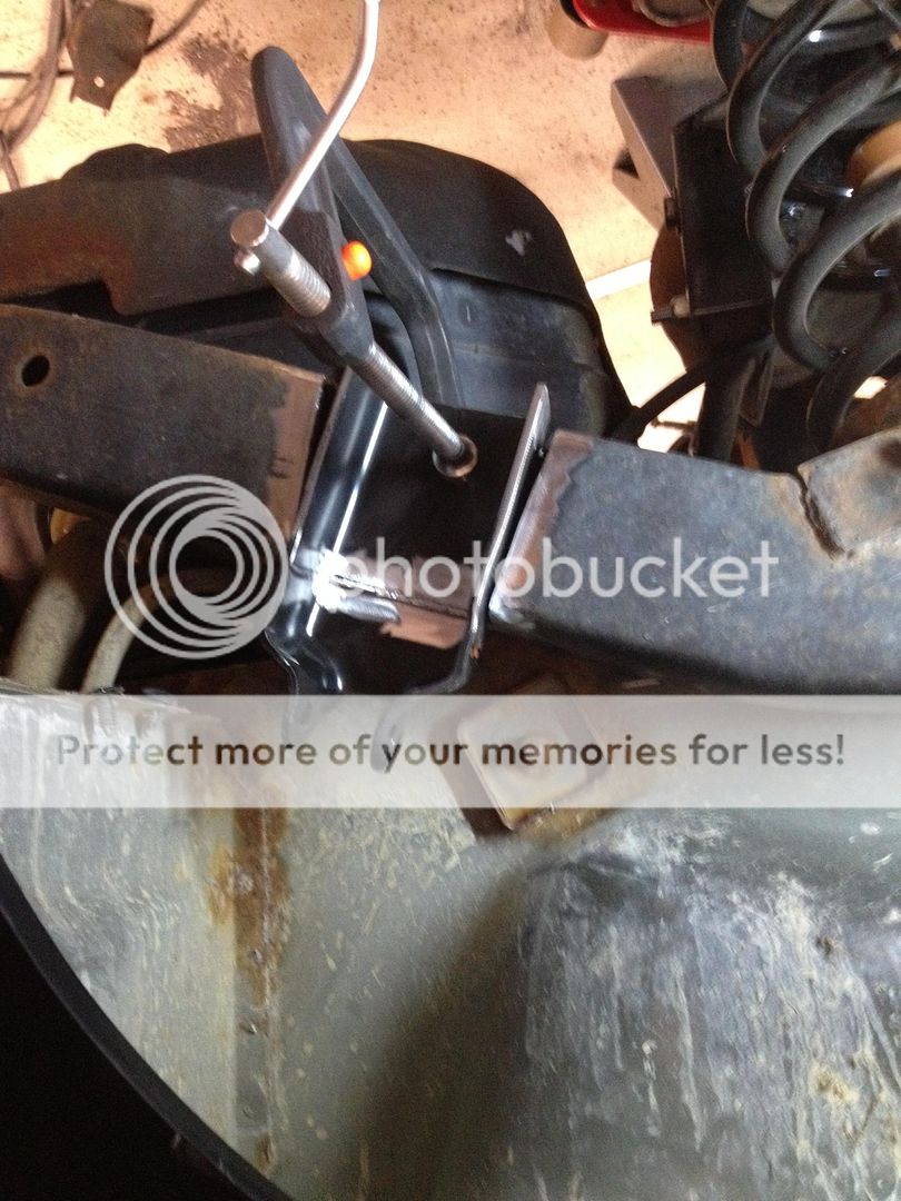

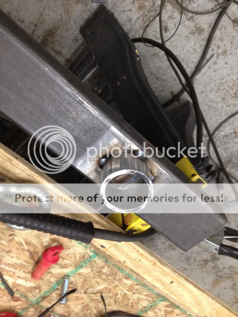

got the upper CA cam spacers installed. drilled out the forward area I needed to. tack welded the cam washers in place and bolted it all up and slid the lower links into location.
the drivers side bumpstop mounting bolt came out without issue...
got the sway bar links installed

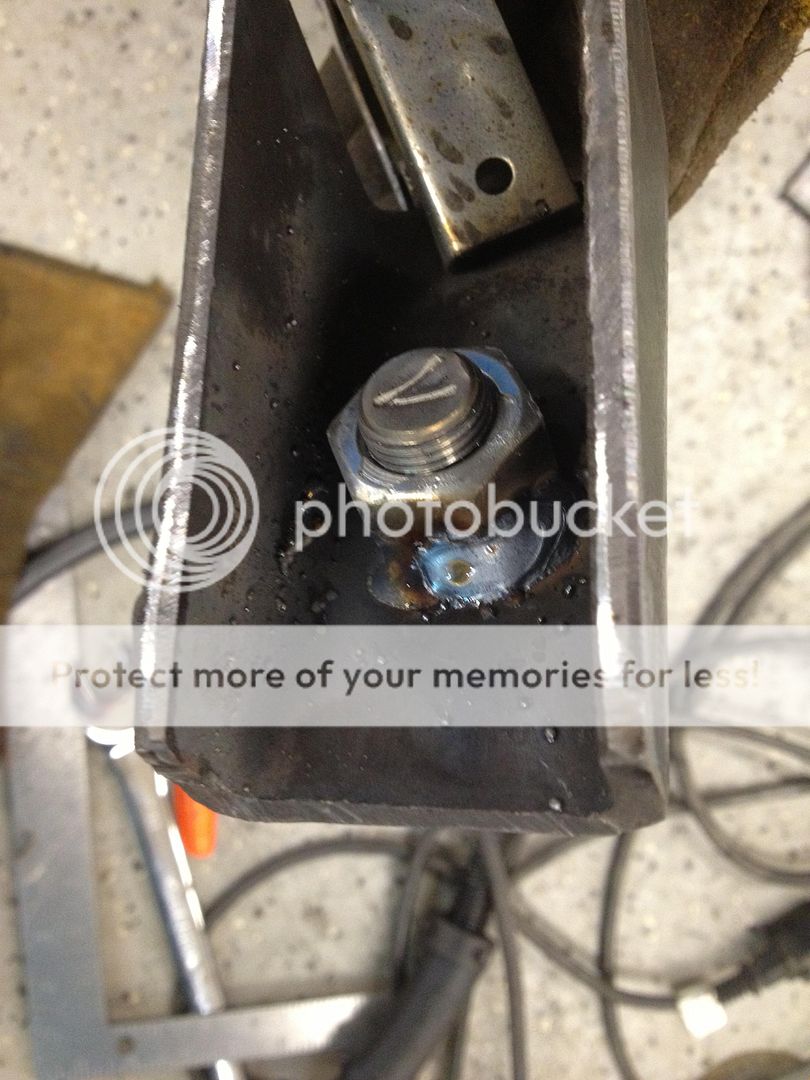

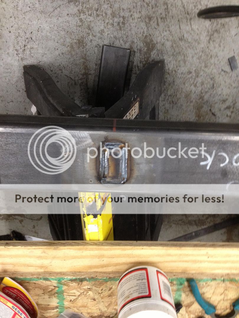

bolted the new track bar mount to the axle then went ahead and threw a couple tack welds here and there just to truly lock it down.
popped the springs up in their new home
tomorrow I need to put the axle side track bar bolt in. going to see if I can find a piece of flat stock to make landing plates on the back side of the LCA mounts for the outboard process.

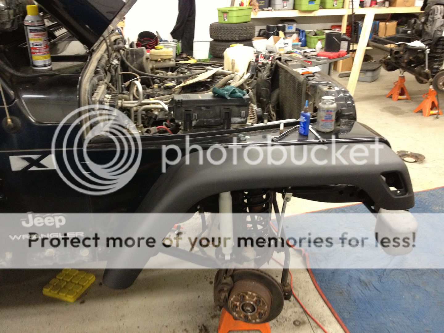

getting close... I guess if I can keep it under two weeks ill be ok with that.
getting the old flares off and the new 7" flares on. I cleaned the body and then rubbed it out with some polish before the new flare went on. you can see the difference just looking at the corner seem
a shot of the rear with the new flares and new shoes...
got the front clip back on..

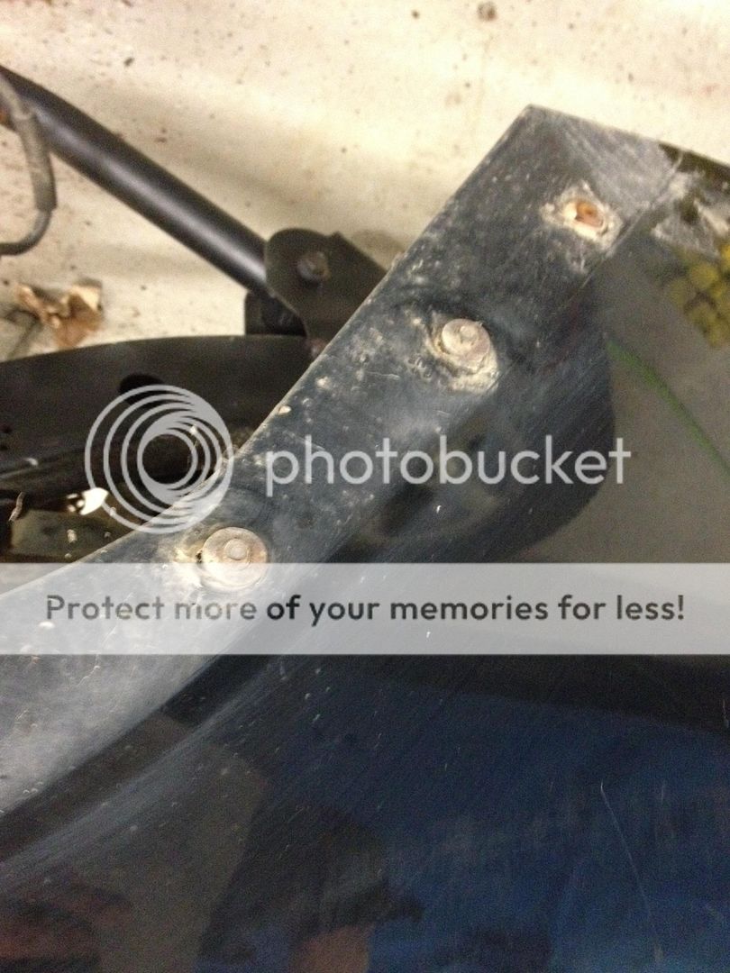

nutserts... need I say more...
f u nutserts.. I win...

also accomplished...
changed the brakes on the pass side, got the new brake line installed on the drivers rear corner.... tightened steering pillow block mount down, put cotter pins in the front spindles and pitman TRE, tightened up control arm bolts... wired up the heavy lines to the starter, alternator and grounds

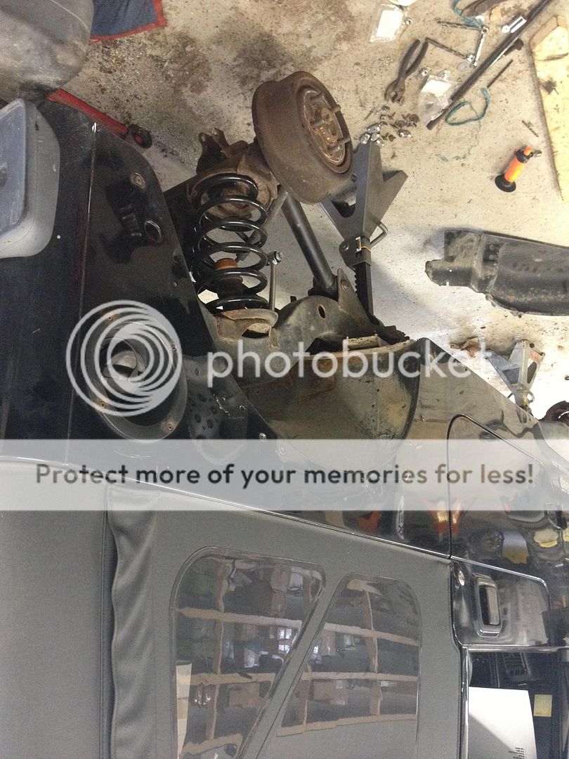

little more progress today....
she is sitting on her shoes and the last flare is on
and got the frickin doors off... what a pain.

SHE RUNS!! fired it up the on sunday afternoon after getting back from up north. SWEET.. that's awesome.
I ordered 1" lift motor mounts but when they came in they were for a 2.5L, nope, nada gonna work. sent back and correct kit ordered.

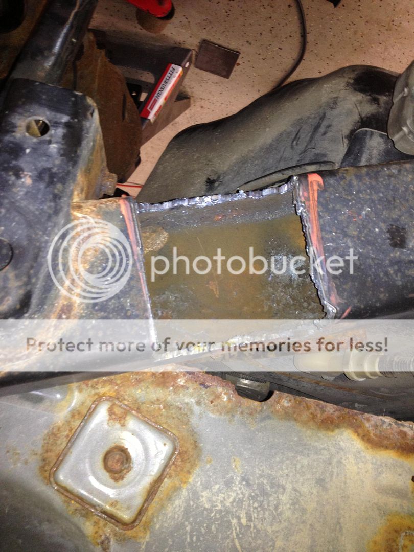

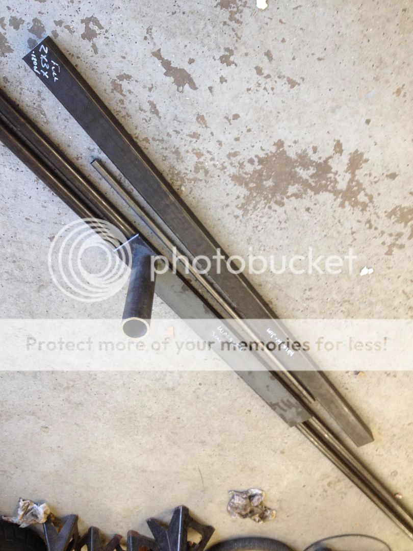

picked up steel last Thursday for a few projects, including a piece of 2x4 .250" box tube to make some bumpers. the rear is going to get a swing out tire carrier for sure. playing with 'carrier' designs.
I also hit napa and got [2] shock stud kits. while I was there, I bought another 40torx socket. never hurts to have at least 3 of those things around if your are working on jeeps on a daily!!
Monday I cut some plates out. today I cut some more pieces out, grabbed the plasma, metabo, grinder and welder.. then had a party. LOL welded the flat plate to the backsides of the LCA mounts on the axle, popped a hole in the 'angle' correcting plates for the shock studs. I welded the nut to the backside of the plate. seems to be the best approach to this. makes the stud replaceable with minimum effort.
tack welded the pieces to the LCA mounts and grabbed an old 12" travel shock I had laying around from the blazer project.
just pic a line...
rough cut it out with the plasma, then went back over it and opened it up with the metabo.
I followed the suggestion to open the lower portion of the shock tower and that seemed to work out just fine. weld in the top and the bottom, then take a BFH to open up the tower.
drivers side, pre weld shots..
after welding the top and bottom, then 'forming' the outer walls into position
pass side burned in and painted
drivers upper and lower mounts all finished. should have new shocks on the door step tomorrow. if so, then I can button the rear all up!

no motor mounts but shocks came in and I went to the steel shop.
the rear outboard set up is all done with the new pro comp [budget] shocks installed.
some heavy metal from the steel shop

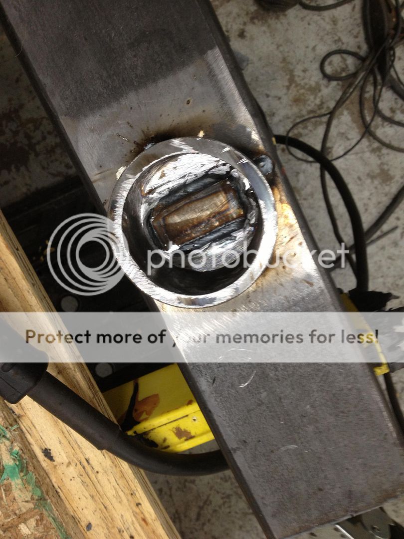

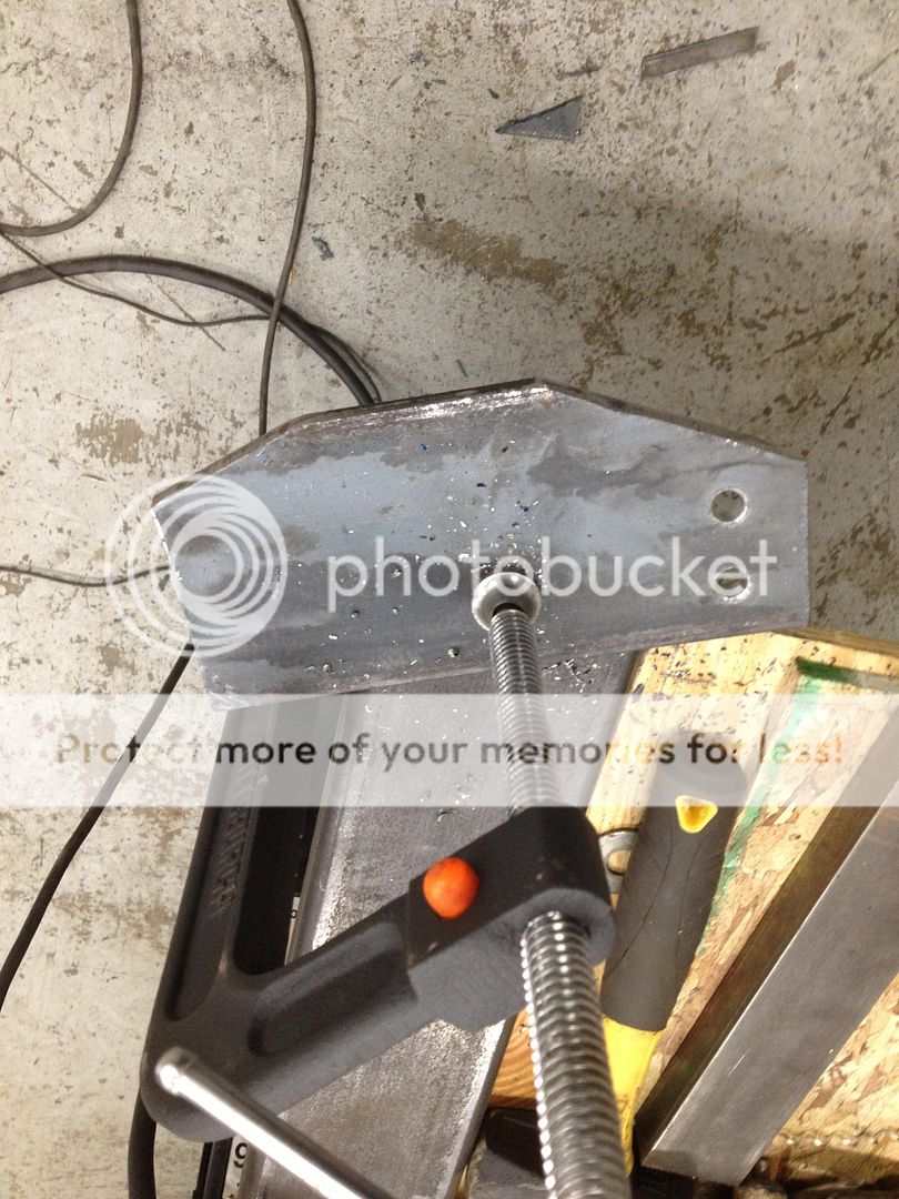

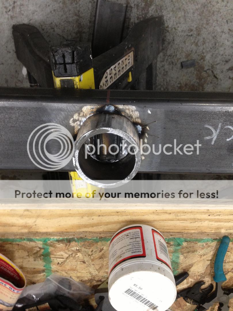

cut and started drilling out the bumper mounting plates. I make mine out of 4" wide 3/8" plate and cut the bottom to match the stock lines. just my way I drilled the inner 2 holes as well for a total of [4] but forgot that pic
cut the bumper tube out for the pass thru clevis mounts
then cut out some clevis mount 'blanks'
welded the back sides...
then something alittle different than everyone else... cut some 2" sections of 3.0" OD .250" wall DOM for the bumper stand offs..
im going round tube for my carrier, going to be different. everyone else pretty much runs square or rectangular, most likely because they don't have a bender sitting in the shop. I just went and fished mine out of storage today and got it mounted to the floor I plan on mocking that all up tomorrow after I get someone to help me line up and tack the bumper to the mounting plates.

the darn motor mounts better be here tomorrow. jeff's bringing back my battery so I should be able to drive her on Friday after tying up some little things. maybe a trip to the DMV for plates Friday... hmmm that would be cool.
