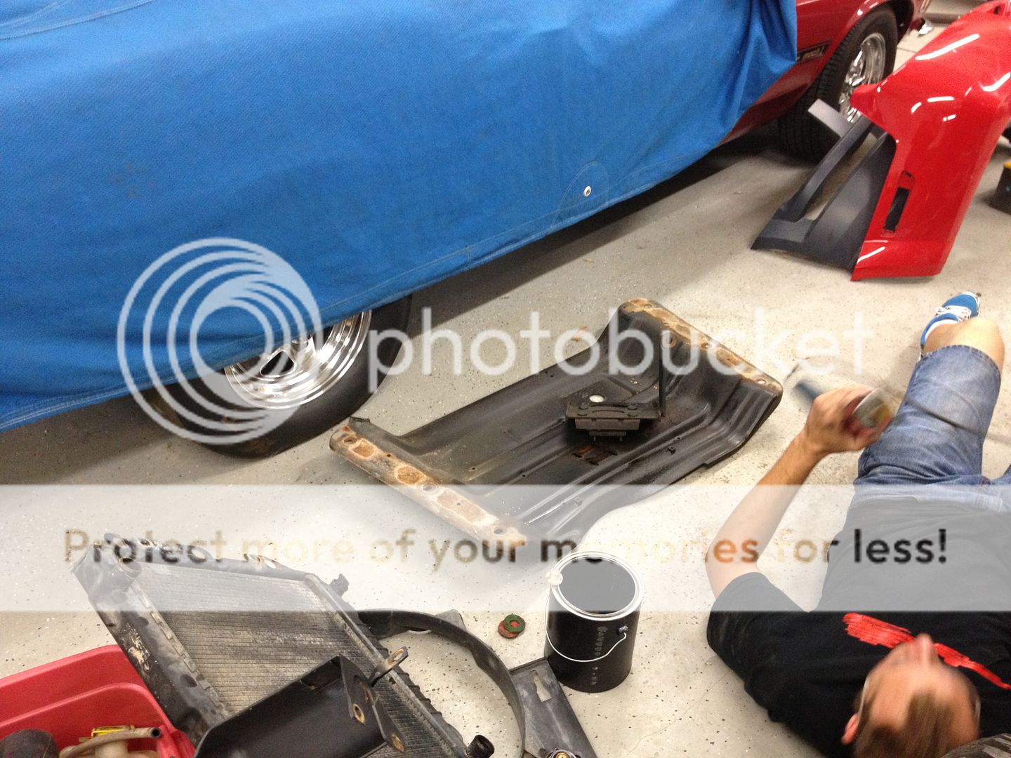

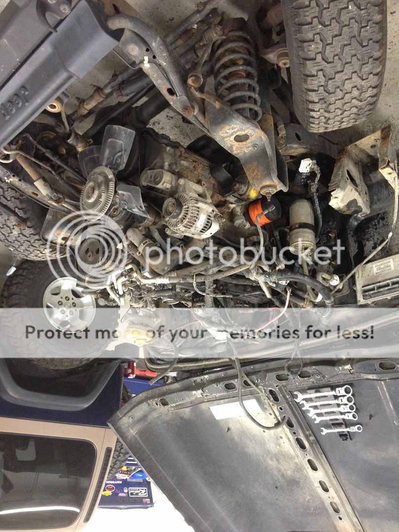

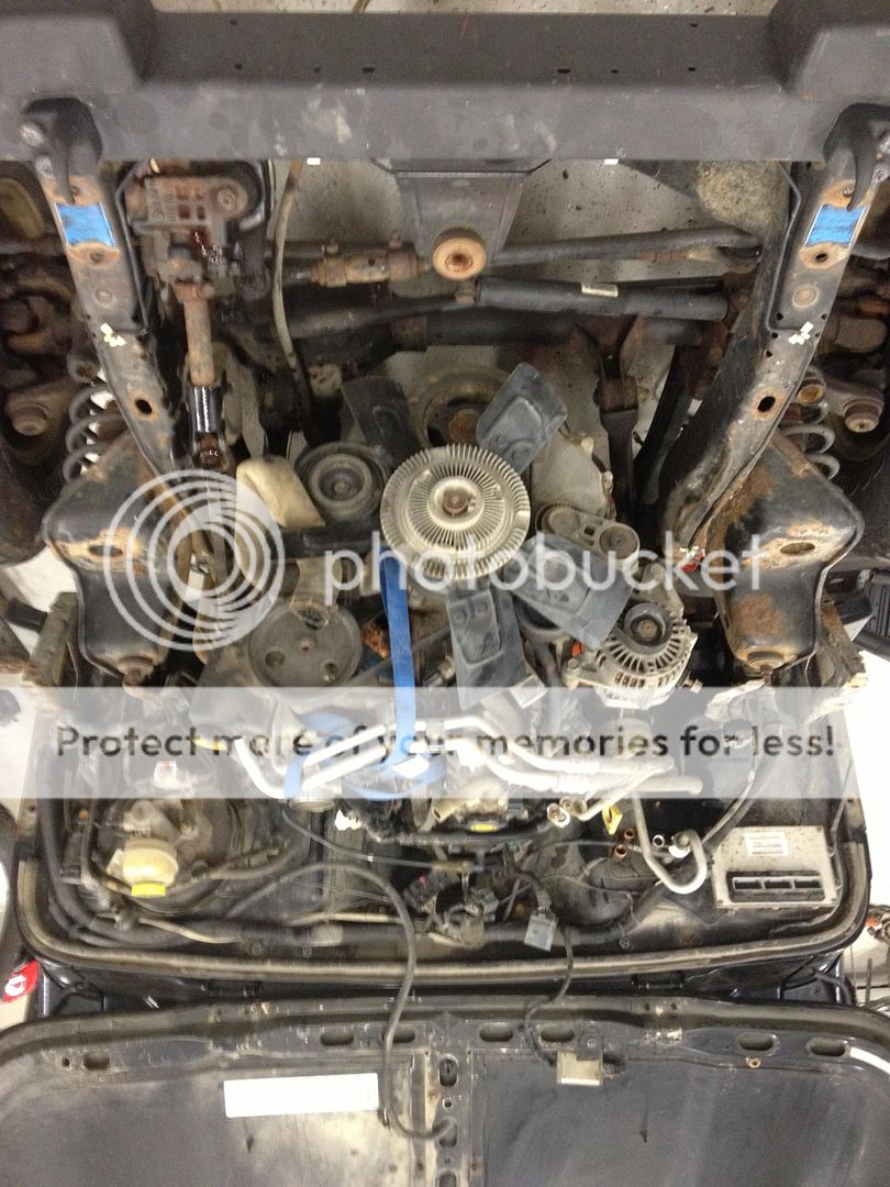

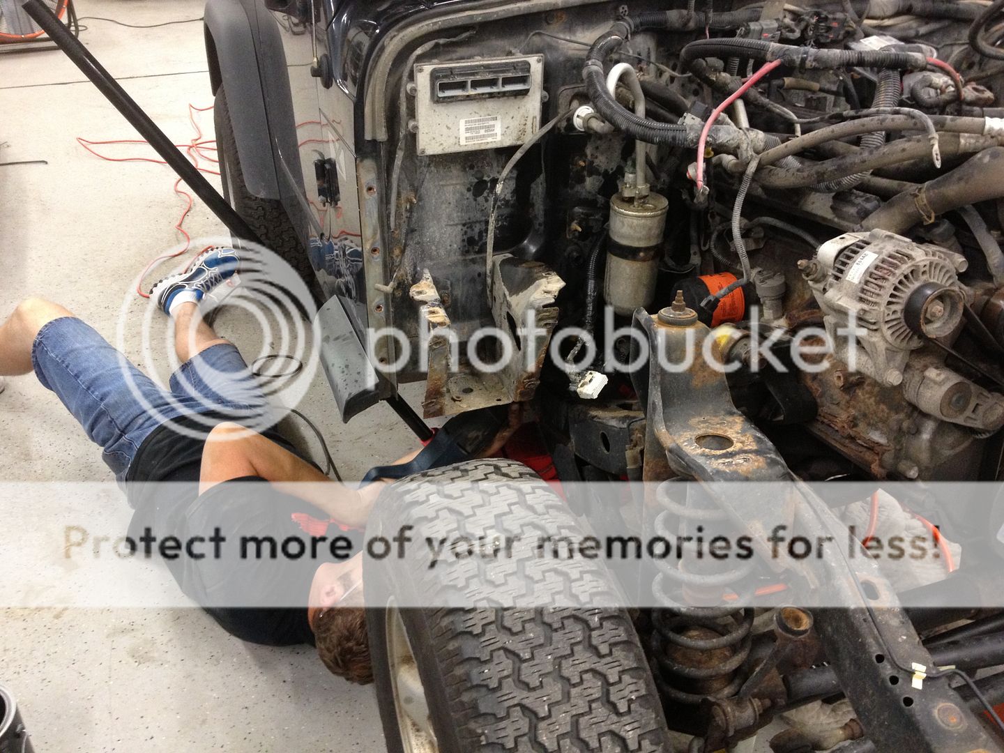

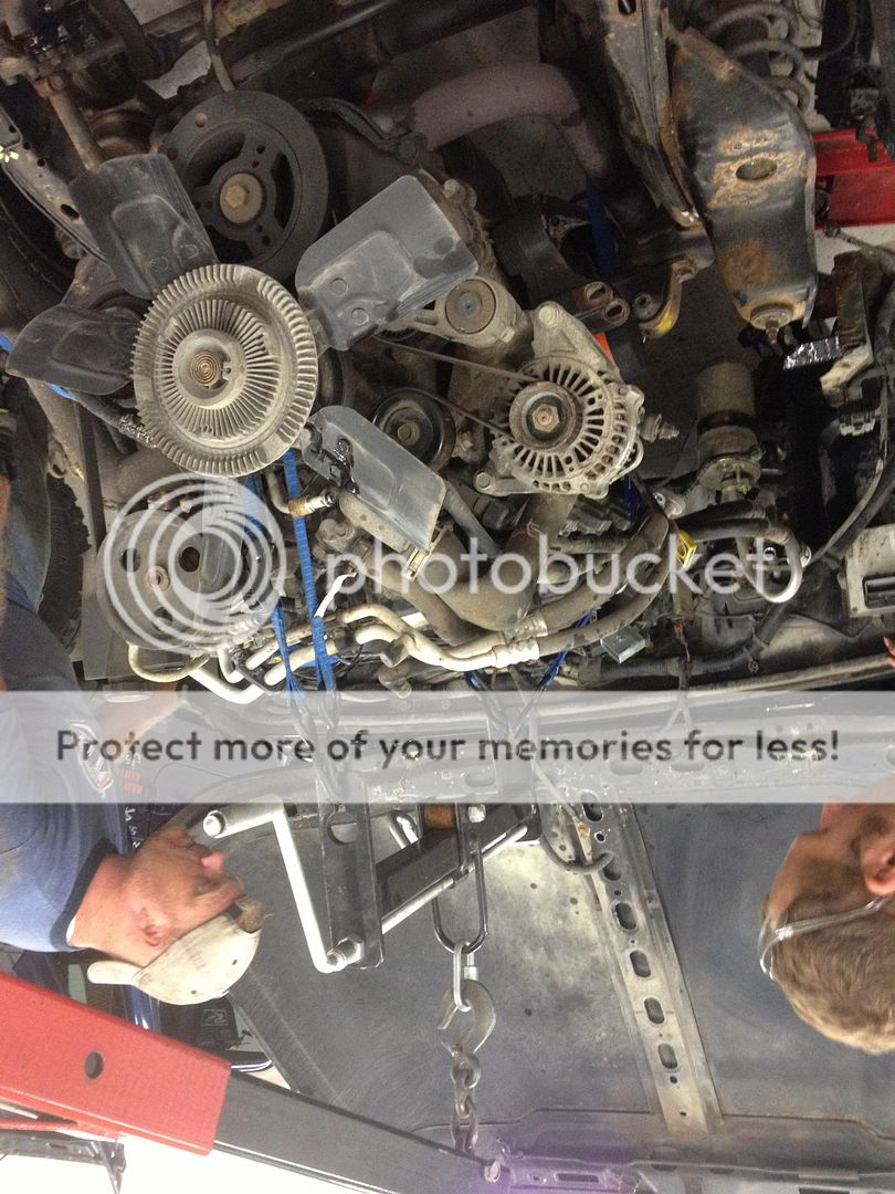

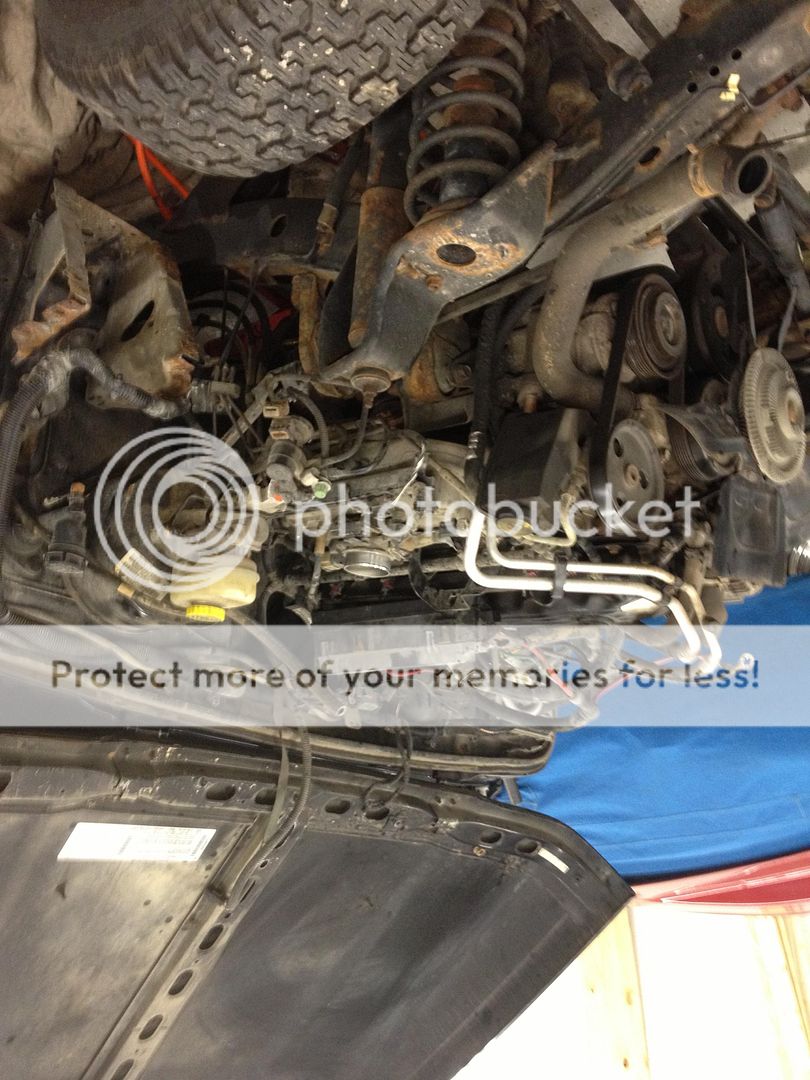

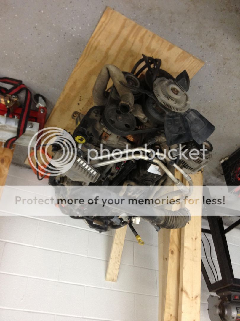

heres how i got her.. minus 3+quarts of oil..lol stock 4.0l, 5 speed, both front sway bar links torn apart blown rear pass brake cylinder, a transfer case that looks like it was used for a shovel
at about 830 tonight my brother showed up for his first 'jeep wrenchin' experience he got a jk a few months ago, and now its time for him to earn some jeep cred's.... bill, the guy who owns the big K5 Blazer we are doing an 1 ton axle swap, disc brake swap, high steer, blah blah ton of work to, hung out and lent a hand as well. so after 3.5 hours of wrenchin and a lot of direction, explanation and instruction, we made some serious progress....
my brother working on a jeep, sniff, brings a tear of joy to my eye
observe the shoveled front edge of the trans skid
on the waaay out
taaaadaaaa.....

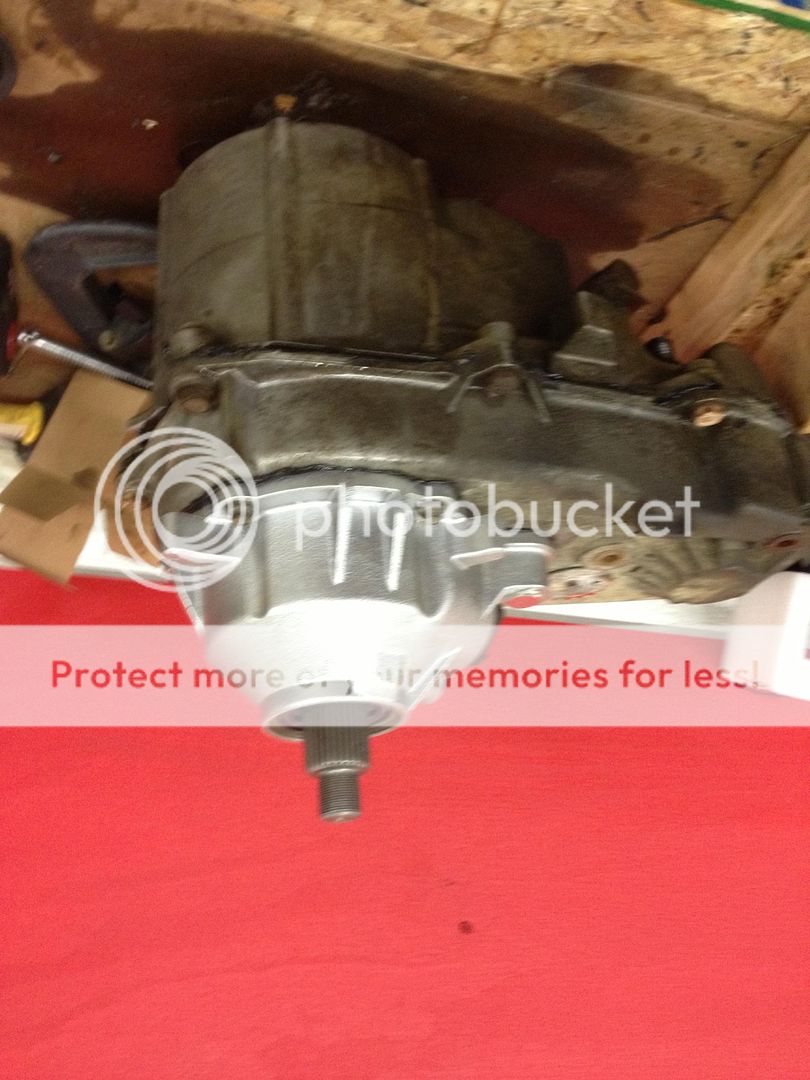

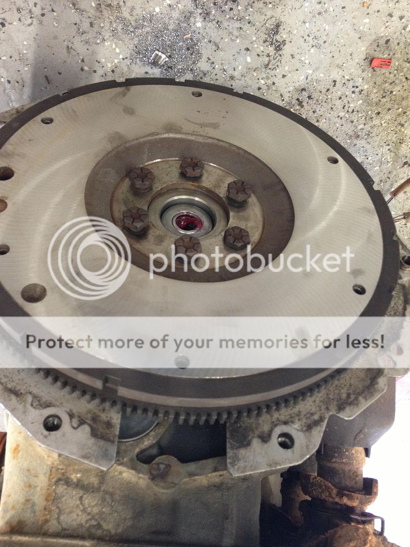

tonight i only had a few hours to play with the jeep. i separated the manual trans from the blown 4.0. then i had to separate the auto trans from the good 4.0. then move the junk out of the way, then bring over the other motor.. things are getting tight in the shop...
moved

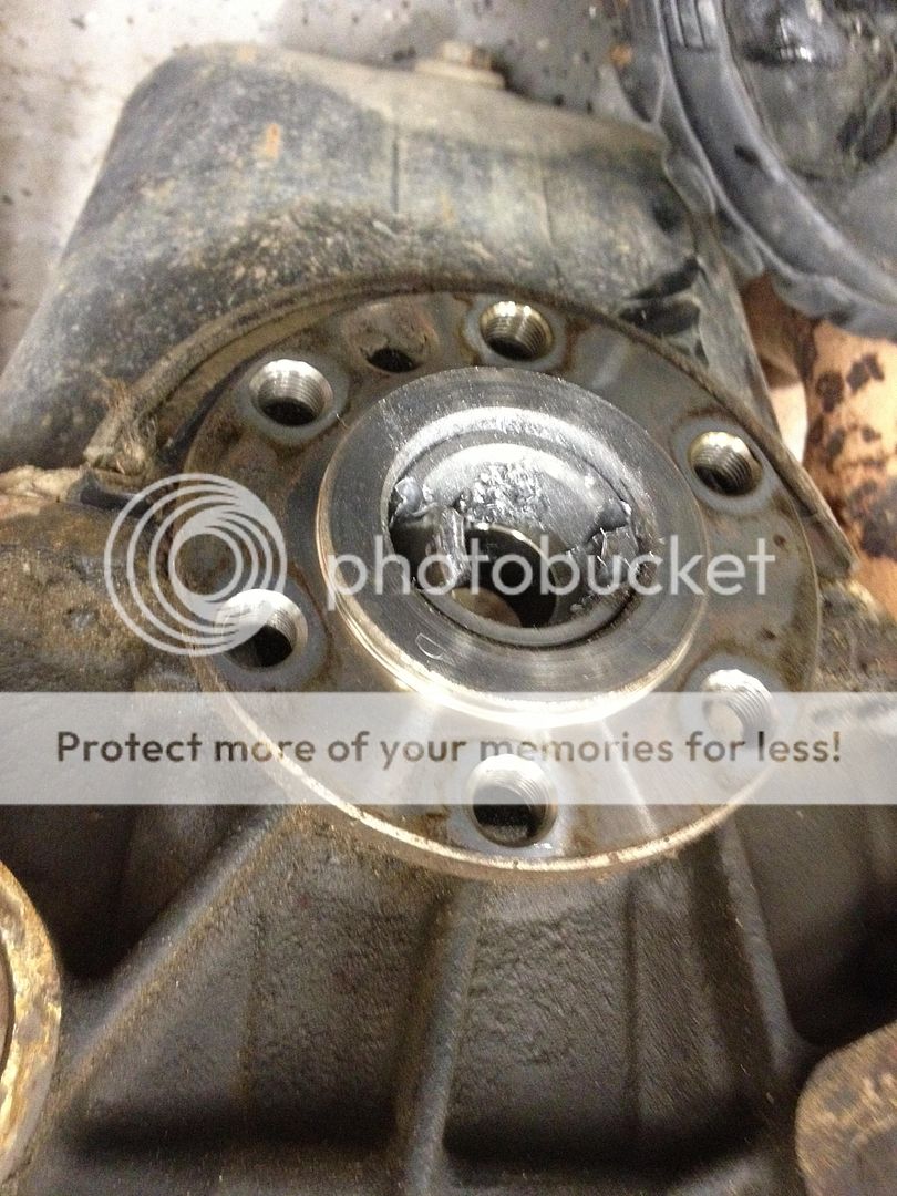

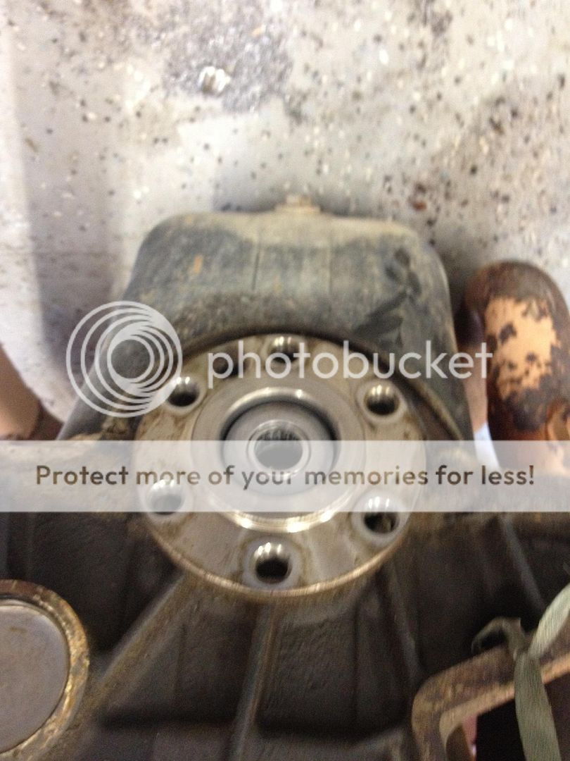

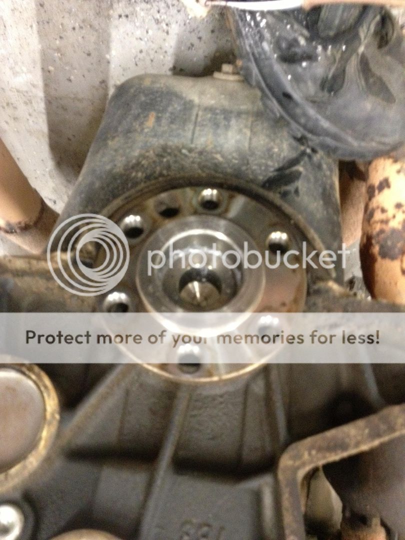

yay.. auto bushing removal time!
the easiest way that i have found is this.. drill 4 holes in the bushing, then re-drill with progressively larger bits until you only have mm's of material. split the holes open with a chisel or flat head screwdriver and hammer. then knock out a section of the bearing. i drilled 4 out of habit, you really only need 2. 4 just releases more tension from the bearing.
all out!!!
orileys website shows the local store has the bushing/bearing i need. im just going to go get that, the clutch kit and a new serpentine belt, so i can get this back together and possibly back in the jeep tomorrow night

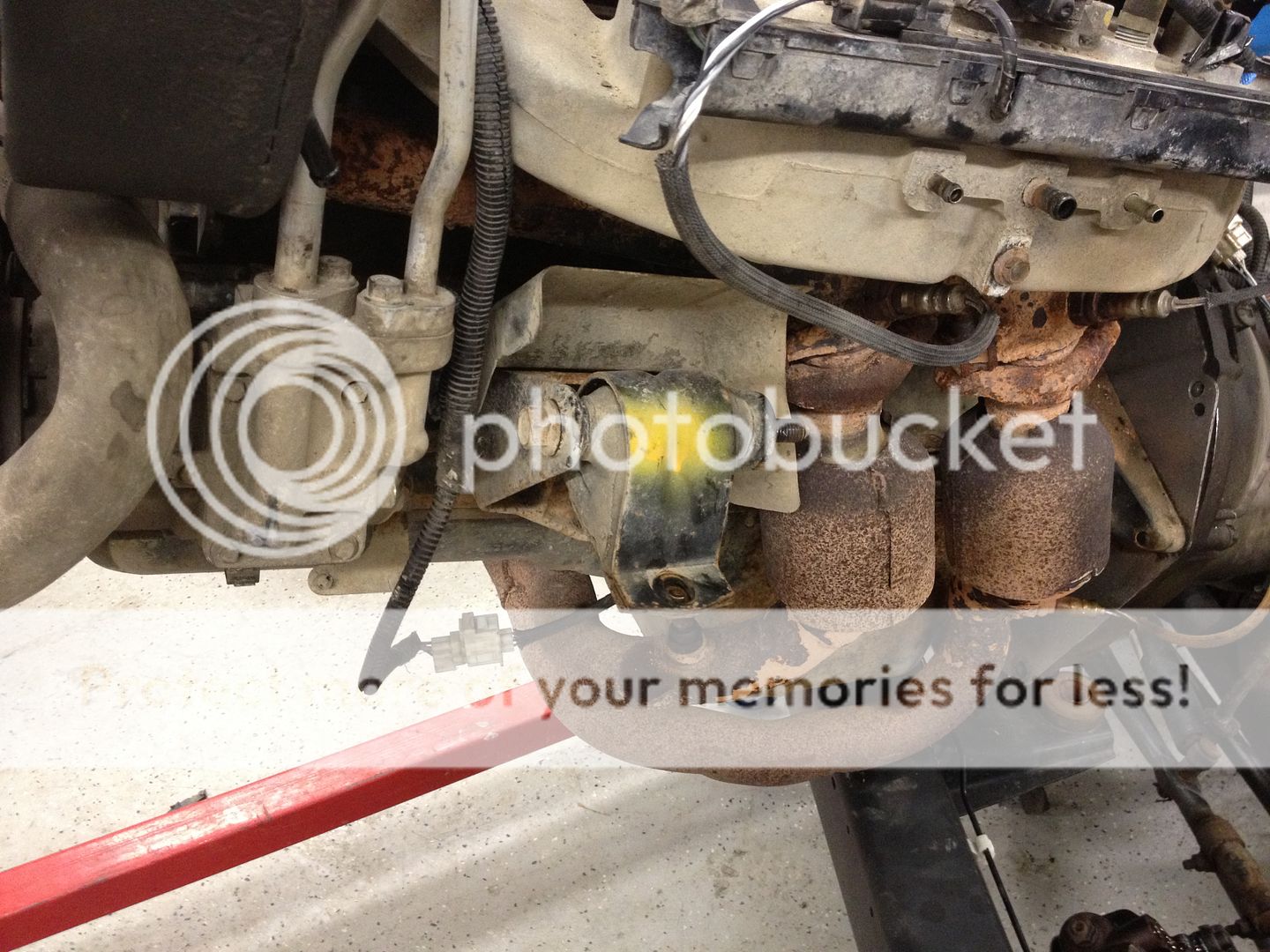

log 4 more hours.... takin alittle break, I love my little brother.. he and his wife came to the shop, they brought me some wings from hooters, yay! we bs'd for a while and they just took off. going to do a little update and then got put another hour or 2 in.
yummmm
new pilot bearing/bushing installed, disc and pressure plate..
mated back together...
I got the 4.0 manual harness installed on the 4.0 engine. the only difference I ran into was the o2 sensors are different from the 03 and the 04. the 04 engine had the power tech smpi on it so maybe that was the reason. anyways, I pulled the o2 sensors from the 03 and just swapped them in. done.
getting her back home...
I leave the drivers side mount on the motor and just separate it from the frame. its the easiest way I have found, both in and out.
taaadaaaa
now for all the trinket stuff, fuel/evap lines, ac lines, starter, mate the harnesses back together, new serpentine belt etc...
I think im going to go see if I cant knock out the SYE install rear quick and get the t case back in so I can put the skid up and the jeep can be moved, especially with the lift and new shoes coming tomorrow. [2] more additions, ordered extended flares and... im going to look up Gerry and get a cable shifter for it.

Im pretty sure it took longer to get the harmonic balancer off the tail shaft than it did to tear apart the t case and do the SYE install.
im not going to post any pics of the SYE install process etc as there are hundreds of those floating around here. what I am going to put up is my after midnight hillbilly harmonic balancer puller. I was getting this thing done tonight
I drilled recesses in the 2x4 for the shaft on one side and the C clamp landing pads on the top so they wouldn't shift.
it worked with a little assistance from a punch tapping it along
and skip to the end... I had this kit on the shelf from when I swapped the Patriot Hemi to a Mega Short Kit.
***ANYONE GOING TO DO A SYE KIT... GO GET THE SNAP RING PLIERS FROM CRAFTSMAN AND SAVE YOURSELF TIME FRUSTRATION
I have done 6 of these kits in the last few months and the craftsmans work the best!!
