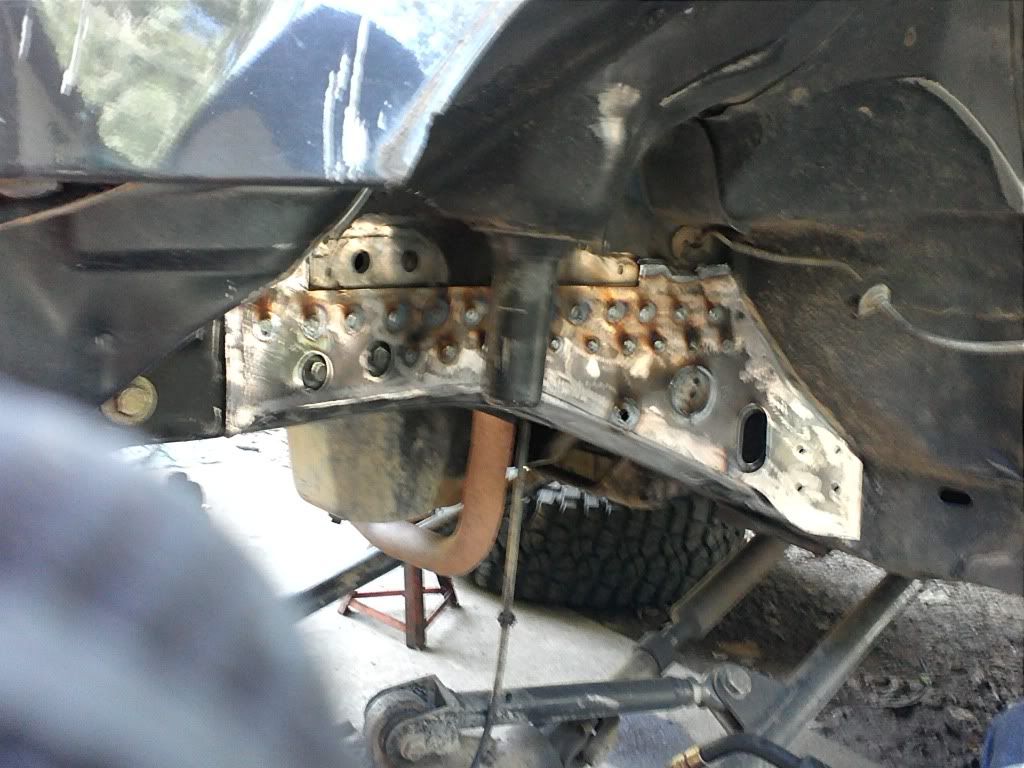

Jeeps under the knife currently. Yesterday I took everything apart and started cutting off my track bar bracket to prep for the frame stiffeners I got from Matt at Moonworks. After I finish welding those up, I am going to be fabbing a new trackbar bracket and will be swapping my frame side bushing on the track bar to a 3/4 hiem. I will also be adding an upper to the passenger side radius arm instead of just running one. Friday I am ordering new tie rods for my rugged ridge steering as well. Hopefully all this should tighten up my front end a lot because now I have almost a complete turn of slop in the steering wheel.

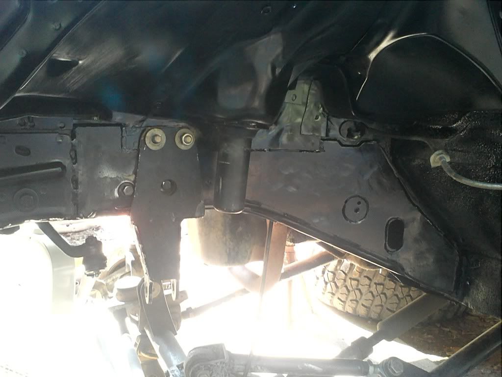

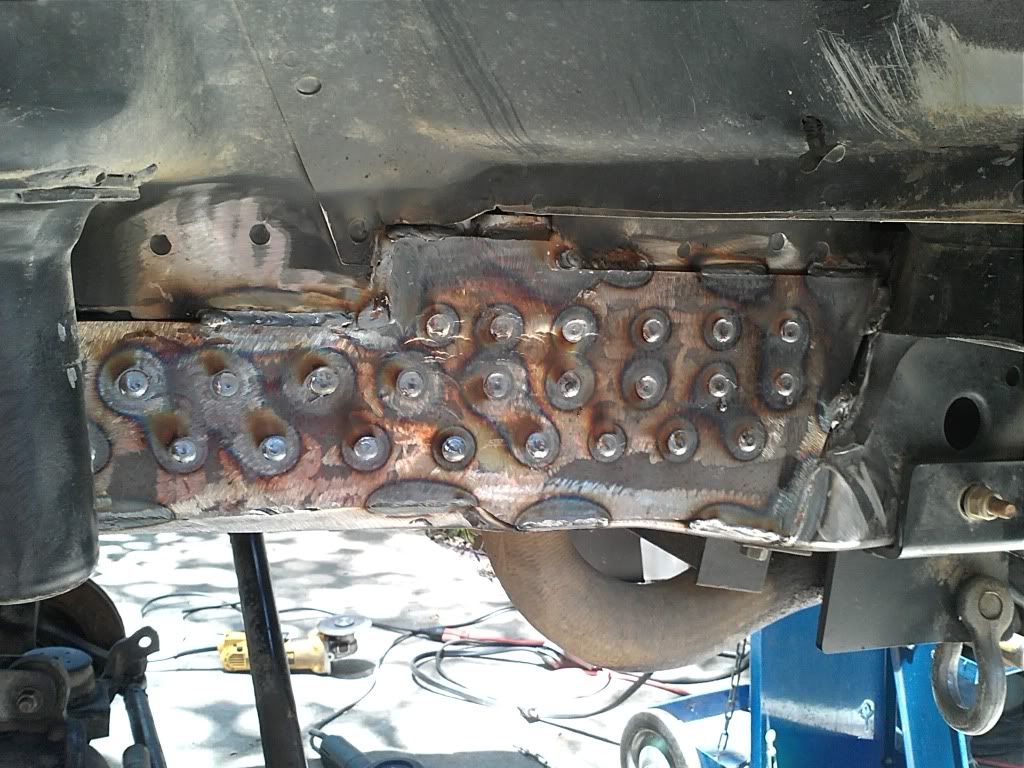

My buddy came over with his 220 and we got the stiffeners that I got from Matt at Moonworks all welded up. They fit up really well. The driver side holes for the motor mounts lined up no problem, and the fitment was great, the only thing that was slightly off was the hole for the upper control arm for the driver side and that was only off by a little over an 1/8" and that was probably my fault with how we aligned them. We started by clamping the center and filling the plug welds, then worked out with the clamps and used a small sledge hammer to form them to the frame. If I had gas for my torch forming them would of been a little easier. The passenger side fit up great. The only thing we did was grind about an 1/8" off the bottom to get a little more weld to the frame.
Sorry for the crappy blurry pic of the driver side.
I think the iro trackbar mount I have will work with a heim and misalignment spacers. Just need to drill it out a little bit. Got my new tie rod ends in for the rugged ridge kit. Gonna slap them in today.

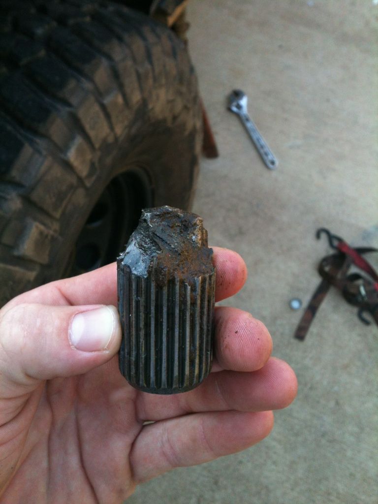

Anyways I think I am going to be pulling the trigger on an antirock soon. I want to mount it in the rear, plan on building a bumper soon and build the mounts off that. My only problem is mounting the links to the rear axle. I have no room to incorporate any tabs next to the shock tabs because of the narrow width of the 8.8. I think I could come up with some new shock mounts that also mounted the swaybar link to it directly behind the shock. I will try to snag a picture of how my rears set up now.

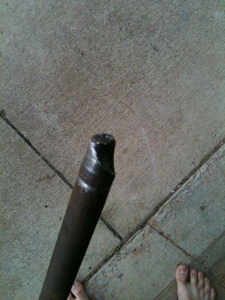

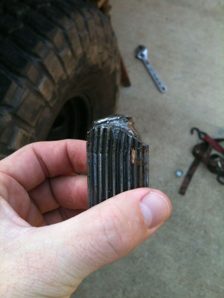

Also Ive been fighting with getting the broken shaft out. Broke at the splines just far enough to not let me get the carrier out. I tried to put a screwdriver through the driver side, slide it past the center pin (which I can't remove to take the locker out, already thought about that) and tap out the shaft but as soon as I started tapping on it it got wedged in there nice and tight... and thats where I left it after deciding I should study for the test I had at 8 this morning. Got to find a narrow crow bar to slide into the axle tube and pull that screw driver out, then I need to find a 1/4" rod long enough to slide past the center pin and try and tap the shaft out with. My only other idea is to pull the whole damn axle out and turn it on its side and slam it against the driveway a few times. Not trying to do that.
-Ronnie
UTChavok is offline
post #104 of 170 Old 09-24-2012, 05:31 PM Thread Starter
UTChavok
Location: Clemson, SC
Posts: 1,743
Got the shaft out and the carrier too. The bearing on the carrier on the side the shaft broke is all chewed up. Going to be taking it to the 4 wheel center tomorrow and and see if I can get a new one pressed on. Any problems with just putting new bearings on it and putting it right back into the housing? I know there are shims underneath the bearings, if I put those back the same way should I have any problems?
