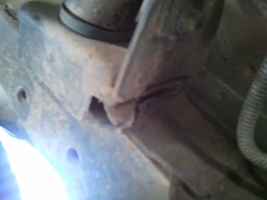

Pretty much got all my parts for my 4 link now. Waiting on a truss and heims, tube inserts, and jam nuts for my upper arms. Got some RE lowers for $150, they are 33.5 bolt hole to bolt hole. Ive got some 2" .250 wall and 1.5" .250 wall laying around so I plan on lengthening them to around 38.
No turning back now :supz: Ohh and sorry for the ****ty pics, apparently my smart phone's camera isnt the smartest and takes blurry pictures if you dont hold perfectly still for 10 seconds.
When I get a better camera with a flash I might try to take more, but heres a couple pictures of the torn unibody. Its just as bad on either side.
There is also a hole to the left of the opening in this picture to that is covered by that plate.

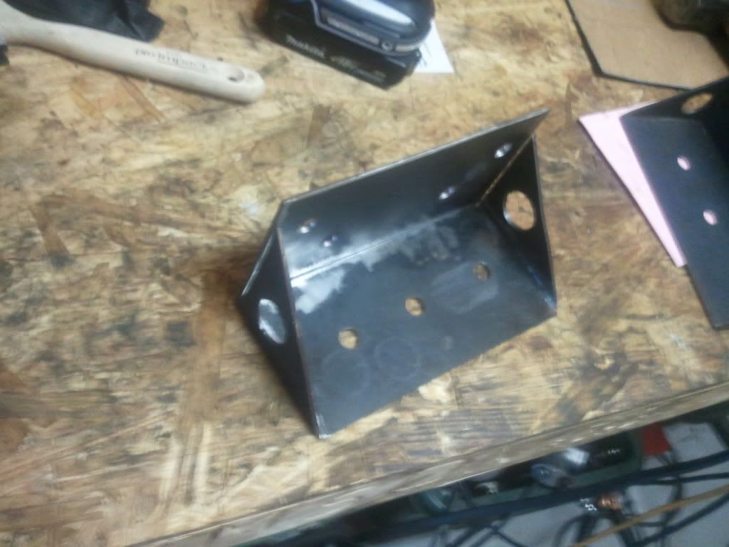

Inner truss piece welded on
Lowers mocked up
One of my upper tabs for the truss. I angled the truss back and made these tabs so my uppers didnt mount up so high. I could of cut the truss down another inch but figured this would be easier and it works.
