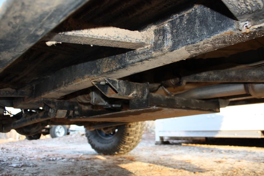

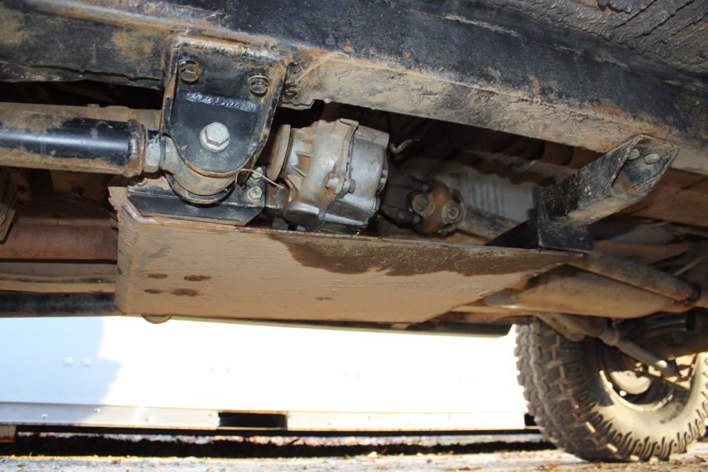

Skid plate and crossmember under the jeep
Going to be taking it off and cutting the welds out. Got countersunk allen head bolts that im going to use. Stich welded it in place friday night before our trip. Still technically is removeable I just have to unbolt both crossmembers at once

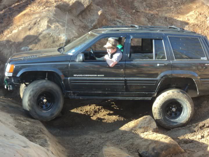

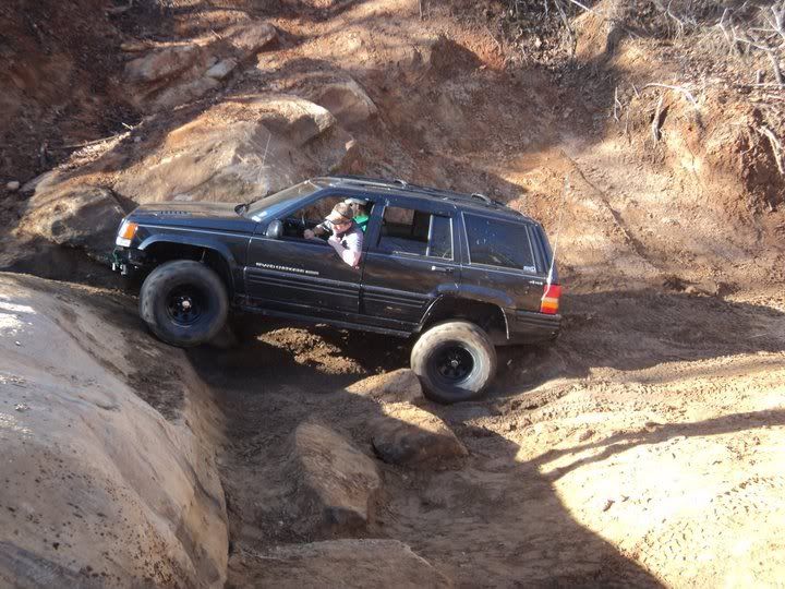

Heres a few pics, this was the TnT rock garden they finished a little while ago. Got my first nice body damage on the new niner from it. No pics of that yet.

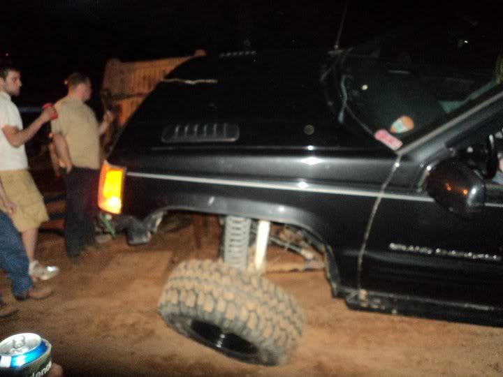

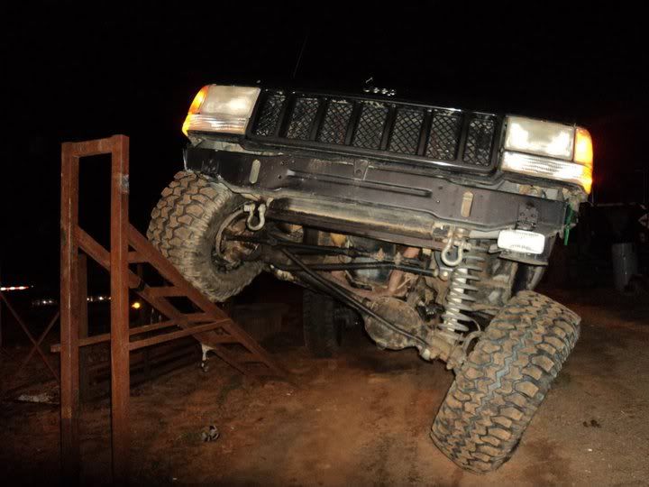

Flexing on the sketchiest rti ramp ive seen yet. We camped in this guys yard since Gulches was reserved 3 weeks in advance. They had like 3 propane 350 buggies and loved coors light. Was an awesome night haha
Still climbing

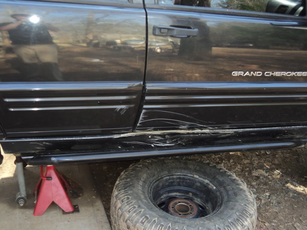

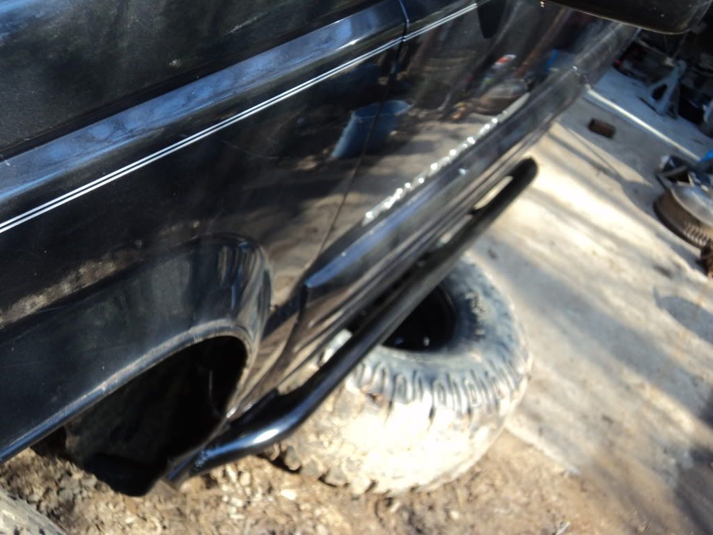

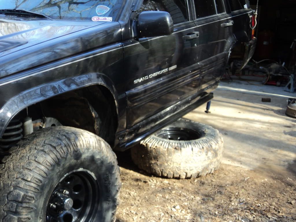

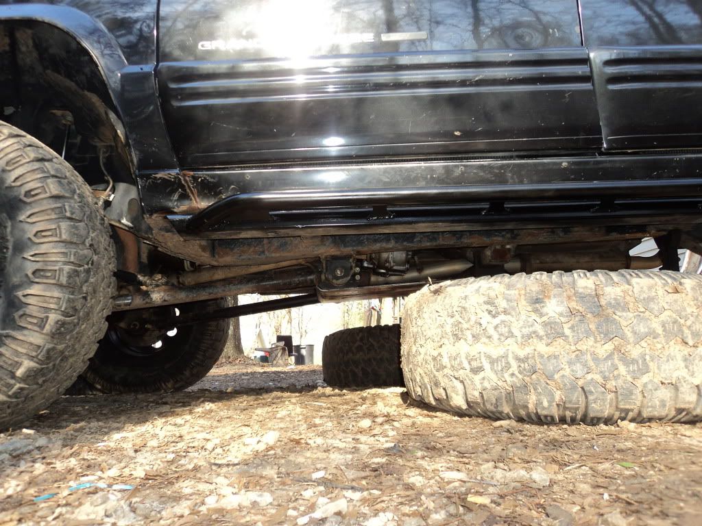

Finally got a digital camera to take some pictures. Finished my rails for my sliders and added gussets to them.
Little bit of body damage from TnT garden at Gulches

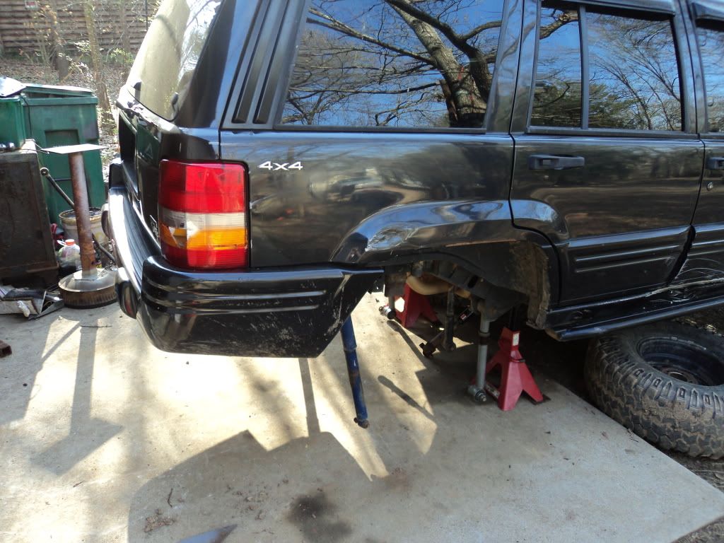

Ohh yeah and Im sort of missing my rear axle
44 out and in the garage. Never run a trackbar relocation bracket on a rig that actually sees abuse. Ive had this on there for a year and the only thing holding the track bar on was 2 loose bolts. All the welds were ripped.
8.8 Going in
Went to LKQ today and pulled the last parts ive been missing. I lost my caliper brackets somehow and my flange adapter so I went and pulled those off and some other misc bolts to make sure I have everything. Still need to set up the locker in the axle and shafts in and then test fit it under the Jeep.
