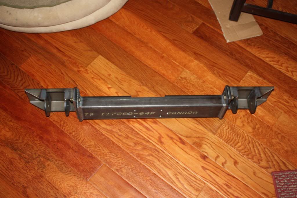

Also got my crossmember, its painted and ready to go in.
-Ronnie
