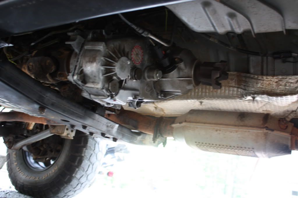

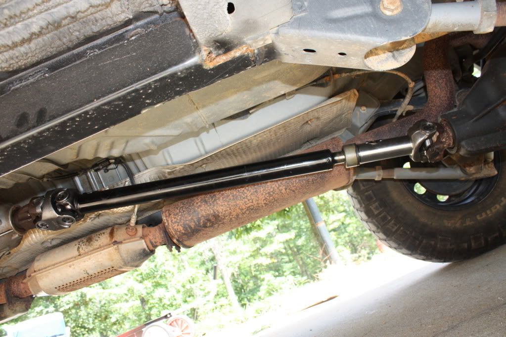

Bye bye all wheel drive. Swapped in the 231 w/ a sye and got a new shaft made at carolina driveline.

V8 ZJs came with a 249 transfer case, which is all wheel drive. Have 4 All time, neutral and 4 Lo. Wanted to have 2 wheel for the road since Id be locked front and rear.

Is the FullTime-case to NP231 a straight-swap (similar year or any year), or is there something else involved with it? I'll be lifting/locking up the "LuxMobile" shortly so I will need to do something about it's full-time 'case.

It is a straight swap if you find a 231 with the same length input shaft. Luckily I did so I didn't have to tear apart the cases. It's hit or miss but this thread should explain it a lot better then I ever could.
ZJ 231 Swap - MallCrawlin.com Forums

vibration
did you have a vibration after the lift before the transfer case change. i was told not too lift mine as it would have vibration becuase of the awd?
Honestly I did not have any driveline vibes that I could notice. My tires vibe a little bit becuase their so worn but that was noticable before and after the tcase swap. My tires would lock up in turns and chirp a little due to the AWD but that happened before and after the lift and tire swap.
