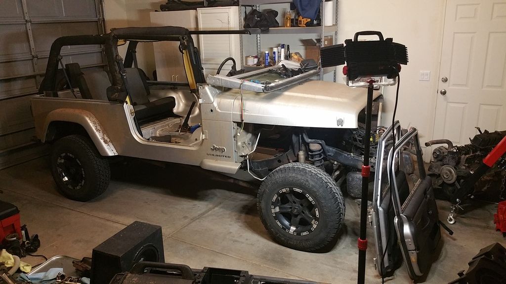

Well, long story short I sold my TJ and bought an LJ. Best decision I have ever made. It also helps that I got a sweet deal for it. It really helps that some how I came out ahead.
2005 Unlimited with 102,000 (I need to update the mileage when I remember to look at exactly what it is) on the clock.
The entire vehicle looks like I ordered it in '05. The interior is with only one exception 10/10. The engine bay looks just like the interior another 10/10 besides the brake booster.
It is all stock except for a CAI and a 2"RE BB with matching shocks. It came with hard top, soft top, bikini top, the stock rims with yokohoma geolander tires, and another set of rims with KM2s. All tires are 31s and all tops match the condition of the vehicle... brand new from what I can tell.
Out with the old (and it will be missed, not much, but a little):
In with the new (and it will be dearly loved):

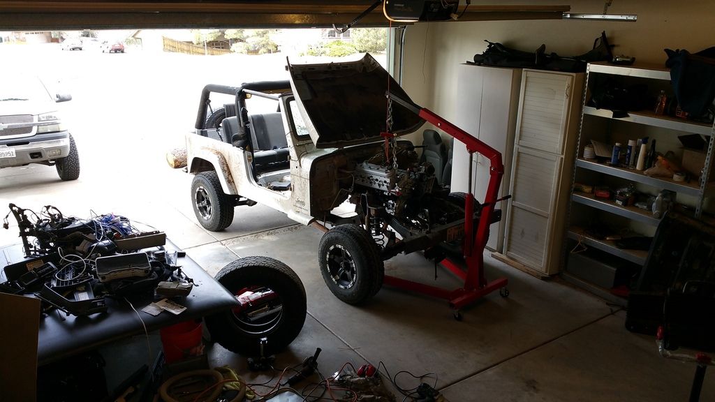

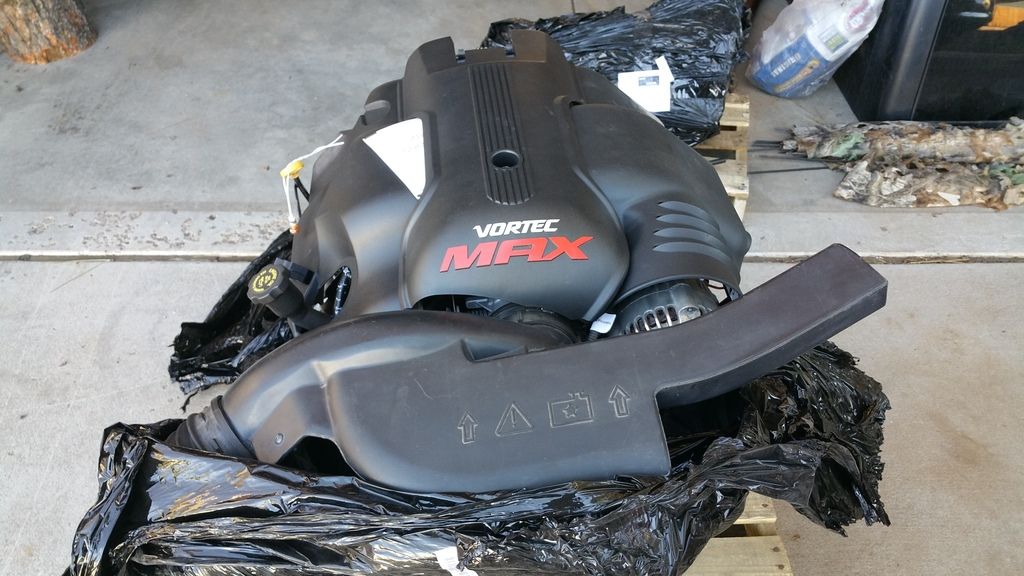

So the LJ has +/- 130,000. Long story short old motor blew so a new one goes in. I have just received my freshly rebuilt LQ9.
It has the 317 heads and an LS6 cam. In the previous post the motor is between the frame rails, however sadly the mounts
have just been ordered so it's not actually in yet.
The transmission is the 4l80e. It will be mounted to the np231 then stock axles. Still to be ordered shortly is essentially everything else.
Transmission to xfercase adapter, transfer case mount, slip yoke eliminator, various other transfer case junk, drive-shafts, radiator and fan,
and lastly all the other stuff I'm missing. At this point it's not that I don't have plans to lift, It's that my budget for the Jeep is done as is
imaginable. Beyond all the stuff I just mentioned, I will be talking to local exhaust shops to see if an entire system can be made up cost
effectively or whether I will have to order headers and have them do from the headers back.
Things I need to finalize. Not just what fuel pump, but fuel system in general and power steering. Also torque specs for any and everything
related to the motor and transmission. I just realized that most of the text above would fall under needing to finalize technically, but hey,
here's to redundancy and a *****in' new motor

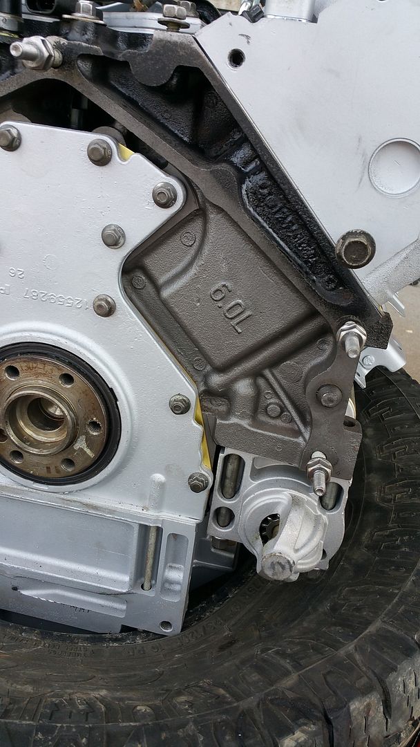

No real work was put in today, so random pic of the day is as follows:
Pic of 317 Heads With casting number:
post-saving-pre-proof-read edit: you can also see the 42 PSI Big Green fuel injectors in this pic

This post will be for my continually updating list of ordered/installed upgrades, I will edit in other crap later, but for now and for ever the top, below this, will contain swap parts more or less.
SWAP:
-LSX4u.com "Vortec Max" LQ9 6.0L w/317 heads, "LS6" cam (204/218@.050 .550/.550 lift 110 LSA), 42 PSI Big Green injectors, standalone harness.
-LSX4u.com 4l80e

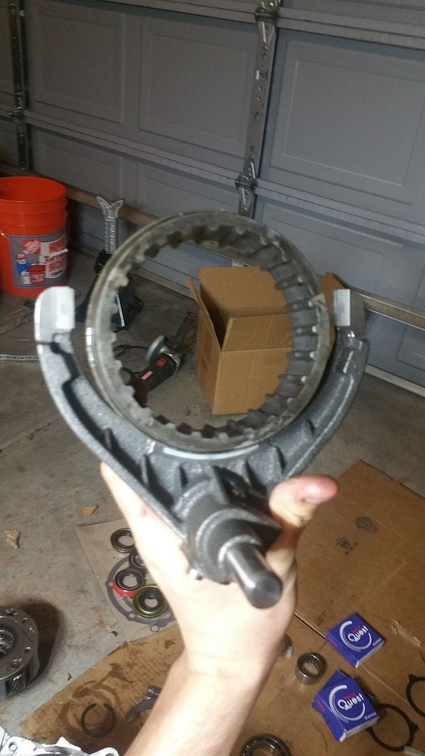

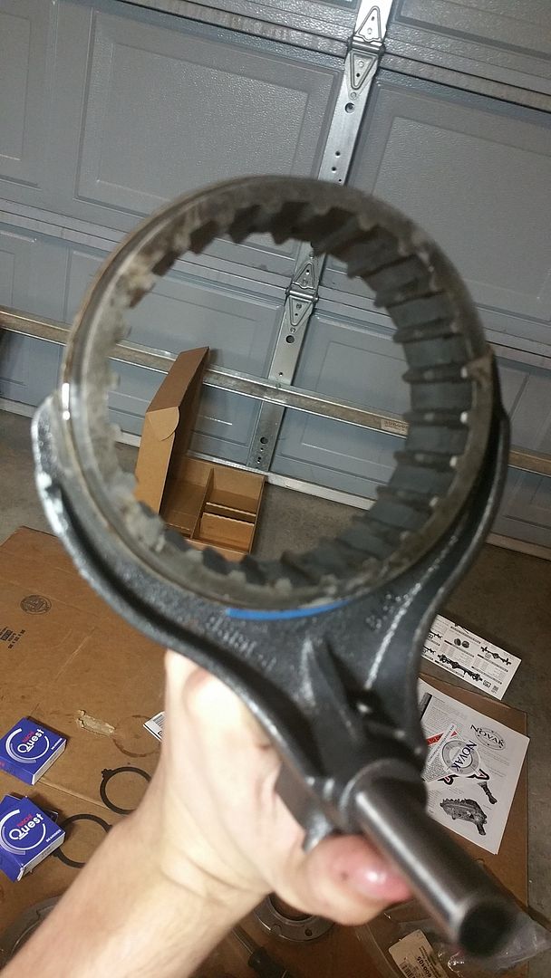

After recieving all the parts for the 231 I either have an extra and wrong shift fork, or I did not recieve the bigger ring gear thing. From the other hd rebuilds ive looked up, they retained the stock fork. I'm assuming I will end up using the stock sized fork.
Original fork and ring
Original ring with the new fork
