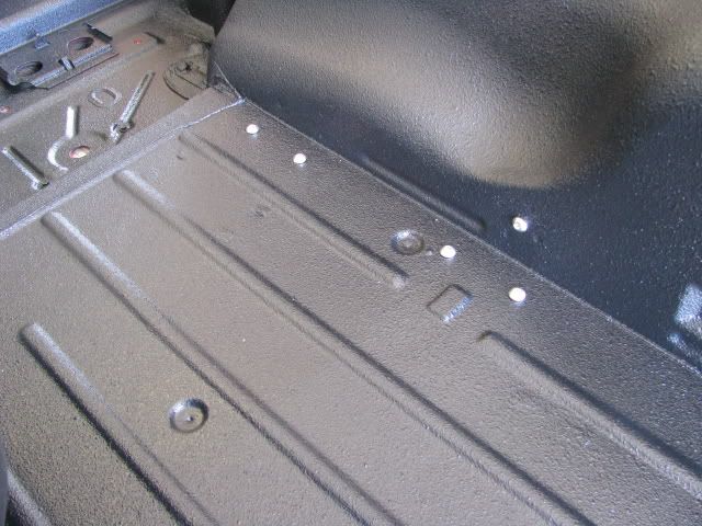

Everything is back together.
The footman loops in the cargo area weren't in very good spots for my set-up. I drilled the rivets out and removed them. I plugged up all the holes. Any bolt holes I might use down the road got some stainless hardware to plug them up for now.

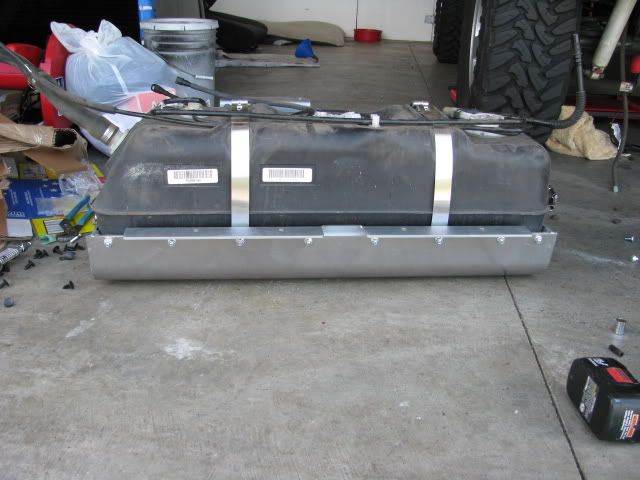

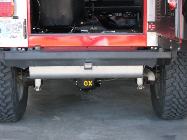

I got the gas tank skid in also. Didn't realize how much the old skid was rubbing the trackbar.
Touched up the raw metal with some paint. Not going to worry about it much more since I see a four link in the future.
Savvy doesn't seem the send any instructions, and I didn't have time to wait for the password on there site. On my 06 the sending unit plugs in on the very top. The other years I have seen used a small pig tail so you could unplug before lowering the tank.
