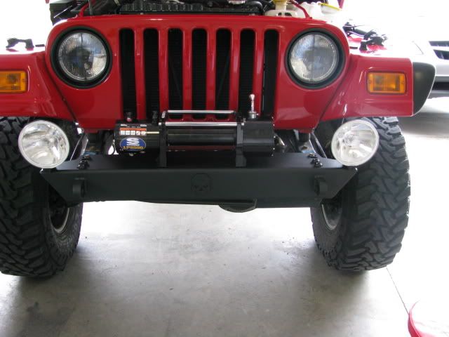

Cleaned up the bumper and put some primer on. I am waiting for an aluminum flare head so I have to mount that still. Then I will finish paint it. The front end only dropped a 1/4 inch.

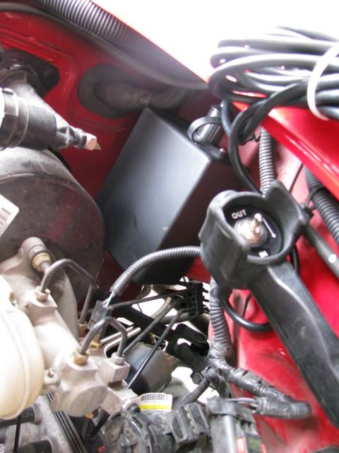

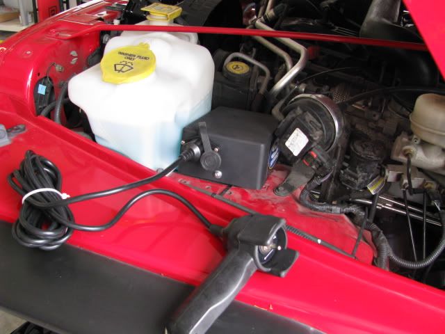

I want to run the control box under the hood. It would be cheaper and easier not to, but I like it out of the way.
Looking for spots to mount it. Looks tight here.
Fits here, but i'd like to keep this open for an air compressor.

Your bumper looks awesome man.

Really like the look of the new bumper

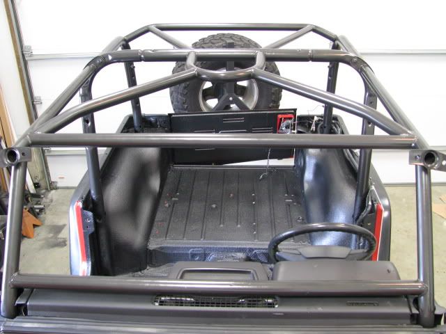

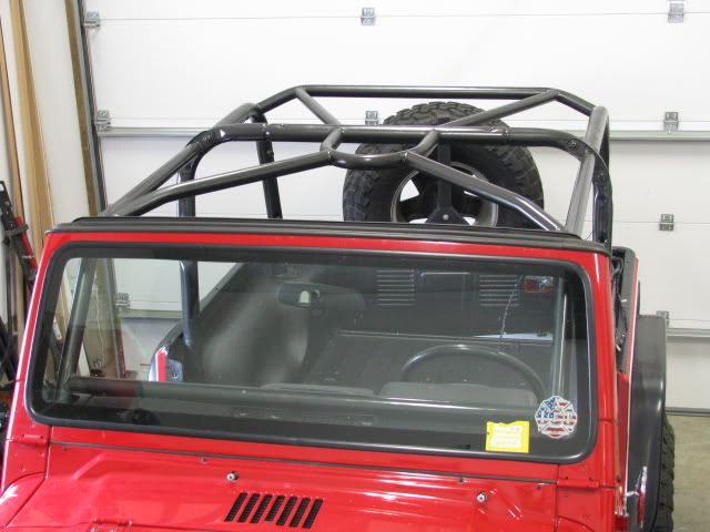

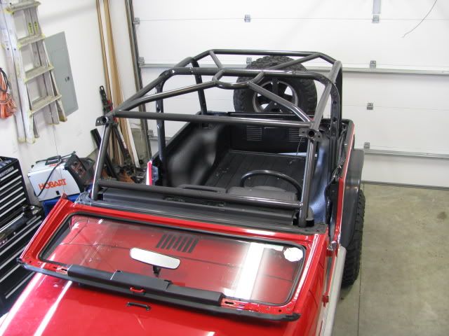

I pulled everything out and started on the cage finally.
I do not reccommend the A to Z cage kit. Either spend a little more and get the polyperformance kit, or buy a tube bender and notcher. I had to renotch every end. None of them even matched. Every piece was way to long. I had read the the above on here, but didn't think it would be as bad as it was.
Started with the windshield bars.
The hoop and top cross bar.
Front. Still need the down bars.
Fixing every single notch took forever. I tacked up the rear spreader, and then put the hard top on to check clearance. It will work. My plan is to take the top off, put the last over head bars on (B pillar to C pillar), and then finish wled what I have. Then I can fold the front window and do the A pillar bars. I'll paint the cage, and then U-Pol the tub.

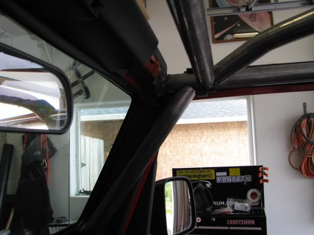

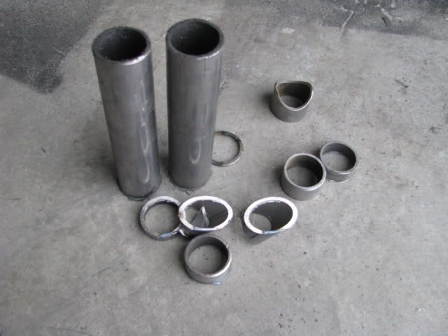

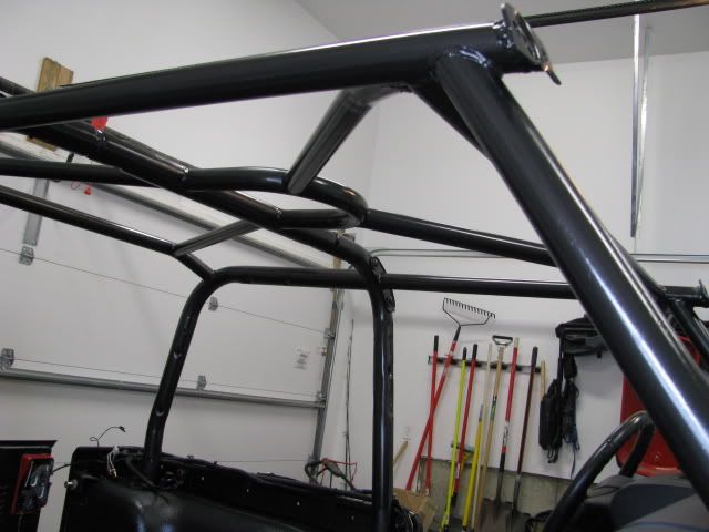

Finally got some work done.
I finished up the cage. Still not happy with the kit!
Here's some of the leftover ends. Every notch had to be fixed so it would fit.
The A-piller down tubes had to much angle to them. I clearanced all I could and they still would not fit the way they should have. I then had to notch the end of the door surrounds to so they would fit.

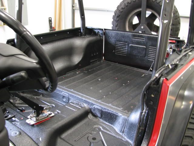

I painted the cage, and finally got the u-pol down. Very happy with the U-pol. It has been curing in the garage for a couple days so I can put it back together tomorrow and install the gas tank skid.

Did you make that skull on your bumper yourself?
