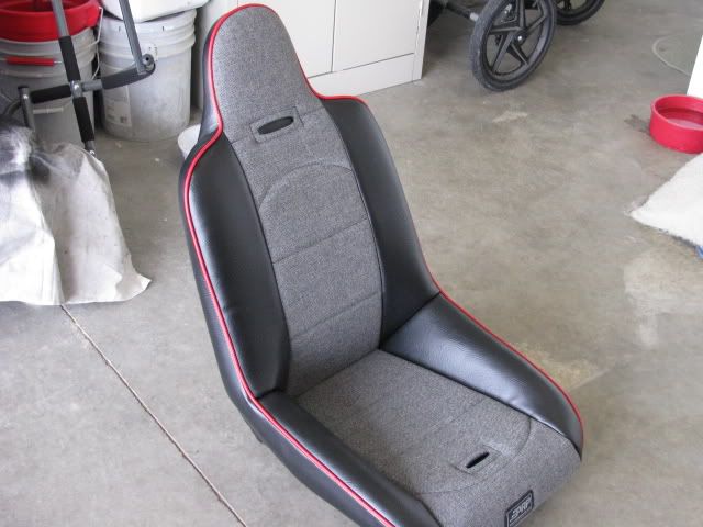

The PRP seat for the back showed up finally.

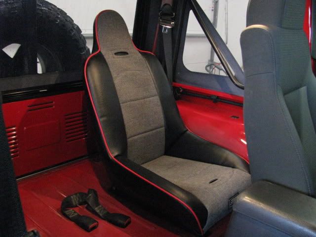

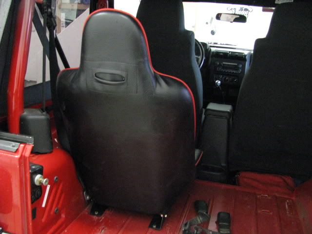

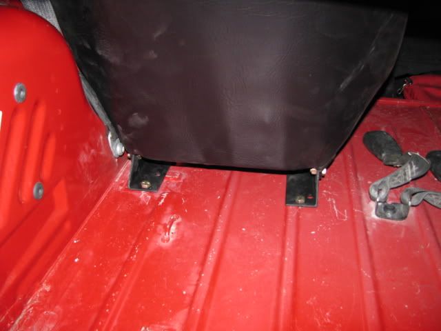

I got some work done today. I cut some brackets out of L metal and mounted the little guys seat. I really like the PRP seat. It's very comfortable, and I can't wait to get a set for the front. I went a little nuts and bolted it through the tub with five grade 8 bolts on each side. I went through the existing seat support brackets and added fender washers. It won't be coming out!
It will be a little tight with two dogs, but it looks like it will work.

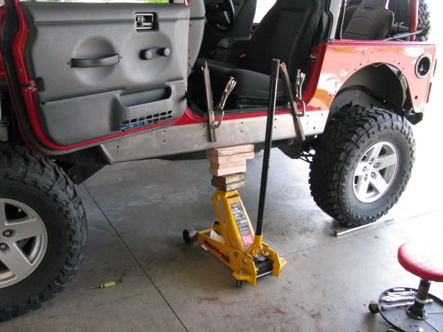

Time to lose some weight.
Old sliders off.
Fitting the Savvy sliders.
Sliders on.
Benderff is offline

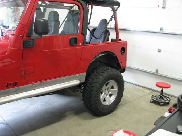

On to the corners
The newer Savvy corners will come with the needed cut out, but I had to make my own. The 05 and 06 hinges are not flat like the other years.
After a quick call to Gerald I marked out what I needed to cut. Drilled a hole in each corner and used my jig saw to cut it out.
After I got everything all together the tail lights acted funny. I check the bulbs and they where all good. I found the lights didn't seem to have a good ground. The old light guards I had for awhile had some rubber washers on them for some reason. Once I removed them I was back in business.
All done.
