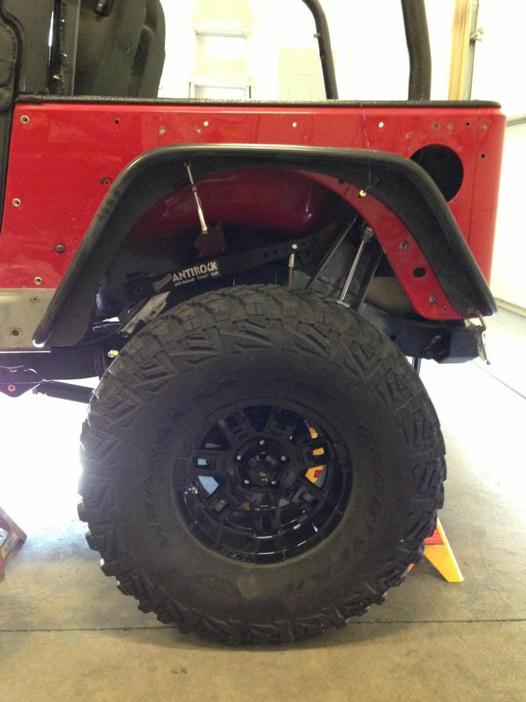

Summer overtime has been great on the bank accounts, but Jeep time has been a low priority.
A little progress.
Mocked up wheel well.
Benderff is offline

Ha. Thanks. I was nervous about the back spacing, and those gave me what I wanted, and didn't cost an arm and a leg. On a side note MT no longer makes them. I almost picked up an extra spare, but I'm pretty sure I make these last until I need some wheels with more lugs.

With another vacation done, and a few days of house projects I have got some work in on the Jeep. All burned in, wheel wells opened up, painted, and some guards to keep rock out of the emissions pump.
I have some a few days of free time now. Time to get to work on the fuel system and get this thing running again.
