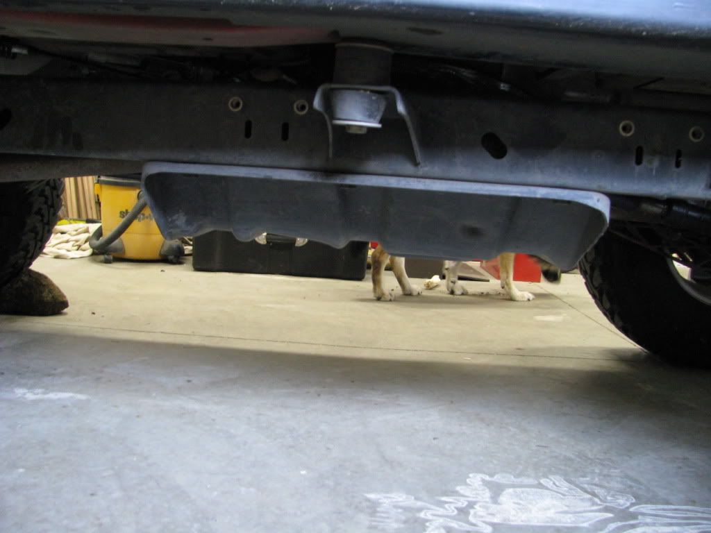

Along the way I picked up a set of MOAB rims for cheap off of craigslist, and a teraflex tummy tuck. I cleaned up and painted the skid and threw that in just before the D44. No more shovel holding me up. There are other skids I would be happy with, but I got this for $80.00.
Before
After
Shaved off a couple inches.
I sold the 33x12.50 tires and the rims with lame BS on craigslist. I liked the Toyo MT's so I went with a set of 285x75 16's on the Moab rims.
