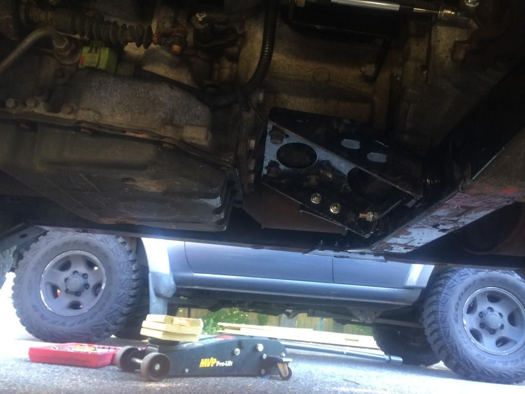

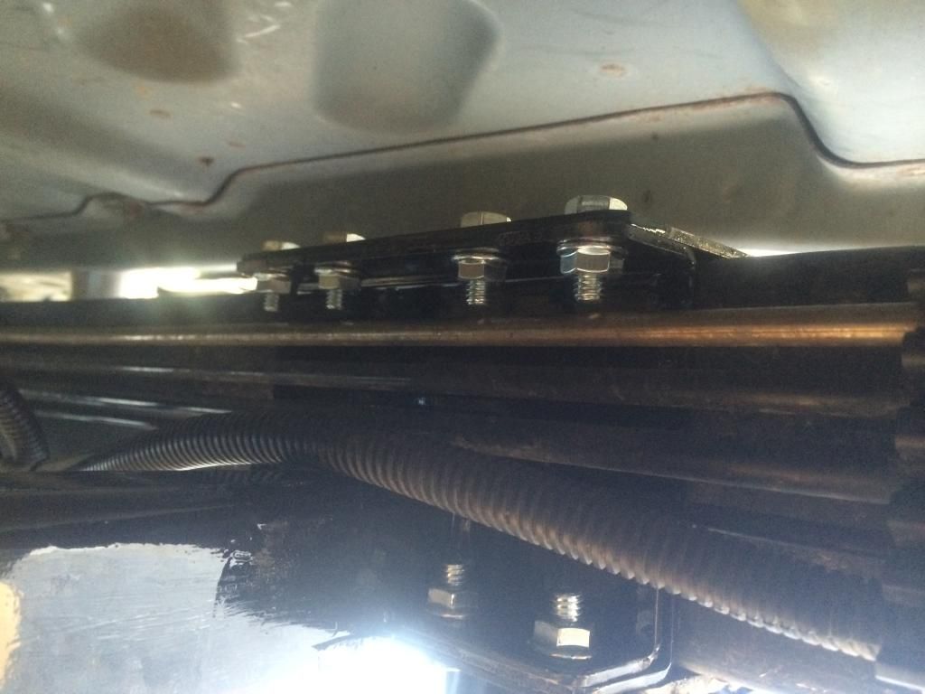

So after doing the body lift I put on the Savvy cross member. That wasn't too bad, the directions are very well laid out- albeit outdated. Got that on, saw how much space it cleared up to do the novak. Body lift and TT crossmember will make that a lot easier.
Also, I would have taken my front fenders off to do the MML. Note for you guys thinking about doing something similar.

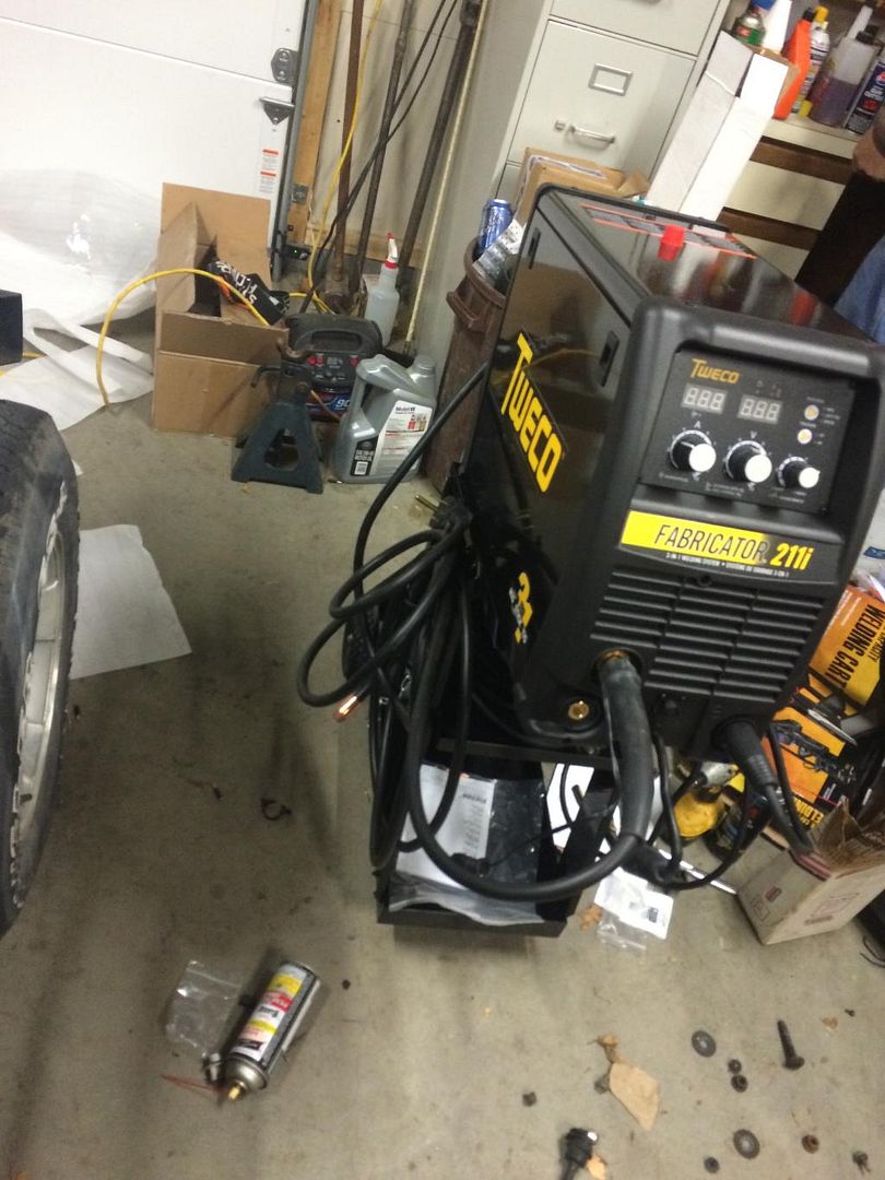

Bought this. Researched the **** out of them. Yes the Lincoln powermig just came out but this was out for a couple years. I like the gun and consumables, but you have to order them. Which looking back would have made the lincoln a better choice but this has a little more ***. I was throwing too much heat on some 1/2" plate which is more than I'll ever need.

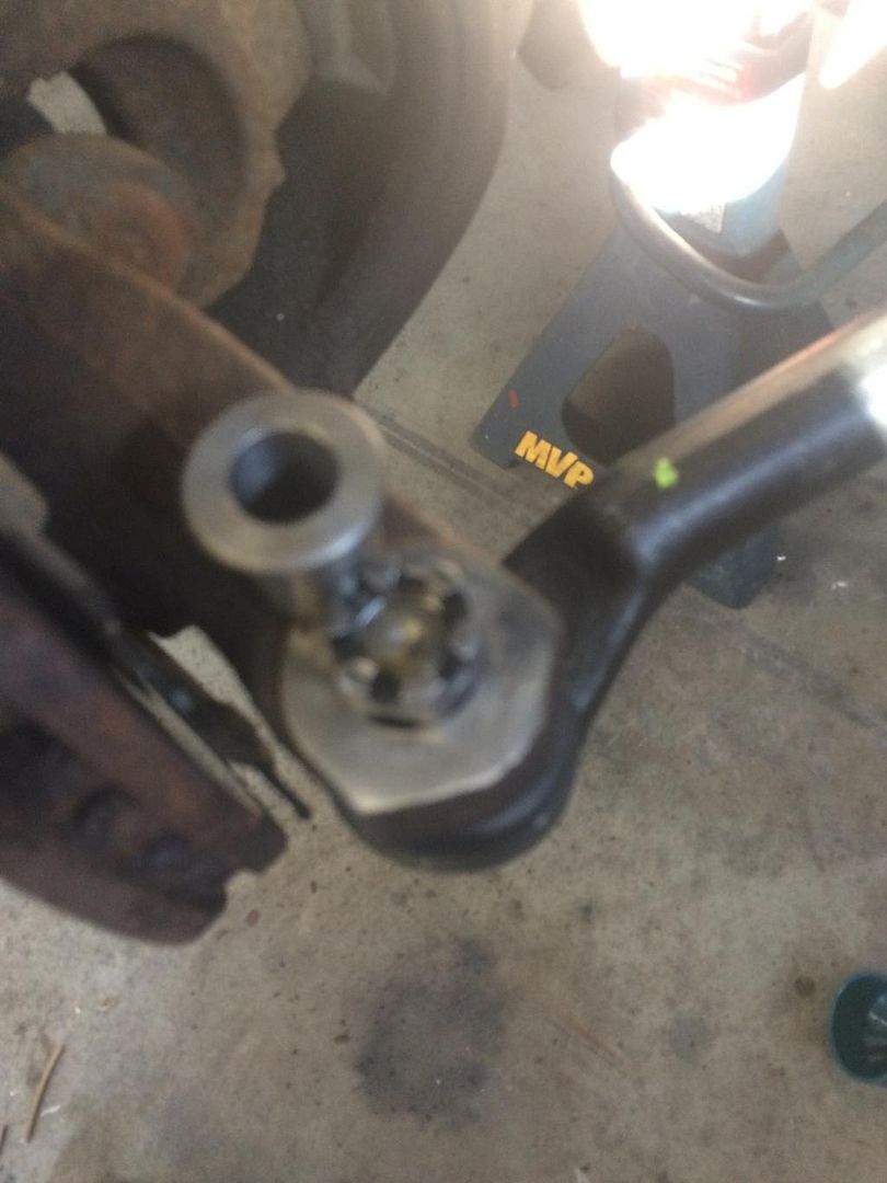

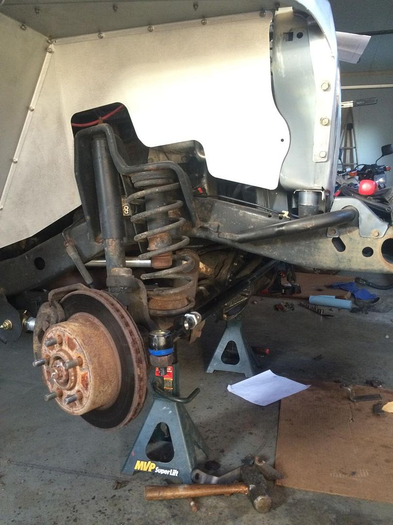

This brings me to my next stage- fenders and steering. I know i needed to beef up the steering and looked around for some time for upgraded steering for 0" lift Tj's. I called up JCR offroad because most people seemed to be happy with their kit, so I got their Over The Knuckle kit along with the correct tapered reamer.
Before I ordered the kit I explicitly asked if this would work for a stock height TJ. Their answer was a resounding "yes, you won't have any problems"
BS.
As you can see the tie rod was rubbing the OEM track bar. The tires would turn approximately 3-5". Not enough. So I had to pay to ship it back and got 75% refund and 25% store credit.
Can't say I would ever do business with them again after my store credit runs out. Ordered rear bumper to frame braces three weeks ago, still waiting on them....
Anyways, back to the drawing board. Thank goodness TMR customs makes a stock TJ taper insert. Picked that up from a local dealer. Luckily 7.15 degree taper is 3/4" which is the diameter of the hole for the insert.

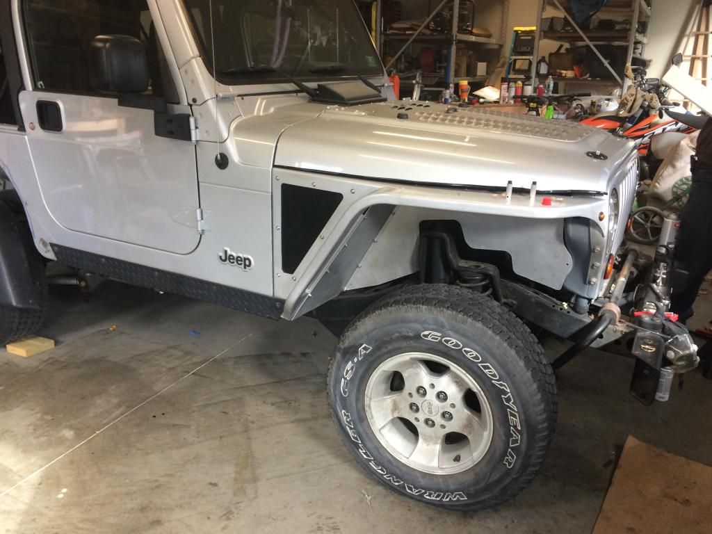

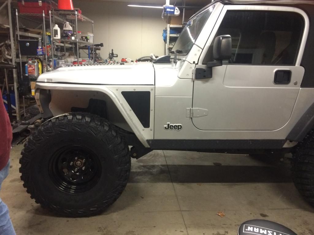

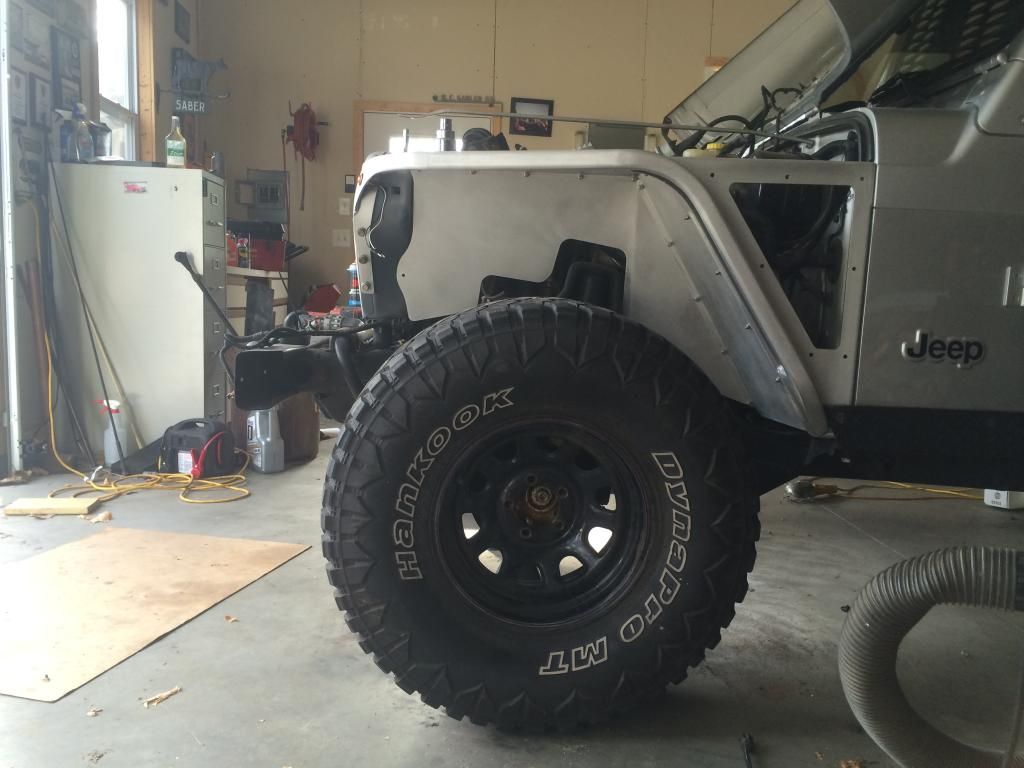

As you can see the fenders were already put on. Sorry for the lapse. I got mad thinking about JCR again.
Anyways they are the PSC Defender XC Taper 3" flare. install went well. Jason at Krawl Offroad hooked me up with the fenders and the inners.
Install went well. Fit pretty darn good. Was nervous about installing the fuse block under the hood.

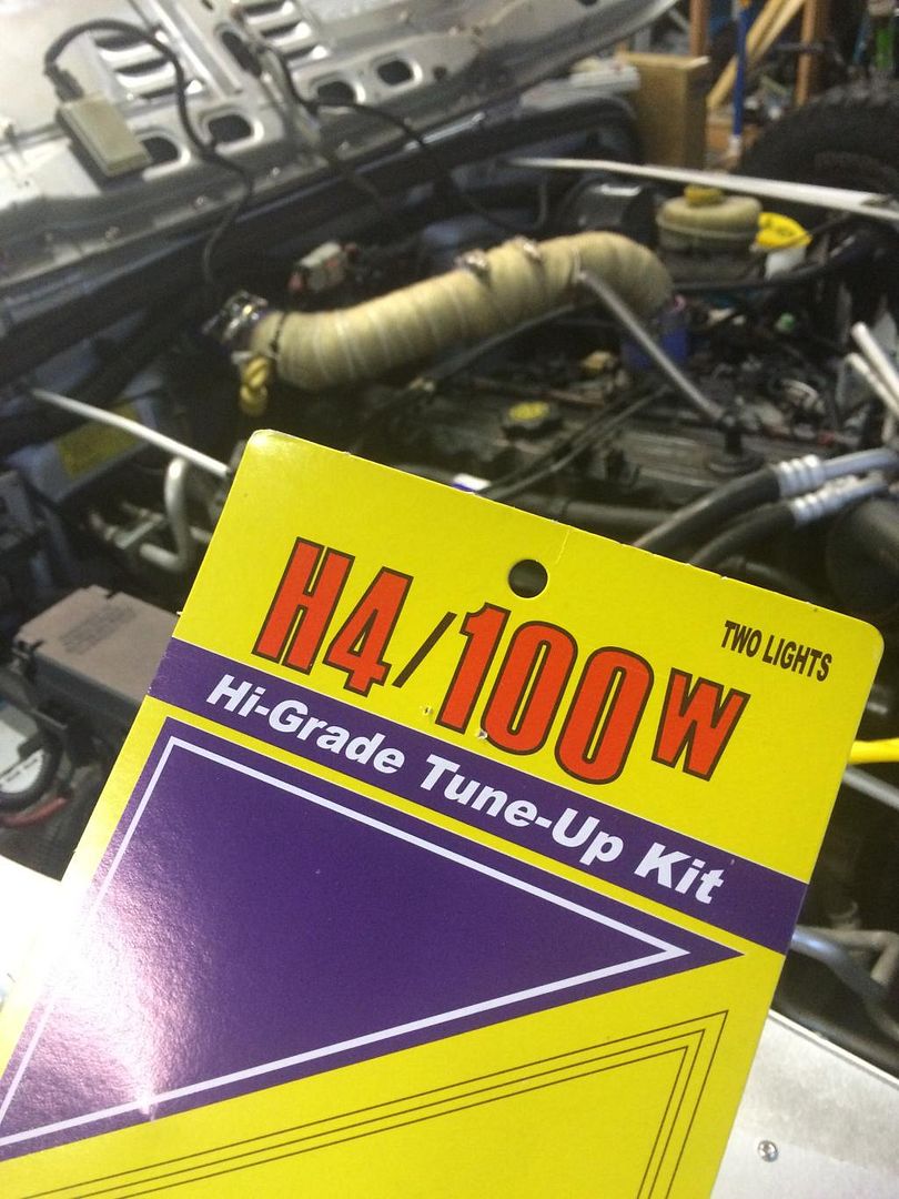

did a couple little things- e code headlights, orsham bulbs and aftermarket harness.

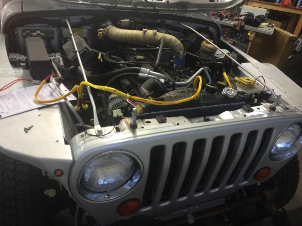

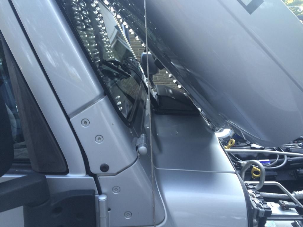

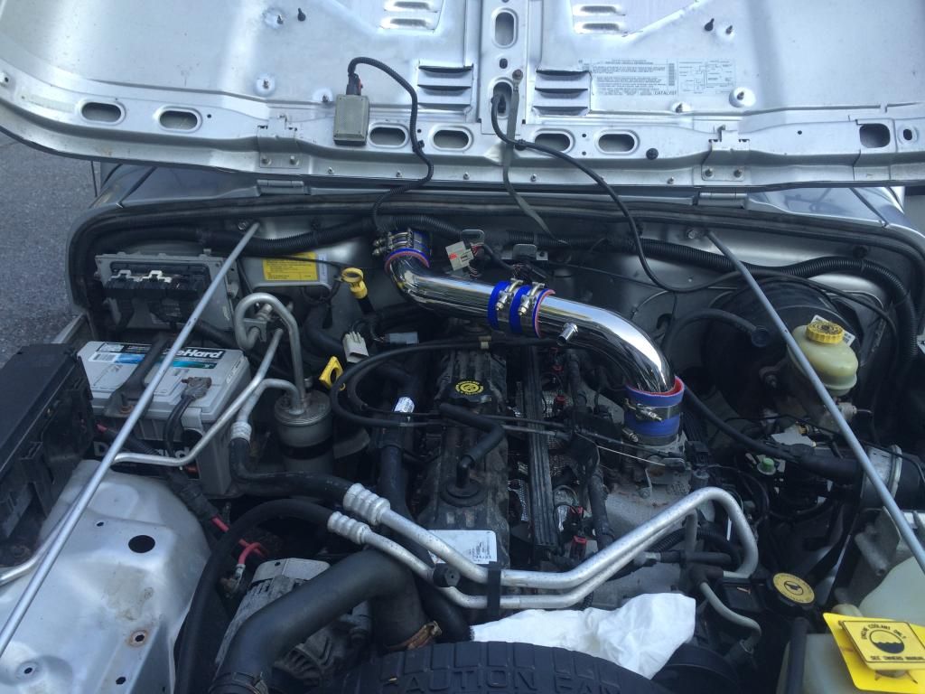

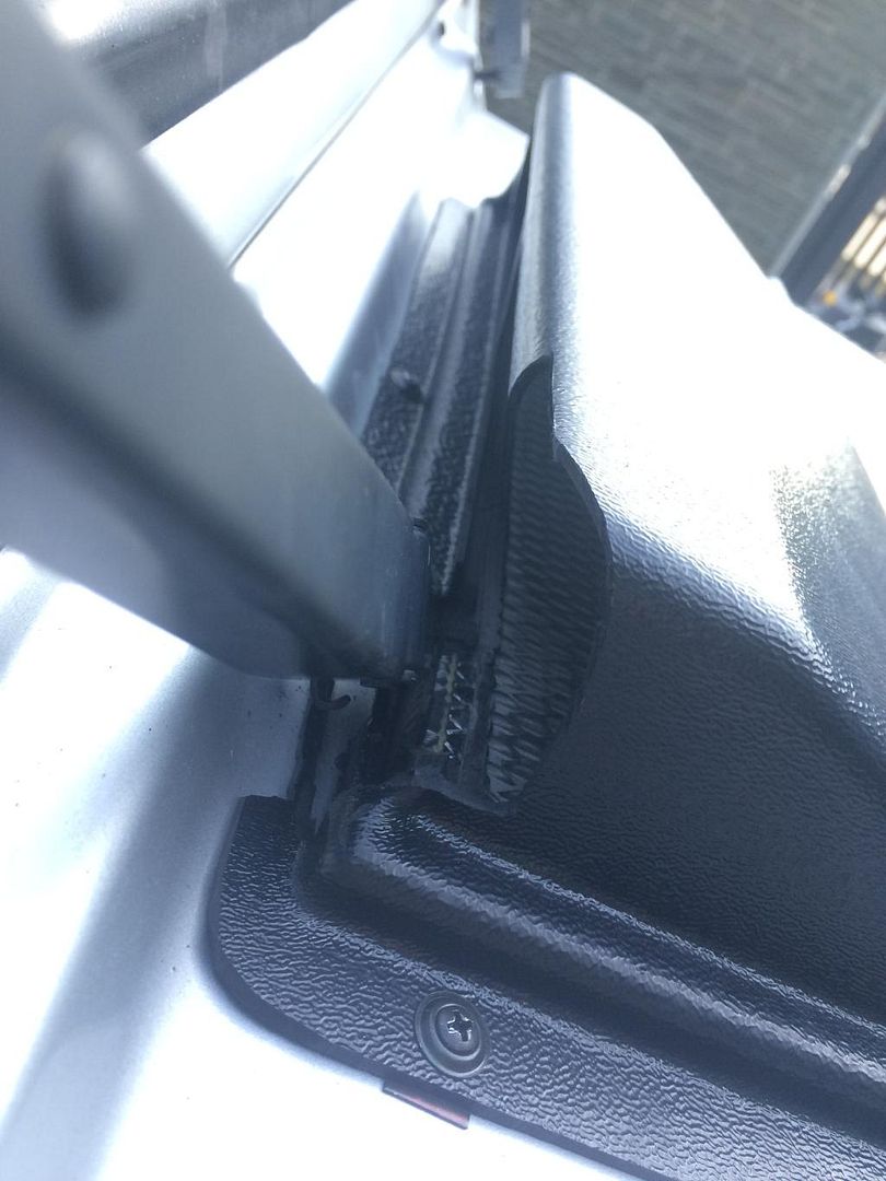

Almost forgot- Mac's cold air intake.
10/10 would buy and install again. I F-ed it up as you'll be able to see.
I did this before i did the fenders because I knew realestate was going to be tight. Sorry again.
^ that's where I blew it. put too close to the back of the cowel. Don't do this if you get MCAI.
Kit came 100% complete. Good packaging and darn good directions, but I still messed up. Make sure you clean the intake tubes as there is spooge on them. Verdict- sounds good. Have the annoying cone filter intake at 2K. Can't say gas mileage is better because it sounds soo good, even on stock exhaust, when you're up around 3K. Definitely runs better. Cleared up buncha room.

Cut rear fenders. Mark 3 times, cut once, right?
realistically I cut to the pinch weld. Left me with this.

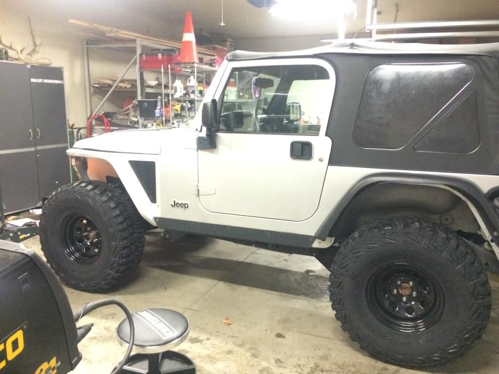

Tires fit. 35" MTR w/ K. 3.75" back spaced cheapo steel wheels.
Need to adjust steering stops a hair.
Haven't flexed it but looks to have plenty of clearance.
Speedo Healer is plug and play. Works perfect. Gears still a little loud but not as noticable now.
JCR "Just made and will ship today" my bumper parts. Not going to use them again. Ever.
Hoping to get to the brakes this weekend. 35's are a little harder to stop than 31 9.50 15's

Next step is to make sure I have adequate clearance. Looks like I should be fine but I need to flex it out.
After that I want to outboard rear shocks and straightened the springs. I'm concerned that after out boarding my springs will easily be unseated. Not feeling a longer spring but we'll deal with that when needed. Eventually chromo and rcvs I guess. The rubi 44's should be good for 35's with an auto.
Then I want to do the swag body mount lift and do a boat side. I can't see the stock rubi rocker guards lasting too long.

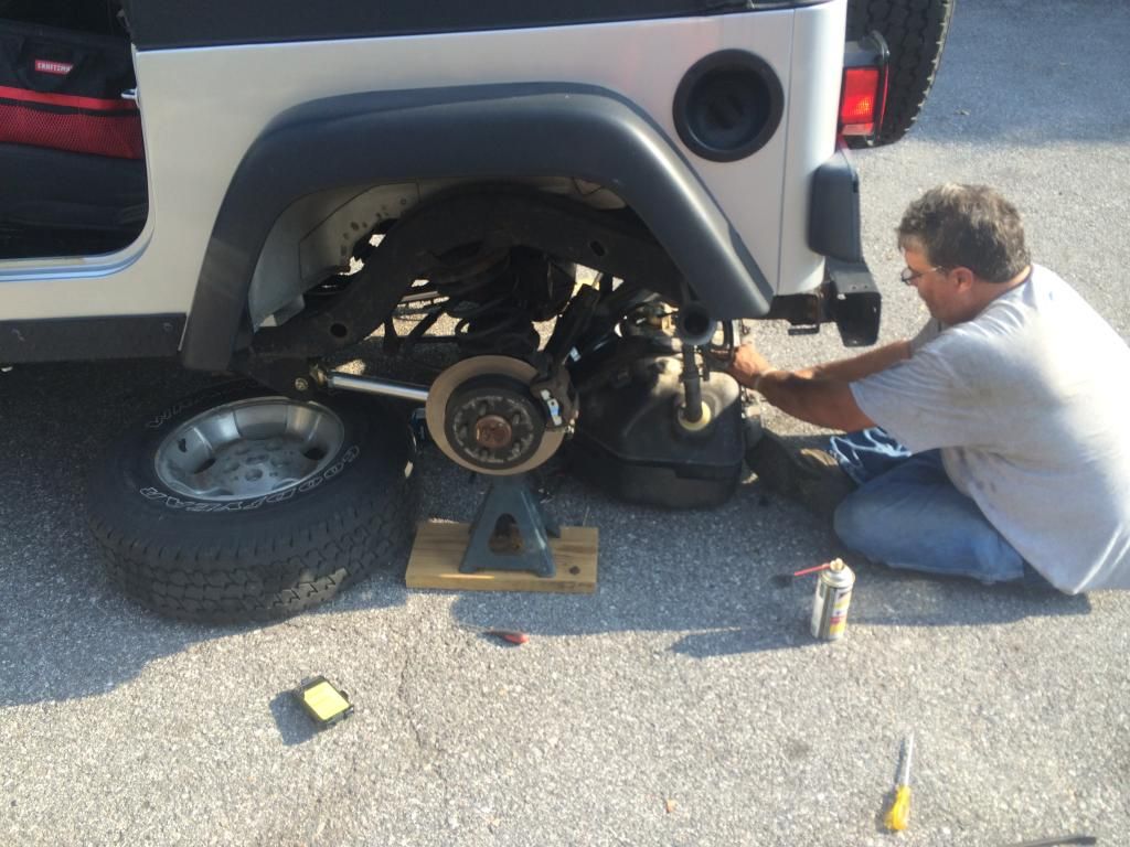

got rear calipers swapped around and bypassed the charcoal canister. Hoping it won't throw any codes. process was easy peasy. Will get the Black Magic ebrake kit when I do rear chromo's
waiting on brake lines to do centric rotors and BM pads. Looking to do rear Chromo. I'd like to go with revolution but haven't seen any for a TJ rubicon.
