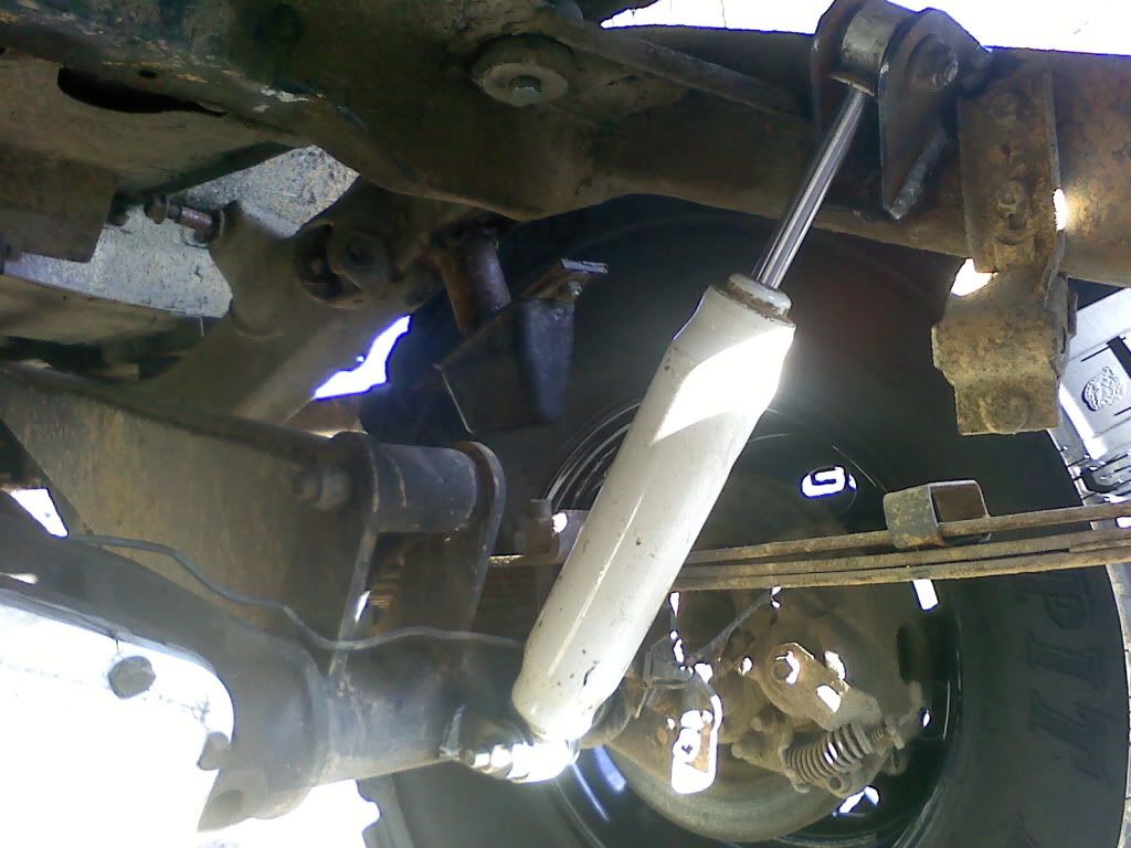

Here is a picture of how i mounted my shocks.
These are just some old like 8 inch travel shocks that were originally on my rear back when it was spring under. With this set up i am running 4 inches of uptravel without my shocks bottoming out. The only thing my shocks limit now is droop, but i have never had a problem with raising a rear tire yet. Another thing to consider is I took maybe half of the leafs out of my packs to lower my jeep so you should have a little more room under the back of your jeep and most likely less droop than I do because your springs shouldn't compress as much. I was using some tabs i already had strictly welded to the frame but i'm sure you could easily make some tabs that come off of the top of the frame to allow for a longer shock. Also consider that when you have your shock mounted at an angle the axle is able to move up and down say 12 inches where as your shock shaft might move 10.
Not to sound stupid but are those ladder bars on the back? The triangle looking things I mean.

It is an antiwrap bar... Help with axle wrap caused with running leaf springs. You only need 1 on the rear axle.
Oh. So like when you gun it then the axle won't shift right?
