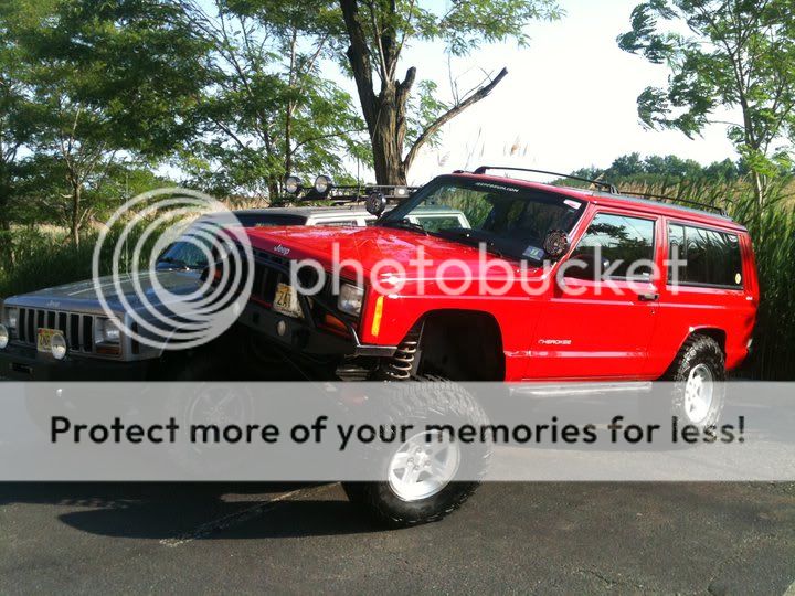

Went to a local car show, i flexed out on my friend (4doorxj)s tire. You should have seen the crowd around our jeeps, people went right under my front bumper and posed for pictures.
