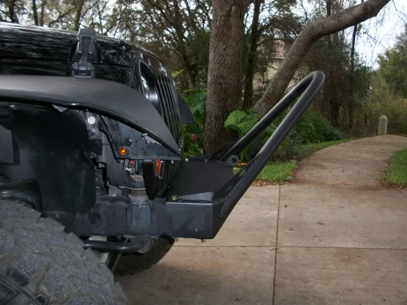

Bumper mounted and bolted down:
Ok, we noticed when we were torquing the nuts on the bottom to 85 ft/lbs the frame began to cave a little.........so I remembered reading how others on this site have created a bracket to help distribute the torque. So we took the factory bumper brackets and cut them down and welded. It worked perfectly and provided a much stronger platform on the bottom of the frame. I highly suggest this to everyone running this bumper.
Here is the photo of the bracket:

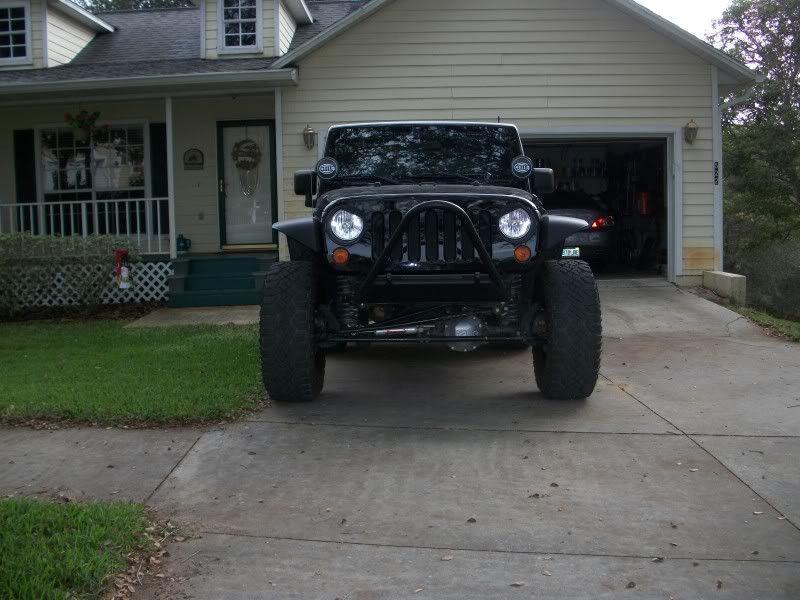

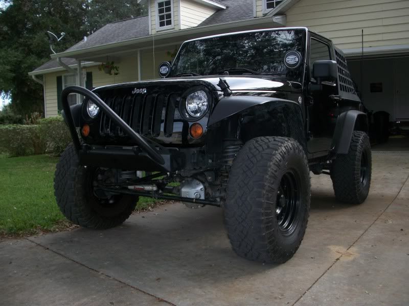

and here is some photos of the finished product.
Driver's view:

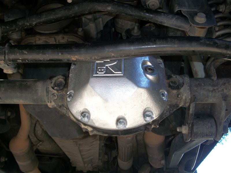

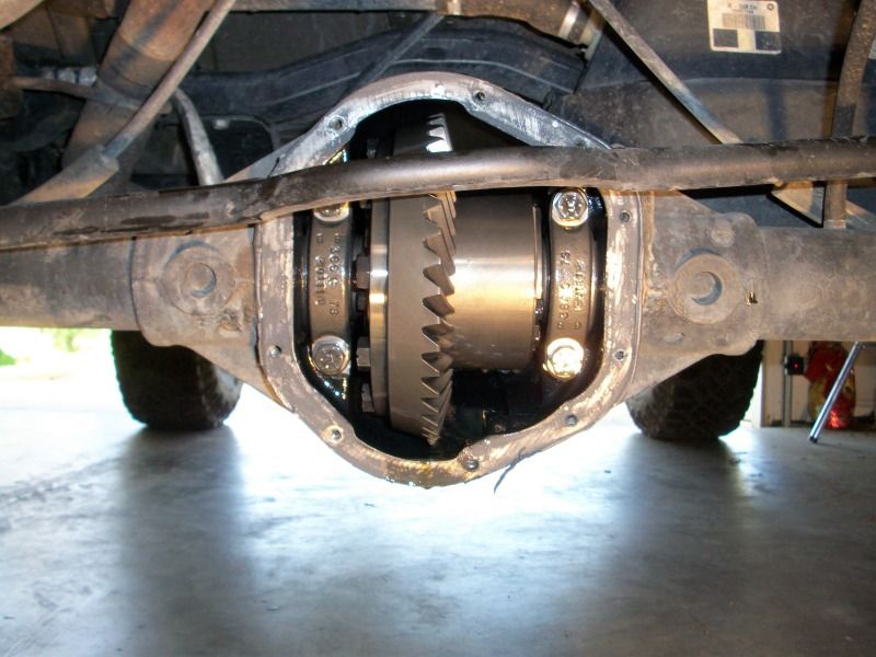

D30/D44 Riddler covers were also installed. These things are tough!

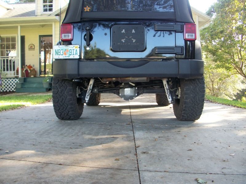

Rancho stabilzer gave out on me so I replaced it with a bilstein.
Skyjacker shocks were replaced for Bilstein 5100's. The ride difference is amazing.
RC front trackbar was replaced for a JKS.
Tereflex limiting straps were installed on the front axle.
Front 2.5" bumpstops were installed.

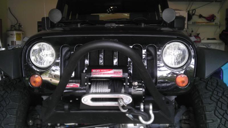

Well after much research I decided on purchasing the Recon 10,500 winch. I ordered it off of Amazon bc of giftcards and received it about a week later.
Here is the blank canvas:
Box came a little beat up-thanks UPS. Thankfully the winch was packaged well so no damage:
Poison Spyder fairlead mount:
The only little issue we ran into was the pre-drilled holes in the fairlead mount were too small for the fairlead bolts. Simple fix of a drill bit opening them up a little.

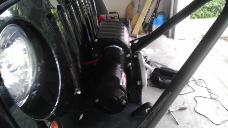

Winch installed:
Photo with the synthetic line cover installed:
Haven't got to do any pulls with the winch and will update once I do so! Although, the wireless remote seemed to have stop working while spooling the line on during install.

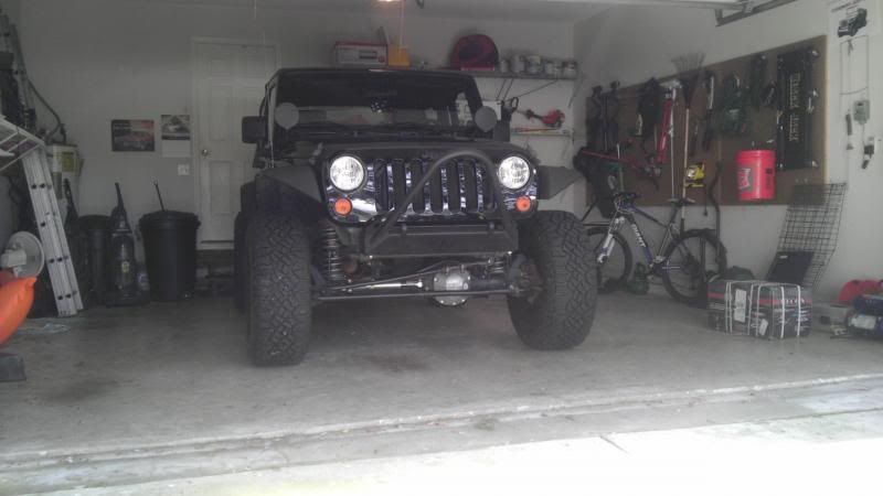

Picture of the new setup out wheelin.
