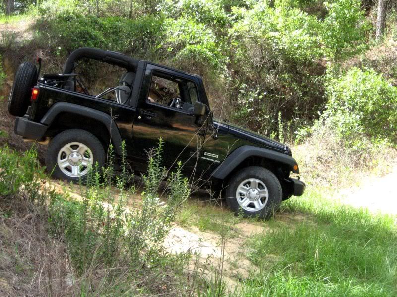

Here is my jeep when I first purchased it.
I was tired of looking like a mail carrier...so I purchased 15x8" Cragar Soft 8's w/ 32X11.5 Wild Country XTX Tires. Unfortunately, I do not have any driveway pics to show just the wheels and tires. Only wheeling pics...LOL I use my jeep!
By the way, this is at a State Forest.....so not ilegal. LOL

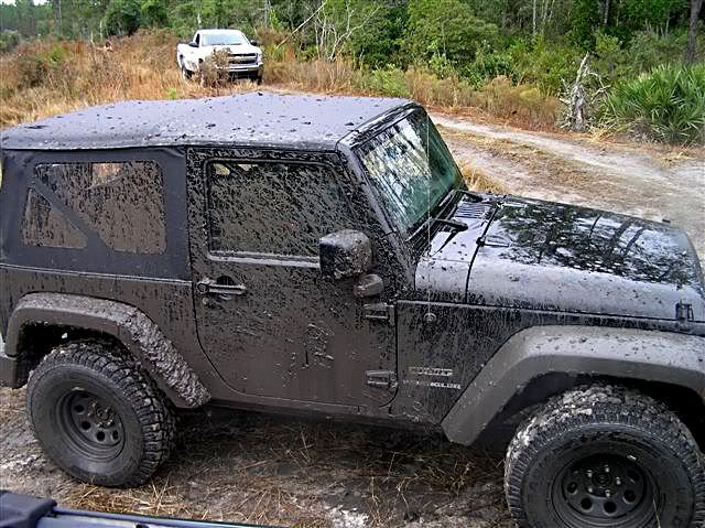

And for the aftermath of a nice day of wheeling!

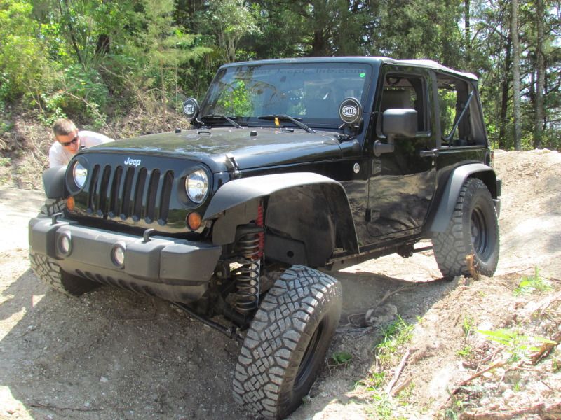

After going on another little wheeling trip to nice little climbing spot, I bottomed out coming over the crest of the climb. As a result, I decided to purchase a Rough Country 2.5" Series II BB Lift Kit. It was fairly simple to install with a friend on this site with our basic tools. The advanced Auto spring compressor made the install even easier and I recommend it to anyone.
After lift:
Haven't been able to go wheeling post lift due to the holiday's but I hope to have some pics soon. I am looking forward to doing more installations and slowly building my JK.
2010 Wrangler Sport M6 16" MB72 wheels, 35" Duratrac tires, 2.5" Rough Country Lift Kit, Hella Black Magic Driving Lights mounted on Rugged Ridge Windshield Mounts, 4.56 gears, F/R Trutracs, Sleeves and gussets, and more.......

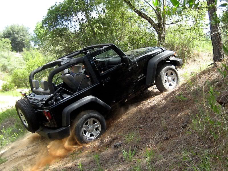

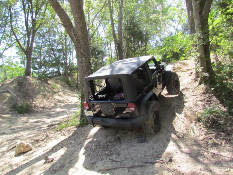

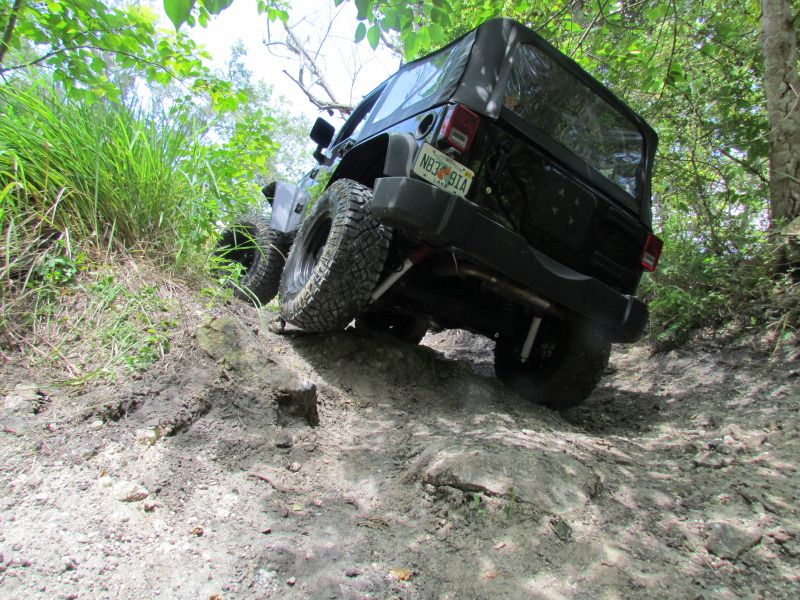

First white knuckle ride. Trust me the hill was pretty steep. And a long way down. LOL My back wheel was a good couple o feet off of the ground. Jeep was doing some nice teetering back and forth. After all said was done, a lot of fun!
Dfloyd with the cig hanging out! LOL
This kind of shows how steep the hill was.

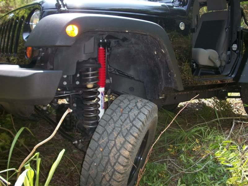

I have been busy but I have added since my last post: Hella Black Magic Driving Lights mounted on the windshield using Rugged Ridge mounts, Rough Country 2.5" lift coil springs and Skyjacker shocks.
Note: to anyone planning on running Skyjacker shocks please order shocks based off of extended and collapsed legnths. Not by what the company deems a 2-3" lift shock. I found out the hard way. The first set of shocks I ordered for 2-3.5" lift JK's. When I mounted them to my Jeep, the front shock only extended past the lower mounting location by about 1".......=not good. I called the company and they advised the shock was the correct part number. I then turned around and ordered the 6" lift shock which has an expanded length of 26.75" and collapsed 15.5". Come to find out the so called 2-3.5" lift shock has a expanded length of 22.xx" and collapsed length of 13.xx".

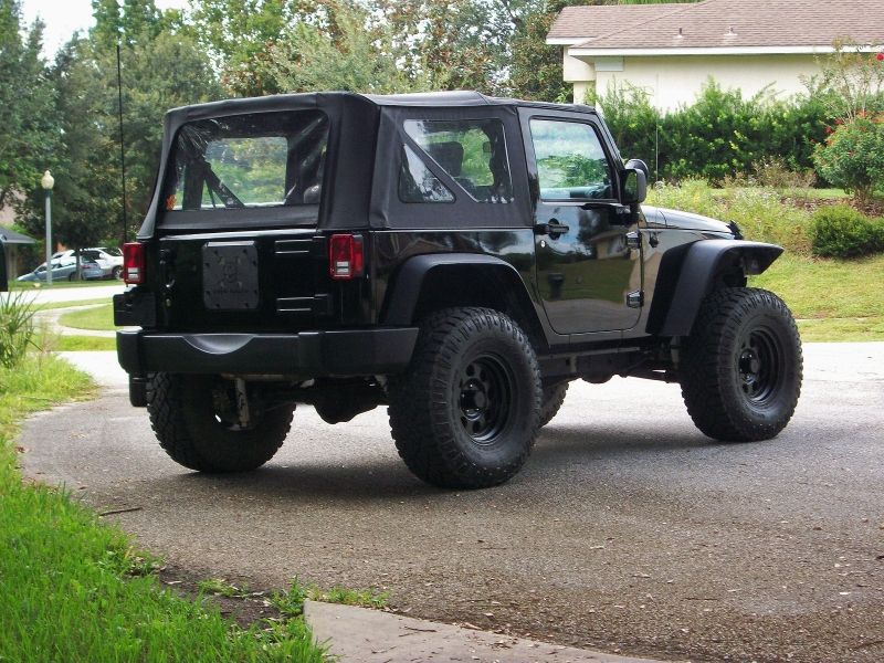

As the build continues it was time for some larger tires.
I attempted to go with 15" MB72 wheels and Goodyear MT/R Kevlar tires but received a call from the shop advising it would take many months before I received the order. The shop advised me it was there fault and they would make it right. As a result, they gave me a great deal on 35" Duratrac tires and 16" MB72 Matte Black wheels.
The following week, Dfloyd and I went to cutting my fenders. I want to be able to flex out the axles so this was a must. The end result, 35s and a 2.5" lift. I love the look. After the picture was taken, I spray bed lined the rear wheel well area for added strength against rock chips etc.

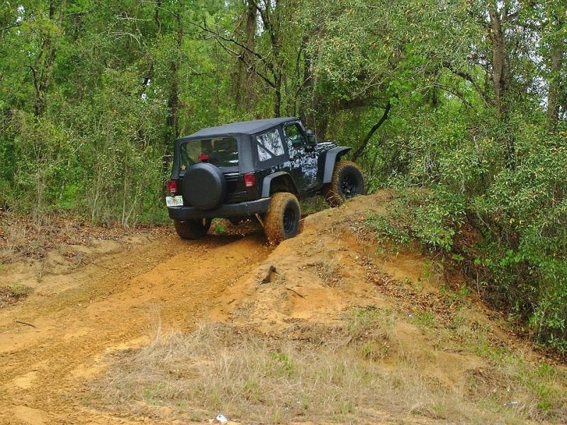

Testing out flex with the swaybar disco'd: very slight rubbing but nothing that will damage anything. I need to order some longer bumpstops one of these days.

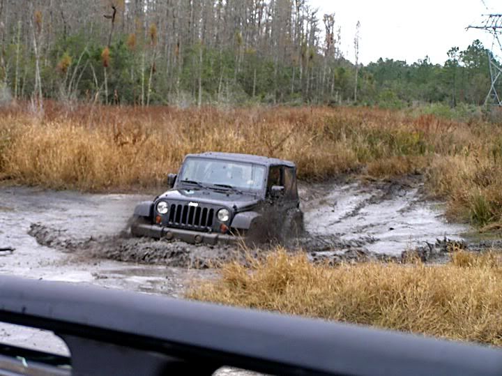

And with more mods, I think I become more invincible. Until you meet a mud hole that has two very deep ruts that cause you to sit on your axles with tires spinning freely like paddle wheels and everyone else enjoying the moment..LOL Not to mention friends racing to be the one to pull me out...so they can say they without me you'd be ****** haha!

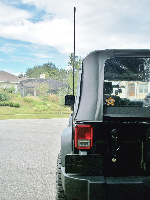

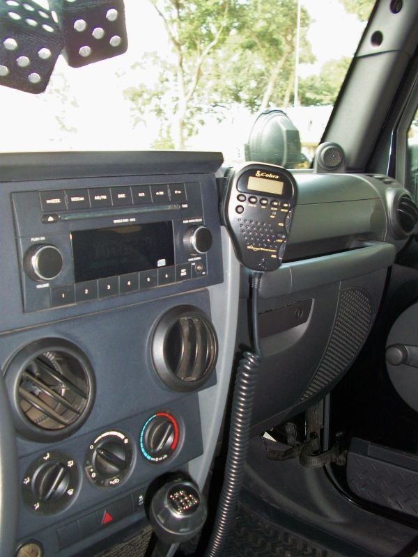

Here is the Cooltech LLC CB mount. It bolts to a screw that holds the radio onto the dash. Again, I liked the factory appearance. The only wire visible is the one attached to the CB. A very clean install. Oh and yes, those are fuzzy dice hanging from the rear view mirror.
